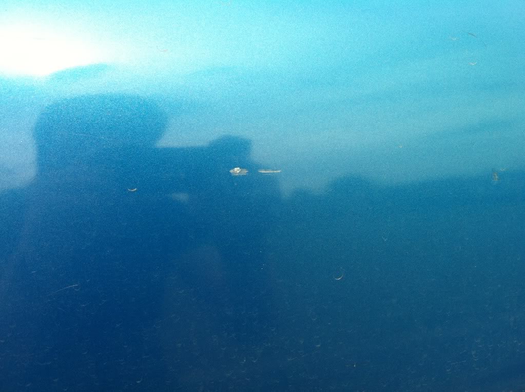

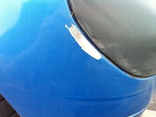

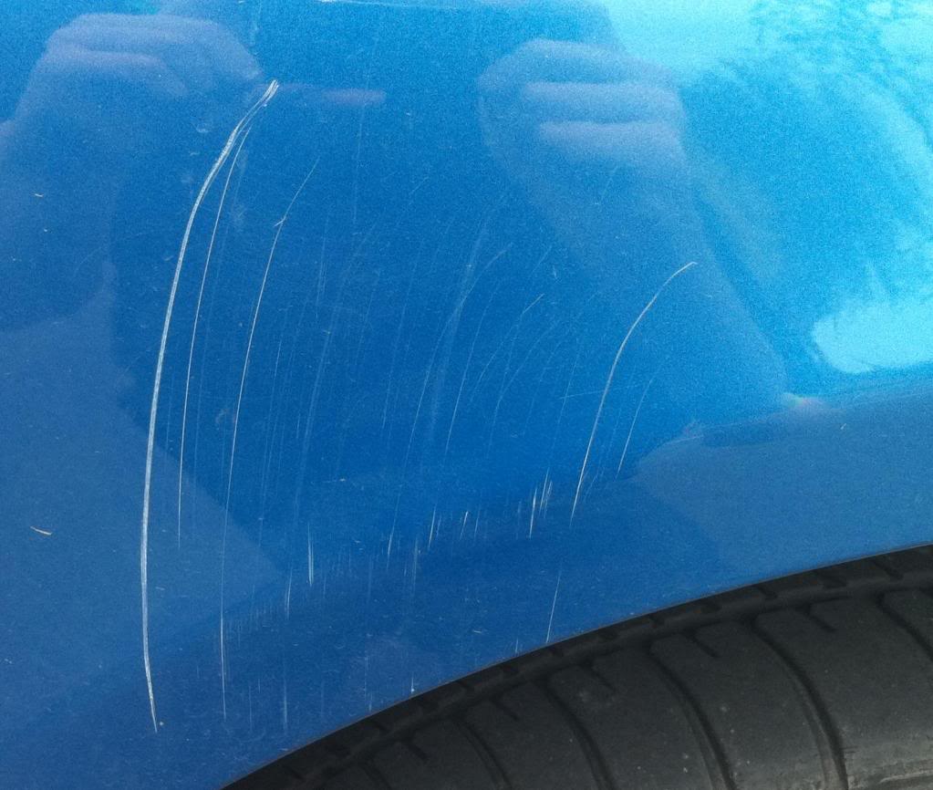

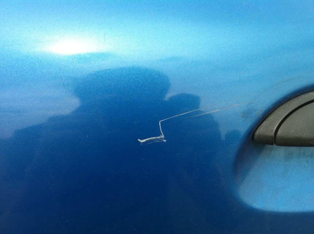

Here are the marks, i cannot afford to get them done professionaly but i have spray (well will have once i order some more!) and a touch up pen.
What do you suggest, i will give the above a go with the megs stuff but want to try and mask them the best i can.
I did have a go yesterday with a couple of small scuffs in the door panel by rubbing my finger over them to fill with the touch up pen paint, it pretty much covered them in from the white but i don't want it to look too obvious as the rest is on the car in view lol.
The bumper is not a problem, i do plan to spray this at some point to colour code.
The same for the door handle, i have new ones that will be colour coded as soon as i get some time.
Those are down to the primer, so will not budge with SRP or Scratch X. I wouldn't waste your time/money and just look at getting smart fixes or the panels resprayed.
