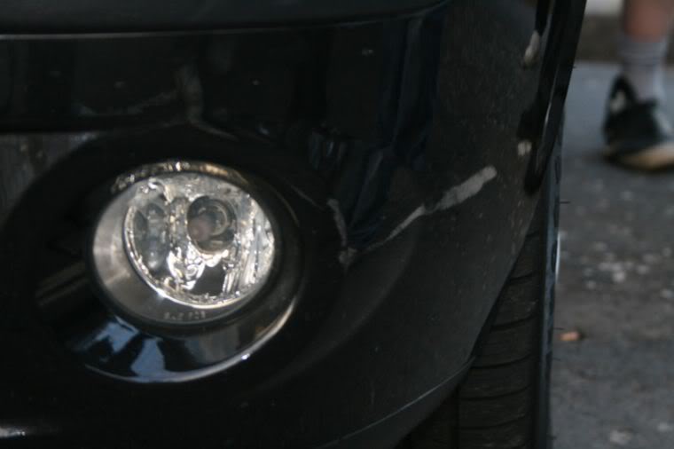

Scuff on paintwork :@. Any solution ??
Car  Static Low
Dont really know how this came about, but got a picture to show.
Its just to the right of the foglight & isnt too bad.
Any ideas how to get rid of it or at least mask it a bit ??
Thanks
Its obviously plastic bumpers.
Something has scraped it.
If the white residue left is paint from whatever scraped it, T-Cut or scratch remover will get most if not all of it off.
If it has taken your paint off there is nothing you can do to ocver it up apart from get it sprayed or touched up. (Large area to touch up tho).
Give a scratch remover a go. Worth a try :)
Alrite mate thanks :).
Il have a go with the t-cut tomorrow morning.
il see how it goes.
If that dosnt work then its obviously taken off the paint like you said.. soo il either just have to live with it or get it sorted out.
thanks.
