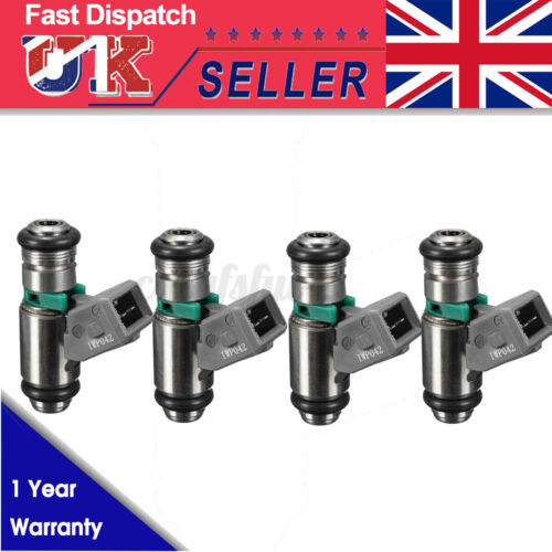

Goes without saying, but if the seller knows anything about these cars, they're very sensitive to the right injectors. Proper Magnetti Marelli not chinese clones from eBay, they're more like £40x4, not £32 for a set.
Everyone on here will tell you to only use Bosch lambda sensors too, £50 or so. https://www.ebay.co.uk/itm/172991958339
Pretty telling about the seller, I'd be very tempted to try and push for a return personally, who knows what other cheap s**t they've put on the car.
