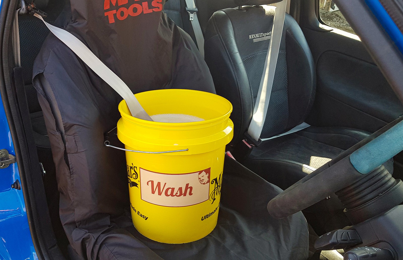

Have you tried putting white vanish in a bucket with water, pulling the seat belts out as far as possible (I undone the bottom t40 torx bolt to release it all) and then letting them sit in the bucket for a few good hours (think it recommends 6 hours on the tub?)
It does get rid of some stains and is the cheapest option to try. Mine came up really well just from a soak.

Well this is an option I hadn’t thought about 👍

Tried this option today and was pretty impressed by the result It achieved. Thanks for the heads up.
BTW is there any product that may provide some kind of seal on the material, I can only think of using a can of scotchguard.
