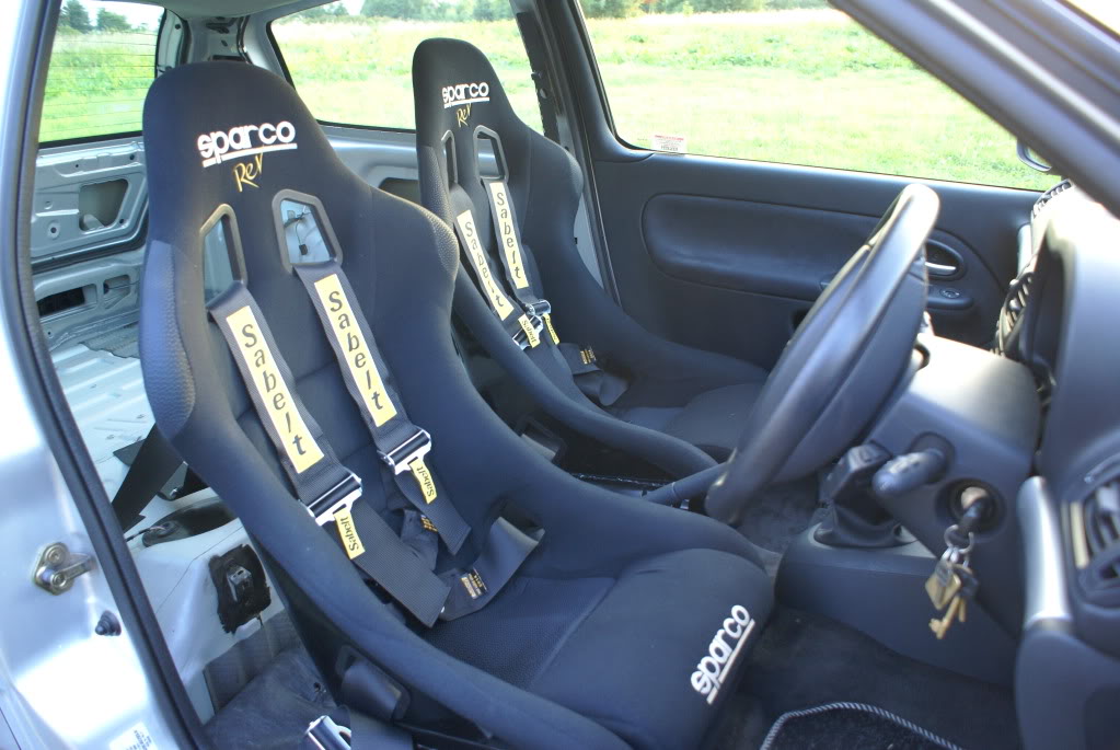

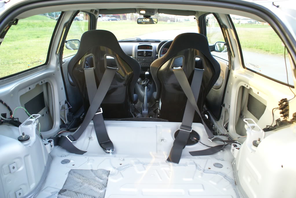

I have 4 point sabelt harnesses, 3" lap & shoulder straps. Apperntly 3" is more comfortable than 2". mine are nice.
Mine were £320 brand new :)
Will these pass in my MOT?
The part of the harness that causes legality problems is the buckle. Aero style buckles are not strictly legal, but mine passed without any issues.
Most manufacturers produce a harness that has a legal buckle, and the Demon Tweeks catalogue states which are which. As for the picture above - you can't see the buckle!
I'm sure you'd be able to buy a legal buckle for whatever you've got though should the need arrise.

http://www.demon-tweeks.co.uk/products/ProductDetail.asp?cls=MSPORT&pcode=SAB901183EPACK
These are what i bought.
Very nice, but not road legal. Don't worry about it though, think you'll be very unlucky if either a police officer or an MOT tester picks up on it.
:eek: REALLY!
I genuinly didnt know they wernt road legal. It usually says on stuff that its only for competition use. But it didnt say on these :( might have to find a friendly MOT man in Feb
I THINK if they are FIA approved, then they are not road legal.
