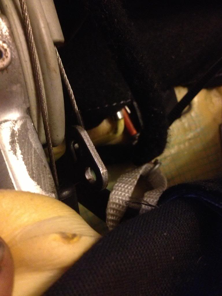

My seat looks like this, I guess the top cable is supposed to be like the bottom one, but the top one is missing.

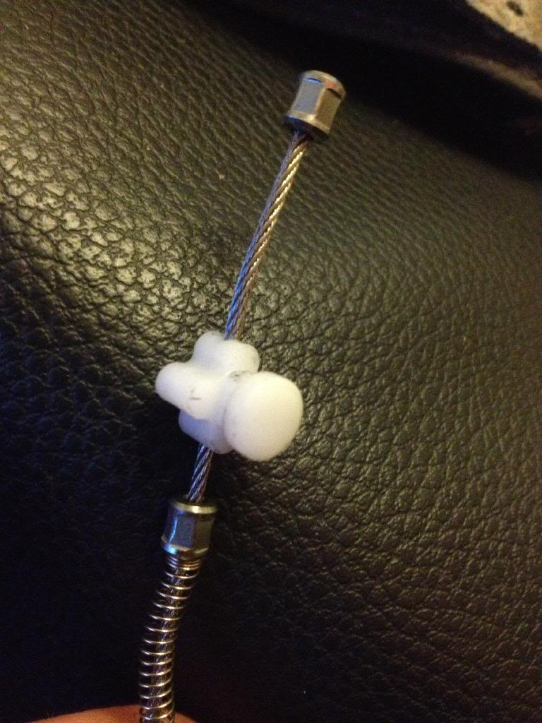

The cable I've got, has the end like this... And doesn't fit, else I wouldn't be asking this question!

So, anybody know the correct part number for my seats? Its the drivers side one if that makes a differance (Don't believe it does though?)
Any help would be brilliant, thank you!
Hello ,had the same issue the other day and sorted it by cutting a slot near the hole then the later cable slides in and twists luss holding it in ;)
