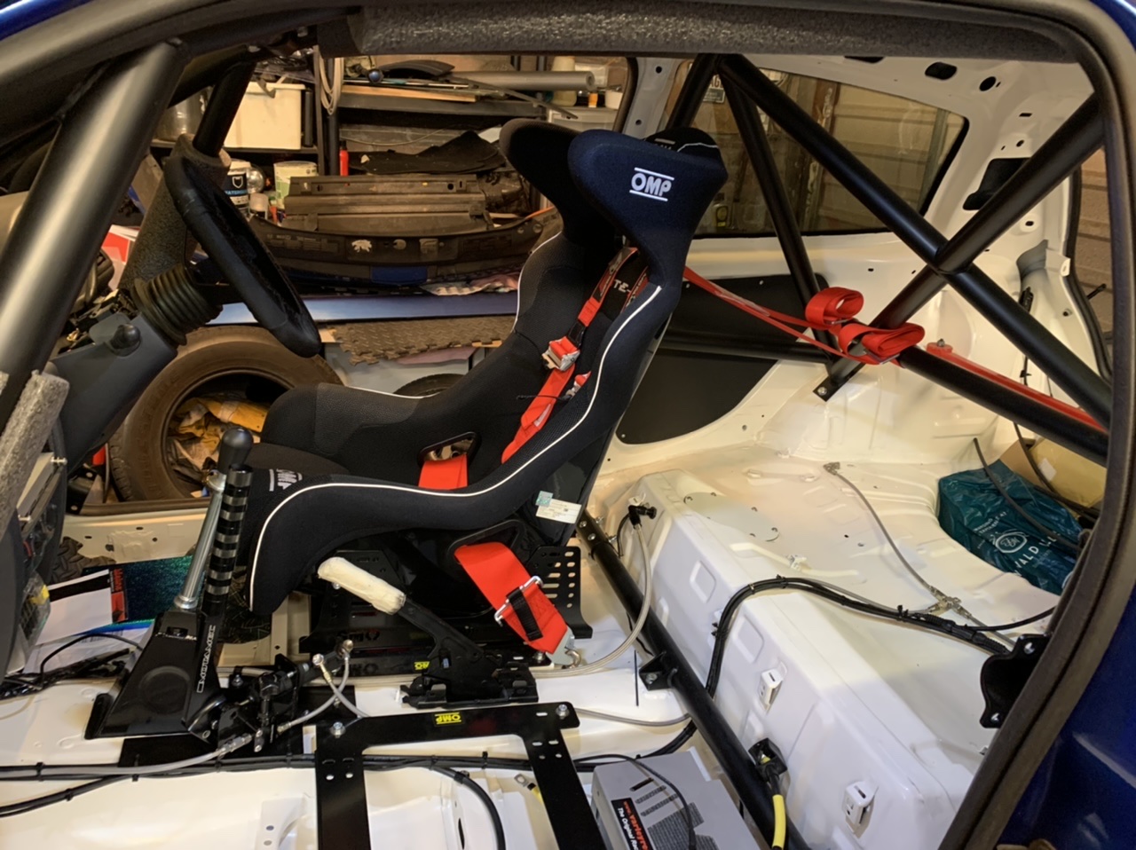

OMP HTE R fitted in mine. You can get the dimensions online to see how compares to your seat. Where is it hitting the cage? It is a bit close on the door bars but workable

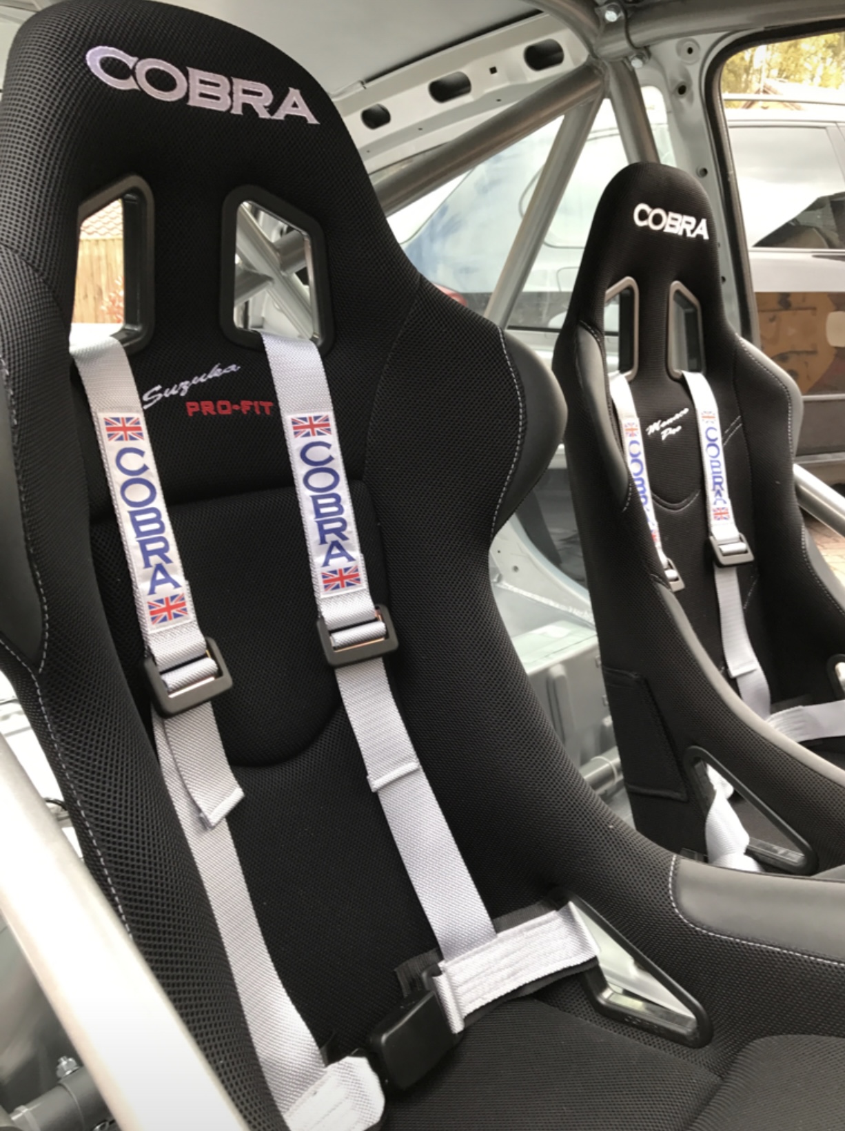

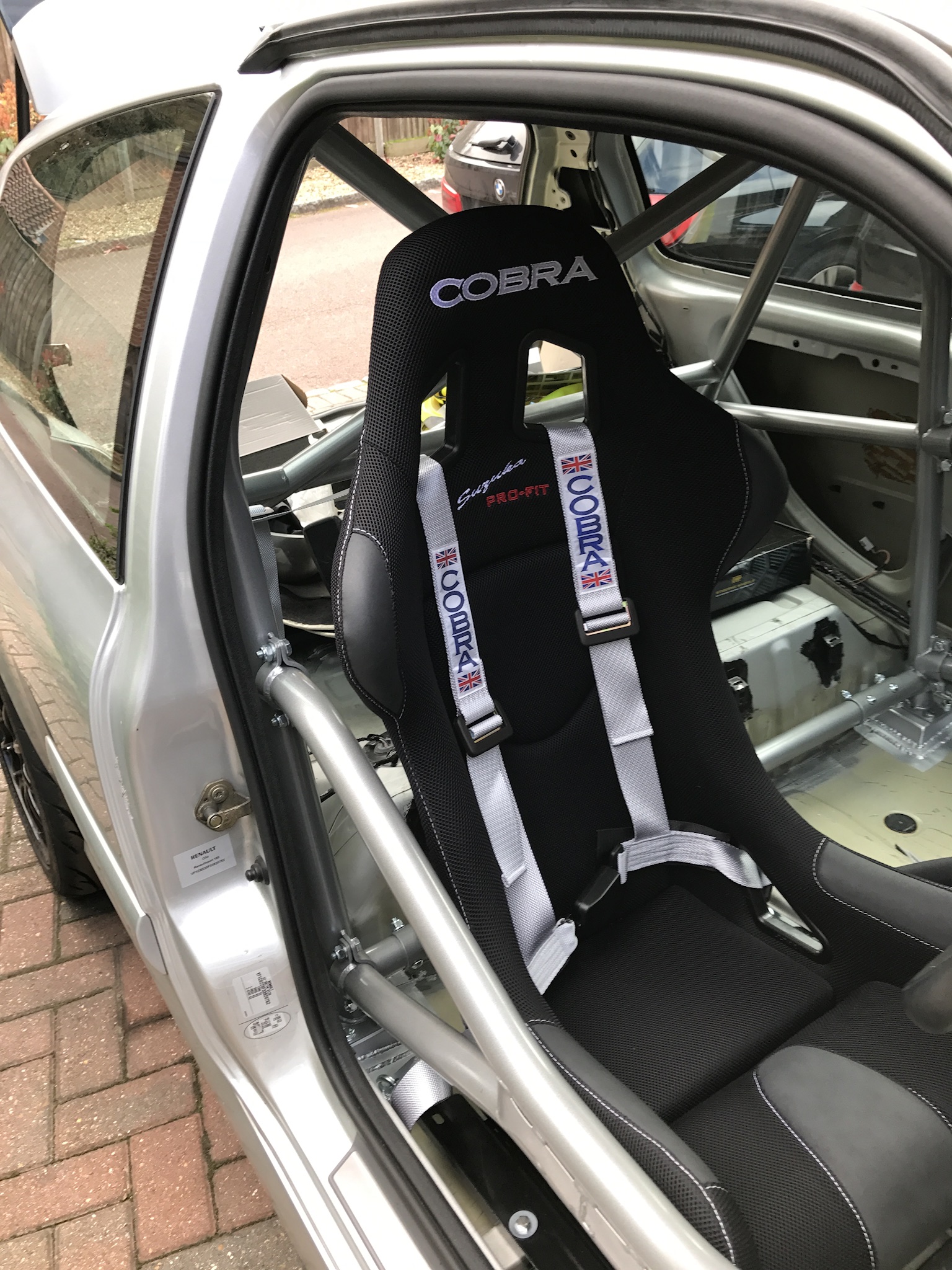

I’ve got Cobra Suzuka on the drivers side on a John Foz seat base. No fitting issues at all. The seat has always been comfortable. I’d recommend one

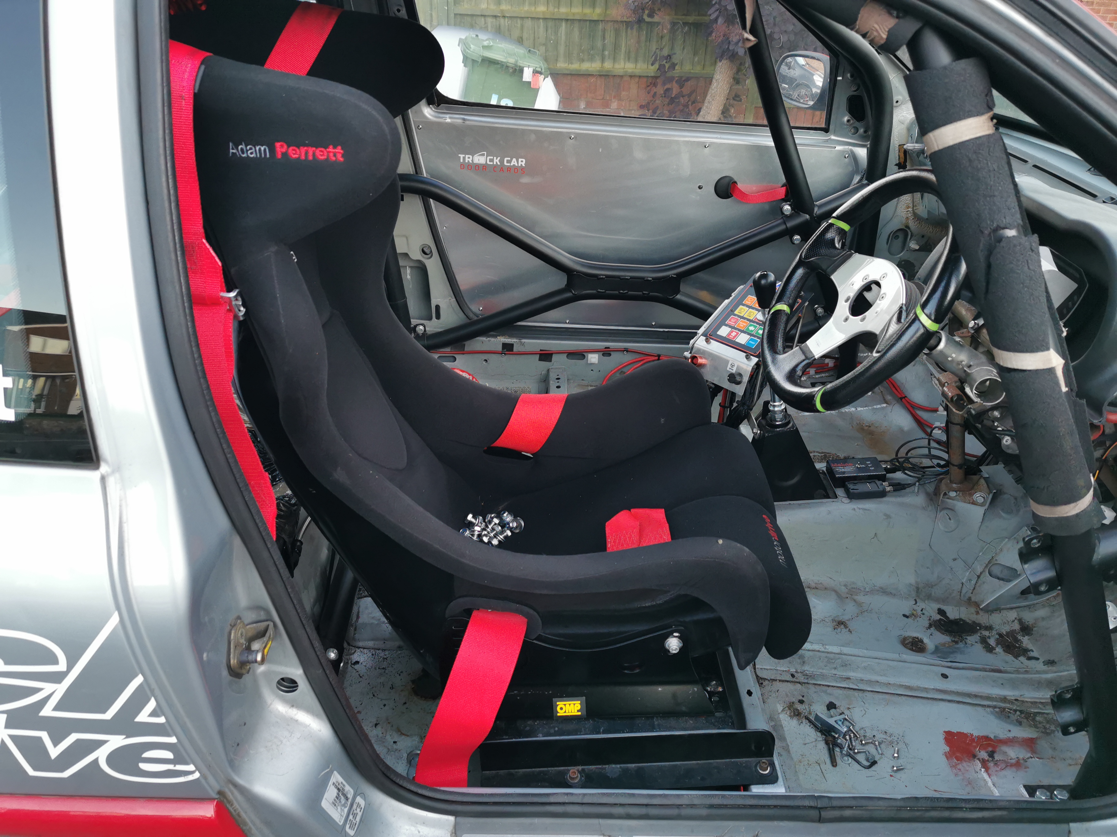

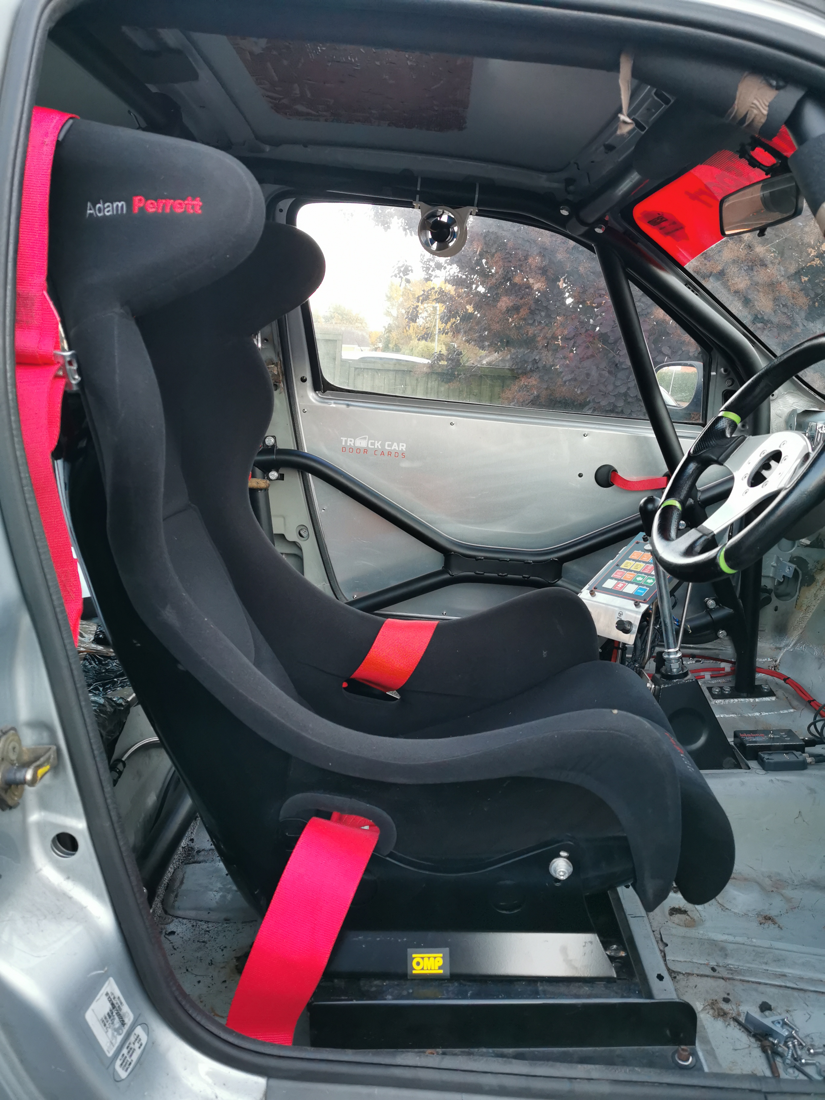

Found this if it helps, the seat has been brought forward slightly but its in and clears the door bar even with fia cage padding on it
