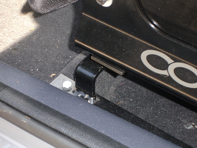

Don't forget to budget for sidemounts if your getting full-on buckets as well
Competition standard buckets, Imolas for example, do not have bottom mounts. You have to get the side mounts which bolt to the side of the seat, beleive it or not.
The side mounts then bolt to the runners/subframe
