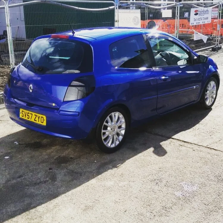

Afternoon ladies and gentlemen, today I picked up my Clio 1.2 turbo from West Yorkshire, travelled from Southend, Essex. 4 hour drive there and back so it was a journey... But I am pleased to say it is my second Clio and it's turbo! Such a big improvement on everything from my last 1.2 16V mark 2 Clio. Power delivery is great, fuel economy isn't as good yet... Here she is...
These are the photos from the ad
It looked really clean in the photos I was surprised it was so cheap at £1695 with 60k miles on the clock
Already was colour coded, K&N filter, team kecko wind deflectors and tinted windows and rear Lights

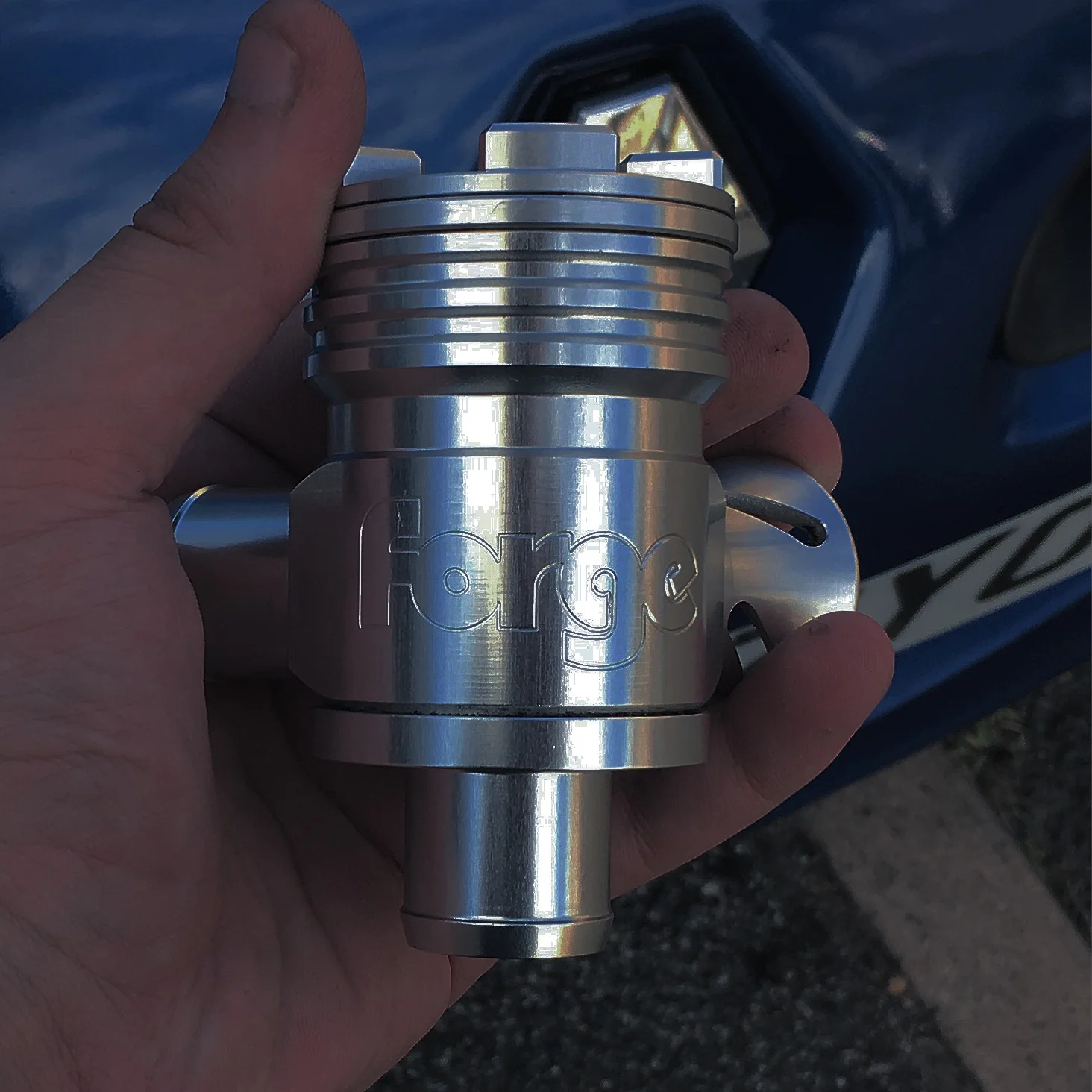

This didn't stop me loving the journey, and when I got home I put a forge dump valve that my brother in law so kindly gave me for £0.

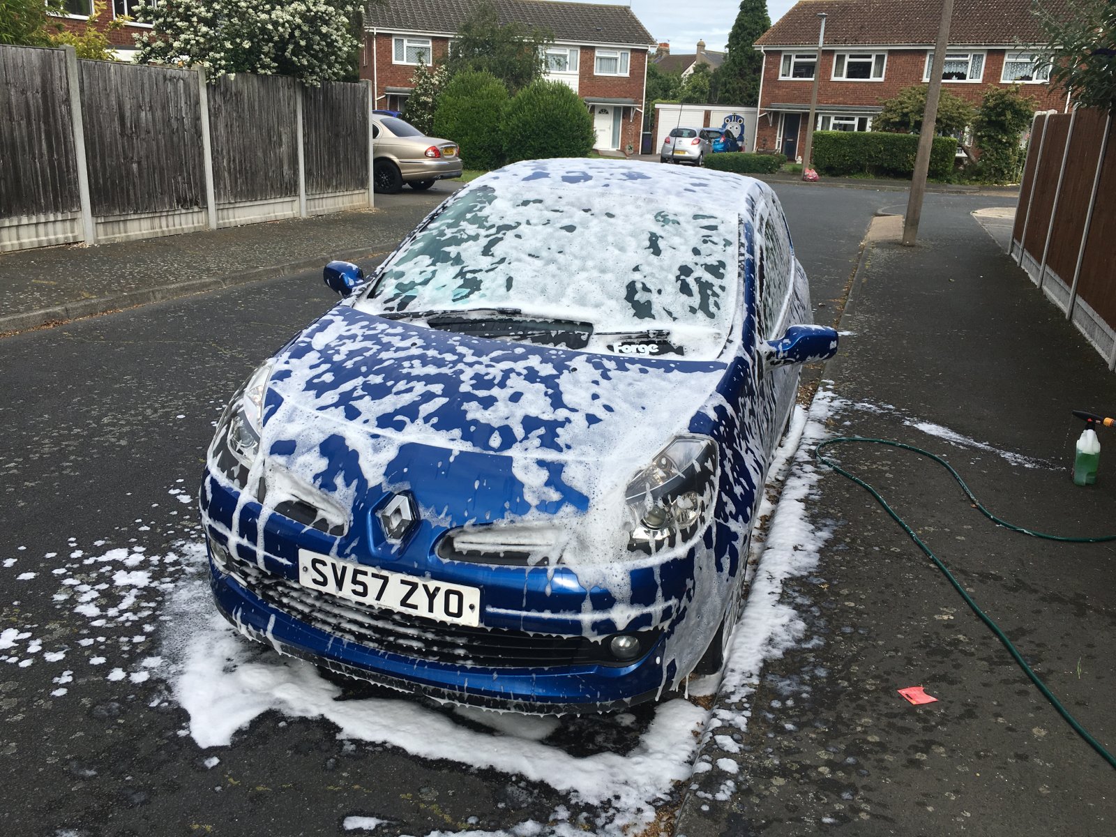

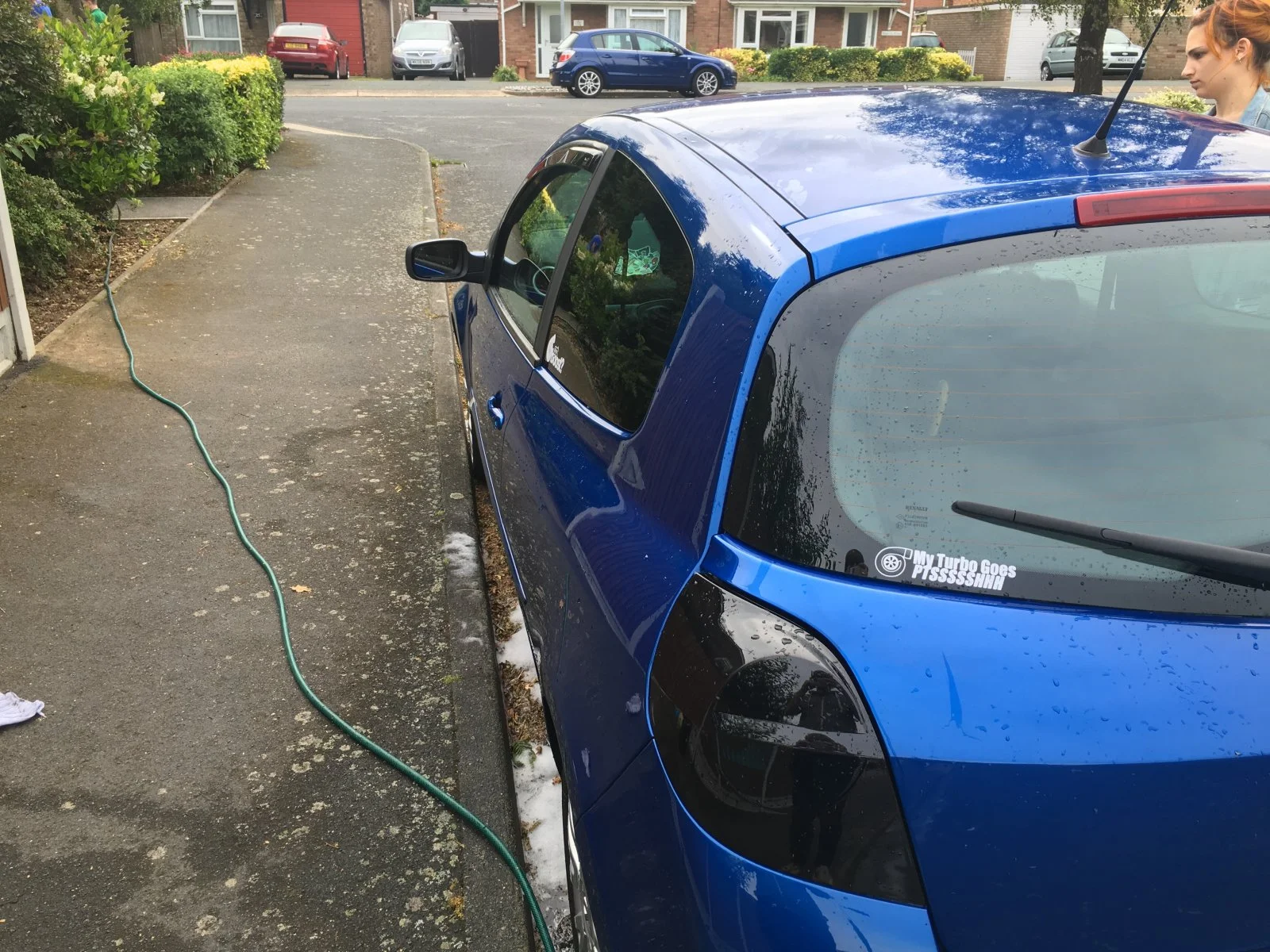

Just a general freshen up with that car, waiting for payday to get the issues sorted! I kept seeing that " Demon foam " car shampoo advertised and brought some for £6. The results weren't that bad at all

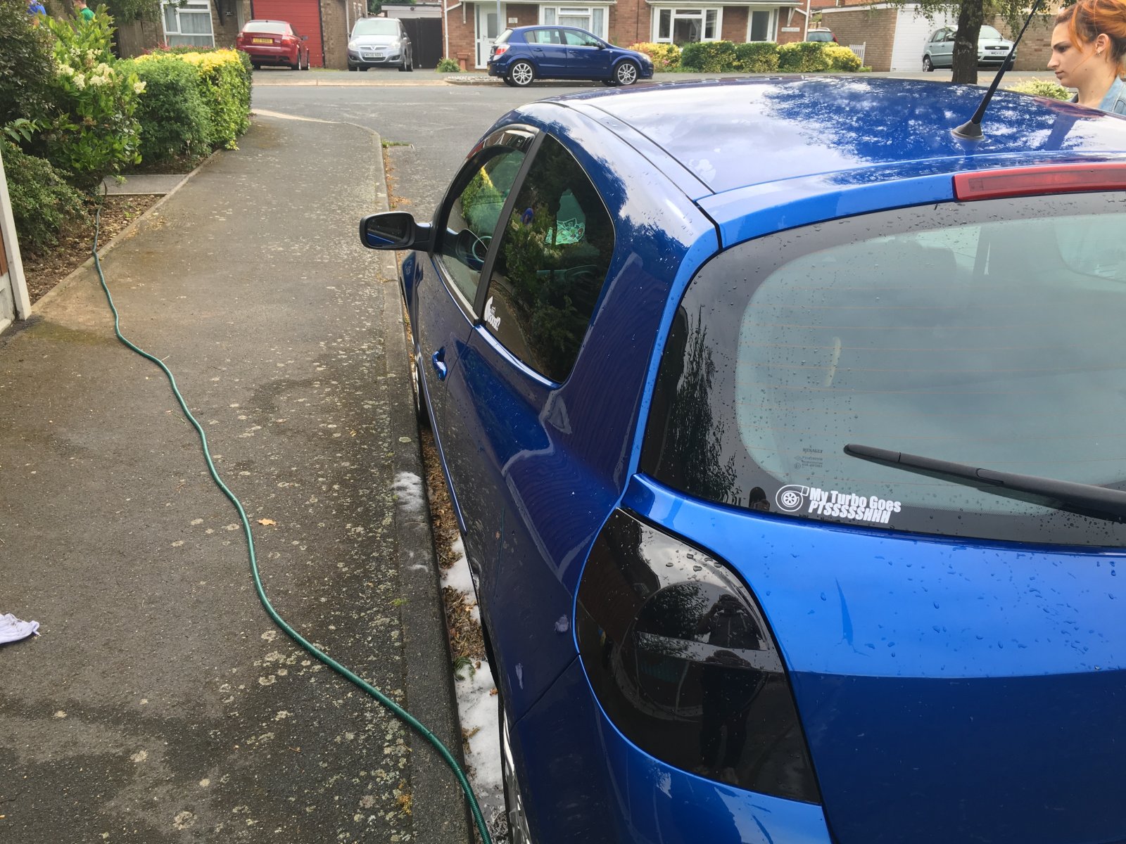

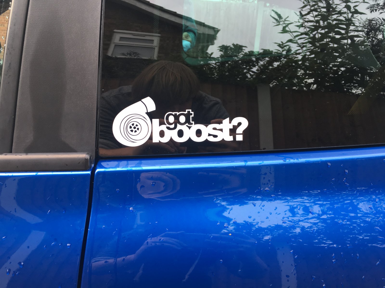

Gotta have some turbo stickers!
Also link to the forge dump valve
doesn't sound bad considering these are running around .4 bar of boost as standard ( might be wrong )

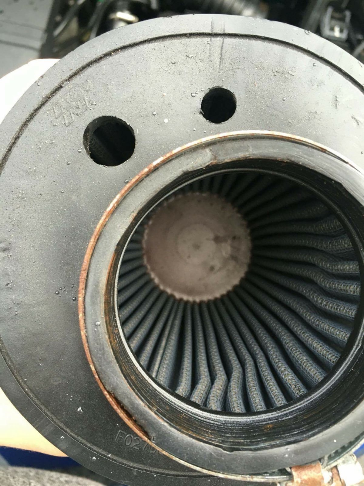

Update! I got the boost gauge fitted after 3 hours and it doesn't work, faulty gauge. So a new one is ordered! While waiting for it to turn up I brought a new RAMAIR air filter as my current one that came with the car ( K&N ) has holes in it as well as colasping slightly. Pic for lols

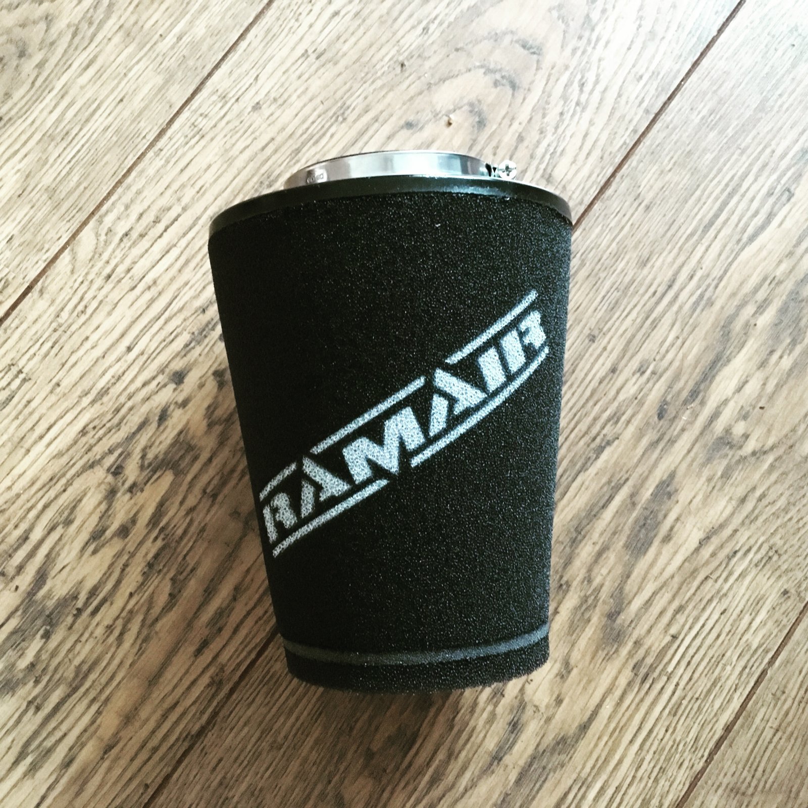

Here's the new one

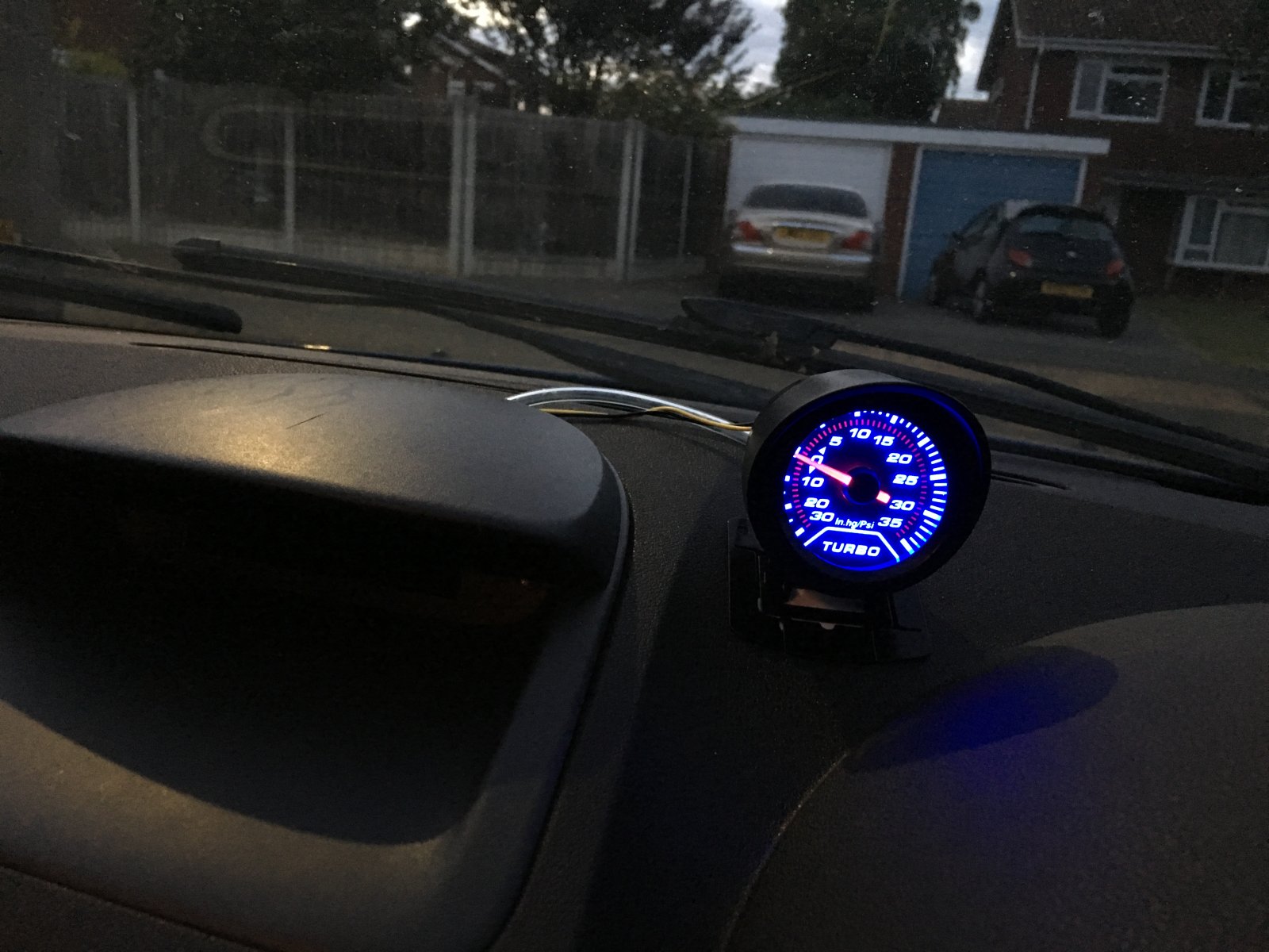

Bonus Lols here's the boost gauge not working correctly

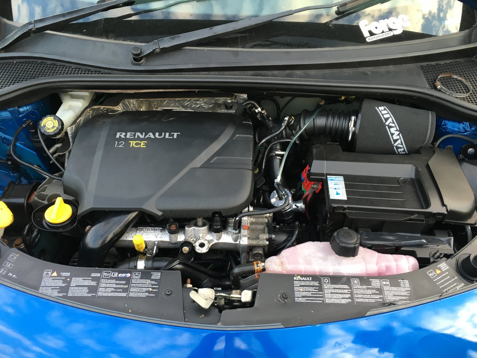

Update! New RAMAIR air filter gotta say it looks good!
But please someone help! It's either a dodgey gauge as I've had 2 and they've both done the same thing ! Turbo gauge won't sit at 0 PSI when the engine is on, and when I Rev it it sits at -30 and won't go above - 25 PSI
( engine currently off )
Engine on and Rev
Update!
Boost gauge now works perfectly, I think? It's reading 7psi.
While adjusting the bov to see what the best noise I'd get, I left the vaccum line off by mistake and it wasn't fast as it was loosing boost pressure, but made the Stutututu noise I've put the BOV on full recuirc and closed the vacuum line so now it boost correctly and I get the Stutututu noise. I love it :)

Forgive me if I am wrong, but I don't think the gauge is supposed to sit at zero on idle, given you aren't creating any boost. Pretty sure it's supposed to be on vacuum at that point
Haha yes you're right, at this point the engine wasn't on, just the ignition

Correct.
Idle you should get vacuum and with a rev it may get to zero. The engine needs to be under load to show positive boost.

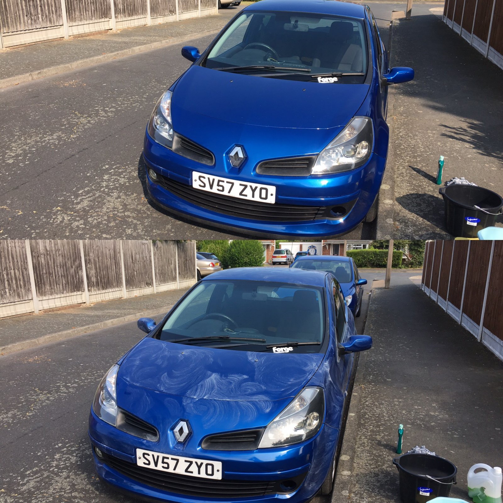

Small update. As its hot in Southend I thought I'd give her a wax, I've never done this before but she came up ok!

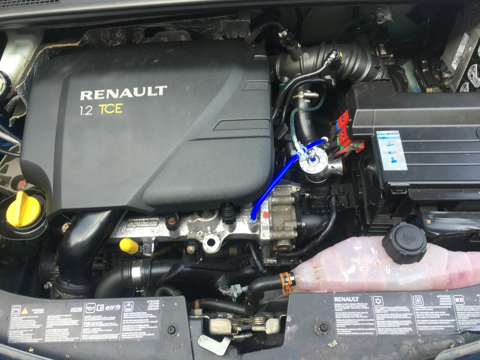

Fitted a blue Vaccum line

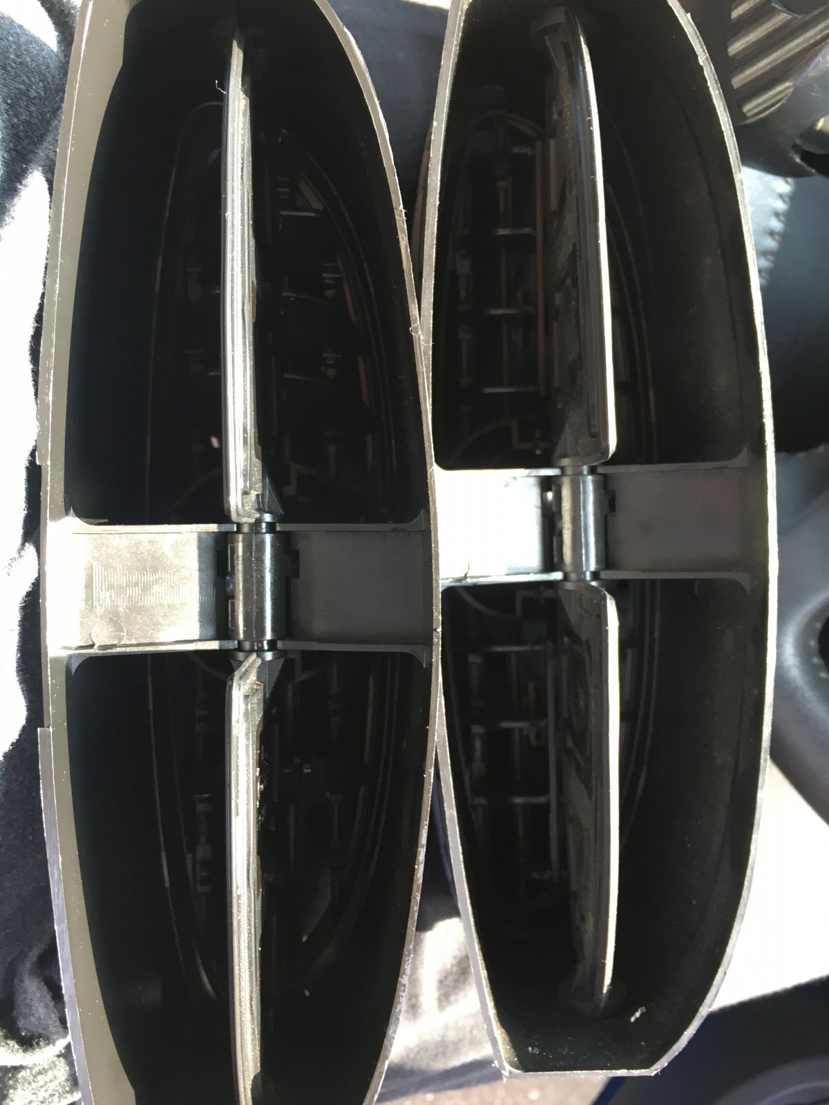

And also fitted a new centre heater as the one that came with the car didn't move at all, so it only blew in one direction

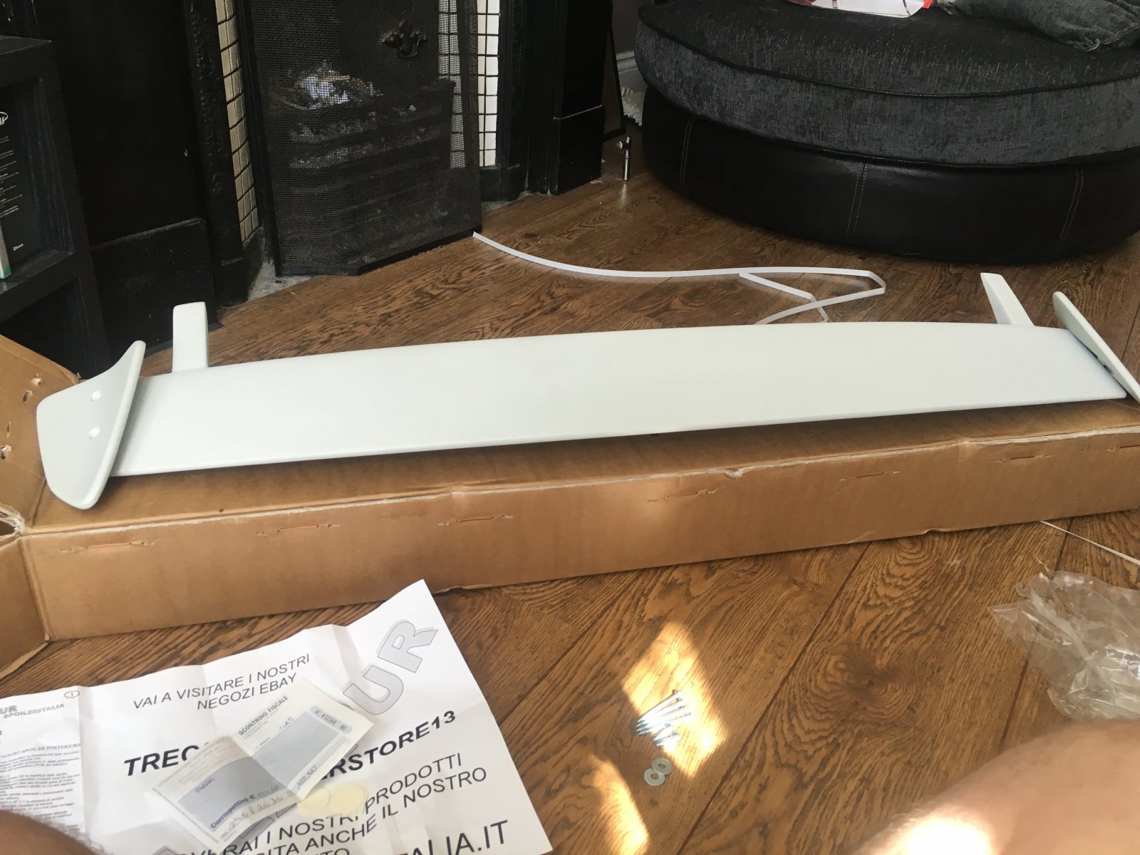

Have brought my cup spoiler and I was eagerly awaiting for it to turn up from when I woke up at 8 to 2. It's those cheap ones from Italy, £110 In total including shipping. I've never brought a spoiler before so I don't know if the quality is good ( it's a fake )
I brought the printed version for a few extra quid
I'm a little gutted actually because a few days after I brought it, real ones were on eBay for only £180.

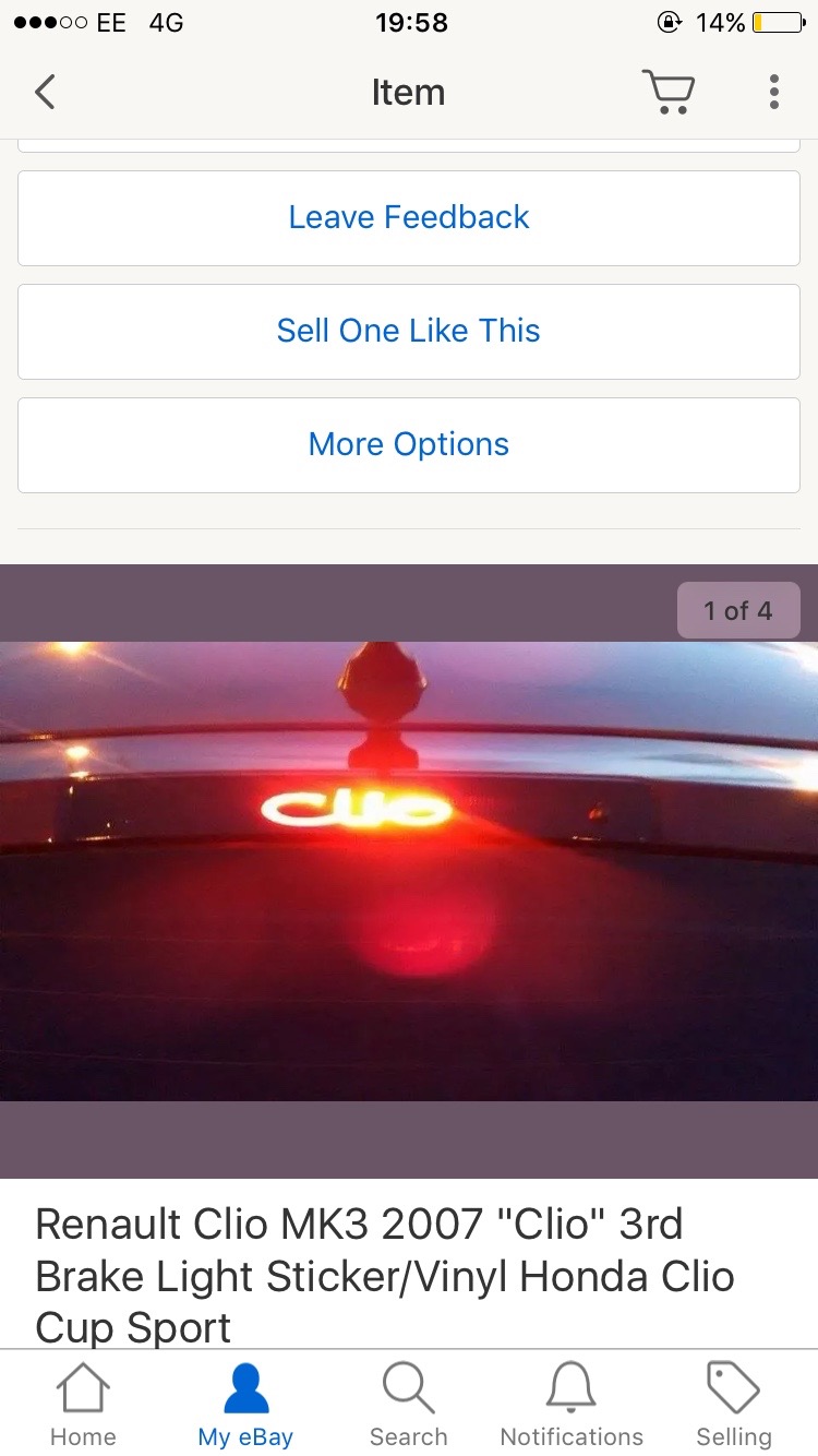

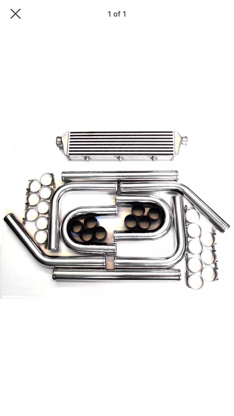

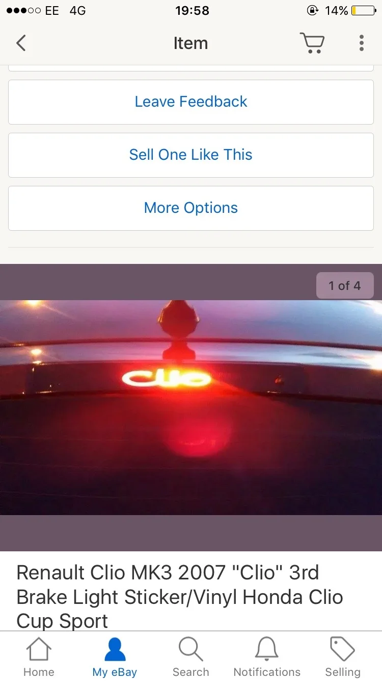

I was watching the fast and the furious on my day off and I thought, im gonna buy a Front mount.. so I have.. And a couple stickers which I think are pretty cool
it all seem to fall in place... now I just need a new front bumper as mines still ruined, paint freshen up and a full service and then ill be putting on the spoiler, front mount. after all of that comes the coilovers, 182 injectors, exhaust and remap!
Because it's a turbo car, bigger cooler + cooler air = better efficiency or so I've been told anyway haha
Haha I'd have done the same at one point. Sorry if I come across a c**k, I don't mean too.
It wont make any difference on your car unless the intake temps are high (which they wont be). In fact, it will more than likely make more laggy and therefore slower.
Not at all, just by research people who have had their TCEs remapped get a front mount and then the boost can be turned up a bit for some extra ponies
The hope is to get 140-150bhp :p
That's fair. Once it's mapped it will help, in the mean time your baby turbo has to try and fill that pipework and i/c. It will move max boost right up the rev range therefore making it slower. I'd hold off fitting it until right before it's mapped if it were me.
That's exactly what I'm doing :p
As well as the injectors as the car won't know what they are

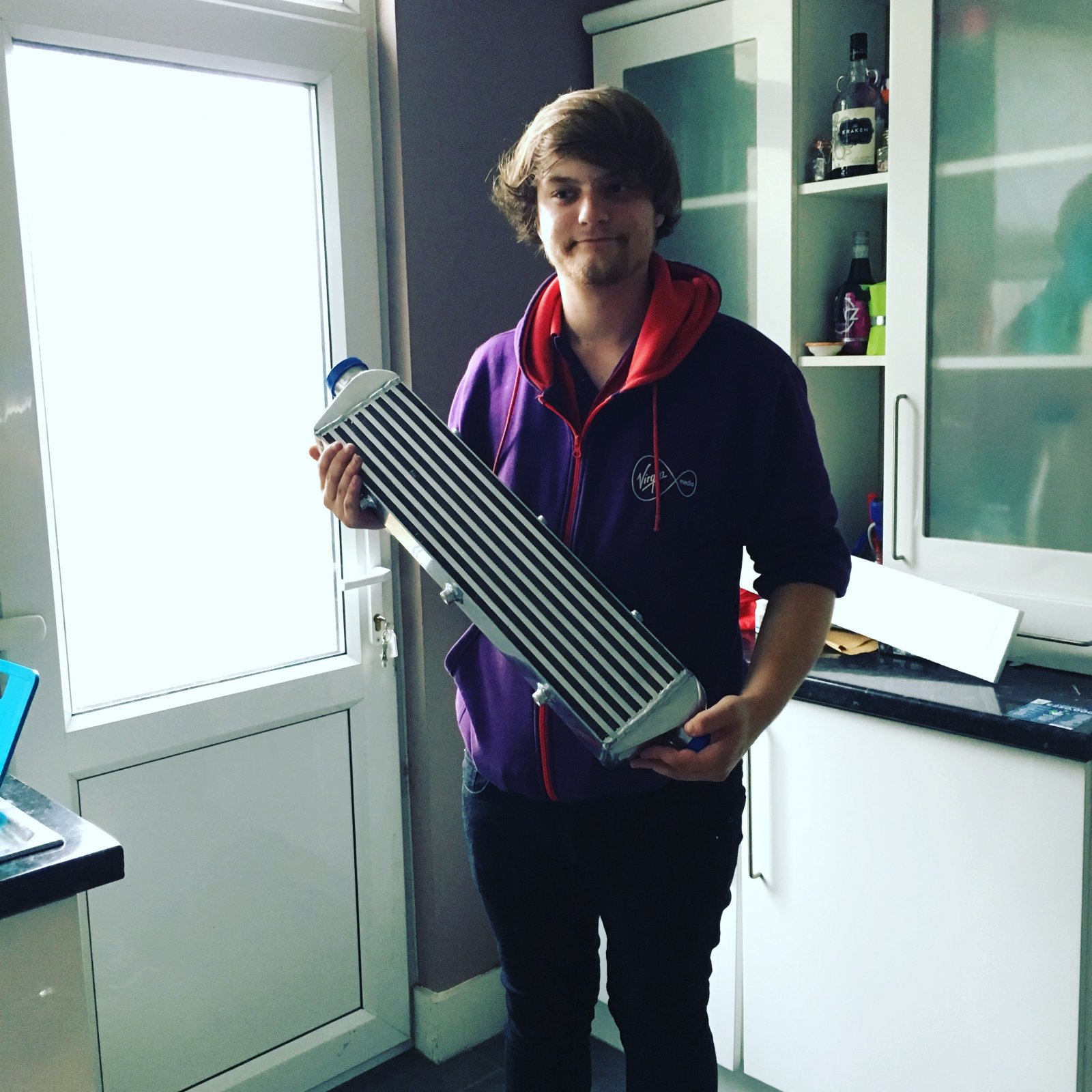

Update! After hours waiting on delivery the baby was delivered on time! It's a boy!
Excuse the terrible picture.
Yes, a new front mount intercooler, can't wait to get this bad boy on

I'm sorry mate but you'll never hit 140-150 in this.
I've had the same car, but newer with a full exhaust, induction kit, 172/182 injectors and a map and the most I hit was 137, but that was reduced as I had crap fuel to 130.
I can't comment on the need for a FMIC but maybe it'll give you 2-4bhp extra. The original isnt bad for the minimal amount of boost these run.
My old one was running 18psi and s**t the bed eventually :smile:. Also, they can't hold boost for s**t LOL. You'll need to get a boost controller on there. The torque drop off is magnificent.
By the way, the turbo is the size of a golf ball. You'll see what I mean but your high hopes if you just take the heat shield off and pull the pipe off, it's tiny lol!
Yeah it's pretty small, I mean I'm only going by what other people have had from there's, there was a guy on Sax experience who had one and got 167bhp with supporting mods, so 140-150bhp is more then enough for me, even an extra 30bhp would be mind blowing for me considering this is my second car :)
