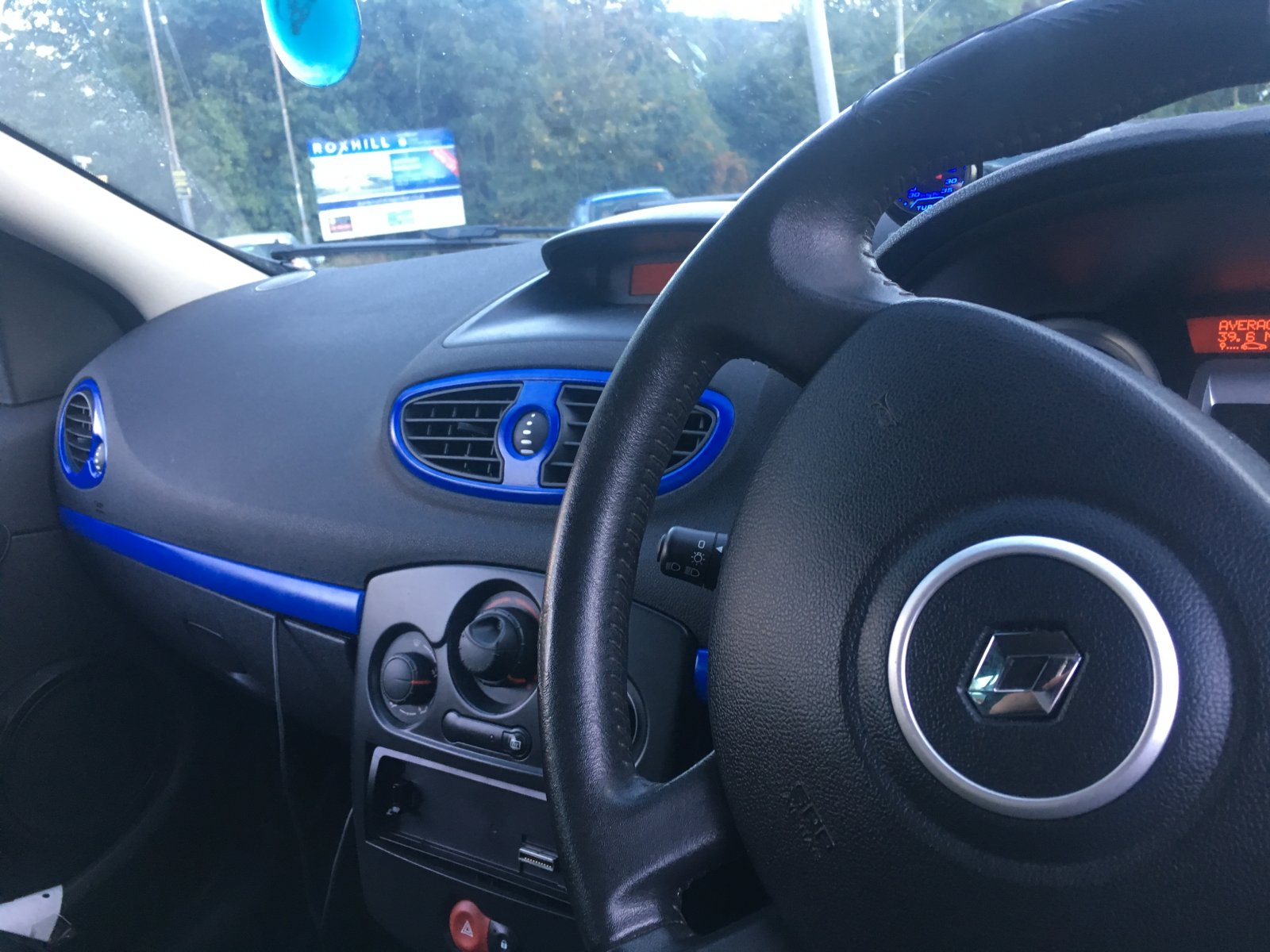

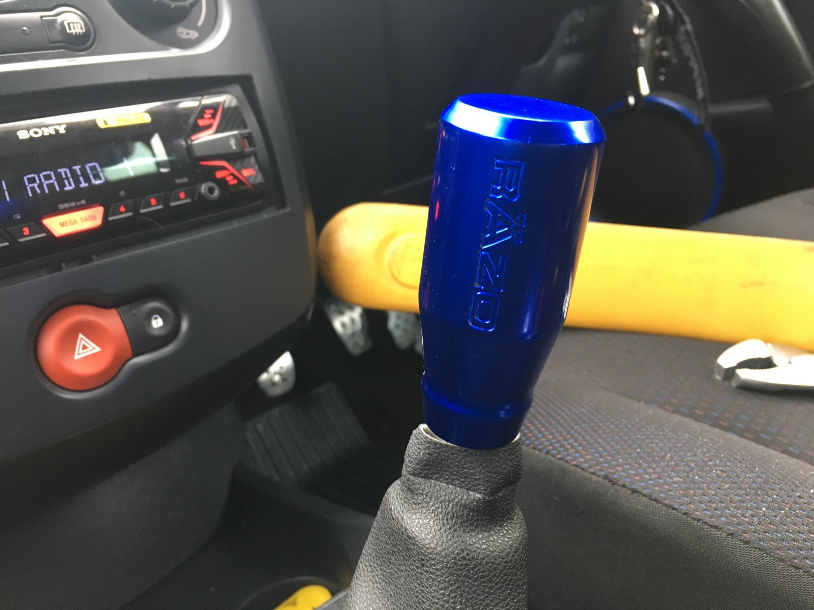

Small updated. Fully colour coded and new gear knob

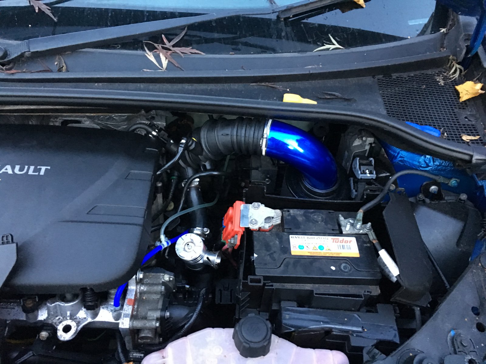

Small update nothing major, I brought a blue aluminium pipe for the air filter to make the engine bay stand out a bit more

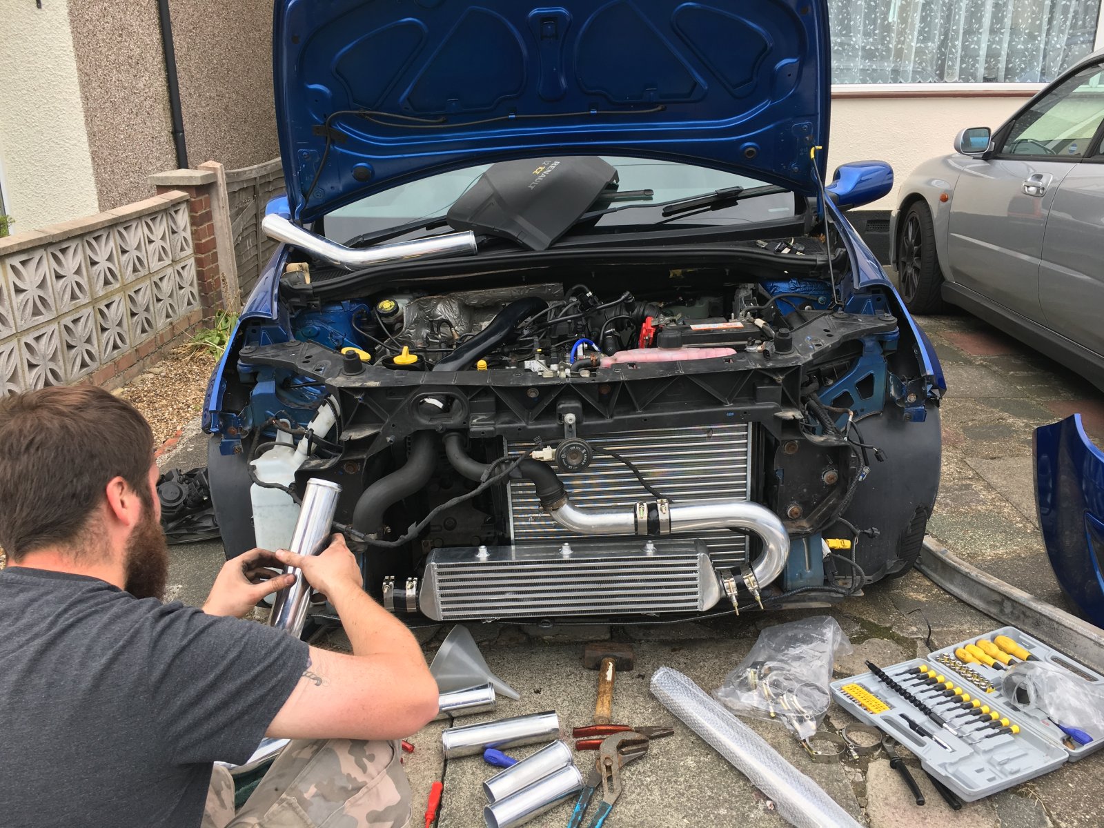

Before it was cut down
I do love the turbo chatter

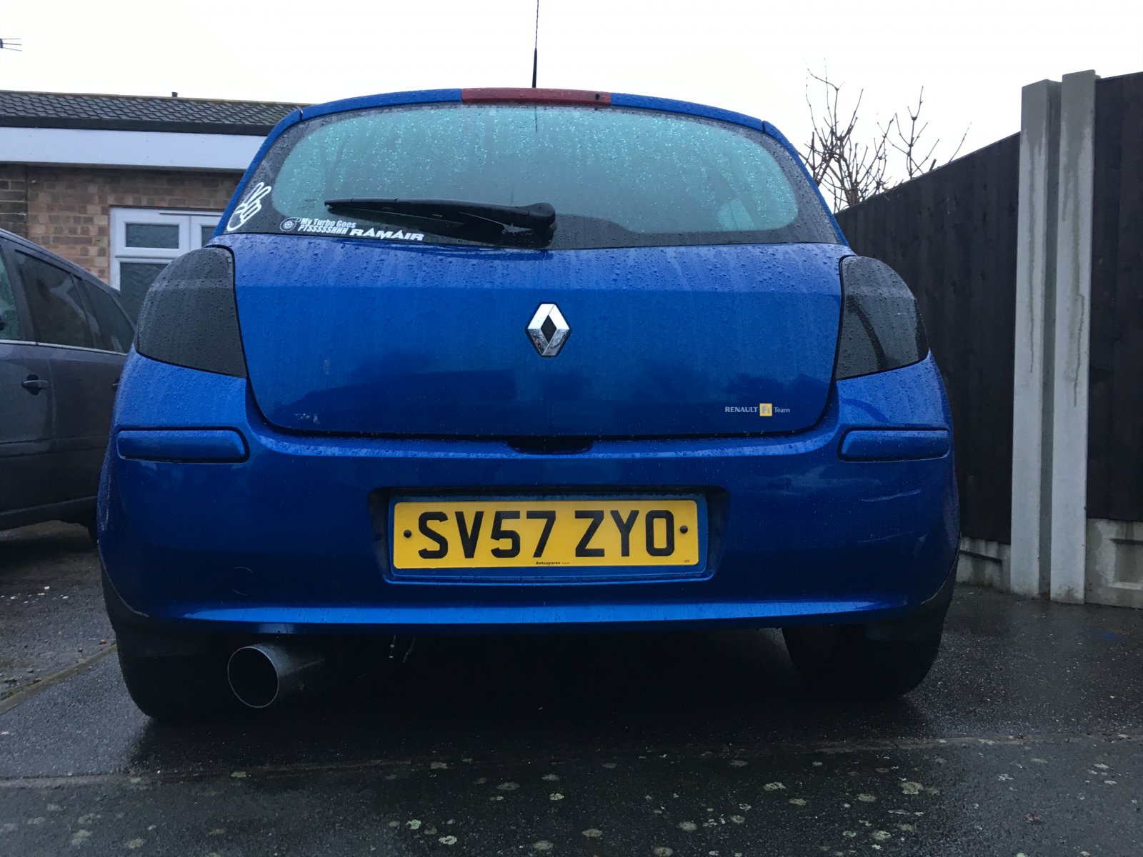

The only things I've done since November last year is buy some BOV blockers and fit an exhuast. Not overly impressed with the noise, I chopped off the backbox and it made no difference to sound, had to take off the middle silencer as well just to hear a bit of a grumble.

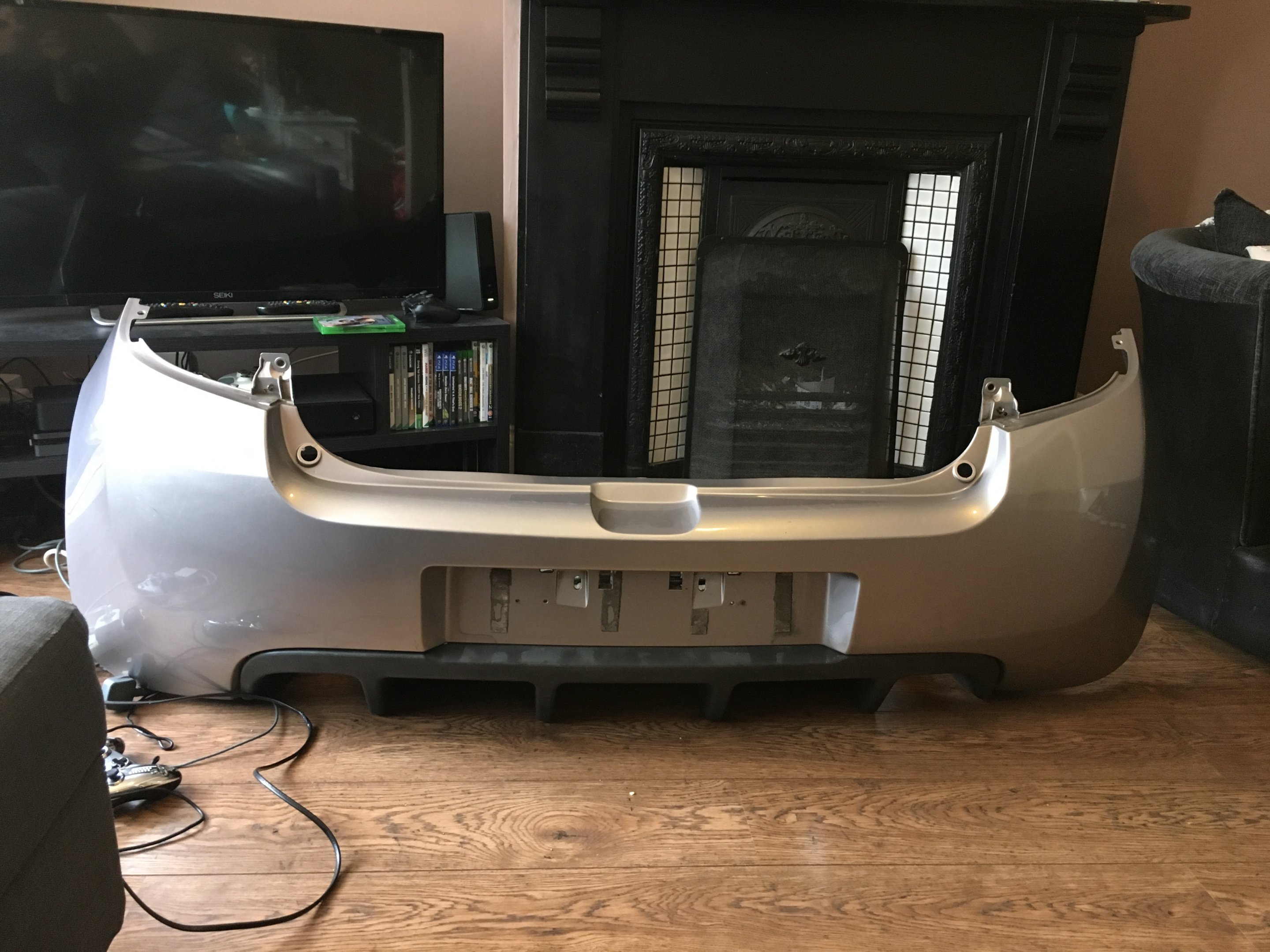

Update - not much it happening due to funds, but I have bought a Clio 197 rear bumper with diffuser

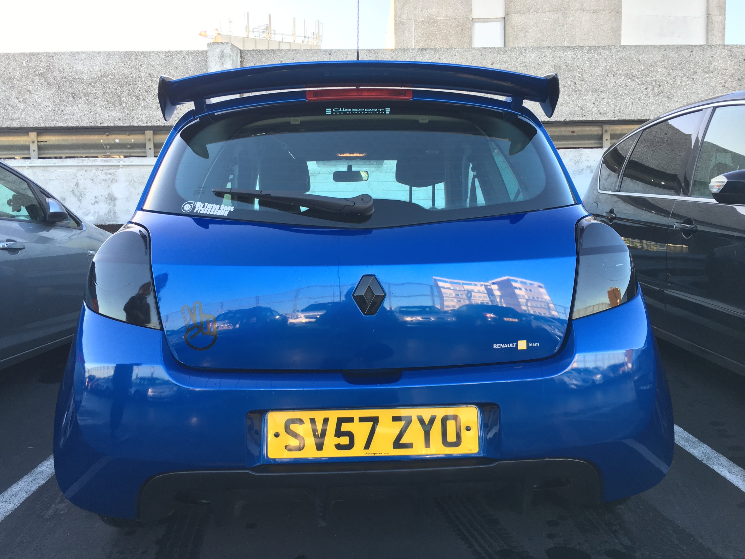

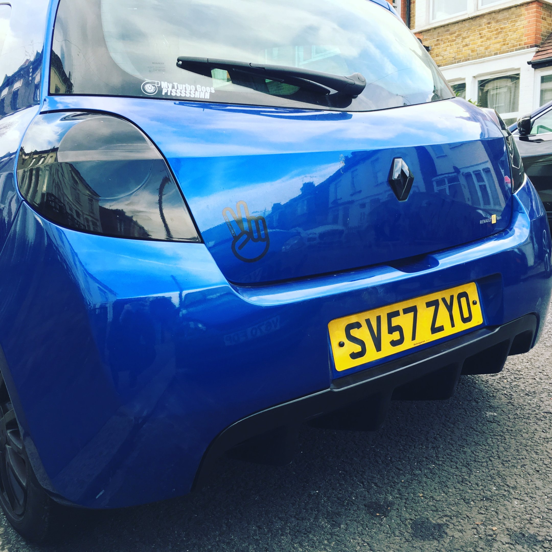

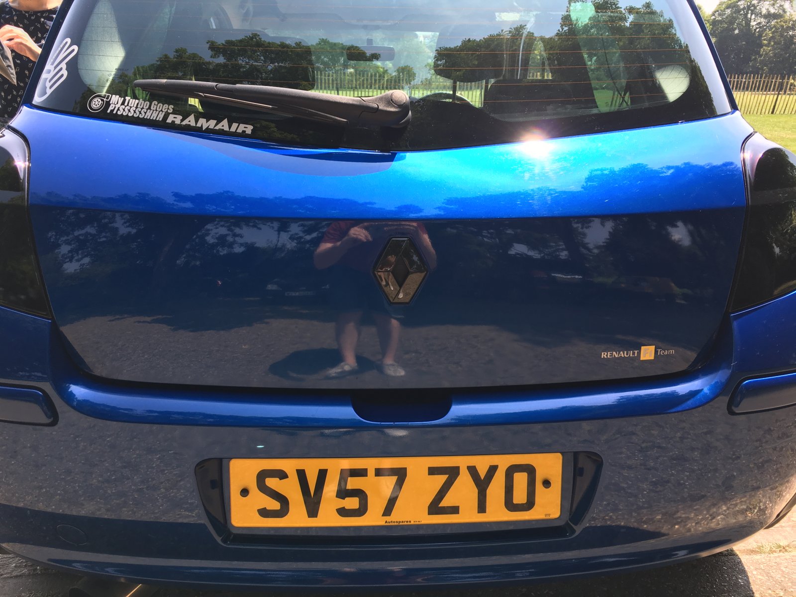

Finally, clio 197 rear bumper and diffuser are on.
It’s actually quiet a nice fit, no modifications required. The diffuser had to be cut slightly as it was dragging on the floor with no way of holding it up

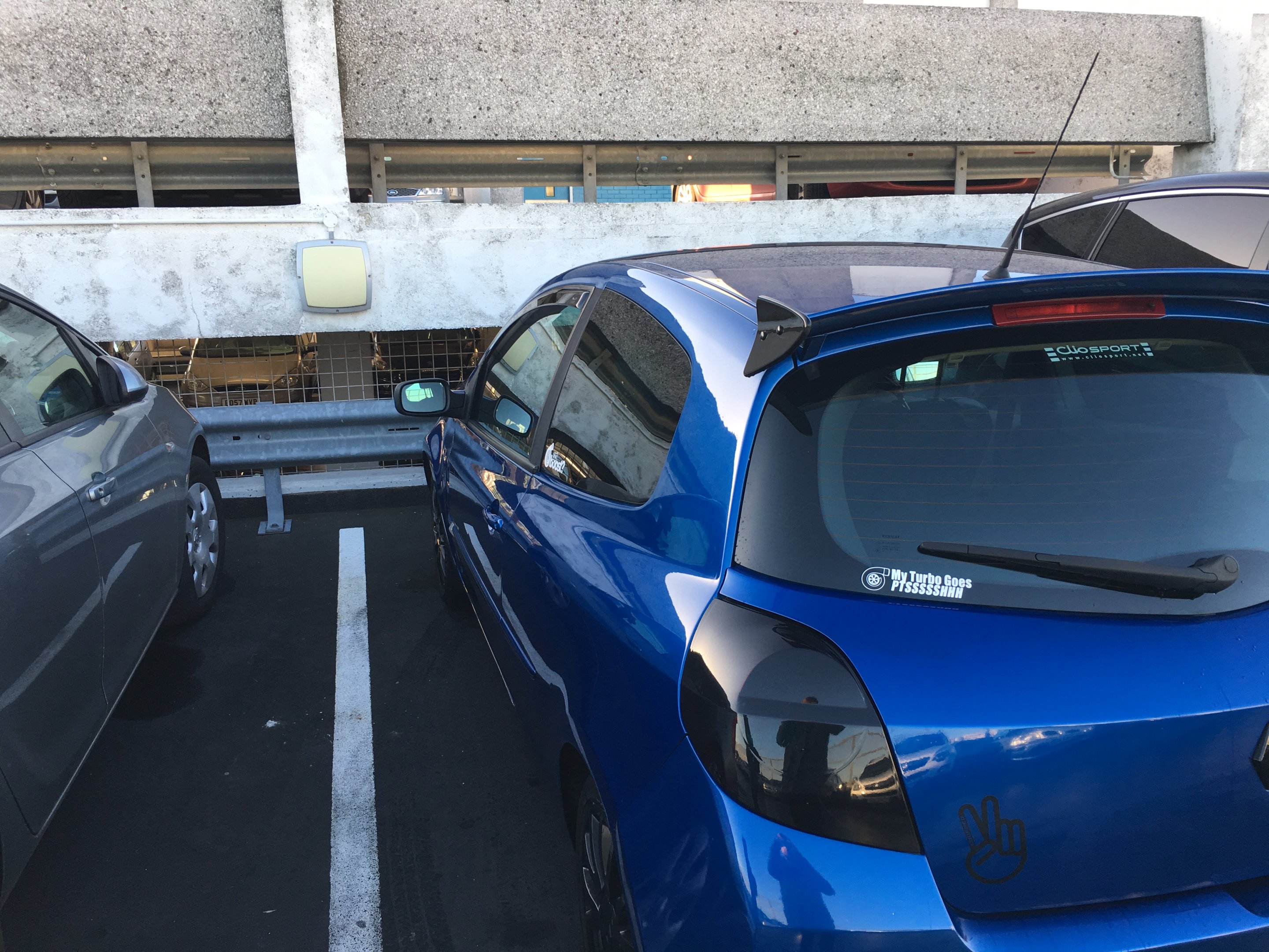

Cup spoiler will be on in 1-2 weeks hopefully !

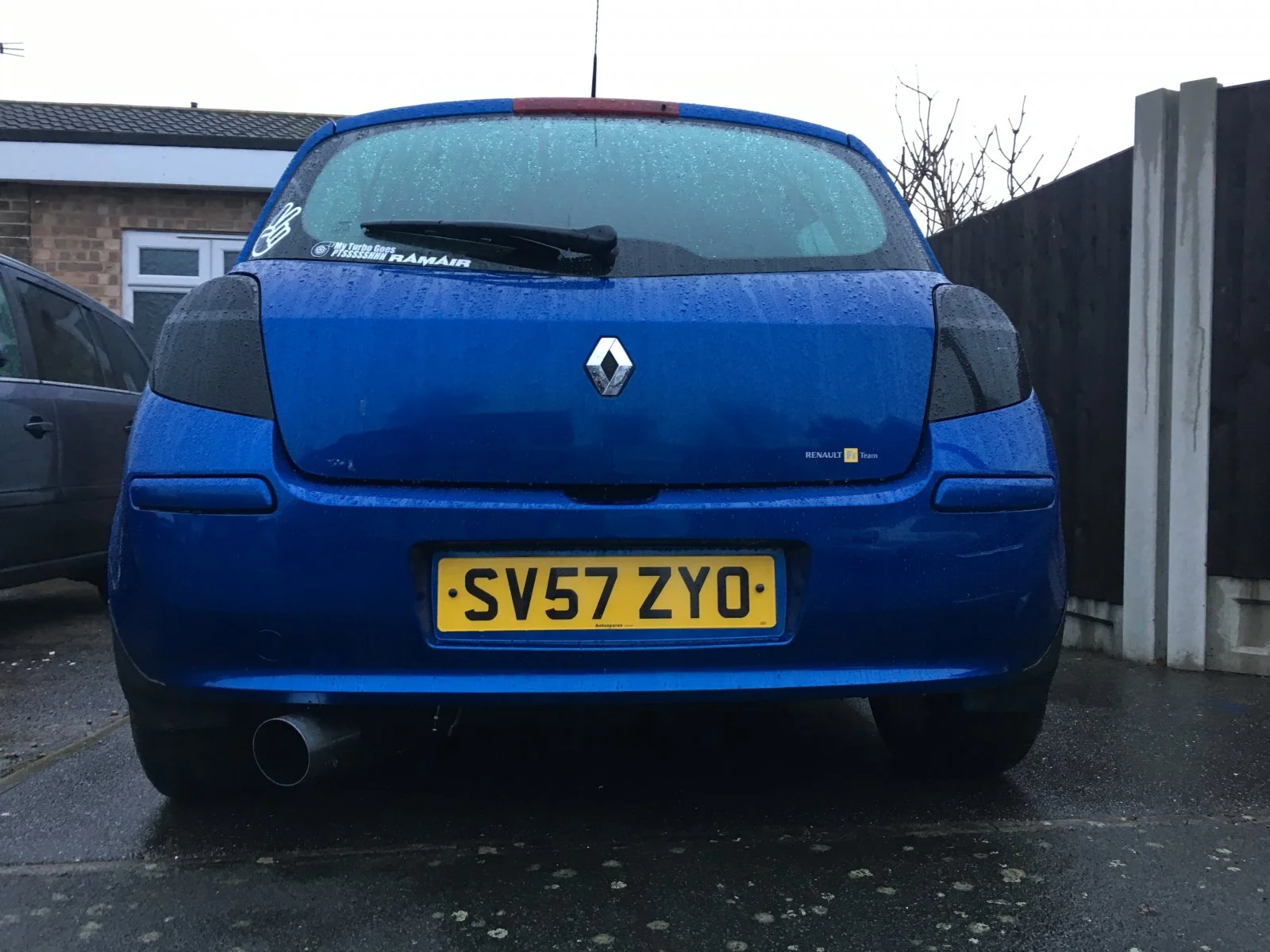

Here's an idea... Before you spend another penny on that car (including fuel), get some spacers or wider wheels on it. Rear bumper and wing look great but completely ruined by the wheels which sit about 7 feet inwards
If you took those horrible rear lights off this wouldn't even look too bad.
Bit harsh, but yeah lose the lights and the stickers as well...
Louis
I Park Like a C**t
Harsh but fair. Something so simple just ruins a nice car!
Already got the spacers just haven’t fit them as of yet, just got the spoiler on yesterday so didn’t have time to do them, when I do I’ll update. Thanks for the nice words though !
