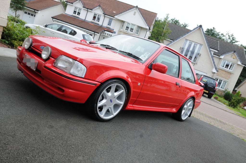

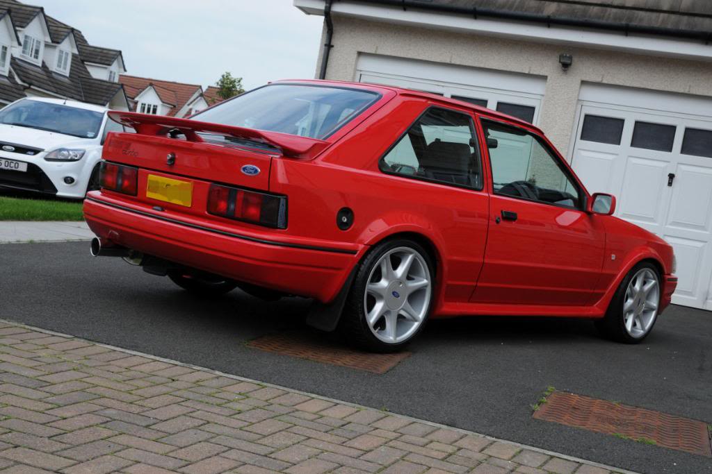

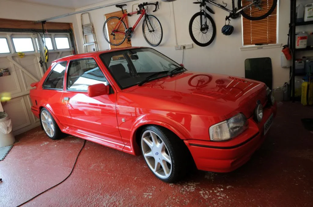

An old girl gets a spruce up and some well deserved TLC, step forward a 1990 Ford Escort RSturbo.

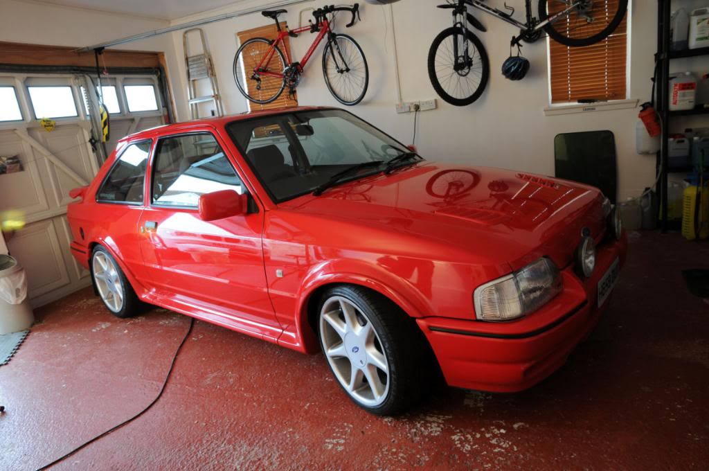

On arrival and doesnt she look clean?
Well yes, she does, from a few feet anyway. This car is in real good condition for a 1990 car make no mistake, but lets reserve judgement for a little longer.

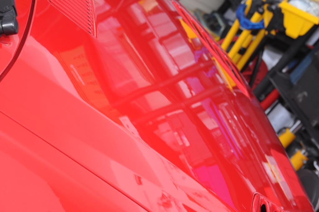

The car was treated to a full comprehensive safe wash and paintwork detox. Foamed with a ph neutral foam, left to dwell whilst the wheels got a little going over. The car was rinsed & wash with a MF mitt & rinsed. Tar & GLue remover applied, rinsed and then a mild clay bar used to remove bonded on contaminants. dryd over and left this:
Let the halogens reveal all, and i mean ALL!

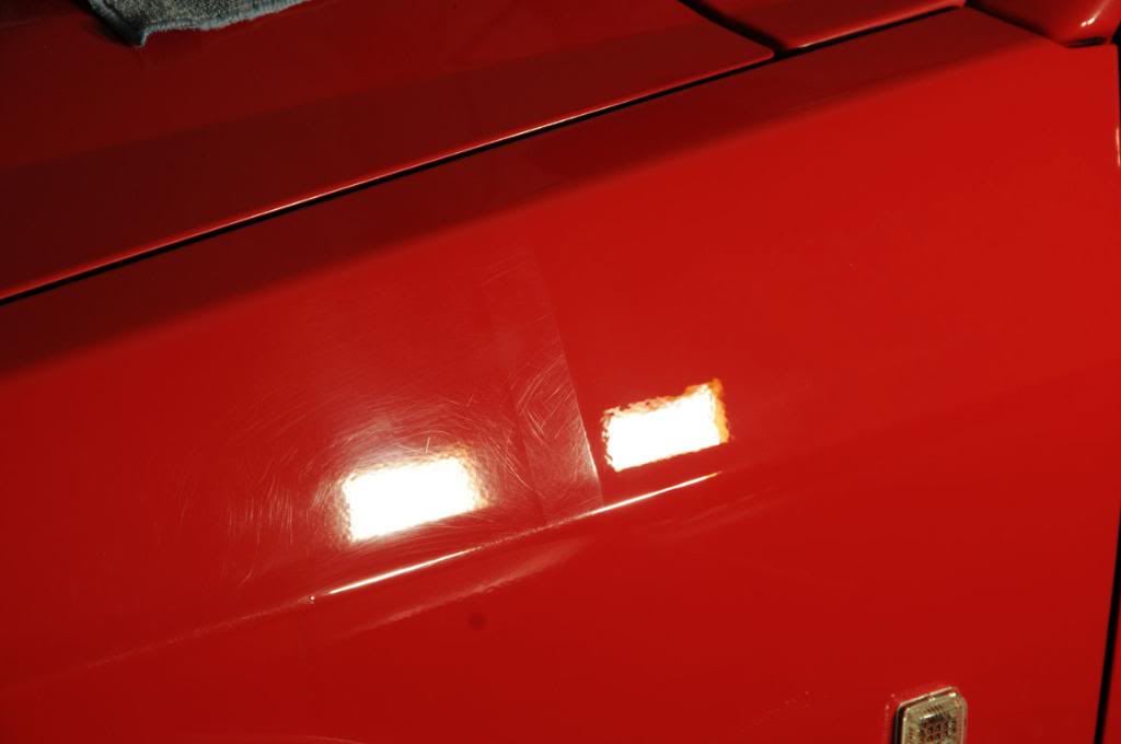

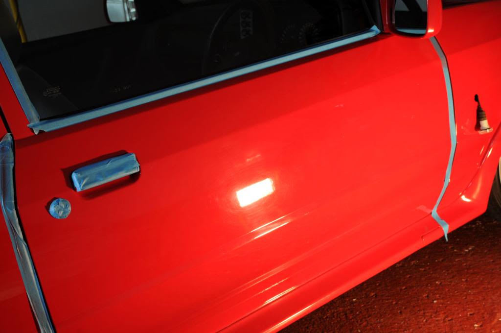

Drivers door:
Rear quarter:
Various:

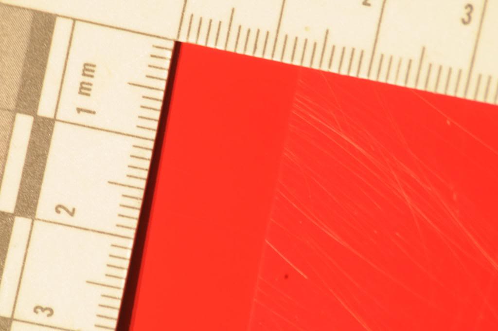

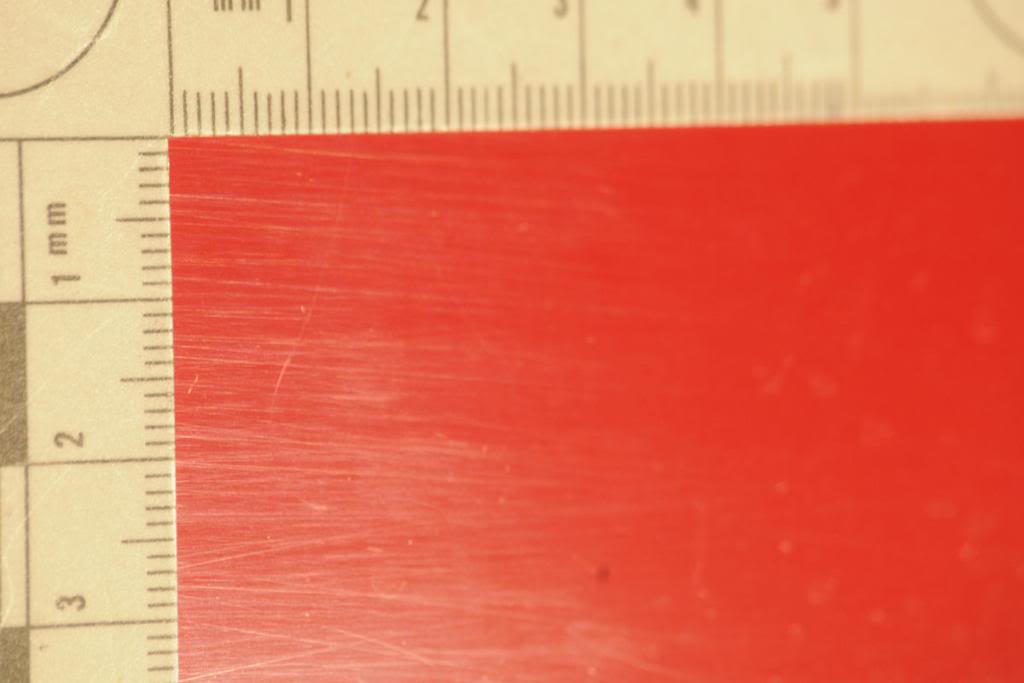

The paint thickness was measured :
and plotted to show what level of correction could be achieved and how aggressive I could be with polishing.

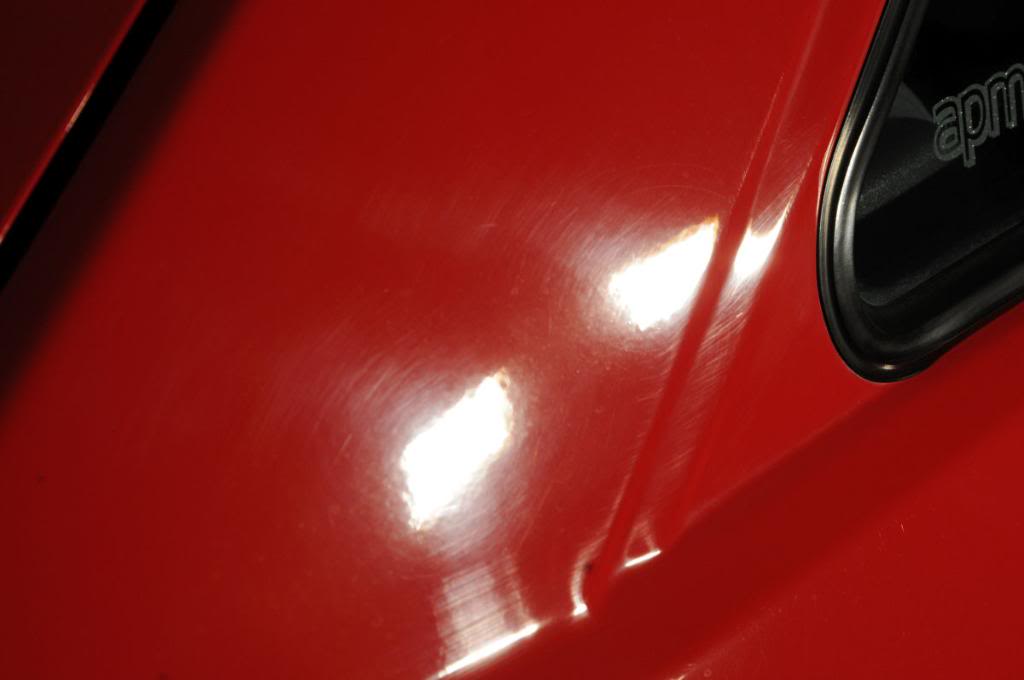

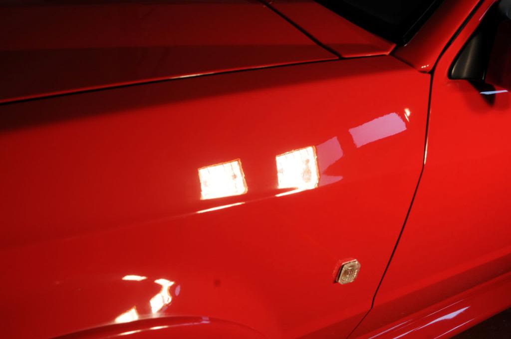

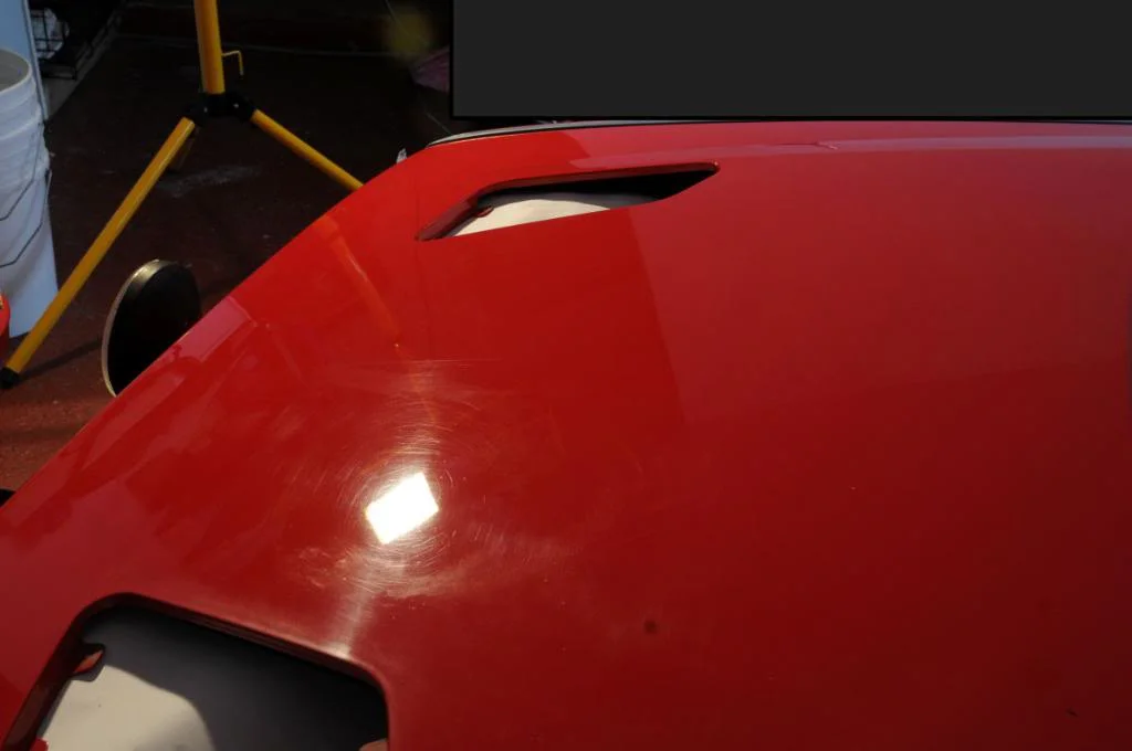

Front wing ready to try out polish n pad combinations
After a few passes of Menz 203

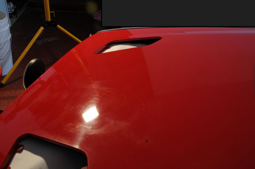

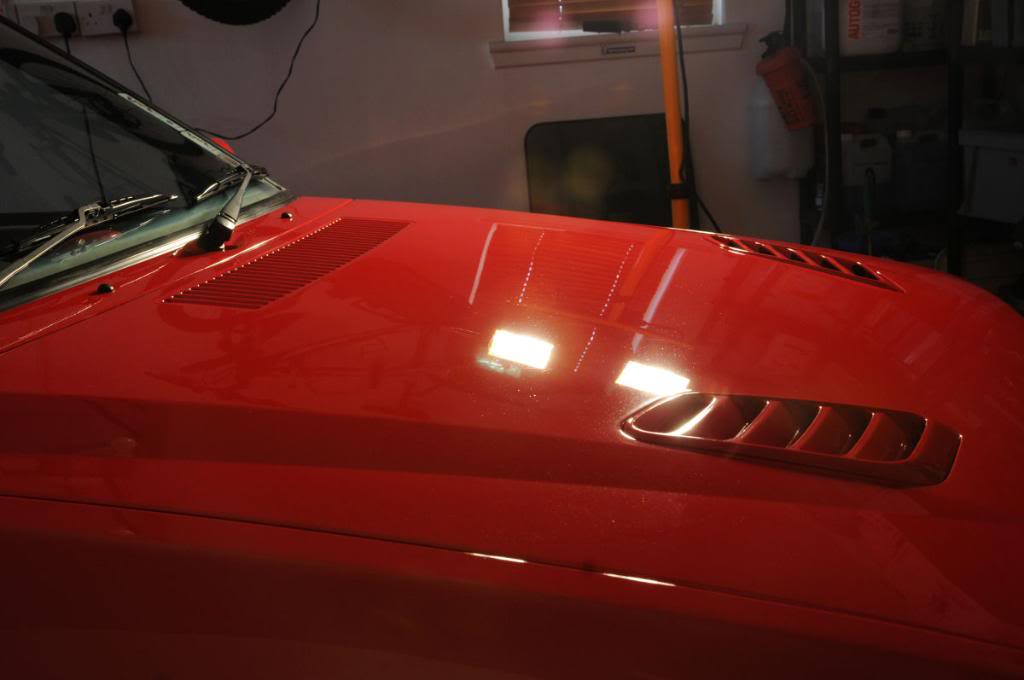

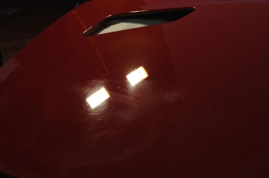

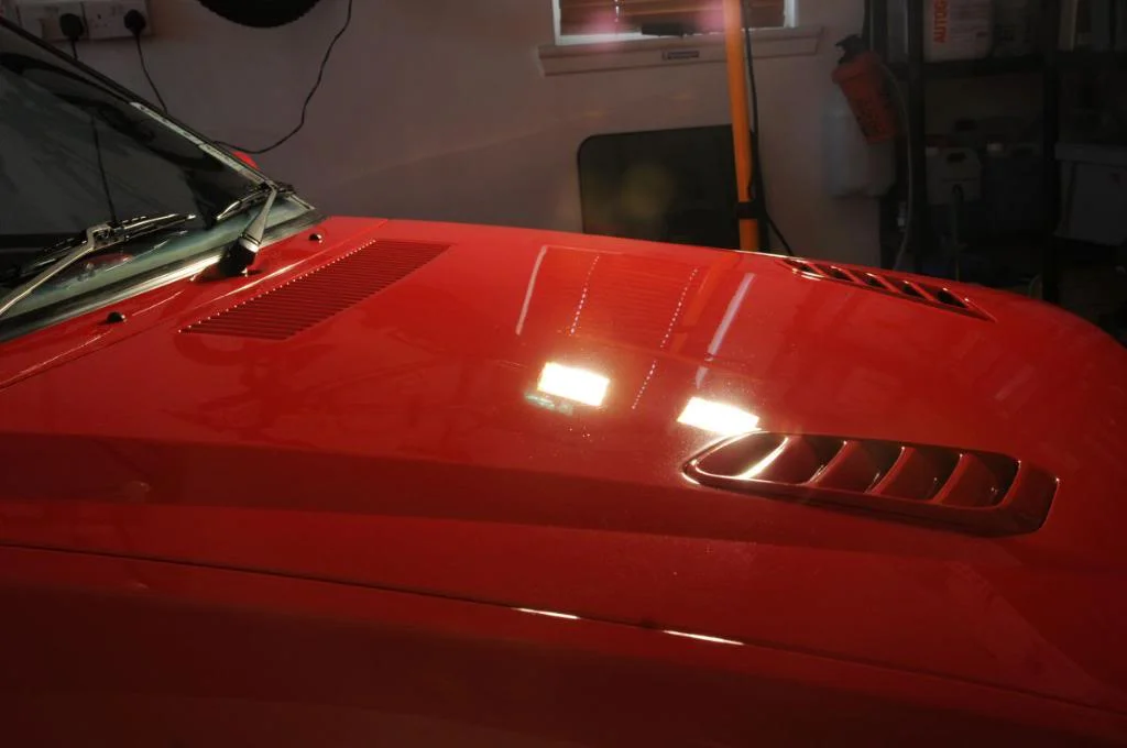

Bonnnet
Bonnet reflection
Makita rotary in action

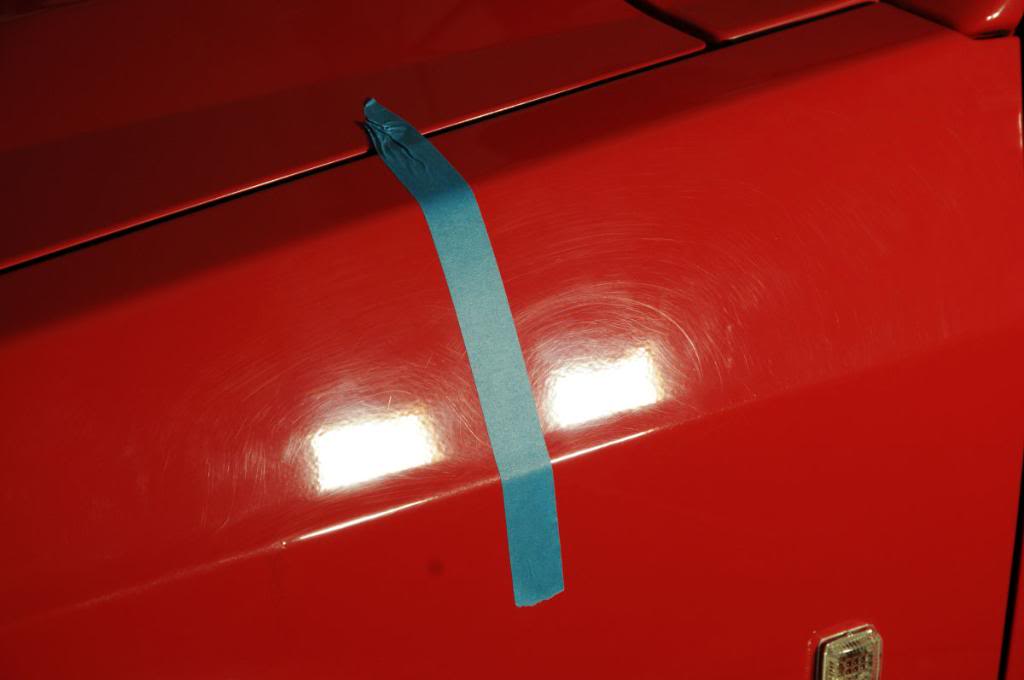

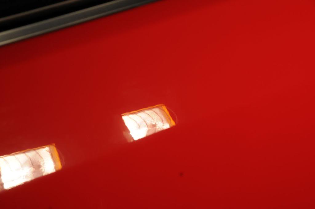

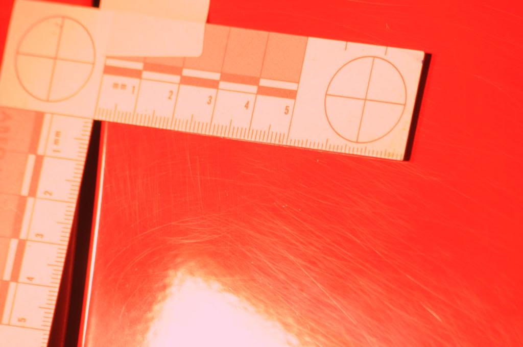

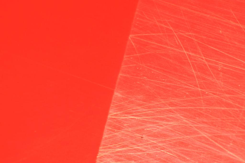

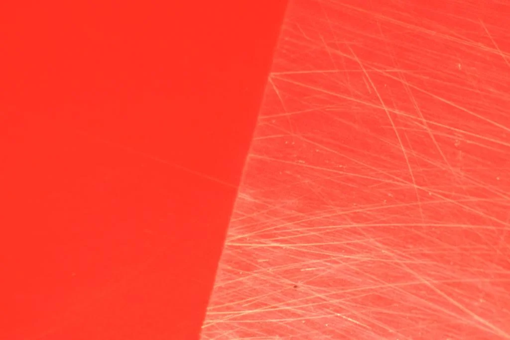

Some close up 50:50's

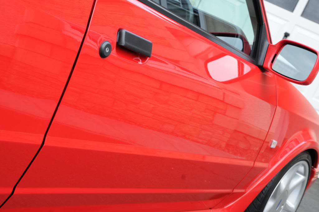

After polishing
The car had some pretty major defects, most of which were addressed with a variety of polishes. Menzerna 203, 85RD,Dodo LimePrime & some 3M products made an appearance also.

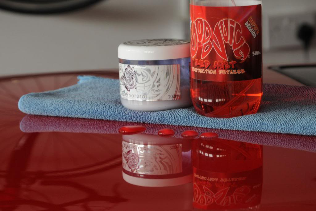

Clearcote Red Moose glaze was then applied by Da polisher, this has almost zero cut and is purely adding "bling" (did i really just type that?) to the finish.

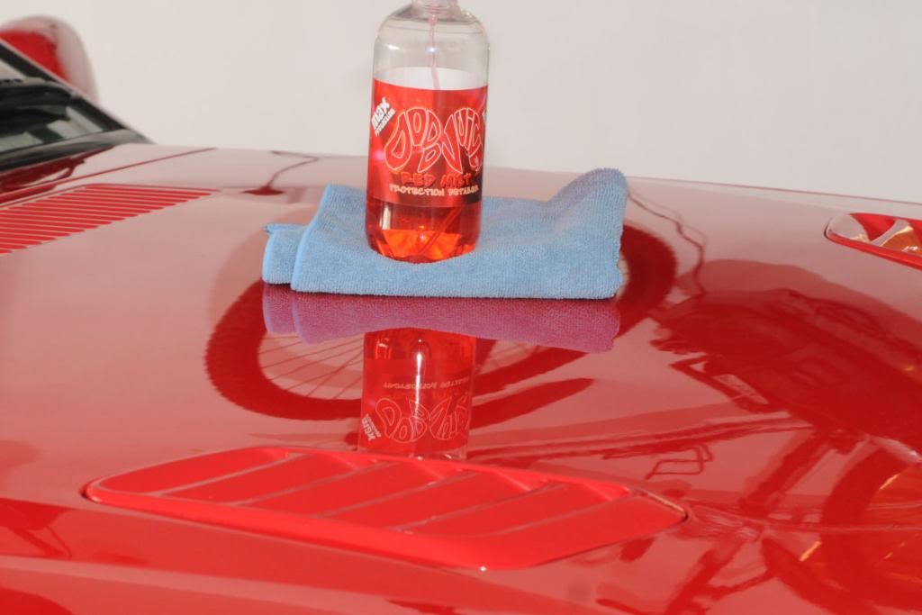

The car would be protected by hand application of Dodo Supernatural wax and topped off after curing time with Dodo Red mist.

Exhaust & Dumpvalve are the only mods under the engine and the suspension is running a Koni set up.
Very nice, what are the wheels off?
The Wheels Are Ford Softline RS7's and im not sure what they where on as standard as there is loads of Saff coswroths with them on aswell as escort GTi's and RS2000's
