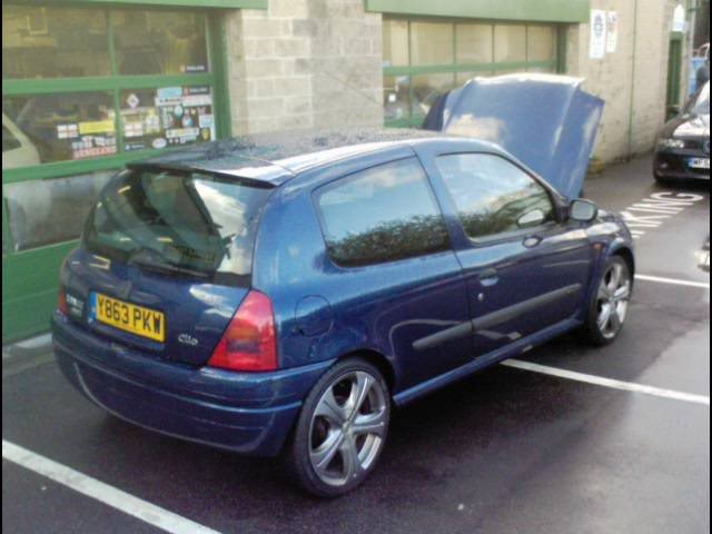

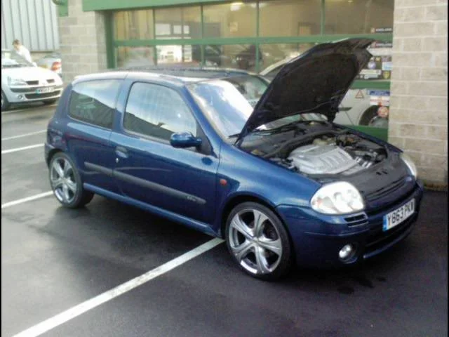

A few of you know i saw a 2001 Y plate 172 with 58k on the clock for sale for £3395.
I went to look at it today, and it looks ok, few minor bits like a bit of a nick on the rear of the drivers seat, and wtf is with the steering wheel?! Its all minging, it leaves your hands black!
It looks like this:
Theres also no history with it, but receipts for work done, and no history of a cambelt change?
How hard are these belts to do, im a mechanic, and at what interval?
They said they'll put 12 months MOT on it, and sort the airbag light out (its on)
Should i or shouldn't i?!

If its straight its a good deal, the wheels however make me think its been ragged. If I was in the market I would spend a little bit more for an enthusiast owned original example, but I usually get ripped off!

for the money you won't get better or faster shall I say. However, the problems seem minor to fix so it's your call. You need some standard alloys too, those on it are absolute bilge!!!

£450 for a new set from renault plus £250 for tyres to go with them.
  182 FF
Gotta agree, the wheels look terrible, but they'll fetch money on e-bay.

Dont worry, the wheels will be the first thing to go!! The ride is terrible! New tyres on them mind, so should make enough money to buy some standards!
The exhaust is a full new system, standard too, and its got new brakes on. Checked air con too, freezing cold, and i started it up from cold and no smoking, then when it was warm i took it for a good drive along long staight rds, and bends, and it pulled and went round no problems
The lack of history doesnt really bother me, its been serviced im sure, just no book. If i got it anyhu, id give it a full overhaul, oil, new belts, pulleys, filters, brake fluid, coolant the works. I know working in the trade that cars that havent got a visible history are normally bargains, because people want history!
