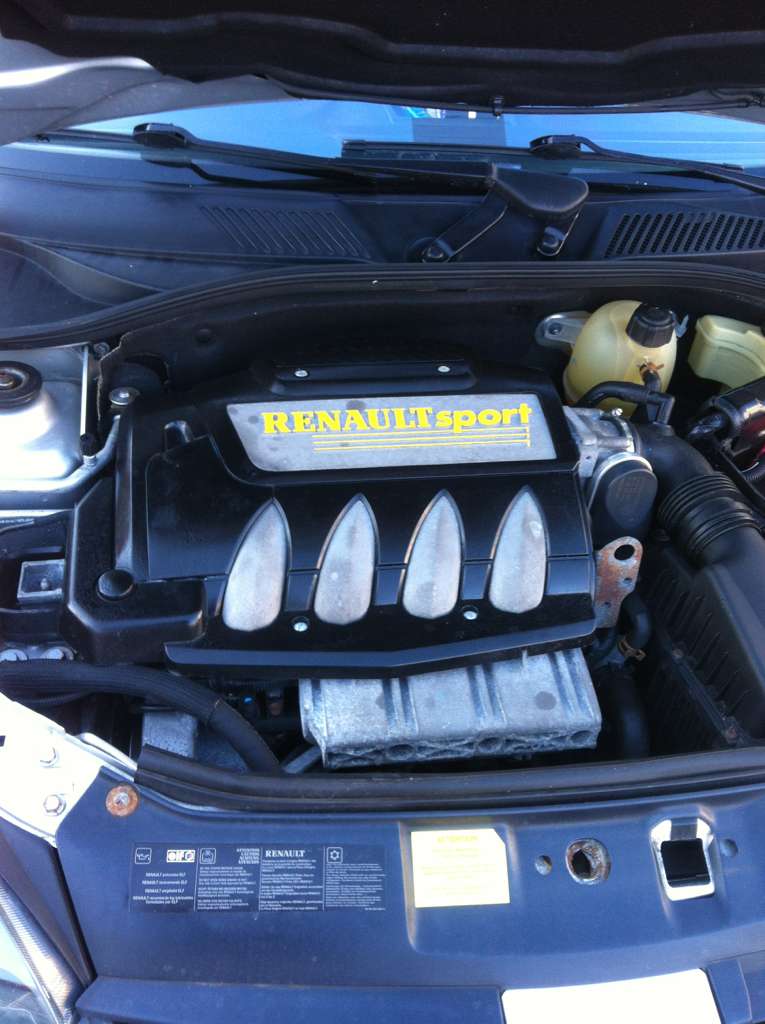

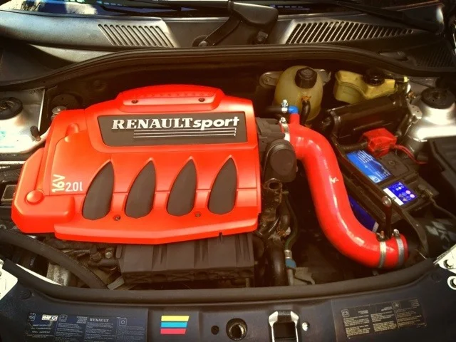

Custom made battery cover and sparyed parts.
Sunglasses_Ron
ClioSport Admin
Put it up Jared.
To be honest it didn't exactly cost a fortune to get mine looking like that.
Fifty knicker for the engine cover to be sprayed, about a score for the battery cover and a few quid for some rattle cans.
Cub.

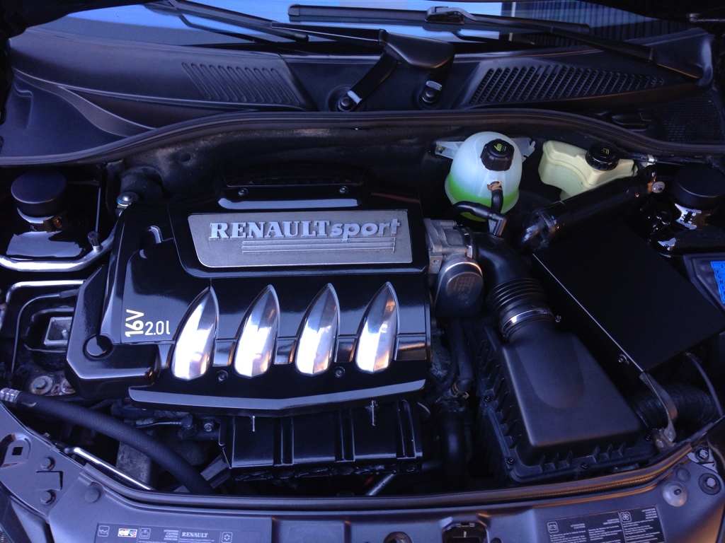

I really need to sort my engine bay out. Going to do it when the engine is out for the rebuild. Love yours RDR.
What do people do to spray the inlets but leave the Renaultsport logo standard or even spray it a different colour?
Sunglasses_Ron
ClioSport Admin
For silver lettering just spray it all then sand the letters back to silver with sanding block (that's what I did).
To do the letters a different colour is a bit more complicated. Apparently you spray the letters first and give it a good coat of lacquer. Then spray the whole cover and before coating it in all in lacquer you use some paint stripper lightly rubbed on the letters to reveal the coloured paint. Then lacquer the whole thing.
I think that's how it was explained to me lol

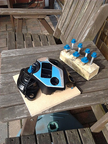

Tel you lot something, polishing the metal parts to look like chrome is a pitta. Spent most of today doing a few boost pipes and an engine mount....
** pics to follow later on *
  BG FF 182

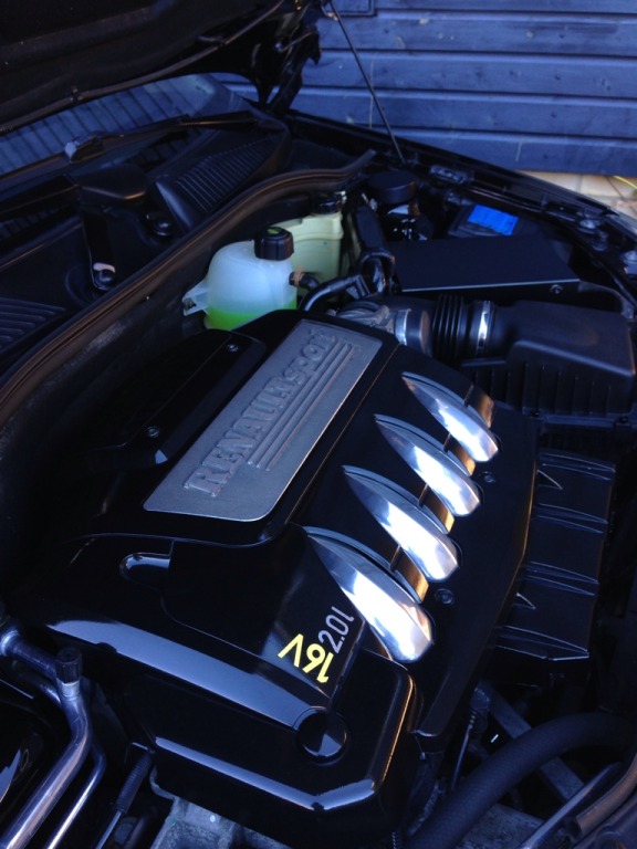

My inlet took me 8 & a half hours lol never again! Worth it though!

Lol you'd never do it by hand, like I said it took me 8 hours with machines.
Still could do more too!
Ahhhhhhhhh s**t just the grinder with sand paper and a good polish with it ?
do most of it by drill or grinder, then hand sand it to make it a good finish. after all that work through the polishing wheels and compounds to make it shiney :)
i started off with 120-240-320-400-600-800- and finishede on 1000 wet and dry. could of got it to look better but IMO the 1000grit sanding marks are nice when polished
Dr HMS Derv Destroyer
  MK1DTi/vivaro/corsa
i got a kit from halfords , something like £16 without the trade card. did the job.
hard metal polishing kit. the do a soft but it comes with less stuff.
hard polishing wheel with black hard cutting compound
medium polishing wheel ( wool rag type thing ) WITH RED/PINK polishing compund
and light finishing wheel ( wool rag type thing ) with blue finishing compound.
there are better kits out there but I CBA to wait lol
