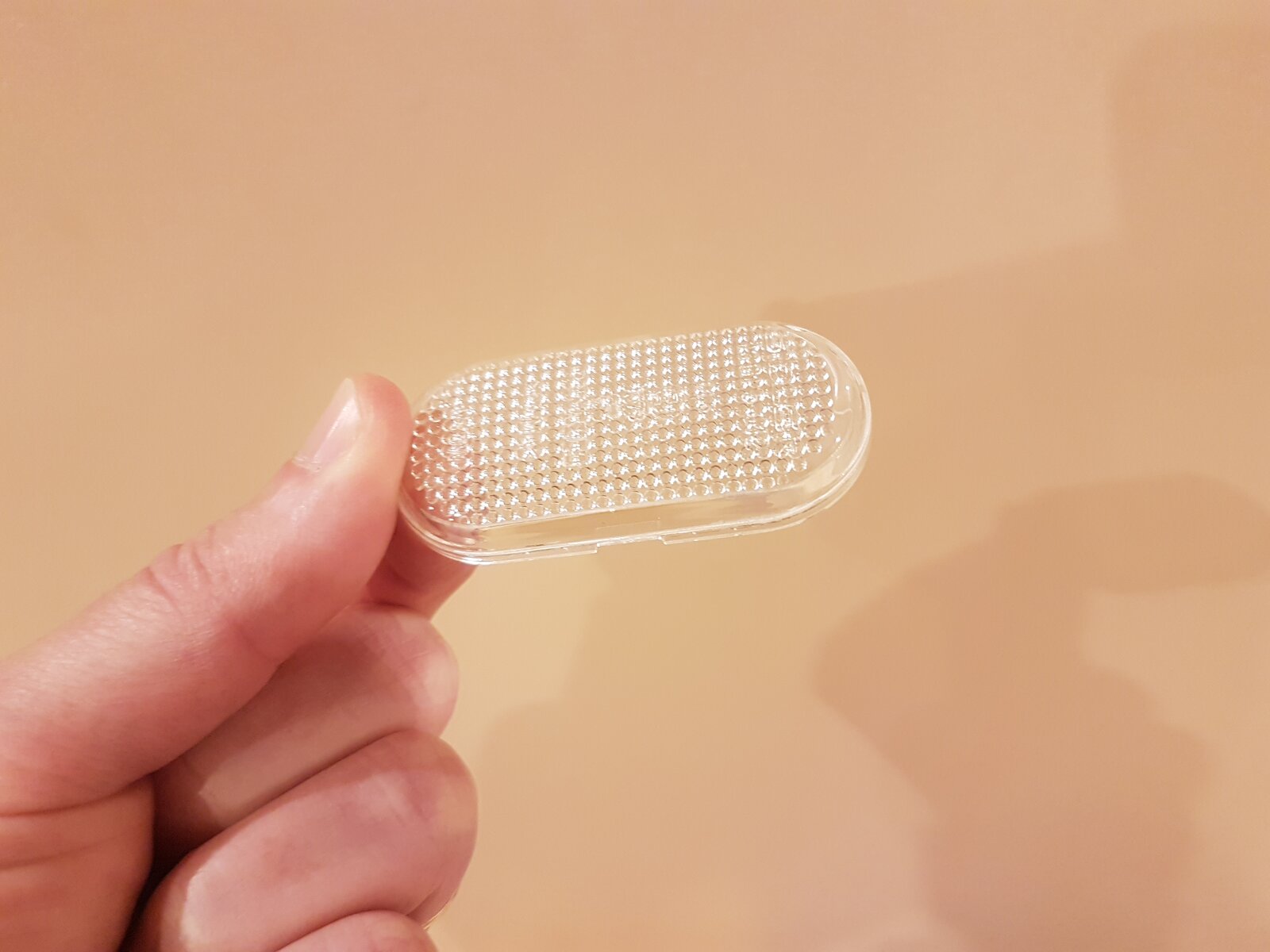

Quick question, I'm probably being thick but how do the lenses go back on?? One of them fell off and it won't 'click' back into place.
Are these glued? Other side seems loose and just held in by accumulated dirt as well whereas the side repeaters on my other Clio are solid and won't move at all!

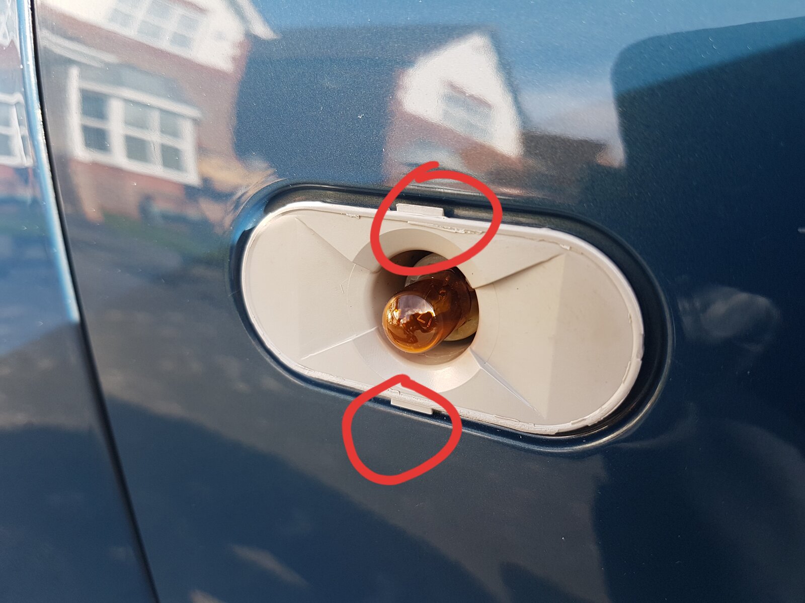

2 tiny little clips on them mate
They break all the time when spackers try and pry them off without pushing the 2 tabs from behind the wing

Put my Corona suit on and got some superglue, should be fine, hope they're sealed now though as I don't think I'll get them off for cleaning in one piece again!
