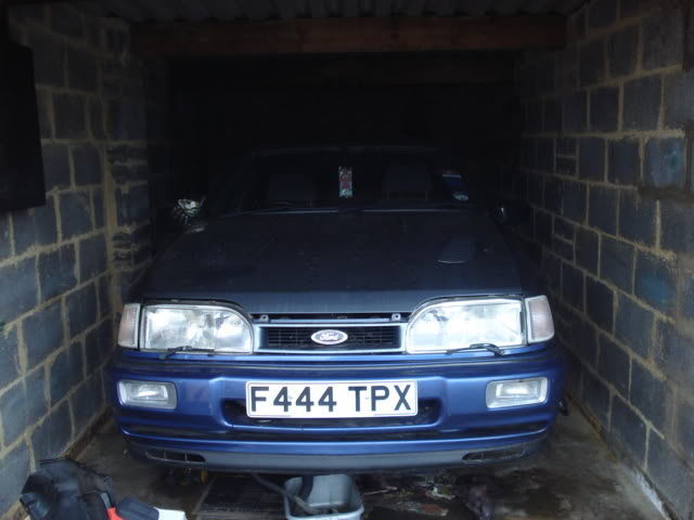

A quick introduction - We got the car in mid September 2010 from Ben's dad who had owned it for 10 years. Unfortunately it sat far lower in his priority list as he has a mk3 Capri 3.0S to restore. This resulted in the poor Sierra, which when he first bought it was in near perfect condition, being left to stand for an amazing 8 years!

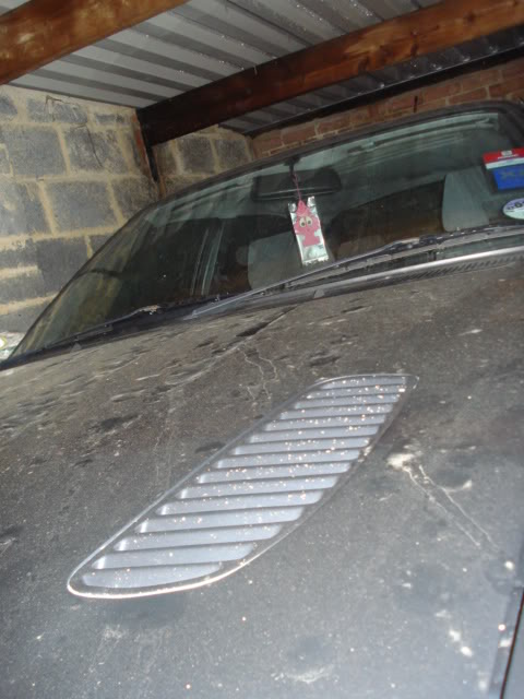

As can be seen the car is a pretty sorry state atm, but below the dirt and rust we can see the potential :D...

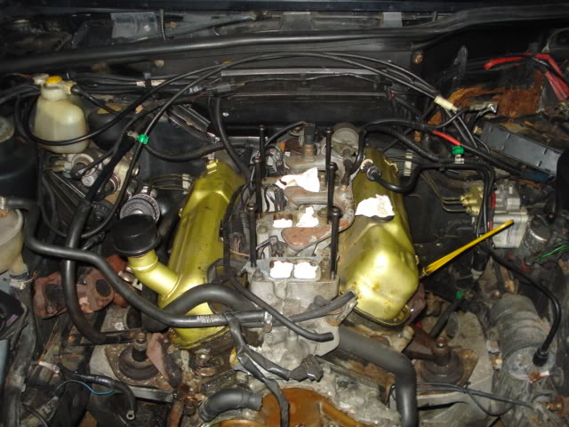

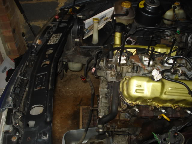

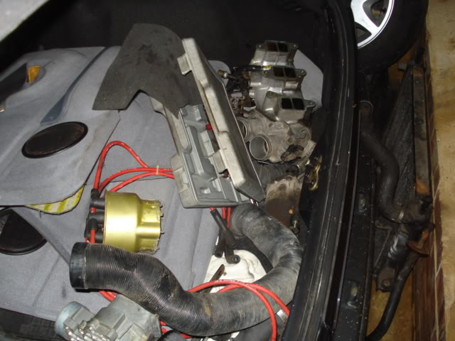

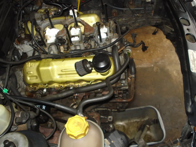

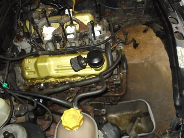

Upon opening the bonnet, we found the remains of a once proud 2.9 12v Cologne V6 lump, incomplete with exhaust manifolds, inlet manifold, throttle body, air filter, radiator, fan, alternator, water pump and all associated brackets and belts:
These item were finally located in the boot
It took a day alone to inspect the engine bay and identify what work needed doing along with a sorting out a list of missing parts.

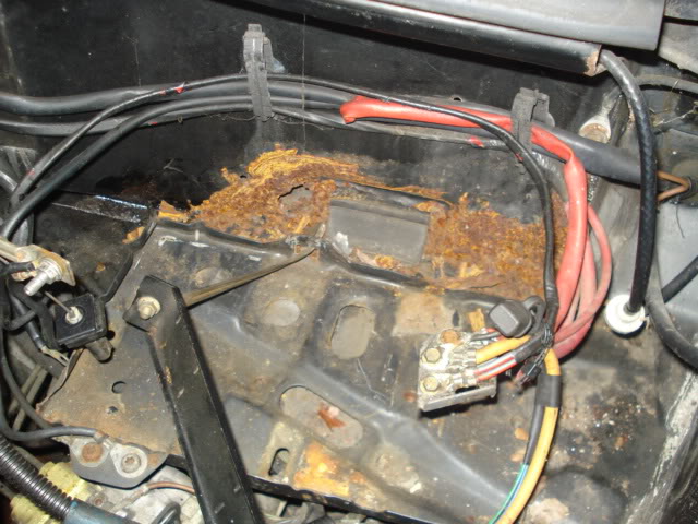

Completely rusted battery tray:

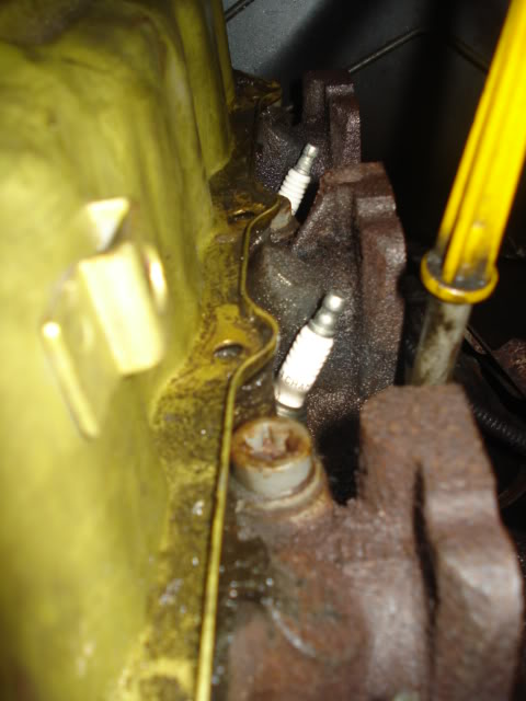

Leaking rocker covers:

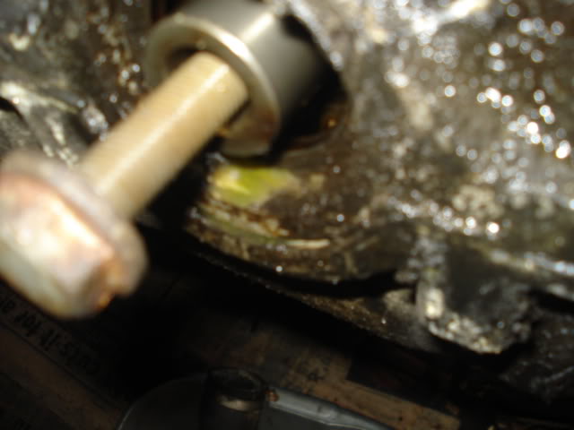

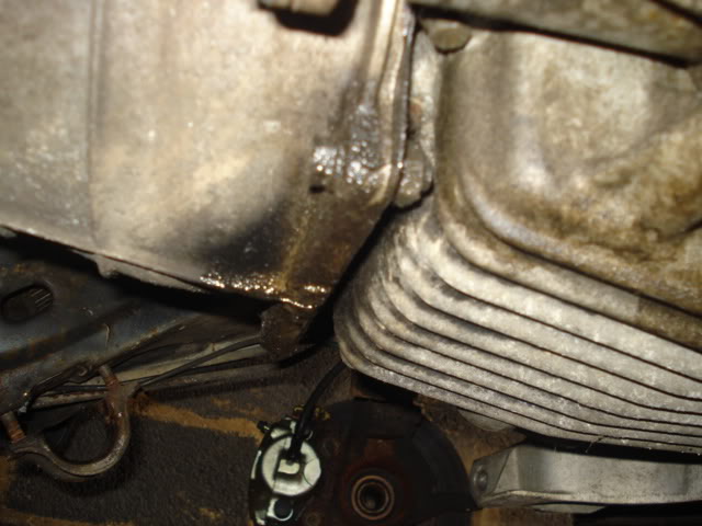

Front crank seal leaking:
As is the rear, requiring engine and flywheel to be removed to replace:

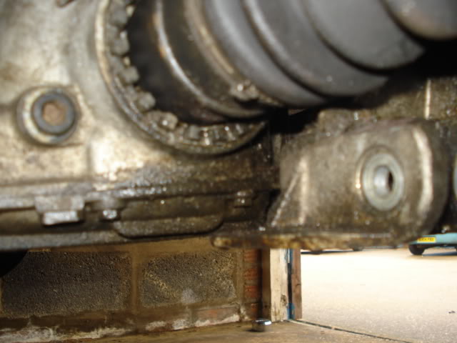

Front diff leaking from both driveshafts:

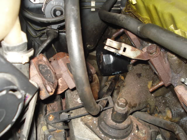

A small bit of luck though, we found one of the AWOL exhaust manifolds, albeit removed, sitting between the block and the inner wing, wedged in place naturally:

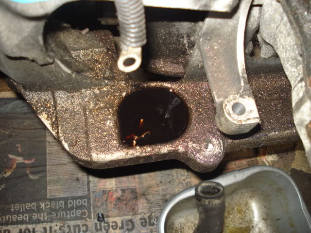

1) Sump gasket replacement.

5) Sort out a bad patch of rust on battery tray.

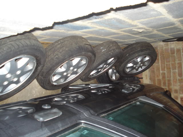

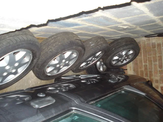

Firstly the out dated wheels came off, as fashionable as they were 10 years ago - in todays age they dont exactly compliment the cars classic personality anymore:
A local Sierra performance specialist sorted us out with a set of wheels similar to what the car came with, as we've decided to go for an OEM+ appearance. £40 for a set of 5 with barely used tyres, bargain!

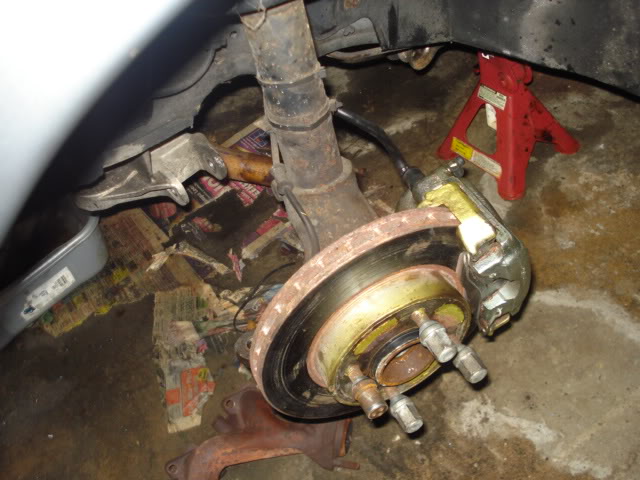

So now to concentrate on the front suspension and brakes. Another bit of good luck when the wheels were removed we found that the front calipers had very recently been changed for brand new ones which is a relief on a car that is prone to calipers seizing! Having said that the discs have seen better days:

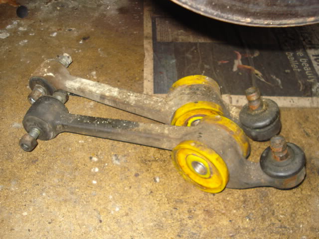

Both track control arm ball joints need replacing:

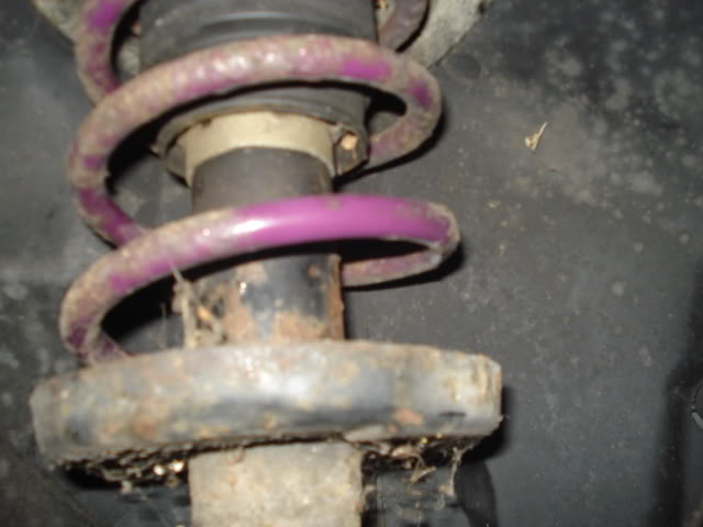

It looks as though the suspension has had lowering springs fitted sometime in its vast past but the plan is to put entirely new spax suspension in:
Basically all bushes, mounts and joints need replacing in the suspension and ARB components.

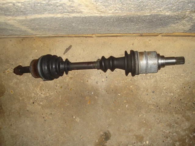

Driveshafts both had split outer gaitors, managed to get a new pair off ebay and replaced them:

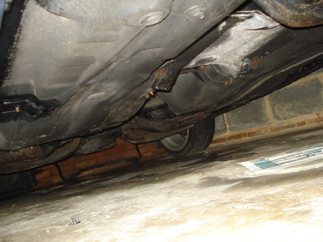

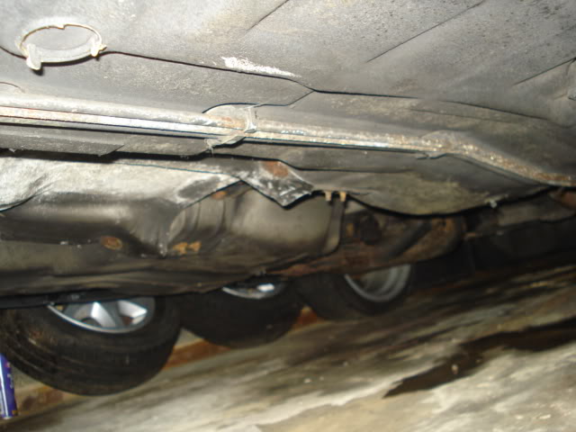

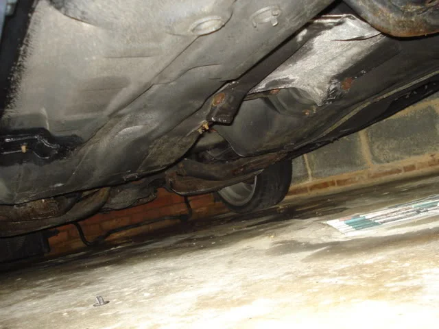

Whilst under there a quick survey of the rear of the car showed the challenges that lay ahead.
Exhaust system completely missing!

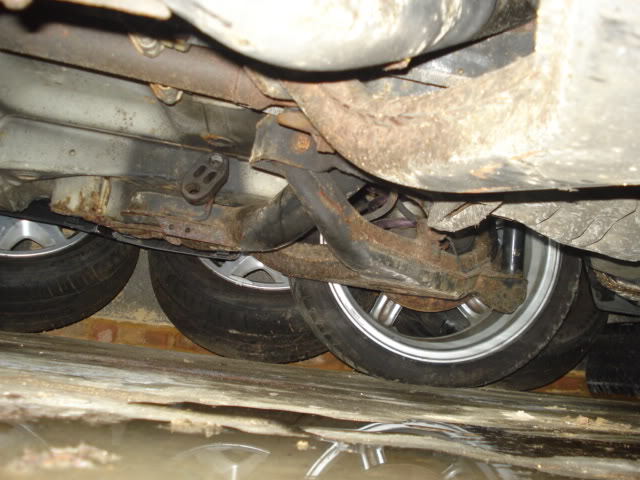

Rear diff and suspension looking tired, didn't want to probe any further for fear that we'd find problems more specific:

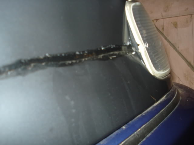

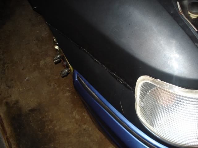

And obviously the bodywork requires major money spent on it. Front bumper and grill are different colours and whilst in storage it got caught by a reversing van on the wing :S

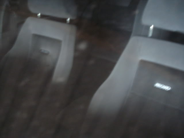

Good news? Yes there is something to keep us going with this money pit, the interior is spotless and from a cosworth variant, that being Recaro seats, upholstery and doorcards :D

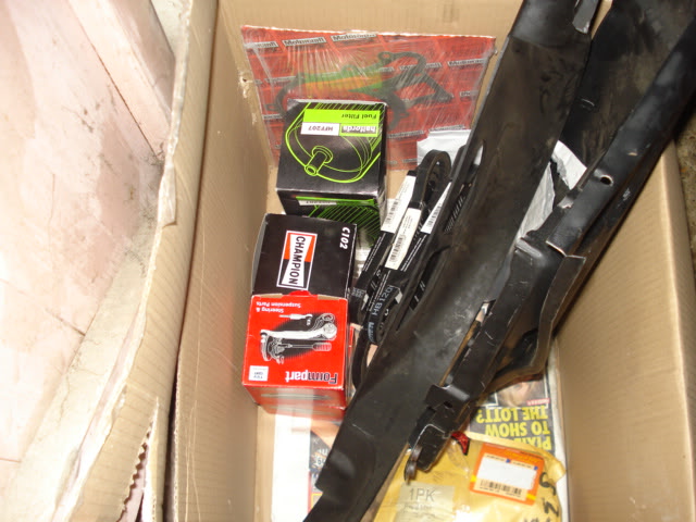

Ben's dad popped over with a few bits he'd been collecting for the car aswell, but not as much as we'd hoped for, mainly service parts :(
But better than nothing of course!

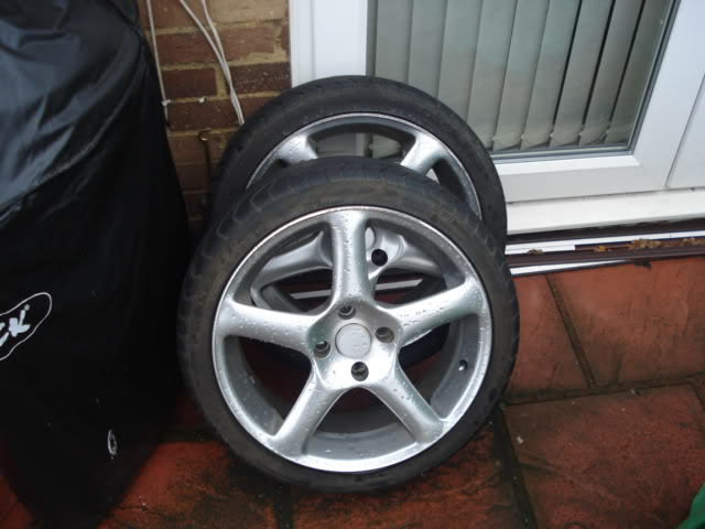

On a better note...won a bargain bid on eBay for a set of these yesterday so plans for the wheels have changed...:cool:
