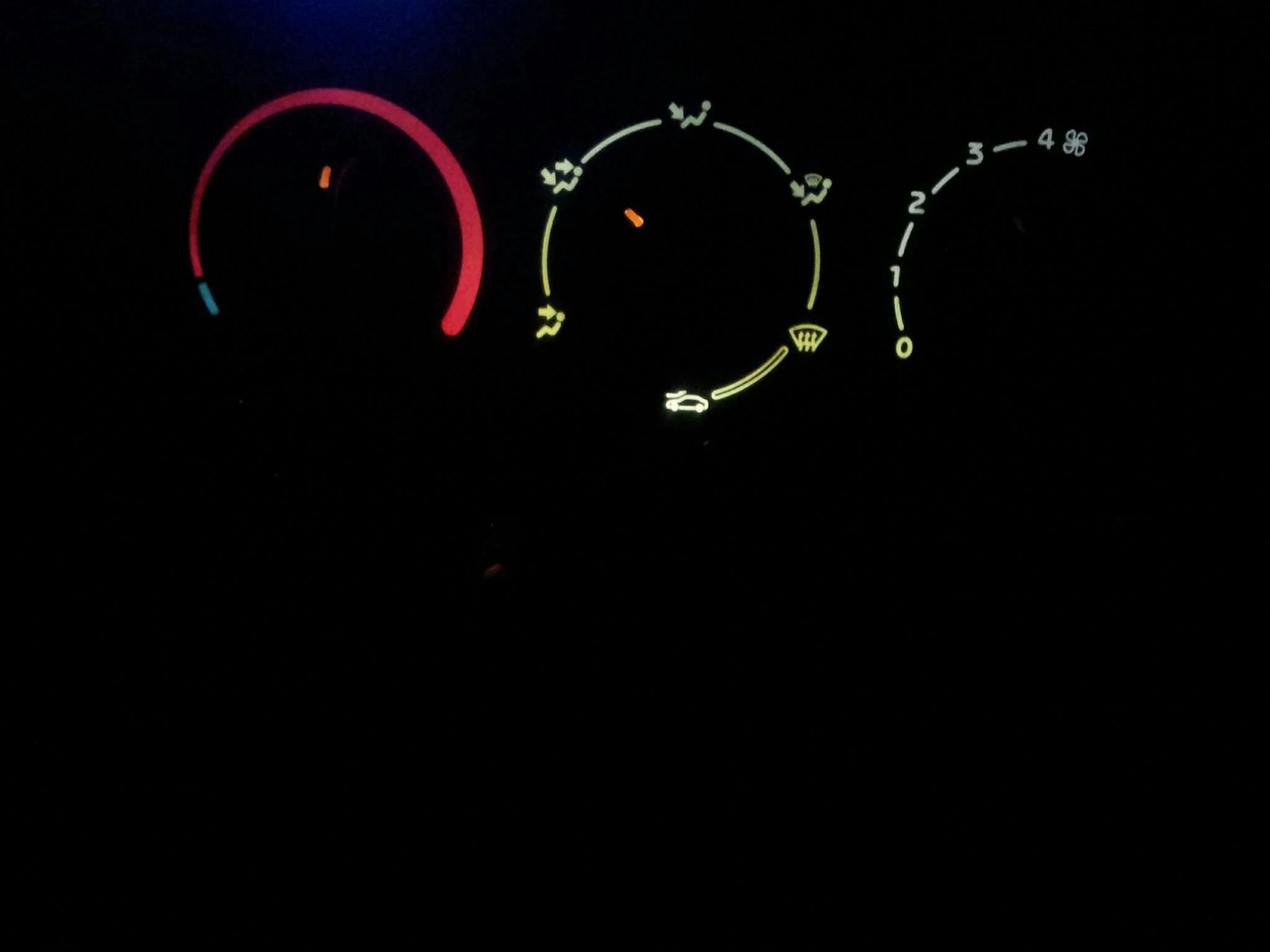

I had to salvage a glovebox switch then ordered waterproof a reel of SMD strip lights - really happy with it.
I also used this for the heater panel

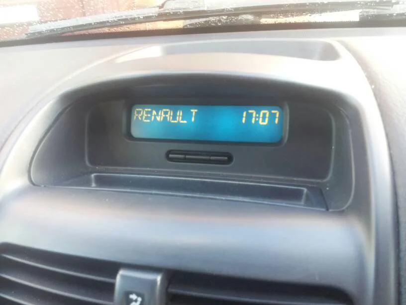

Next thing on my list is to do the centre clock LCD.
Now all interior is finished with LCD done.

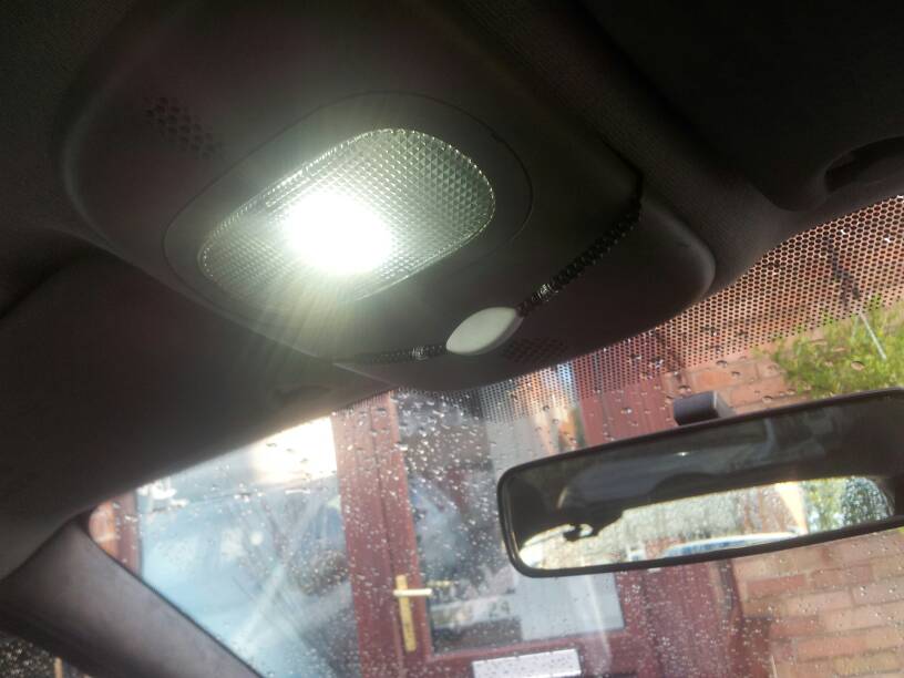

Also made a rectified interior light

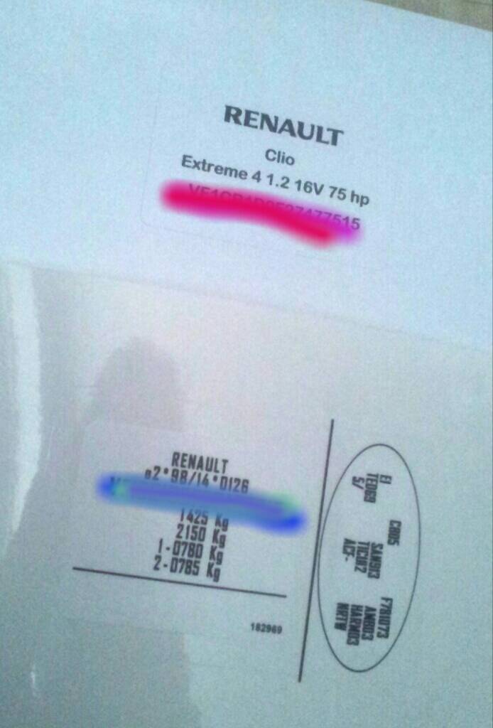

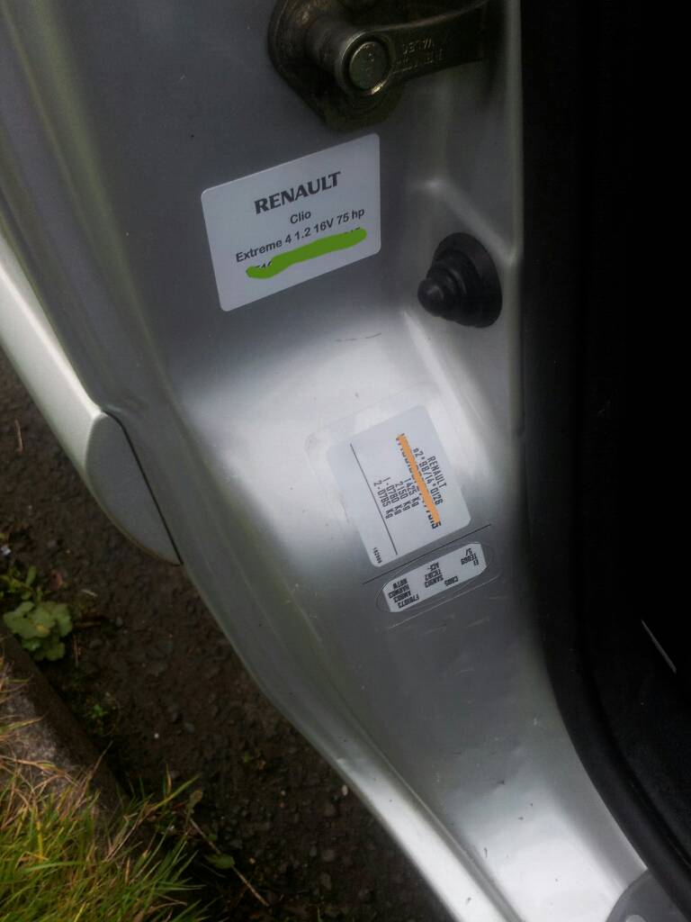

I was after replacing the oval plate and vin sticker as mine were non-existent.
So I created a template to use with Photoshop then finally I have had them printed.
Now fitted.

Did you use SMDs for the whole conversion? or did you swap the LEDs like for like? I know the dial ones are tiny, but I can't remember the name of them.
Looks really nice, especially the dash :D
Thanks :)
I used SMDs for the dash, LEDs for buttons and window switches and SMD strip for glovebox and heater panel.
The tiny SMDs are PLCC 2 3258 :)

Quick question about your dash conversion.
Are all the smds in the cluster the ones you mentioned? And I know you used a strip for the heater panel but is it actually lit by smds too or bulbs? I'm just thinking if I'm going to do mine then I'll try and just replace every smd I can :)
Oh and how did you find the part no. for the smds?

If you have the same dials as me all of the SMDs aren't the same, so there are 4 PLCC-4 for the LCD and 4 PLCC-2 for the dials thats the cluster and for the centre clock there are 4 PLCC-4 SMDs.
The heater panel was originally lit by 2 'dashboard' lights which are T5 capless bulbs inside a B8.5D holder - http://www.ebay.co.uk/itm/221151086260
If you're replacing every OEM orange light you'll need 5 3mm LEDs for the Lock/Unlock - Rear Window Heater - 3 x Window switches.
how much would you want for changing the colour of the clock LEDs?? and the heater control light bit? i have a soldering iron... and blue led strip... but i dont know where to attach the wires... :S
If you were going to use a blue strip like me you'll need to remove the orange filter from the heater panel by removing the panel itself then splitting it.
