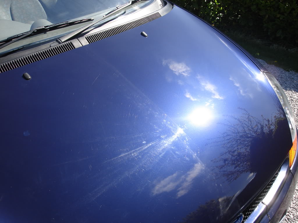

This is the worst scratch on the car:
I realise whichever I buy won't get rid of completely because it's through to the plastic in places, but if I could get rid of the majority that would do for now. Other than that there are a few deep scratches and a lot of light scratches and swirls.

That pic of the damage is beyond fixing with polish alone.

You may tidy up the light parts, you would be better of getting some touch up paint and giving it a wet sand before you polish it.

Oh and I know all the scratch won't come out Rich, but I'm hoping to tidy it up.
Look into wetsanding mate, but from what i can see the damage is pretty bad, so i personally think a new bumper is in order.
Wetsanding is basically going over the scratch with a paintstick, letting it dry, sanding it down with 3000 grit wet or dry paper which has been soaked in soapy water for 24 hours and literally sanding untill the surface is level, and then going over the sanded area with a machine polisher.
