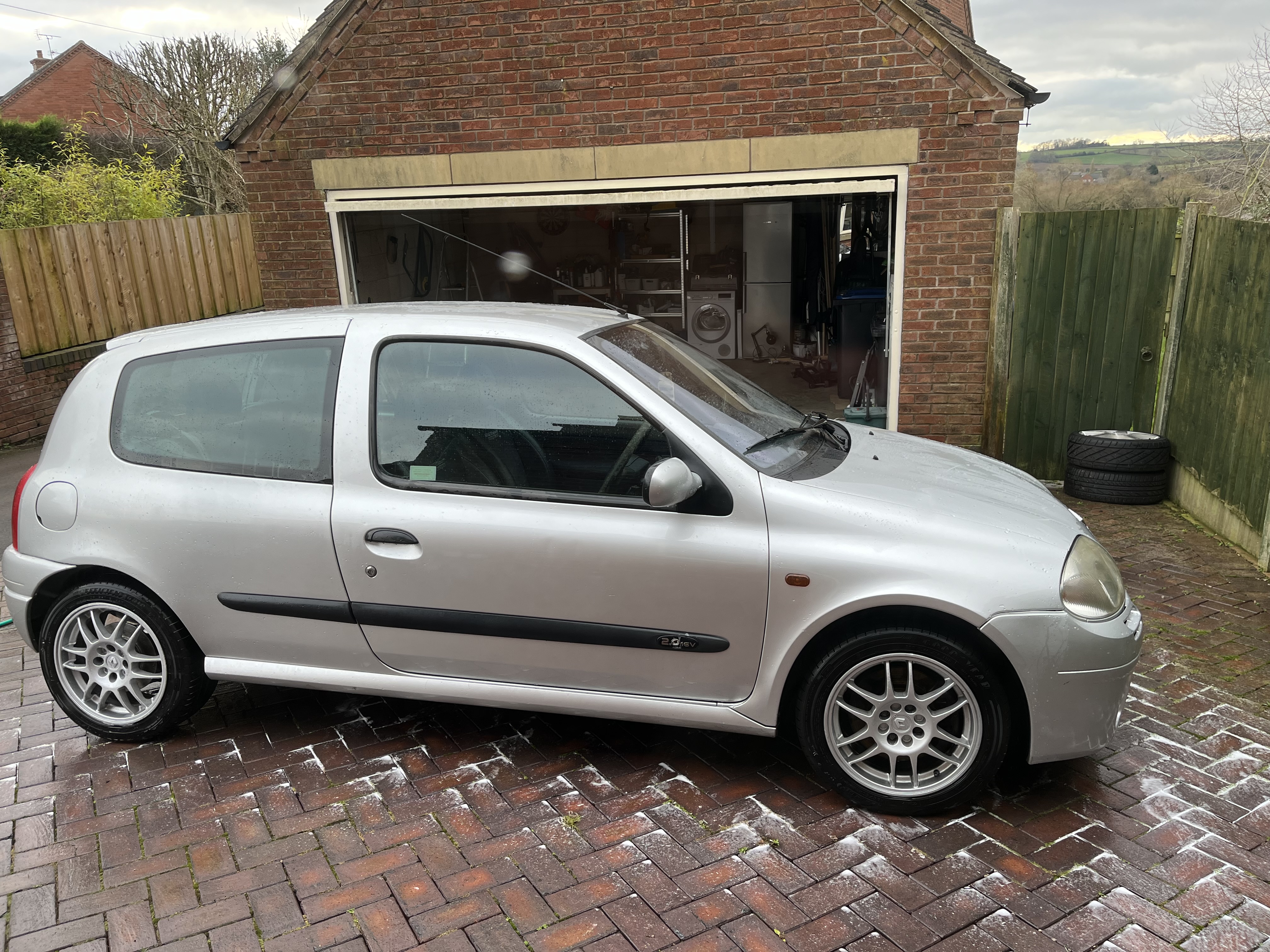

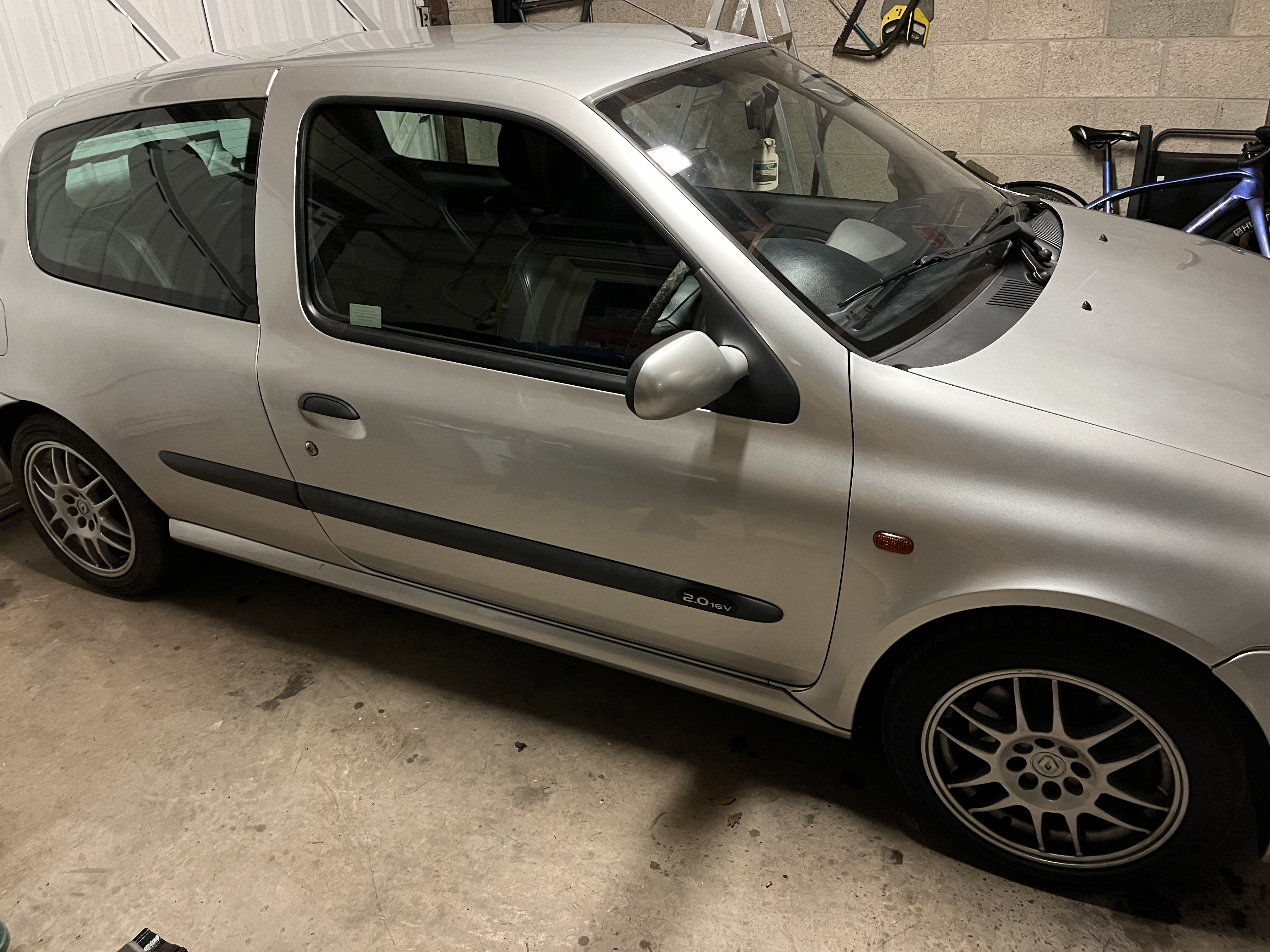

Picked up a new little project today…
It needs some work but has got potential to be good. 62k with a lot of service history (though not necessarily good service history) but really needs some TLC.
Back home now and tucked up with the Trophy, this evening will be the first of many spent ordering parts.
More pics and info to follow as soon as I get chance. 👍

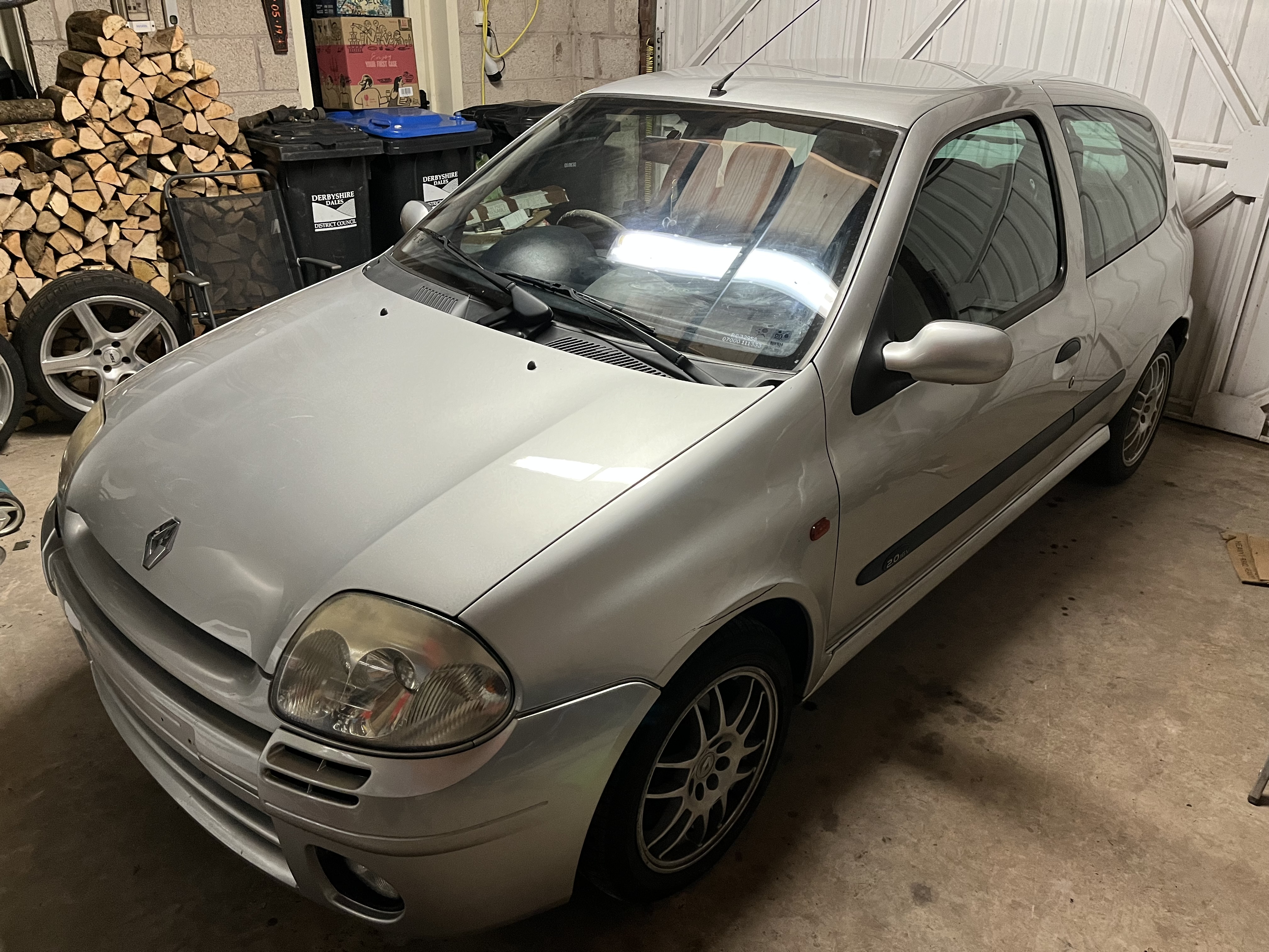

Started doing a few bits to the Ph1 on and off the last couple of days.
Rear ‘door cards’ out to check for rust. No surprise to see that there is some there, I’m 50/50 on whether it will be treatable or need repair. Sill covers coming off will be the decider - more to follow.
The cause of the quite terrifying drive from Manchester back home to Derbyshire is one completely knackered rear shock. Old shocks removed and new ones on order.
Poly dog mount fitted - because it was there.
Took the 5 spoke 17’s (yep…) off and fitted some F1’s I picked up locally. Not mint but will do until I can justify getting them refurbished.
Rear discs and pads, front pads, engine mounts and a few odds and sods on order so will hopefully turn up next week. Get that fitted, service and then it will be usable.

I think I remember seeing this car for sale just from the description of the 5 spoke 17” wheels.

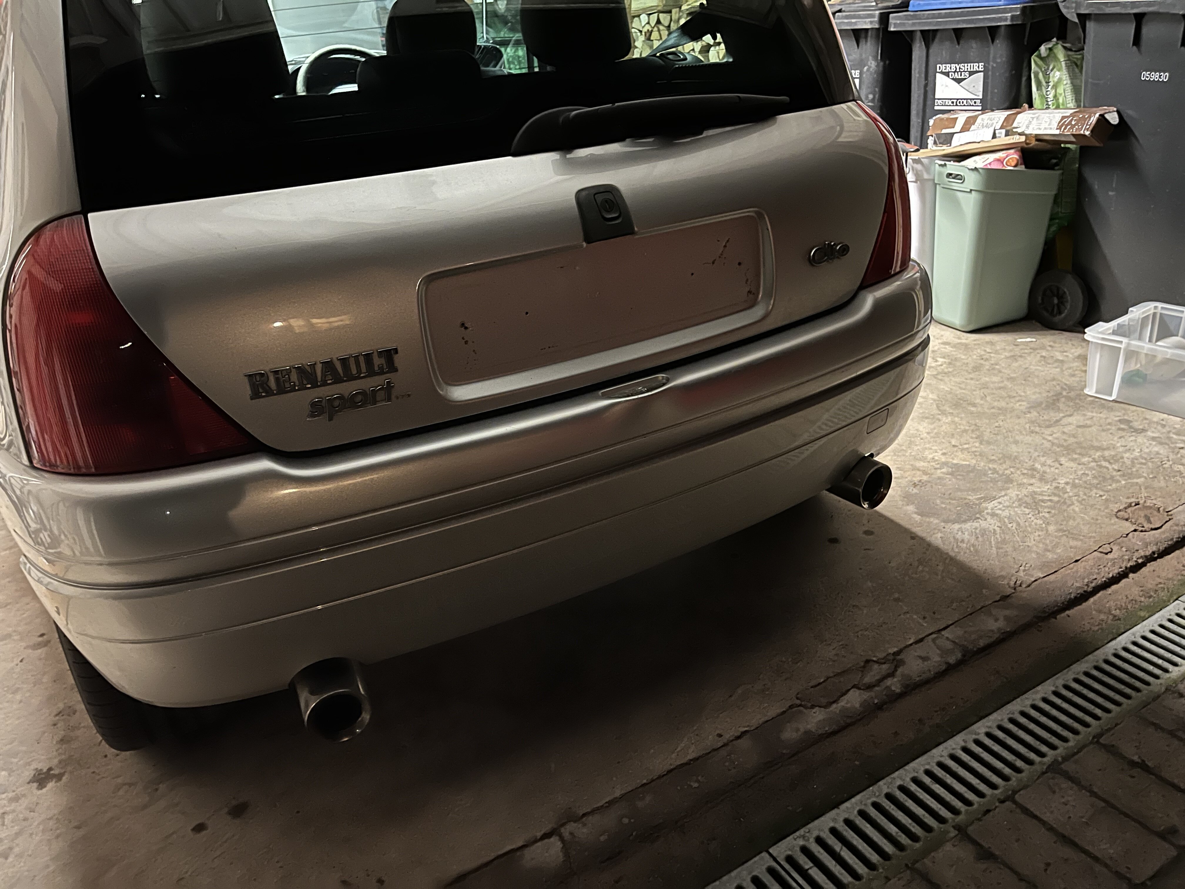

It had been for sale for many months, the owner is now in her 70s (it was actually her son selling it on her behalf) and it has been used very little in the last few years. It also has a very interesting Powerflow twin exhaust.

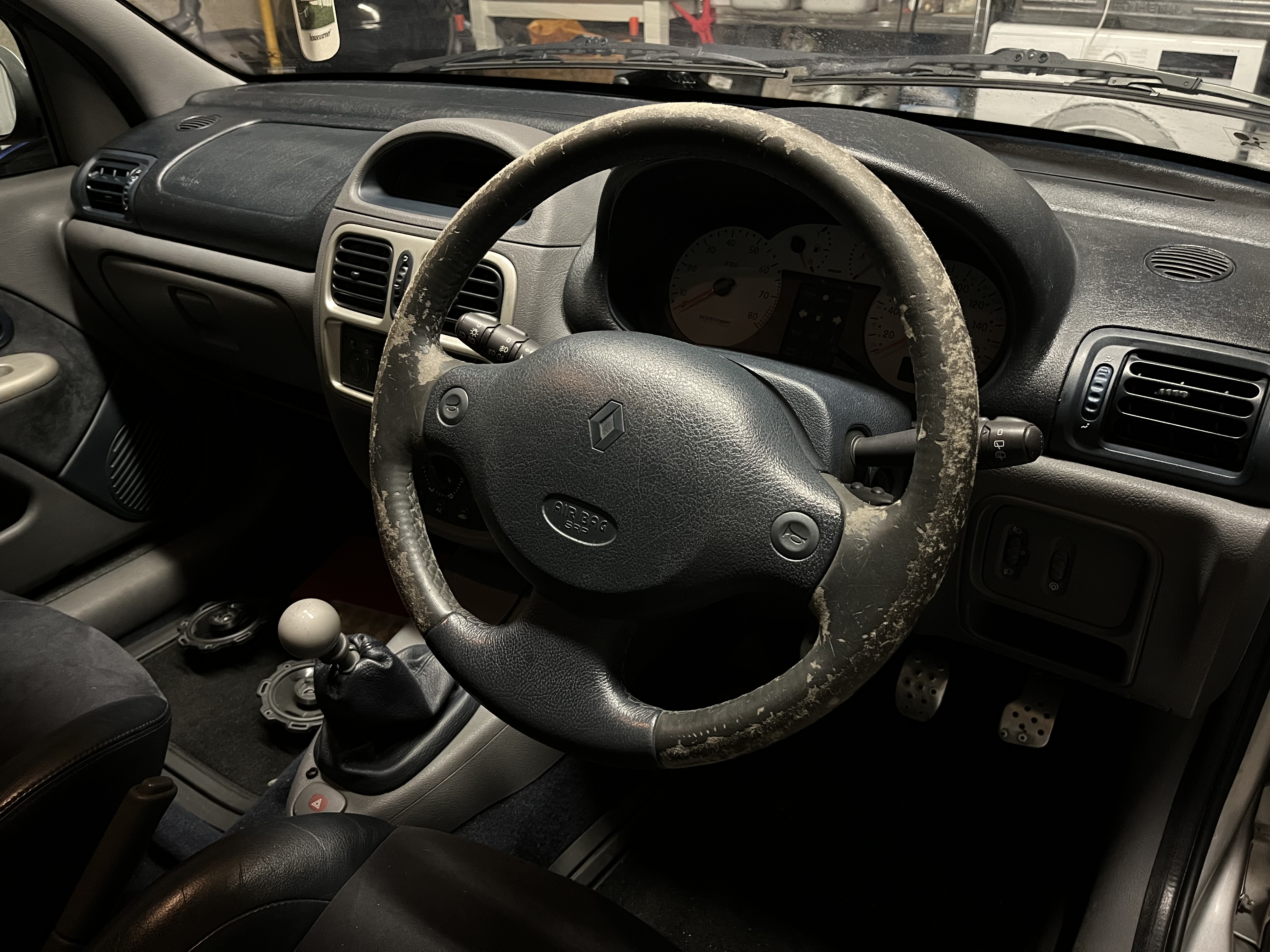

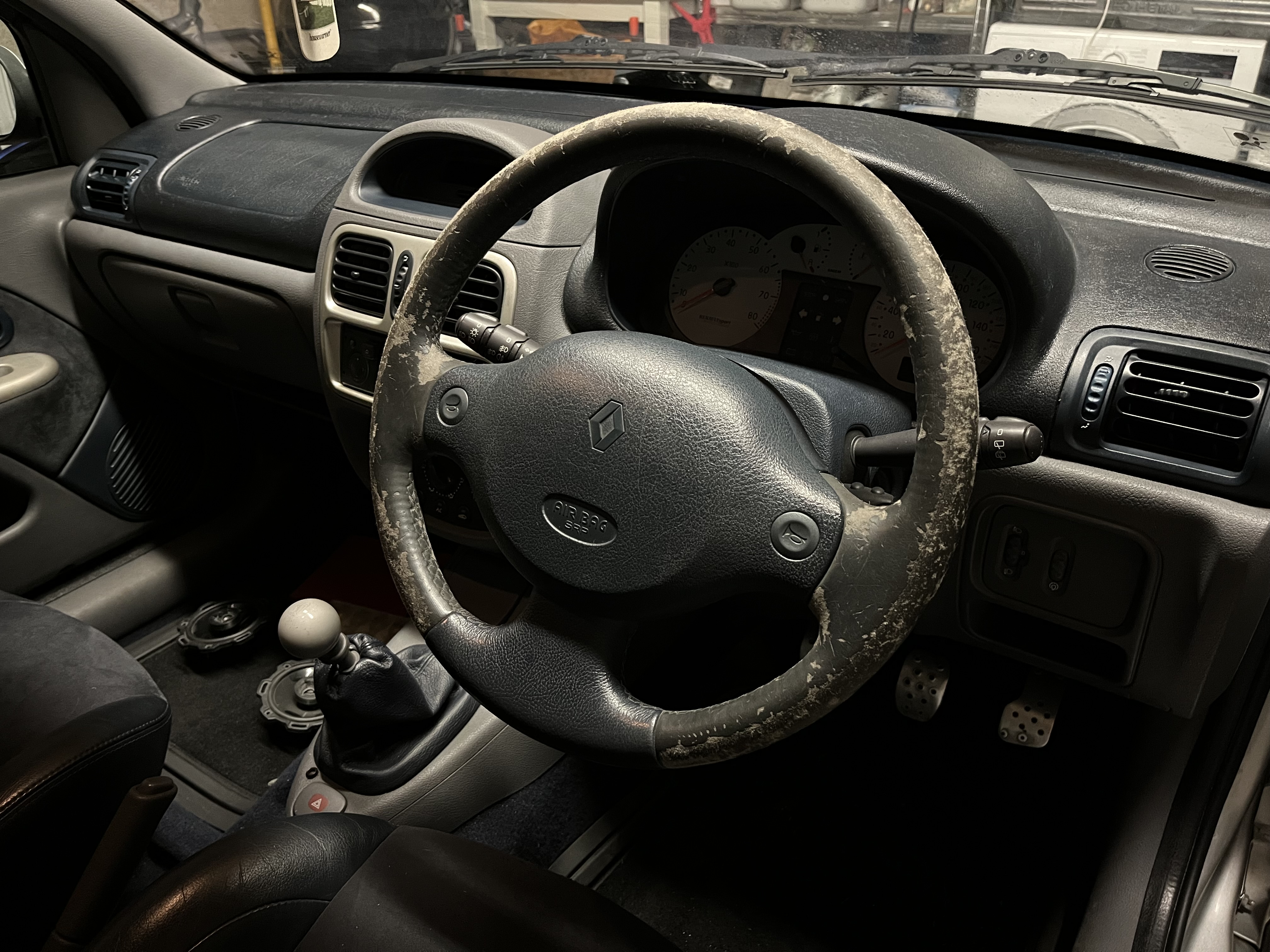

Apart from the inevitable steering wheel decay, discolouration to the silver plastics and darkening of the dash, the interior is absolutely immaculate and it does seem to run really well. The body work is a PDR man’s wet dream with car park dings everywhere.

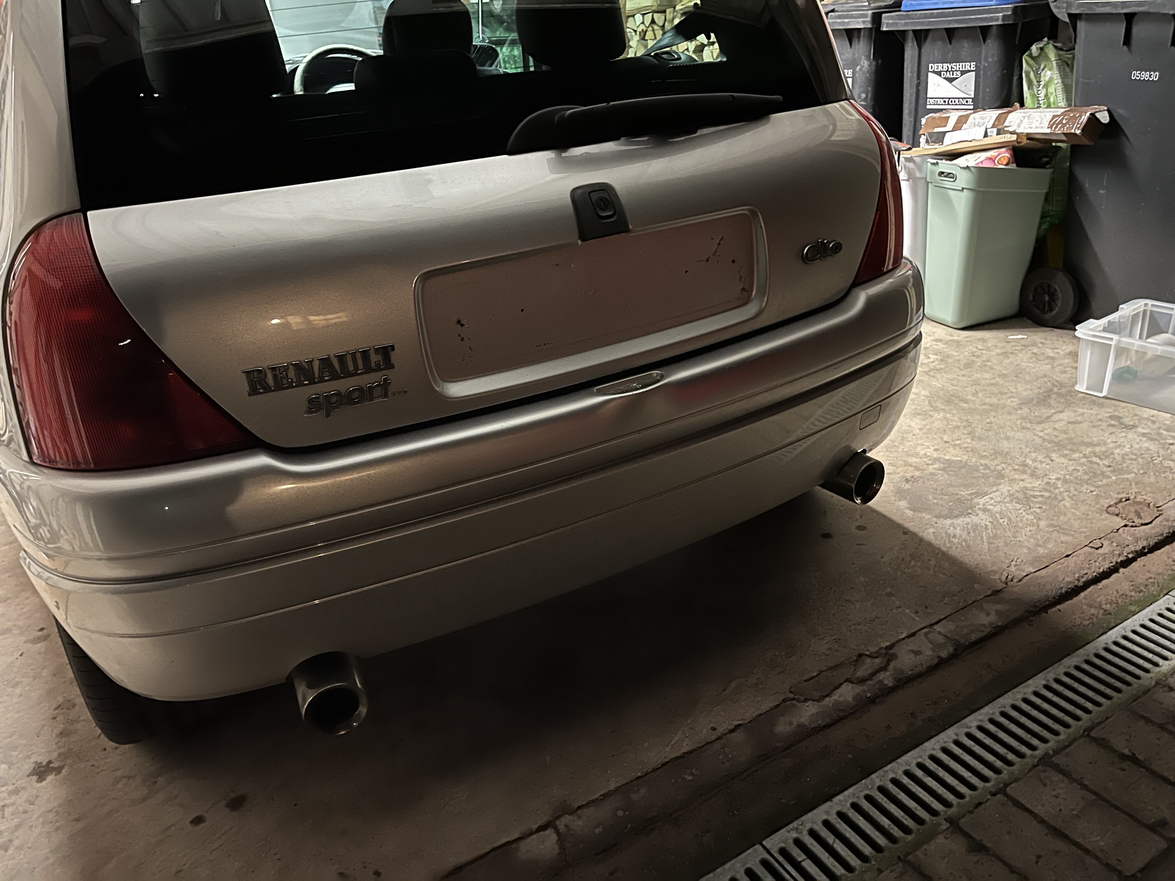

This was for sale on Autotrader for quite a while, with the BMW 335 style rear exhaust system........
starmagsi
  Trophy 193
Same one, yes.
The exhaust is still there but will be replaced in due course. It was fitted about 20 years ago to a fairly new car, there is a receipt in the pile and it wasn’t cheap - not for me though.

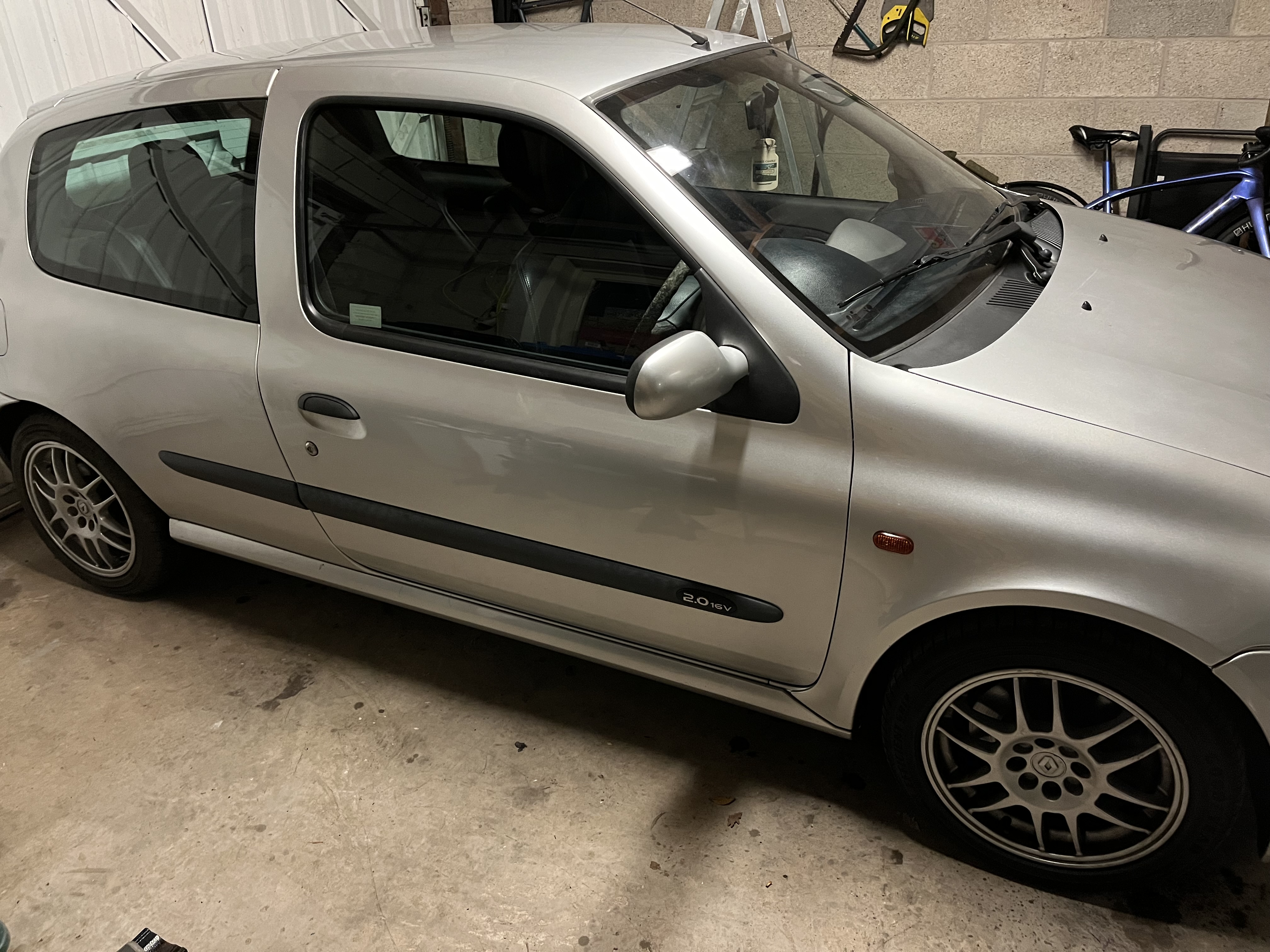

A few random pics from this evening…

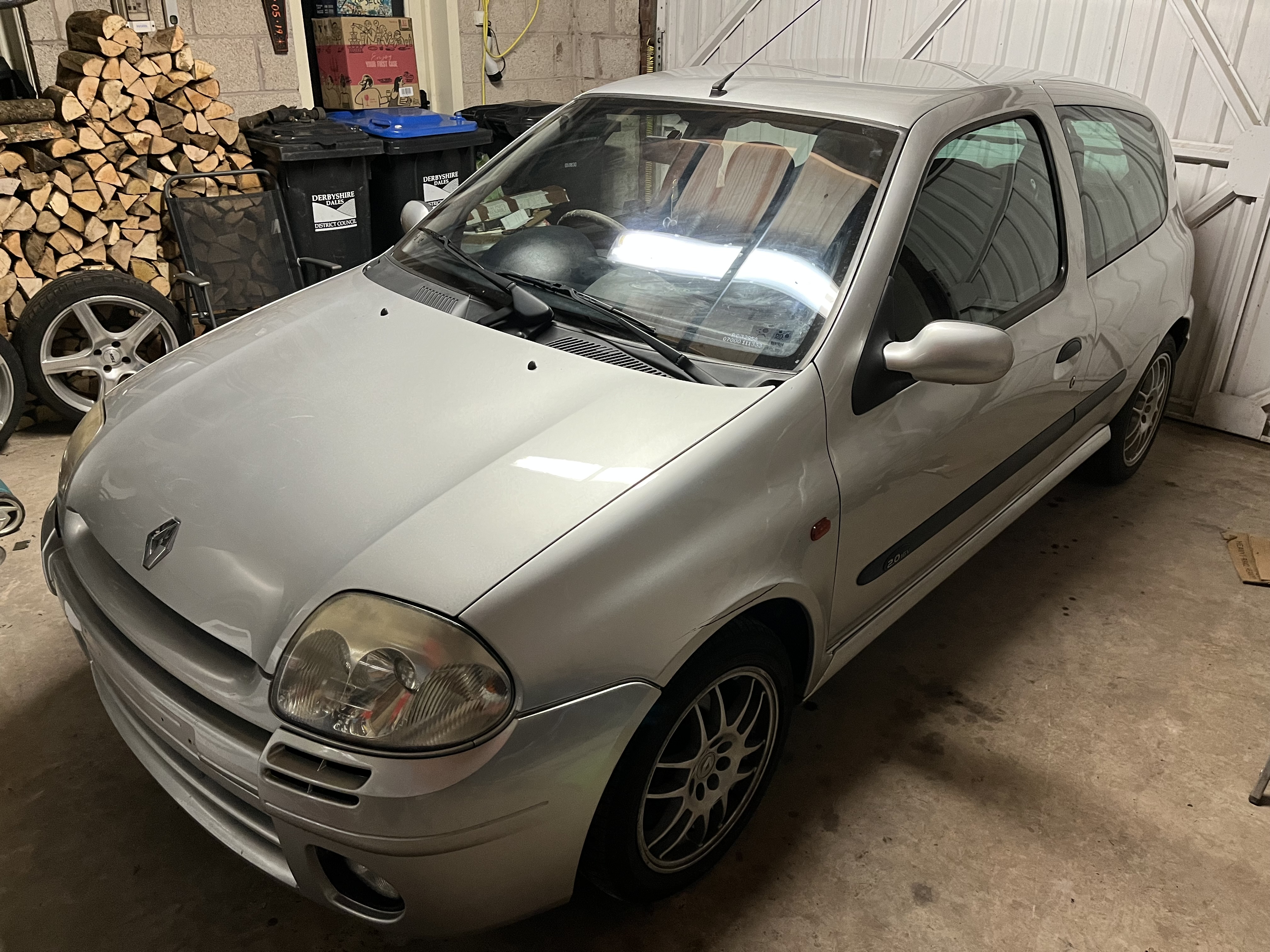

Got the new rear shocks fitted after work and went out for a quick drive to see the effect - completely different car, feels like a Clio again.
More to do over the weekend.
My daily is in the body shop at the moment after a trip into a hedge on an icy road before Christmas so this will be called up for commute duties next week I think. 👍

Exhaust - the one on there is not to my taste aesthetically, it’s too loud, and it’s impossible to eliminate the rattles. This will require work to the rear bumper too.
Steering wheel retrim.

Picked up a second hand K-tec stealth exhaust as well as a donor rear bumper so that I can ‘fill’ the cut outs for the twin exhaust. It will be good to get that done as the exhaust sits wonky and bangs on the bumper as it is.

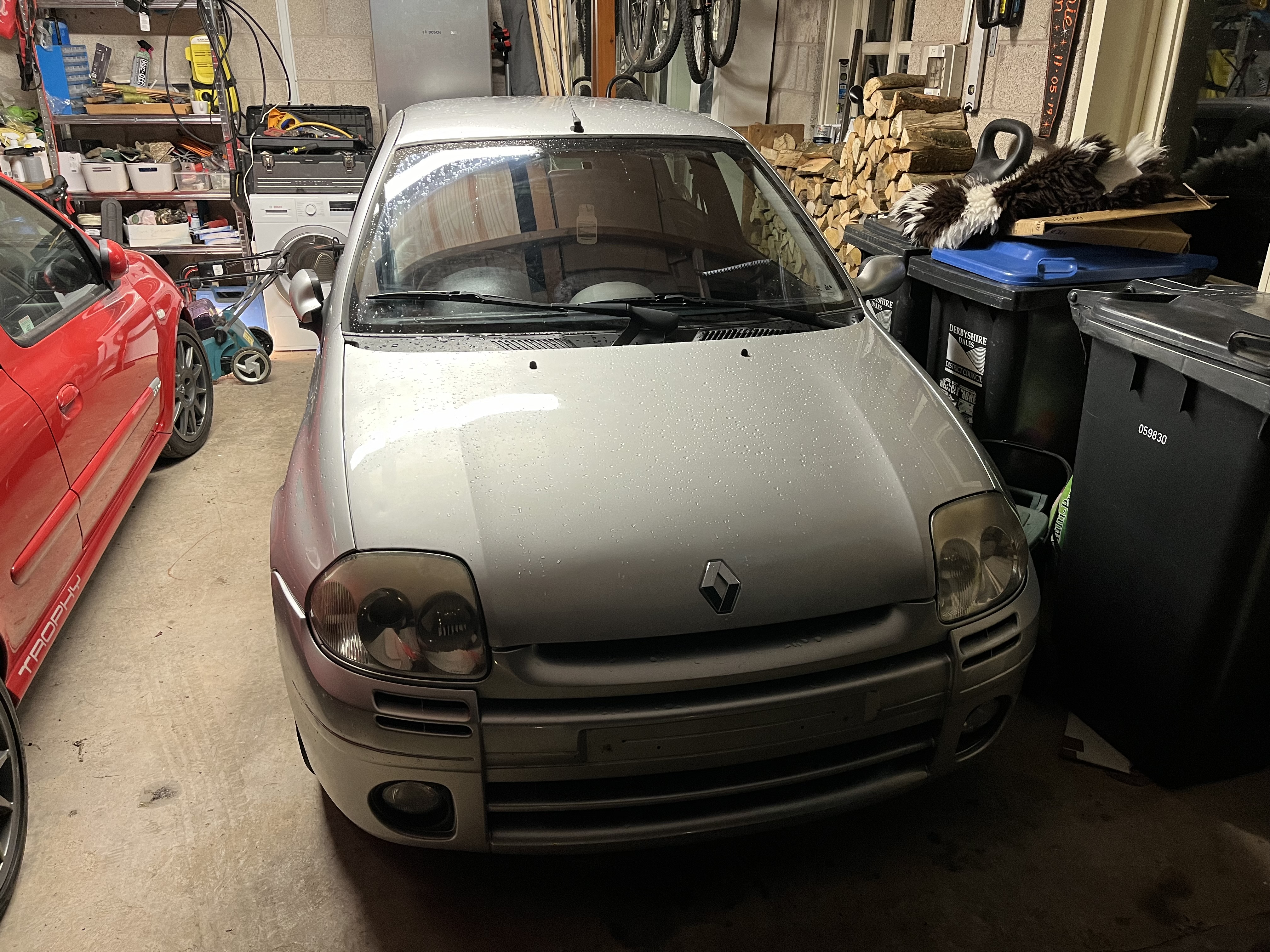

Quick update...

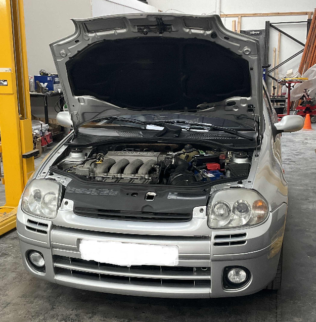

The Ph1 spent a day at Diamond last week having Timing and Aux belts, dephaser etc. Was also treated to a new set of spark plugs to remedy slightly rough running. All good and running well now.
Next up will be fitting front discs and pads, and replacing the twin exit exhaust for the 'stealth' one (and sorting the apertures in the bumpers). Also have some Jon Foz seat rails to fit at some stage.
