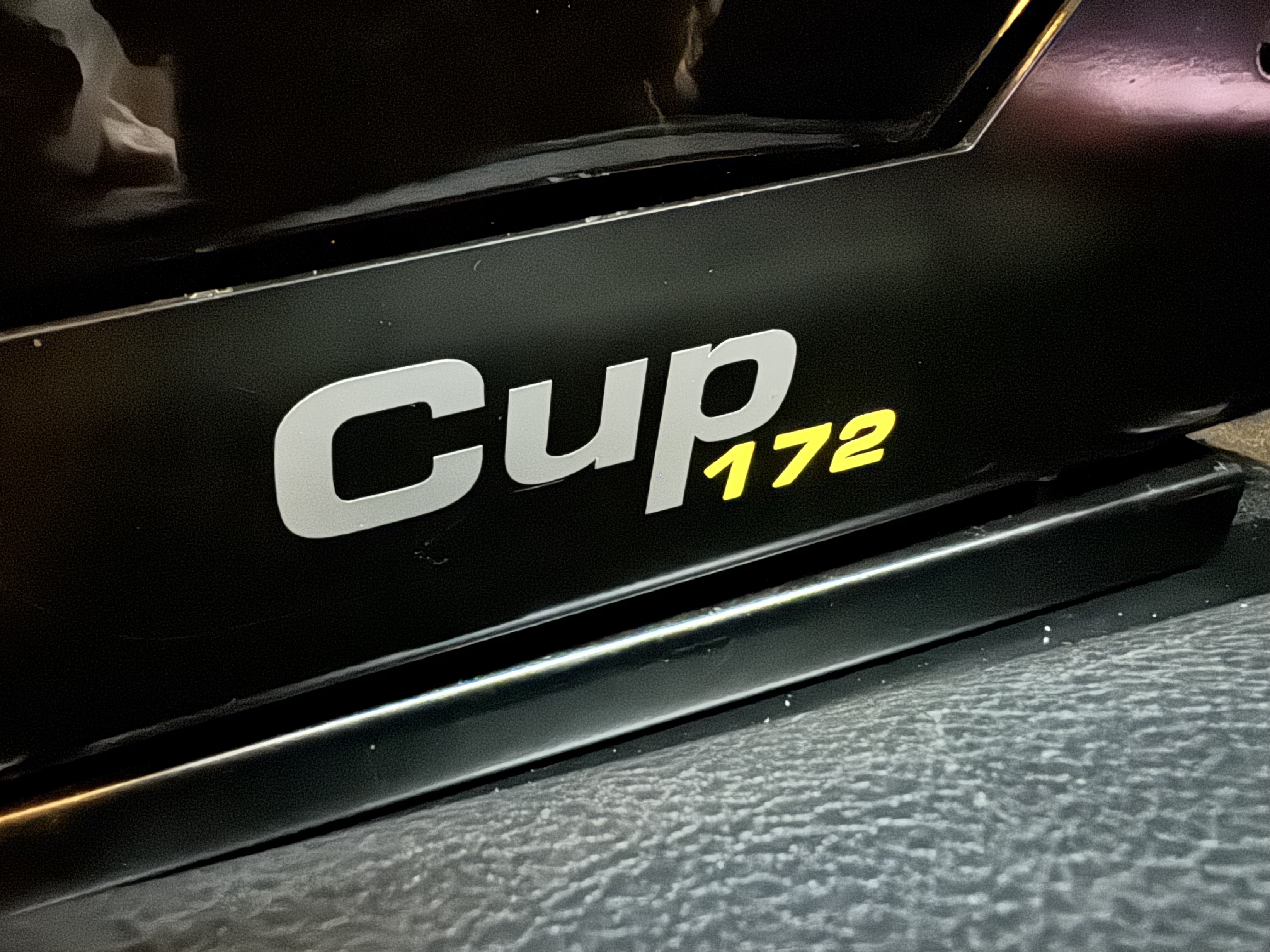

Thanks for the photo, shows the differences perfectly. The letters look a bit off but the numbers are ok.
Took mine off in preparation for new ones cause was missing some of the numbers. Hopefully still have the letters lying around in the garage.
Exactly my thoughts, font is good too just a shame they couldn’t replicate the chrome effect.
Only paid a tenner for my pair of ES badges as I didn’t think I’d get some genuine badges (I did in the end though for a princely sum 🤐) as they turn up on here or eBay occasionally.
Wow that shows the difference very clearly! I saw some for £78 on eBay and thought about it, but the genuine ones might be something I do at the end of any work. Probably when they’re £178!!
Im not sure if you mean you were considering spending spending £78 for the ones currently on Ebay but just in case you are, they are in fact Evil Speed reproductions.
@OP, Thank you for this post, don't feel so bad about my 182 non-cup now, just purchased it and so far spent 1k on it for servicing parts and doing a restoration on it as base car is clean inside and out, I used a sticky stuff remover and then sand blasted and painted the crappy trim bits that were sticky as s#it. Not as cheap a car as I thought it would be.. On a plus note the blue is such a nice colour on your 172 CUP.
Thanks- no, I paid for evil speed ones already! Not at that price. Real ones do seem to be becoming the new bitcoin though.

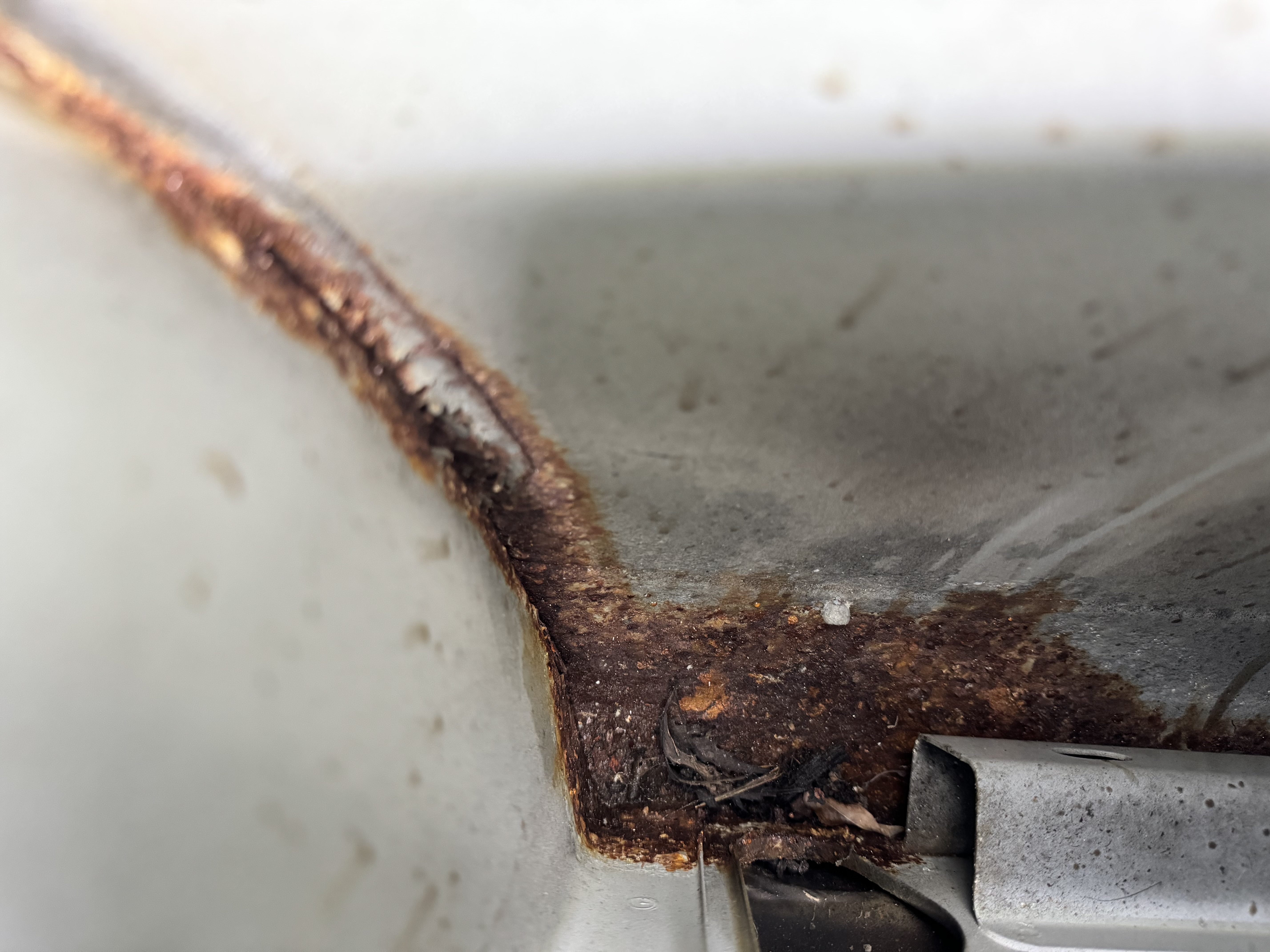

The jobs keep piling up and I’d really like to be on top of the rust. And getting the 15” turinis refurbed in silver!

Organise welding- sills, rear quarter, fuel filler

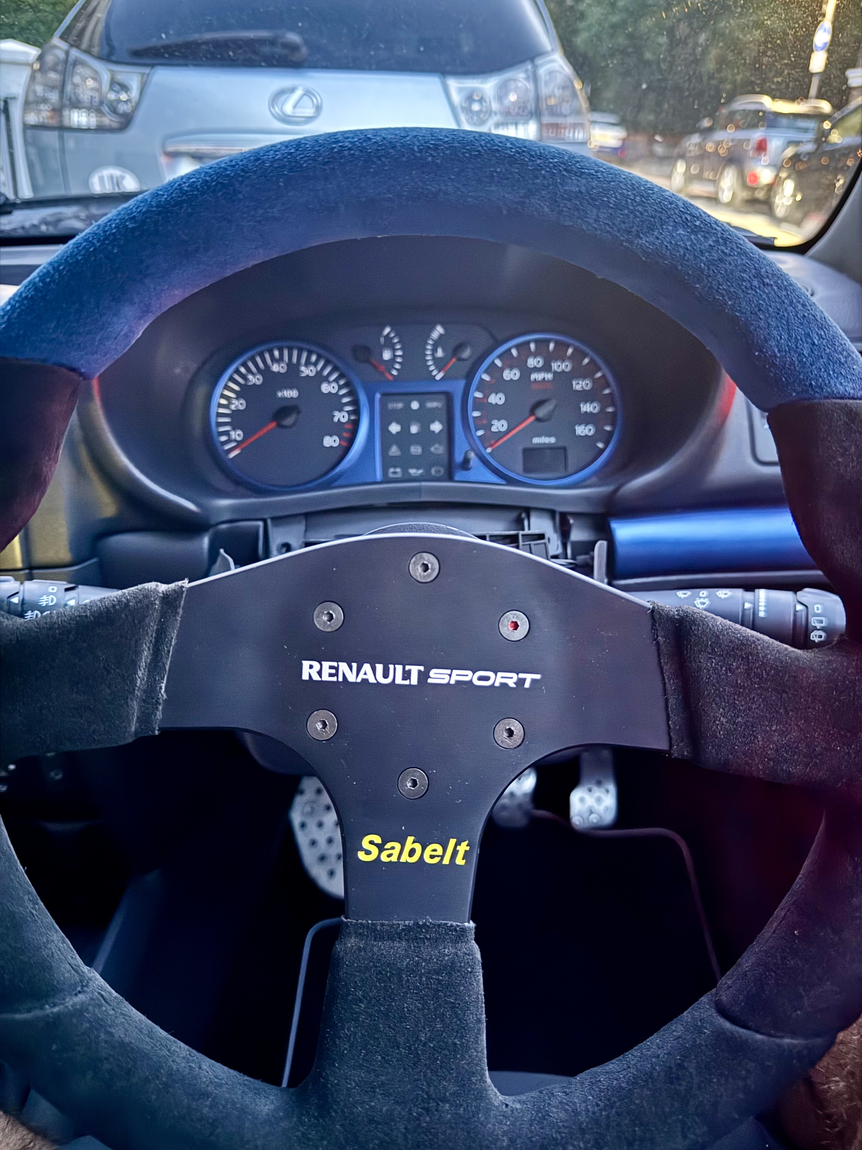

I fitted the Sabelt steering wheel and QR, pretty straightforward, disconnect the battery, wait a bit, unclip the airbag etc. my large torx bolt on the steering rack wasn’t a T40, but a T45, other than that ok.
But when I disconnected the lights stalk to put in the new one with a horn on the end, problem. The black and red wires to the stalk slipping two separate locations on the Cup one, my new one has a white plug with the wires. So that isn’t connected. Any suggestions for someone who hates doing anything with auto electrics?
Then I need the airbag codes but or resistors. Anyone near SE London that could do that? Failing someone with the fancy RS Tuner or Clip, are the resistors 3.3 ohm? I’ve seen people use those or 3.9.
Anyway, the better wheel is an absolutely massive improvement in driveability, though I haven’t driven it yet.

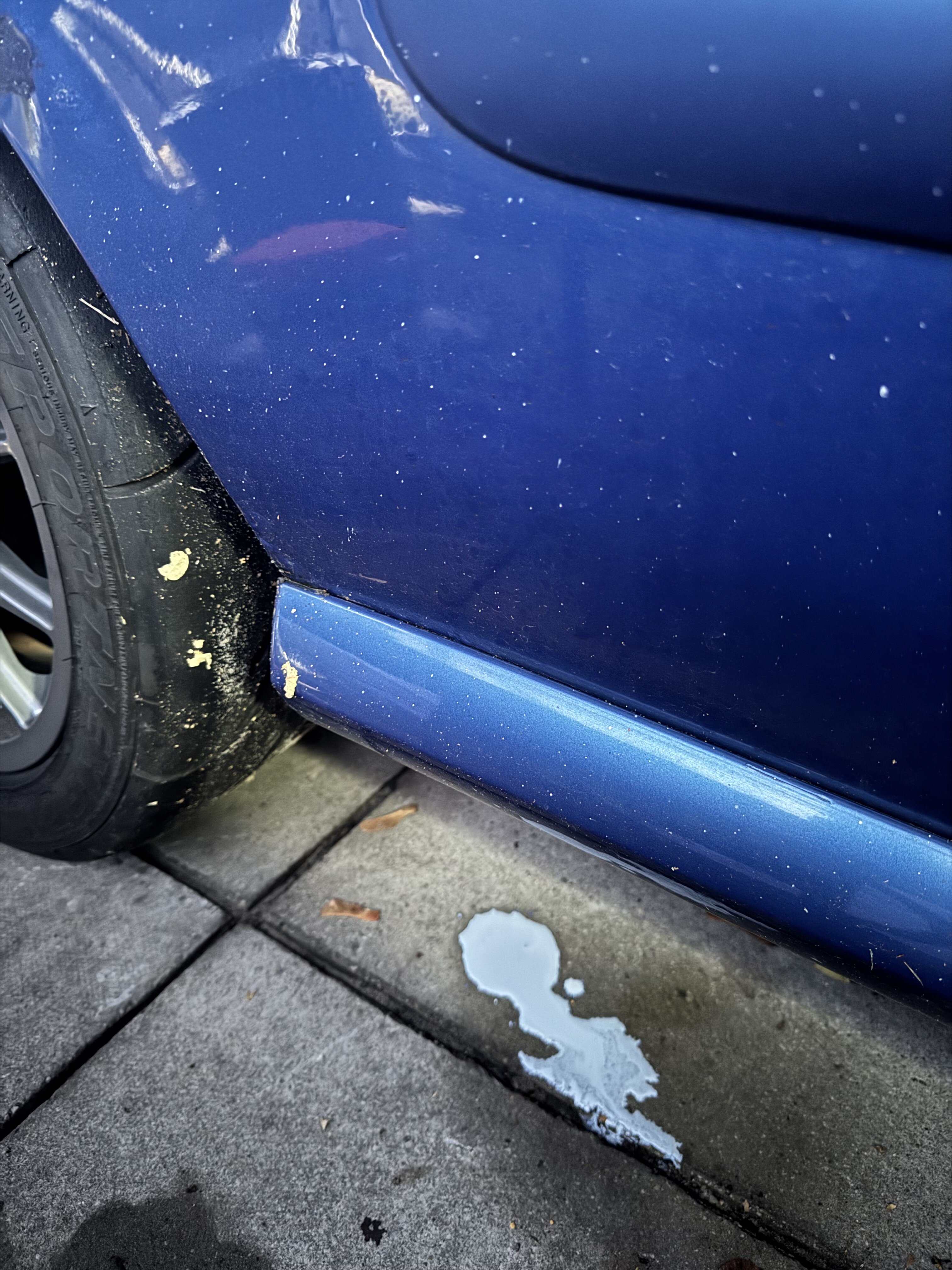

So today was a simple regas- no, that’ll be a fucked condenser thank you. And as I’m getting prepped to put seats in it, I whipped off the rear interior panels to check that the rust was really very minimal indeed. Yep, can hardly see any rust.

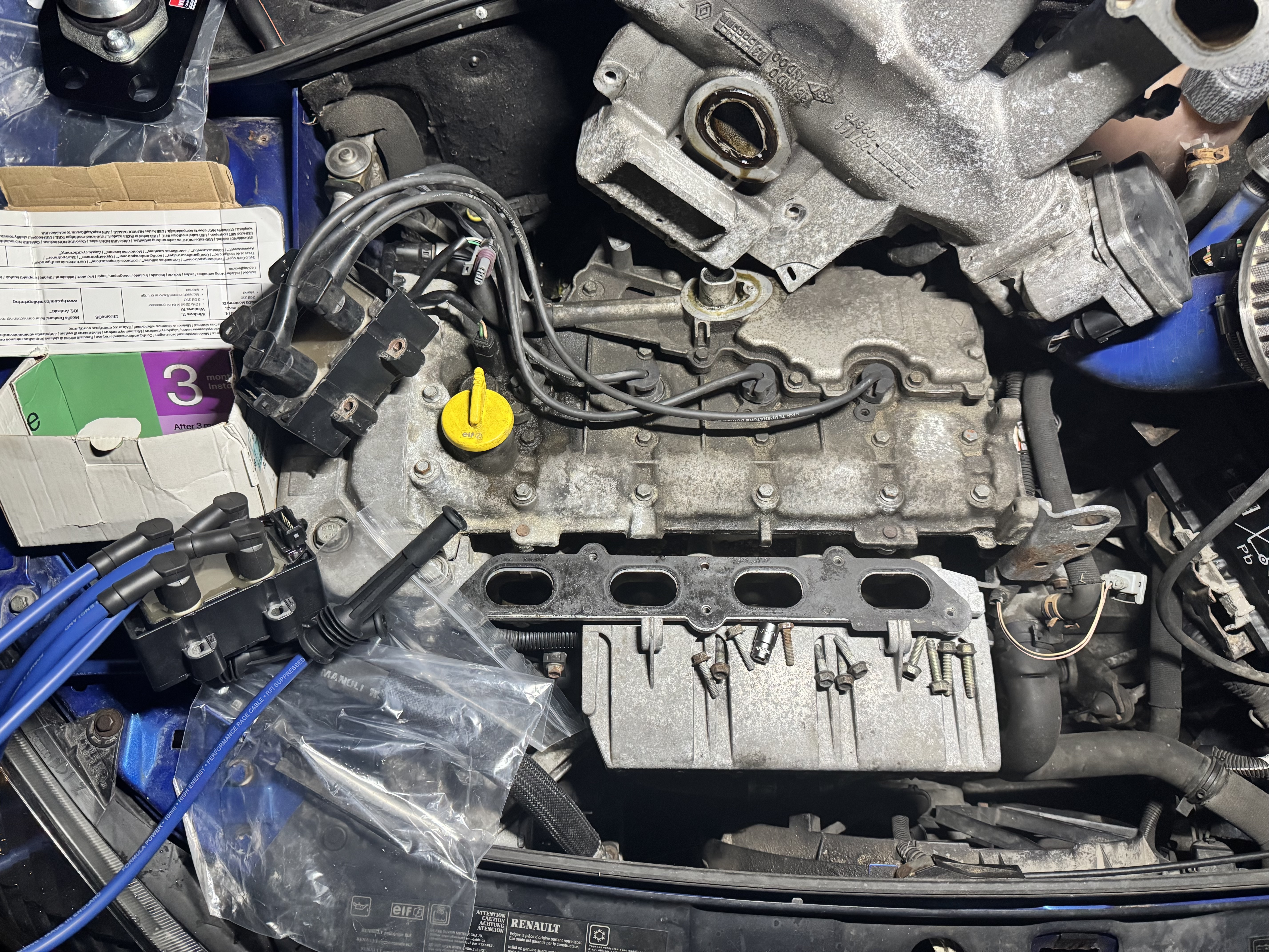

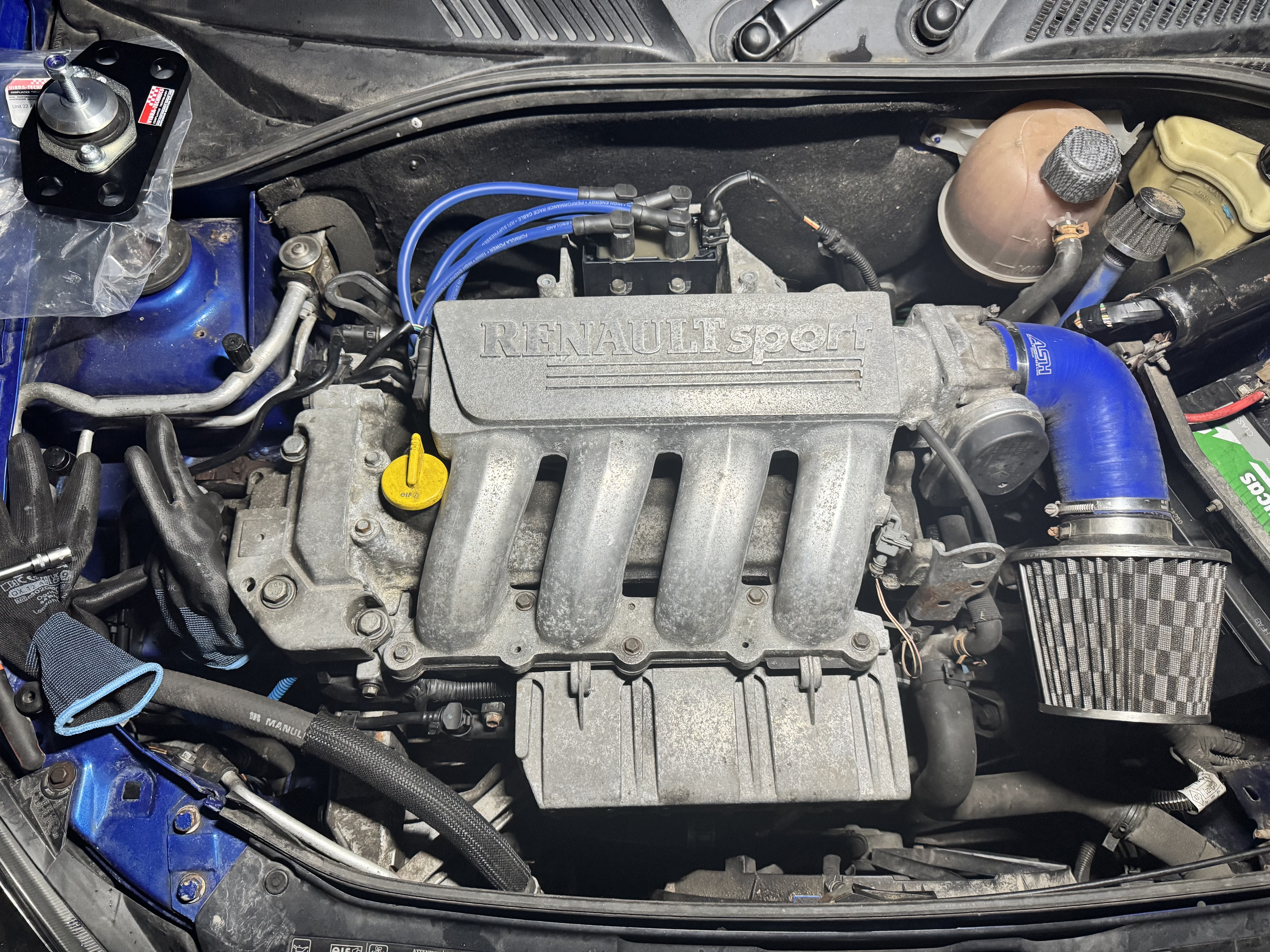

I managed the job that didn't need doing today- new coilpack and leads, why not? Maybe the answer to that is that I think i managed to compress a lead under the inlet and I'm worried that there might be a specific way to lay out the leads under it that I don't know about? The front 5 bolts on the inlet took quite a bit of pressure to clamp down the inlet onto the bottom half. Positives: it didn't catch fire (yet) and I only lost one bolt (from the side of the coilpack and i can easily replace that).

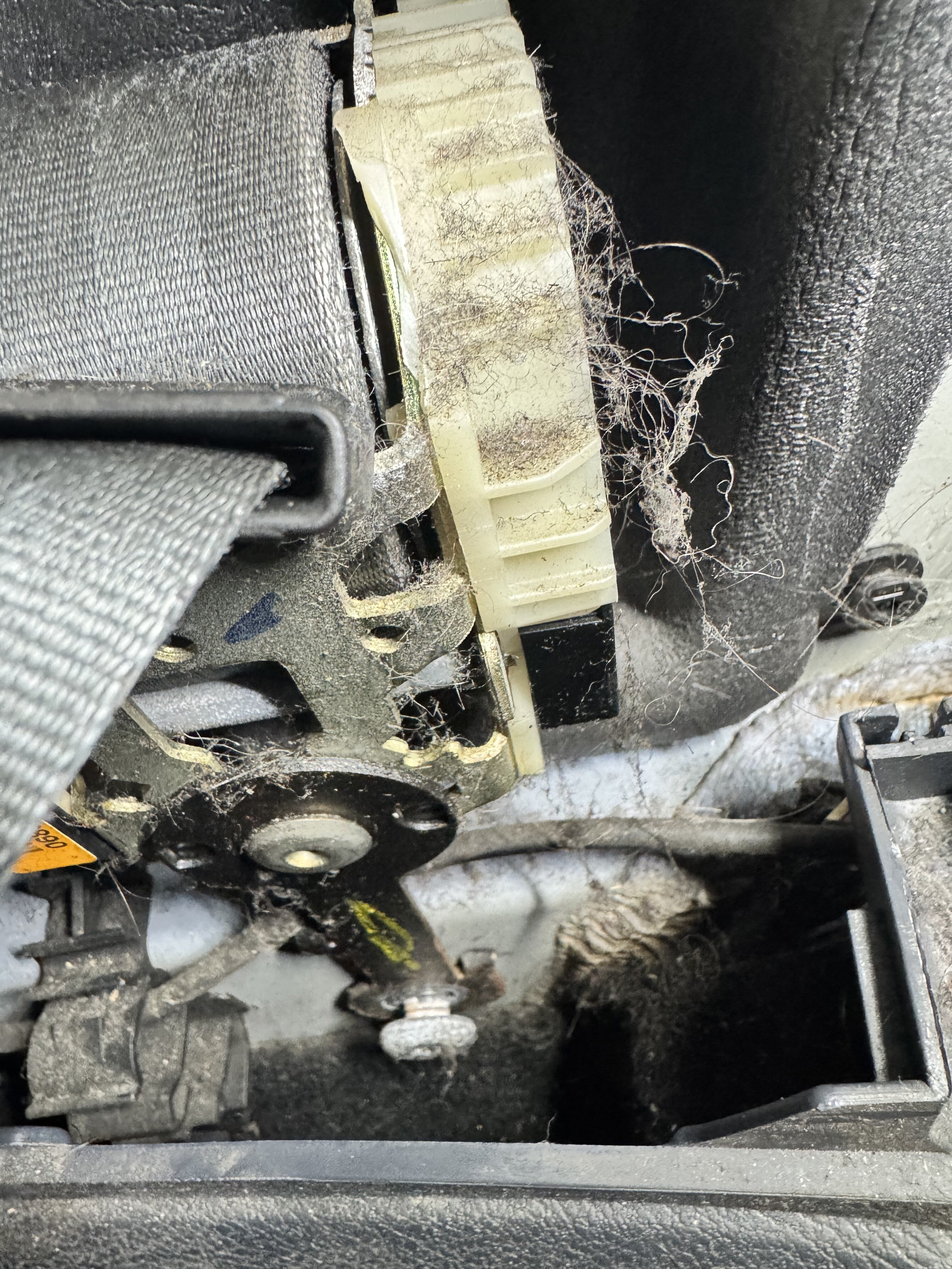

Also pictured: Hairy seatbelts, now fully sanitised and Bilt Hambering the driveway... I'm definitely sure the stuff is supposed to drip out of the sills onto the ground, yes?
This is how I work on my cars: identify that something needs doing, research the s**t out of it reading how to guides, watching videos, even looking at a Haines manual, then order the parts, put the work off for a bit, finally convince myself it is as simple as the guides say, remind myself "all car stuff takes me 3x the guide/ video claim" and set to it. Then I find I've fucked something up.
Example: leads and coil pack. How can you mess that up? What the guides don't flag is that the leads like to get stuck under the inlet and bunched up and make it impossible to seal the inlet back down on the head. That means you compress a lead and don't have an airtight seal on the inlet. Cue startup with super manky running, very high idle and one sweating and stressed Polynesian. It also meant that I tightened the inlet bolts down too hard. All rectified today, leads lying happier in the space under the inlet, and running nicely.

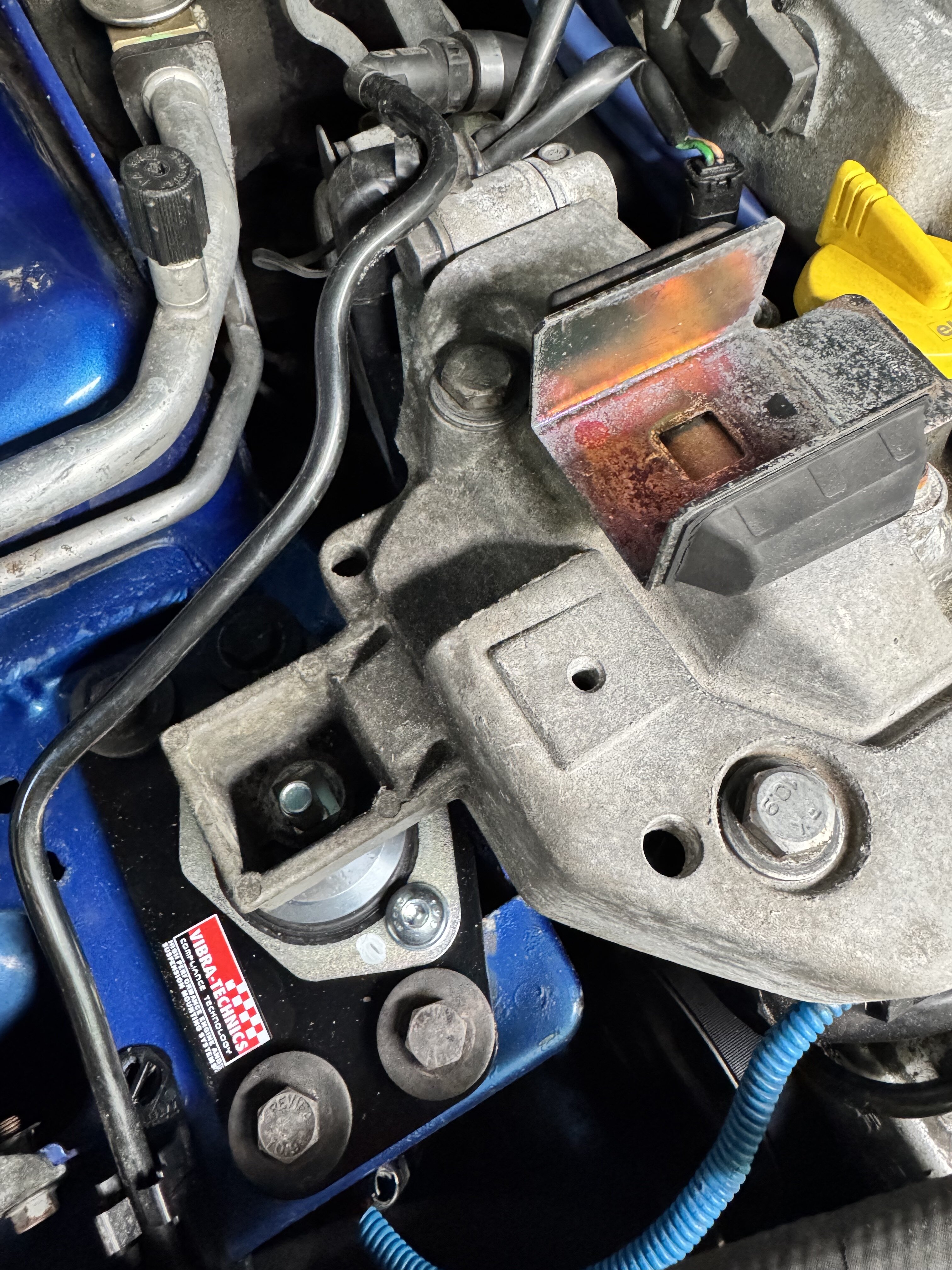

Then onto the engine mount. The vibratechnics one is a little different than the original. On this I carefully followed the cliosport guide (thank you!) and it all went well, aside from putting the mount in back to front at first. I ordered all new bolts and washers but was impatient so fitted it with ultrasonic cleaned old ones for now. I'm assuming I've done the right thing to leave the original little metal insert with two rubber sides out and just mount the engine bracket onto the vibratechnics thing (picture below).

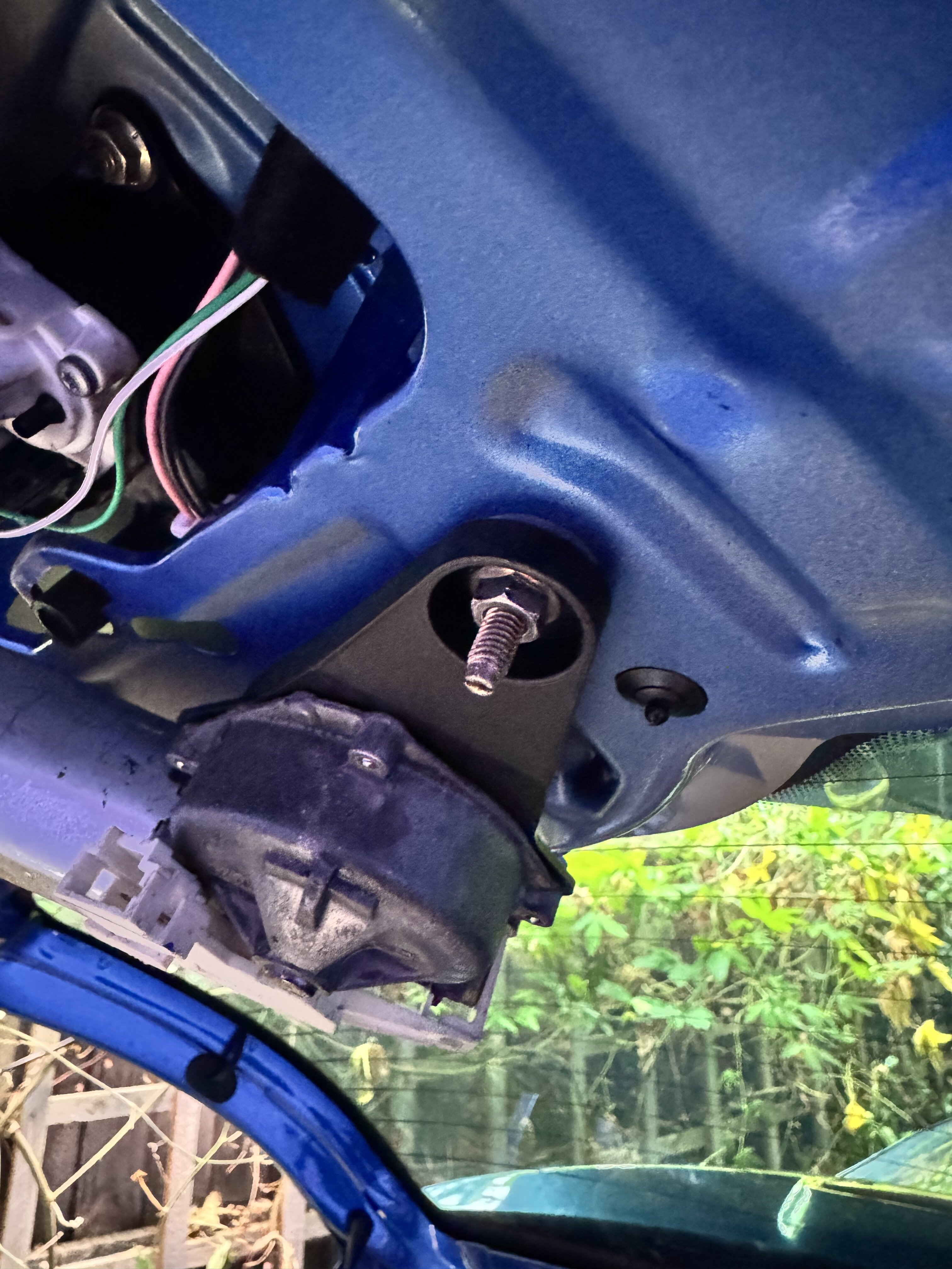

Finally, I removed the rear wiper motor and gubbins. It's a kilo saved to offset my AC, and it makes the only difference I know of between the Cup and the Ragnotti no longer a difference. The Jean Ragnotti edition was the French Cup. You probably all already know that. I managed to try and insert the Dewiper blank back to front - had very quick support from the guy and I think it looks great. My bootlid did not follow the info in the guides (of course). I had two 10mm nuts that span in the lid, as there was just a smooth bolt on the inside of the metalwork. I also had to order a deep 22mm socket to get the thin nut off of the actual wiper shaft.

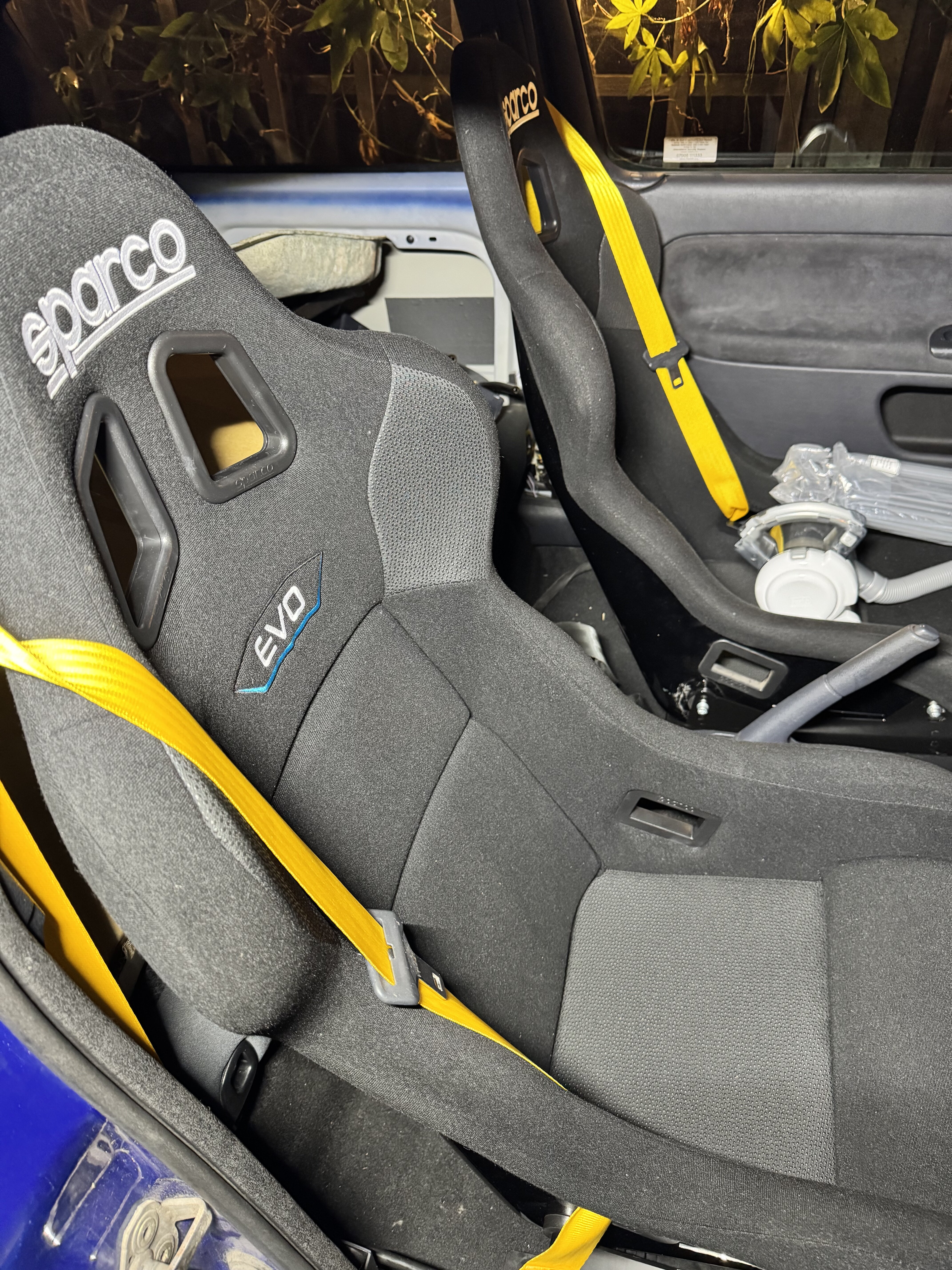

Now getting the JonFoz seat mounts in (thank you, @JON FOZ for your advice) as I have Sparco Evos arriving tomorrow.
At the same time, I'm trying to put my MX5 back together, change the waterpump on the Alpina, and build/ modify/ fix about 5 bikes. And as you have read, none of the jobs is quick for me!
Seats are the priority for now, and the yellow seatbelts I've got. Then the AC condensor and a few other things. Good news: the car no longer stinks inside.

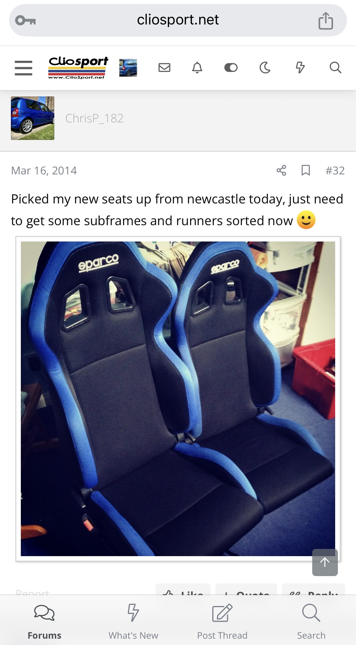

Funny that this is the second time my car has had Sparcos in it. Found a thread where @ChrisP_182 owned it back when I had my first Cup.
Whatever happened to it since that time, it was not very loved. That gives me drive to make it good again.

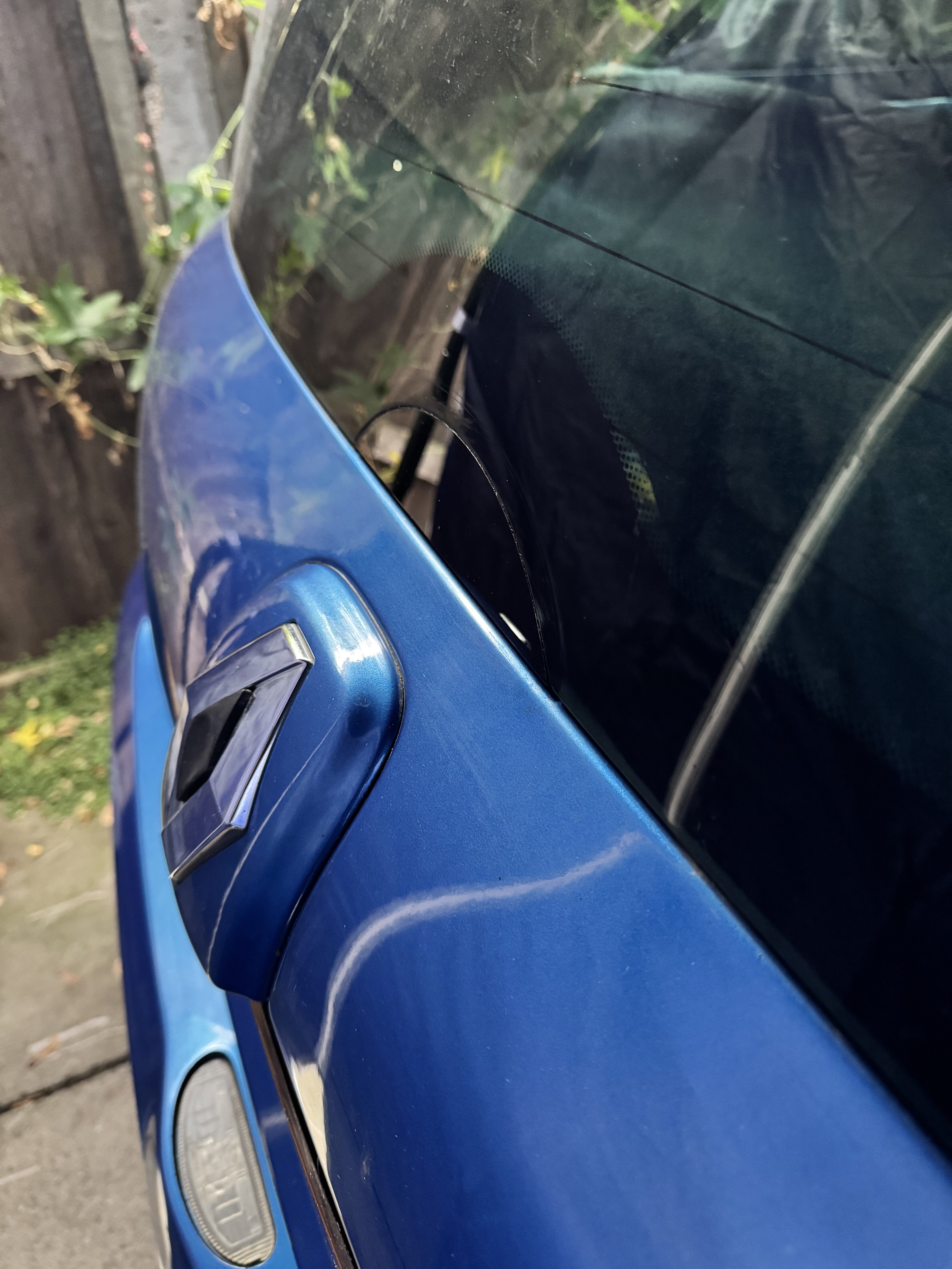

Where did you get the wiper blank from? I know people say you’ll miss not having a rear wiper but mines not worked in the 6 months I’ve owned it so I won’t miss what I don’t have.
Im in the process of trying to work out what seats to get for mine. After the last track day I was getting flung all over the place. I didn’t realise that Corbeau seats factory is in Sussex not for from me so planning on takinga trip down there any seeing what seats I actually fit in.
Great move if you can visit Corbeau. It’s a fiddly job but totally worth it.
The wiper blank- https://ebay.us/m/ytO2wR

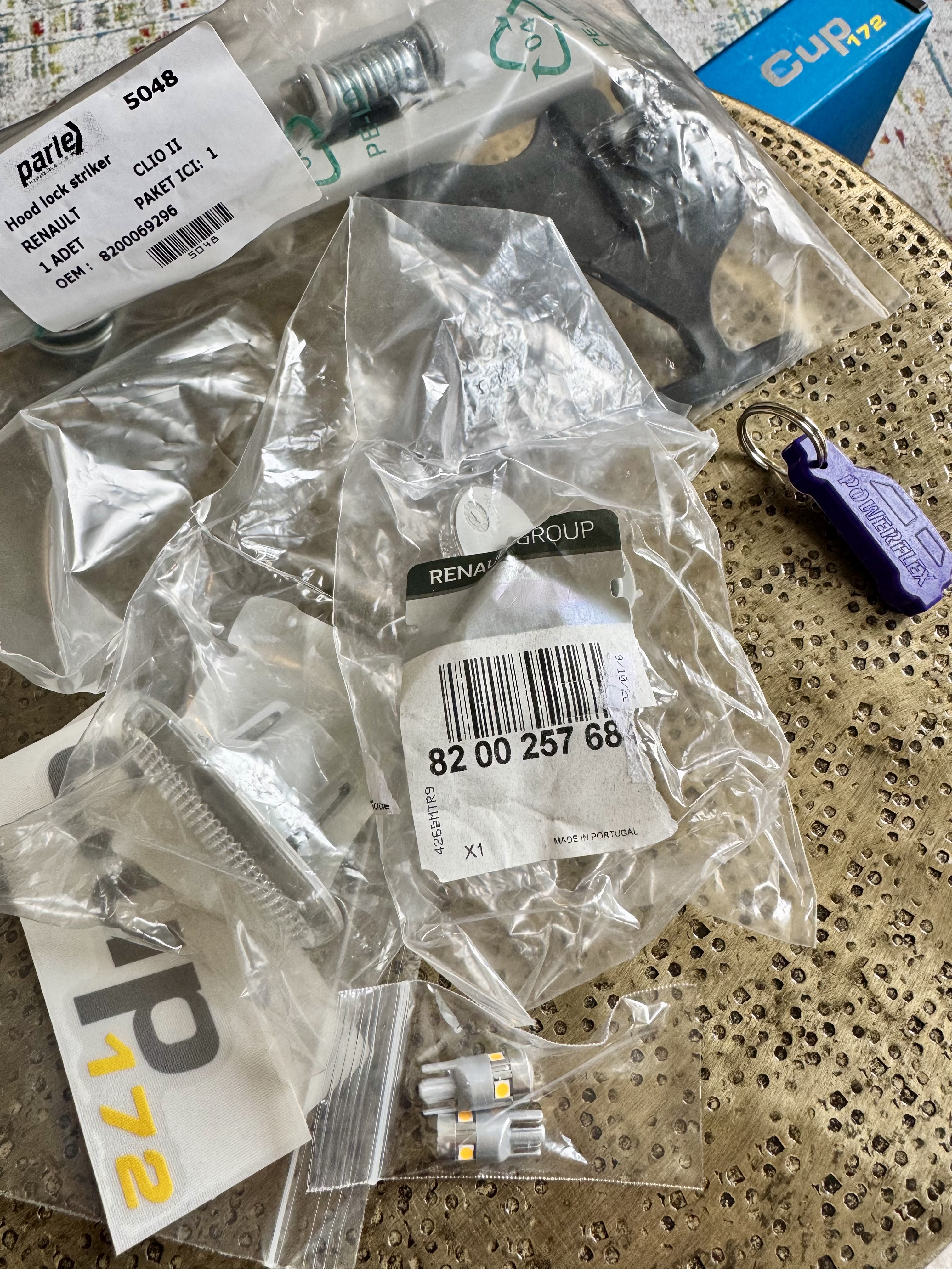

I also made the mistake of buying clear side indicator lenses from eBay- don’t know originals were available- they got horribly and the clear led bulbs I bought are not clear, the orange of the leds shows through and it’s pretty ugly. I’ve found OEM lenses and different led bulbs that are a little less obvious- what kind of bulbs are people using in clear lenses?
Also bought a new bonnet release mechanism- a pattern part so hopefully the fit and function will be ok. The original is rusted to hell.

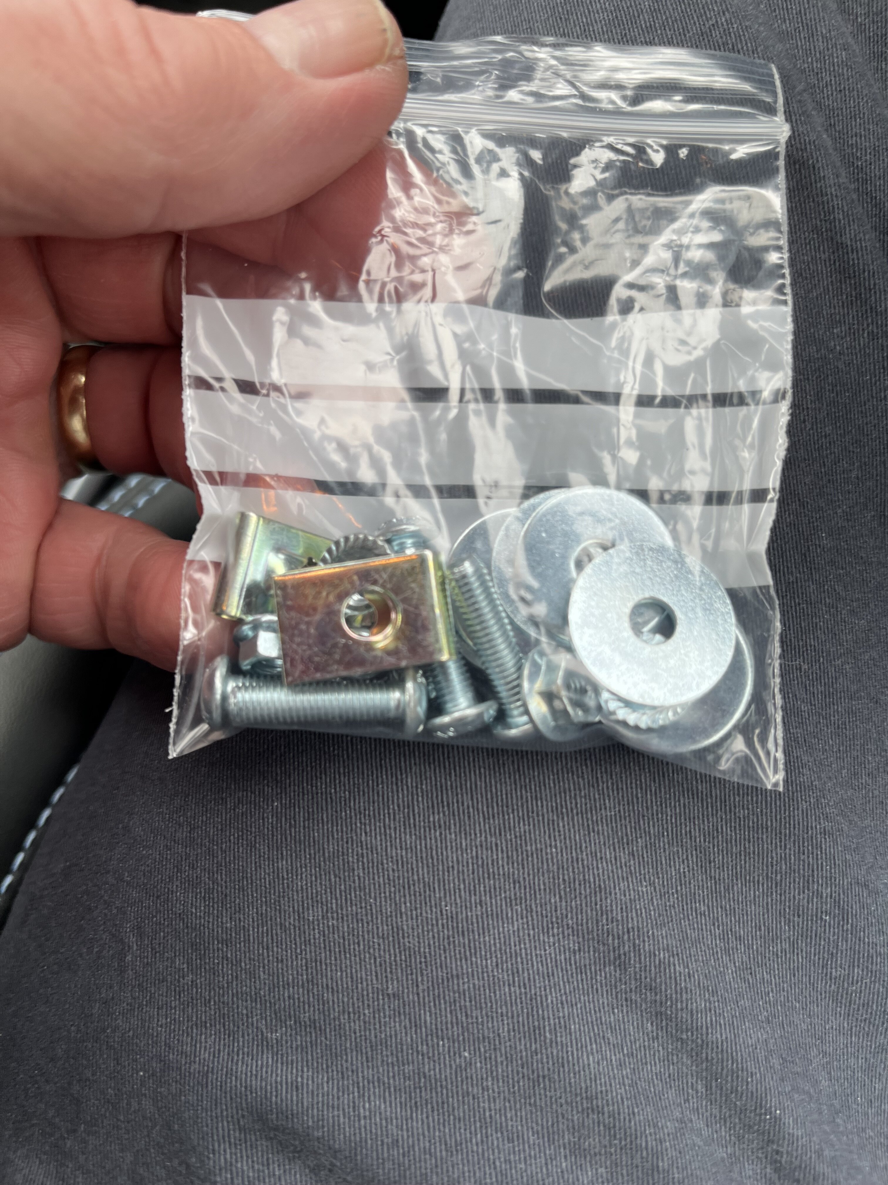

Waiting on some high tensile washers for the seat mounts and I’m trying some different seat belt receivers, slowly getting through a few things.

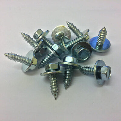

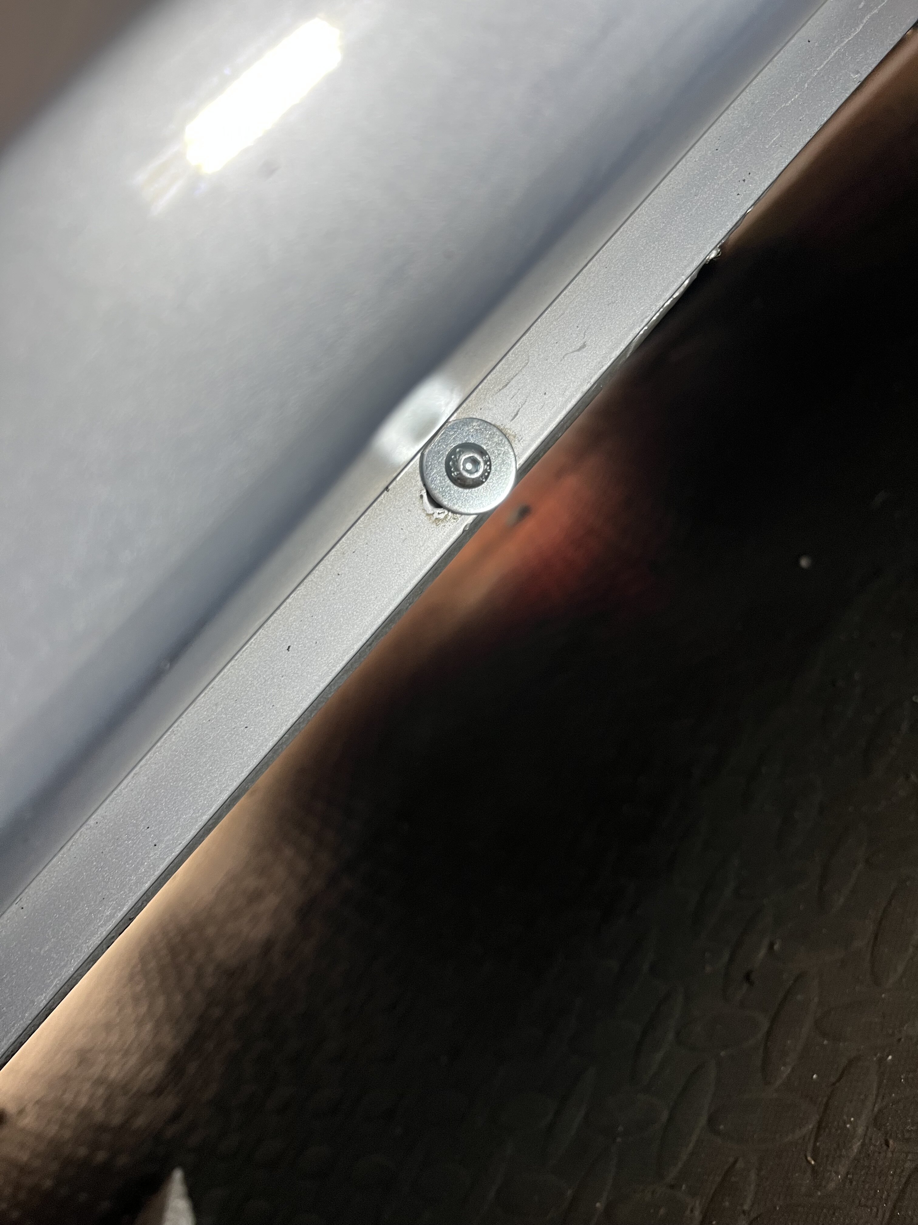

I used some M5 x 15mm Long Button head bolts with some penny washers & a flanged serrated M5 nut for my side skirts.
I did file a small flat on the washer to avoid hitting the curve of the side skirt.

I used these for the side skirts in place of the rivets. They are simple to fit. As long as the holes are still small they work well. If the holes are too big you'll need to fit a U-clip to the back of the sill for the bolt to screw into.
