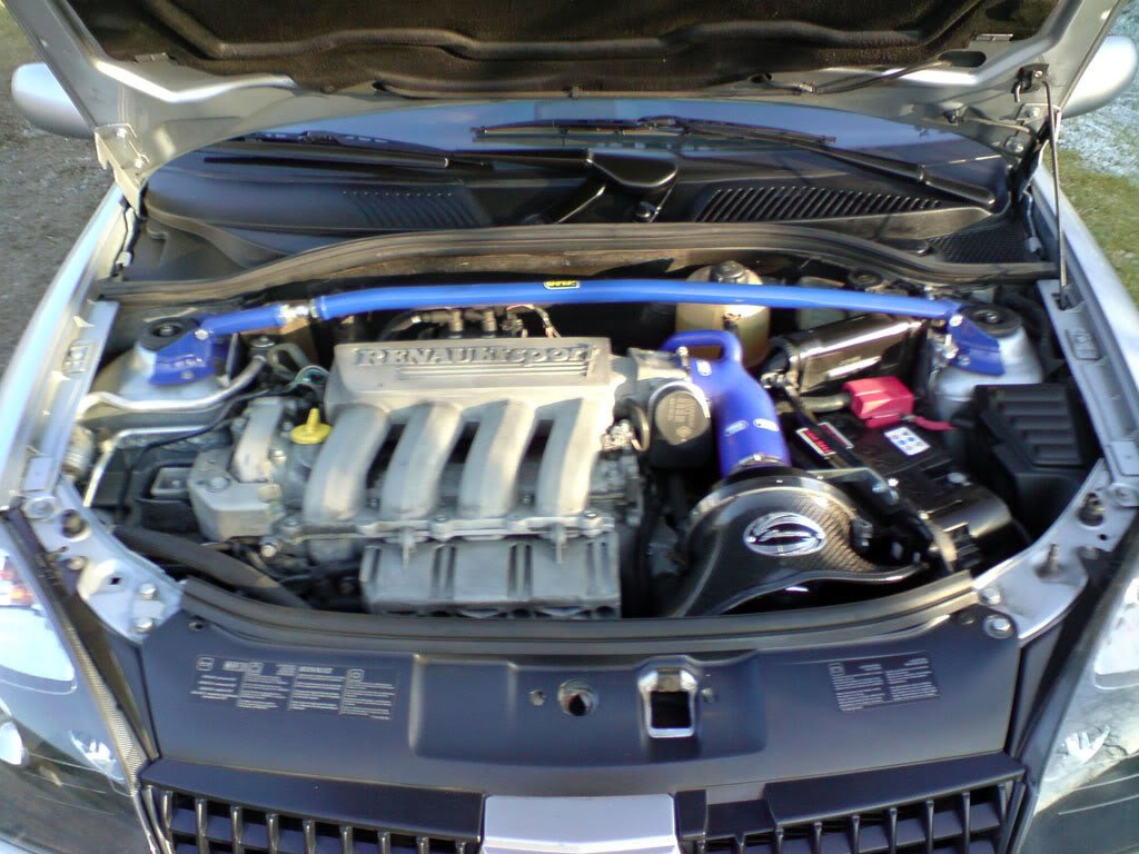

I've got a Carbon Aero Form fitted to my 172. Sounds great when you put your foot down and definitely turns heads! :approve:
There is a noticable increase in torque at lower revs and more power at the top end! :D
I've also extended the original cold air feed and angled it directly into the intake cone to provide more air flow.

This is mine fitted to my 172. :)
i brought one, and then tested inlet temps against a viper and custom cold air feed a few months later...needless to say the viper was kept and the simota sold....it definately loses power from heat soak! Inlet temps were over 10 deg C higher than with the viper and air feed!
heat = less power!
I sounded great though, but then so does the viper...especially with a yozzasport exhaust shouting with it :)
Whilst they do sound great, its unfortuanately just an open filter really so heat soak r us. All they do is suck in hot air straight off the radiator in that position.
The only one really worth bothering with is a Maxogen, and you don't get that much noise from it and ££££.
