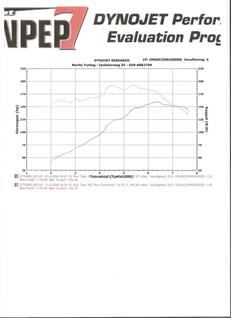

Before; power is at the wheels . Top lines are torque, in Newton Meters

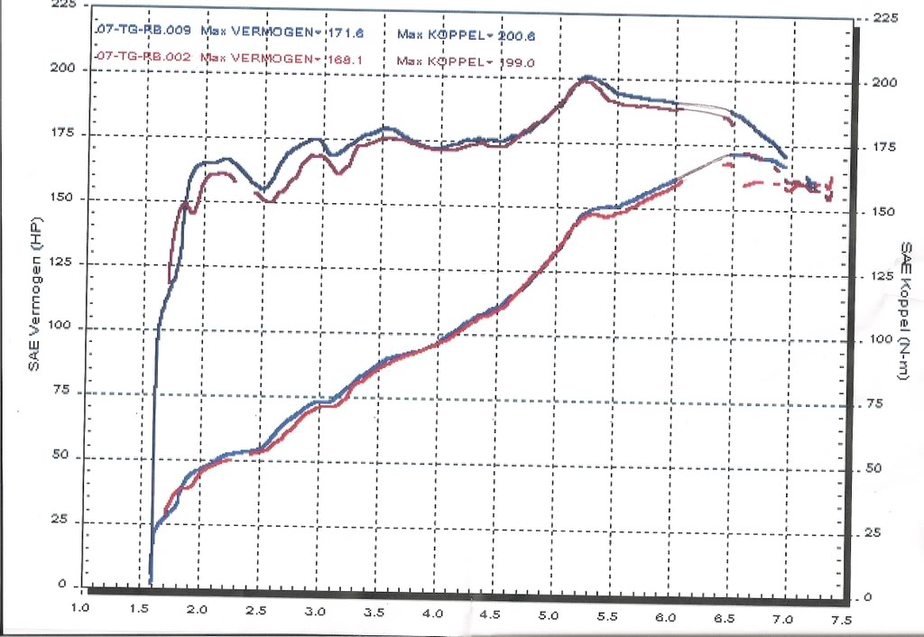

After ; also matched inlets like yours. Torque AND top-end improved
