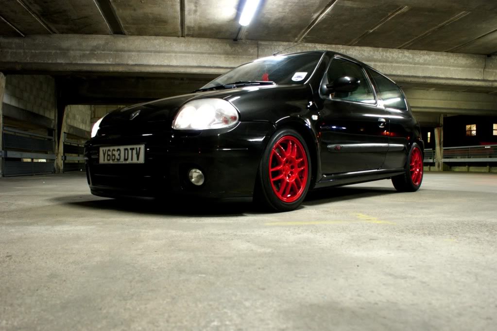

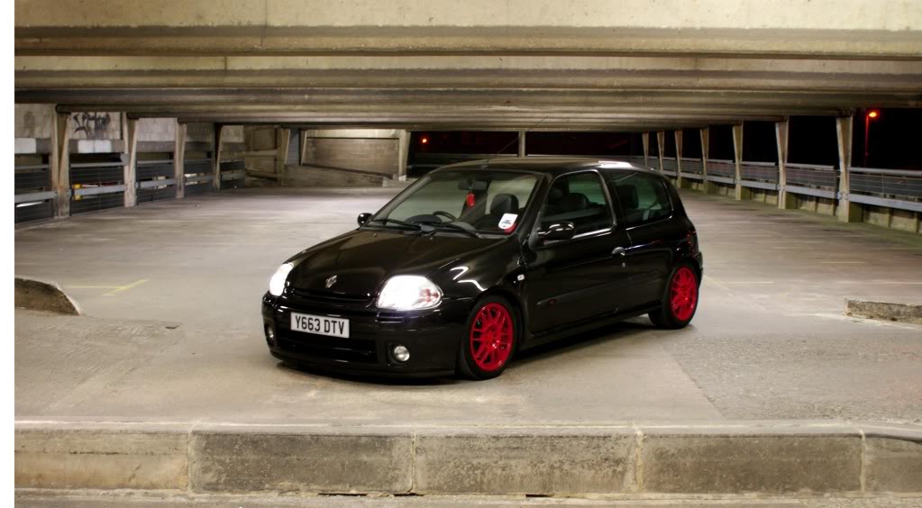

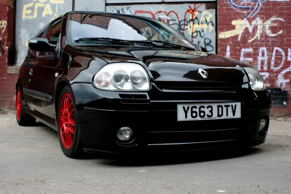

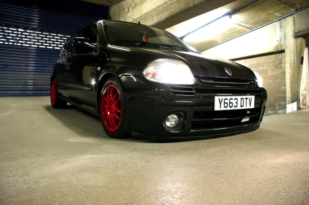

Thought I'd get myself a Fabia splitter, can't got wrong for £11.98 inc Vat. Easy to fit, just ended up cutting about 30mm off each end. Then gave her a bit of a clean.
Had a new clutch fitted this week along with the gearbox being stripped and a bearing and seal being replaced. So I went for a bit of a drive and afew pics, the transmission work has made a big difference and was worth every penny!

Very nice! Can't really see the splitter how hard was it to fit?
Really easy, took about half an hour. Trimmed the ends off the lugs on the splitter, clipped it in place, drilled 5 holes through the splitter and into the bumper, fixed in place with pop-rivets and cut extra length off.

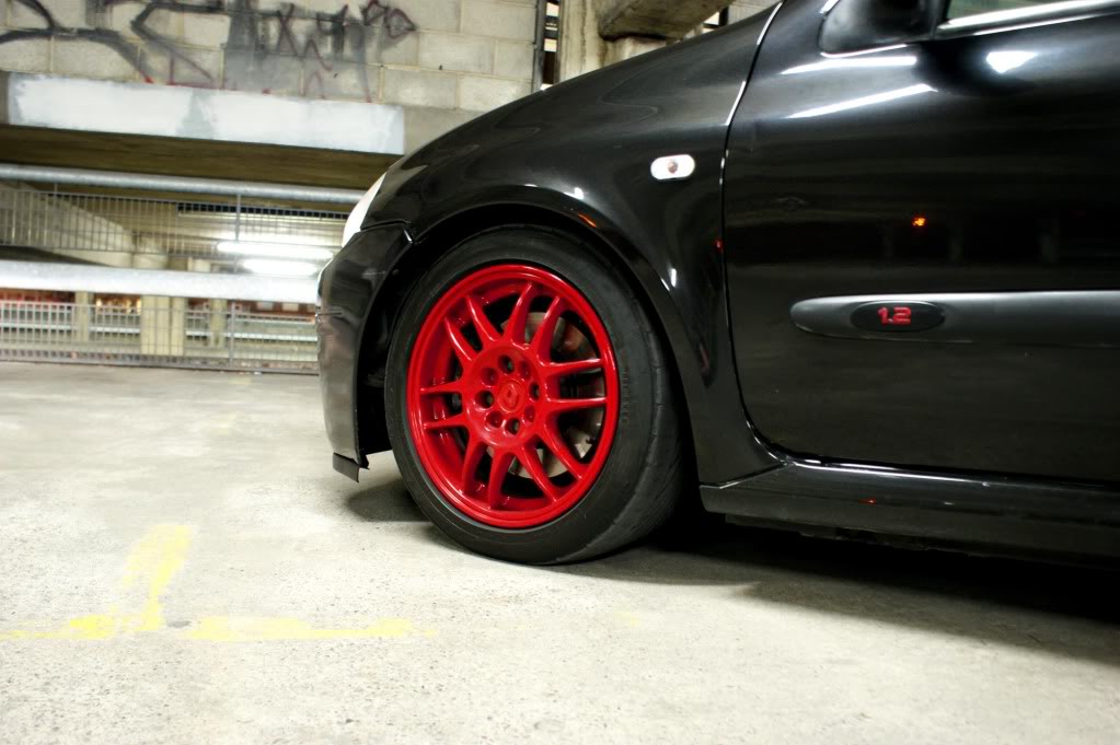

I thought the wheels might have been for sale this weekend, but my 16 inch Oz f1's don't fit.

The centre bore on my 16's must be something like 59.5mm, so the need opening up. But they are also 7.5 inches wide so will need spacers. I've had them refurbed and powdercoated aswell, so it hasn't been a great week for me along with the gearbox/clutch issue.
