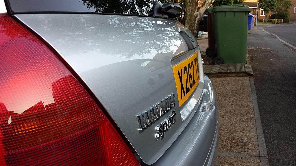

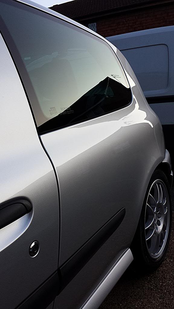

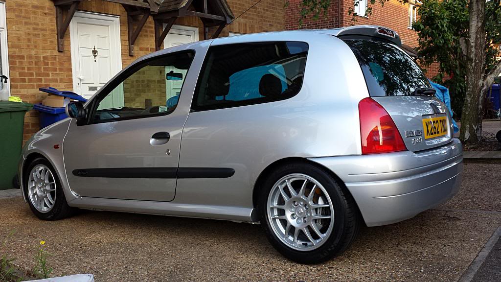

So thanks very much for the advice, Used AF Tripple and AF Illusion.
I think the results are very good, well im over the moon anyway. :D
Looks stunning chap. All by hand too?
Mr R.
  A special one.
I used my DA with a white hex pad and the Tripple, only needed to give it a very quick going over as the paint is pretty much spot on.
Then yeah the Illusion by hand, 2 panels at a time.

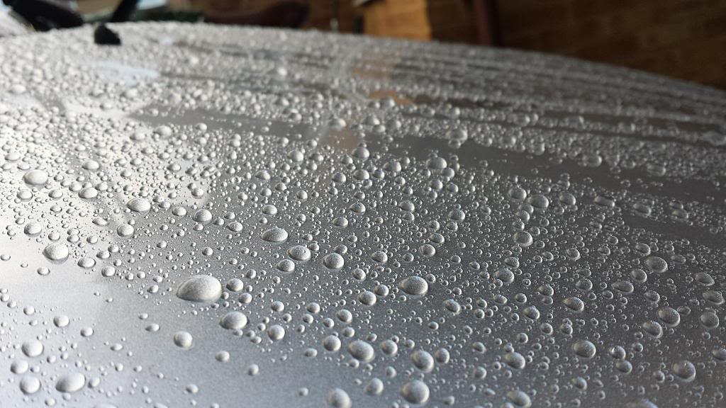

I have just treated the bonnet with C2V3 and the water behavior is amazing.
Great product, im impressed thanks Gally.

I think a wipe down on any wax with C2 will still look immense Dave.
Glad you're impressed mate. I'm on my 3rd bottle and i'm the biggest critic of products.
