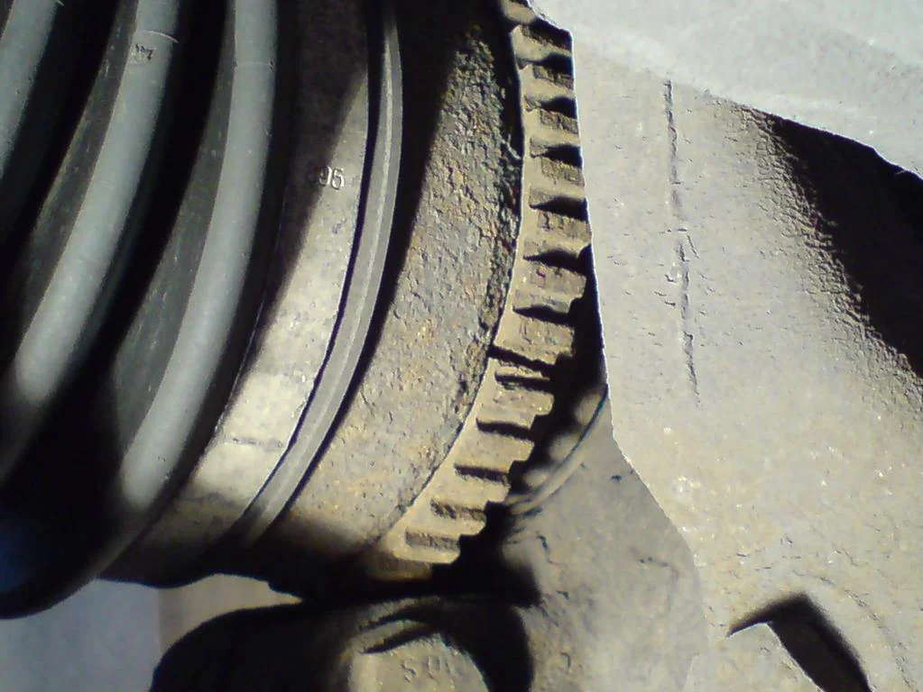

could be a broken abs ring on front drive shaft. seen this on a few other makes of car and have heard about it on here
  CLIO 172
Sounds like a cracked ABS ring or faulty / dirty sensor. Mines doing exactly the same, feels horrible doesnt it? Get under your motor and have a look where your drive shaft meets your hub / disc see if you can find anything like the pic ive attached.
Mines cracked on the front passenger side - but check all 4corners!!
I rang the stealers to get a replacement and they couldnt tell me a part number and said I would have to have a whole new drive shaft!!!
I managed to get one off ebay yesterday, which I intend to fit on Friday, so ill let you now how I get on and whether its the right part when it arrives.
