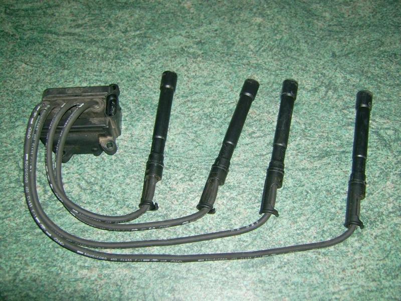

Is this the coil pack your refering to? Is there a reason why this particular part is prone to dmg?
yup thats the coil pack, Always go wrong on the 1.2 16v's for some reason edde or brian will tell you soon probably, as does the tdc sensor :)
