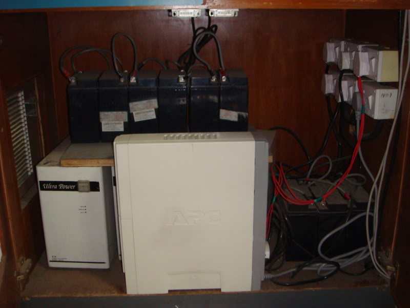

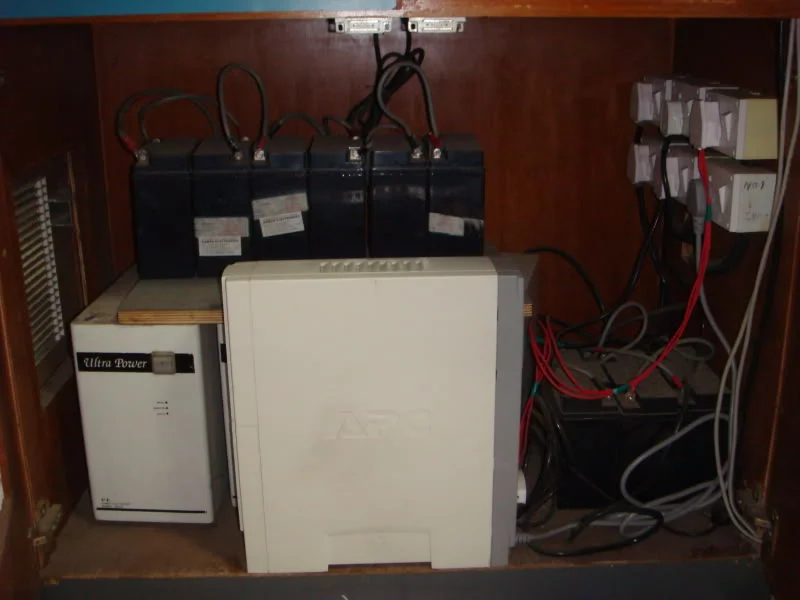

You should have seen the "UPS" they had when I was doing a rollout in India.... check it out!
  DCi
that's quite impressive...
