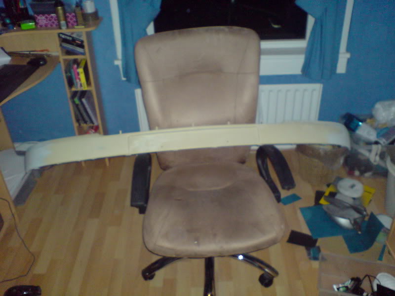

after seeing laura's old hologram i had an " I WANT" moment when i saw her bumper so been putting in a few hours and coming home at lunch, hopeing to get it painted friday/saturday. before any of you say it will just crack shhhhhhhhh i've used a few methods and the latest seems to work and past the ultimate crack test ( holding it in the middle and flapping it up and down ) lol
plastic weld on the back using another peice of moulding i had as the weld material, lots of hot glue, super glue!!!!, filler etc, its pretty solid but still flexible if you know what i mean. iam pretty confident it will work but only time will tell

it wont crack, but over time it'll sag down, especially if you need to use filler on it.
if i was doing it again it would need to be stikaflex'd down, and then plastic welded around all the edges as thats where you'll get movement and therefore sagging. mine lasted a while, but once it started to go it was forever in and out of the bodyshop.
