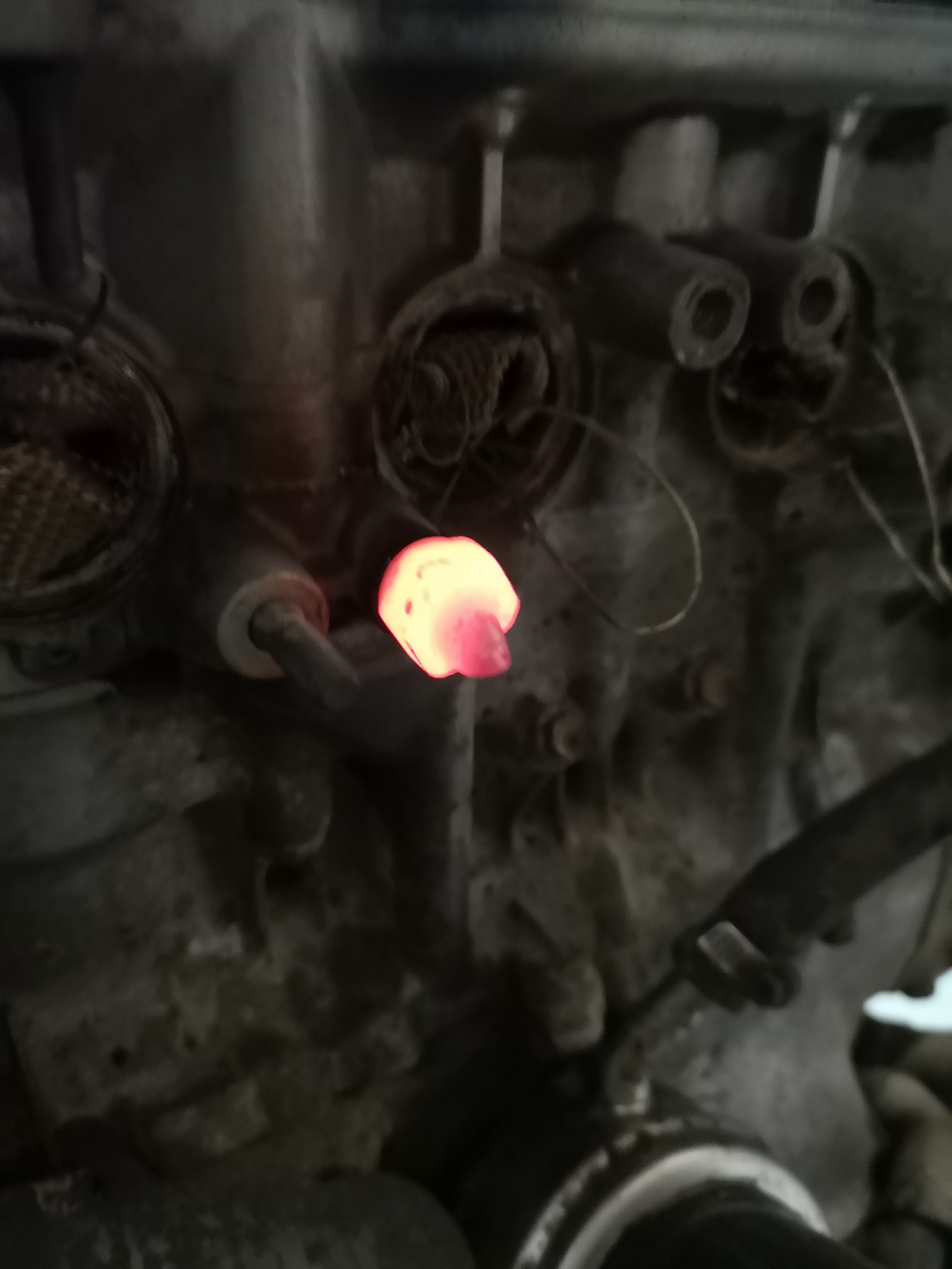

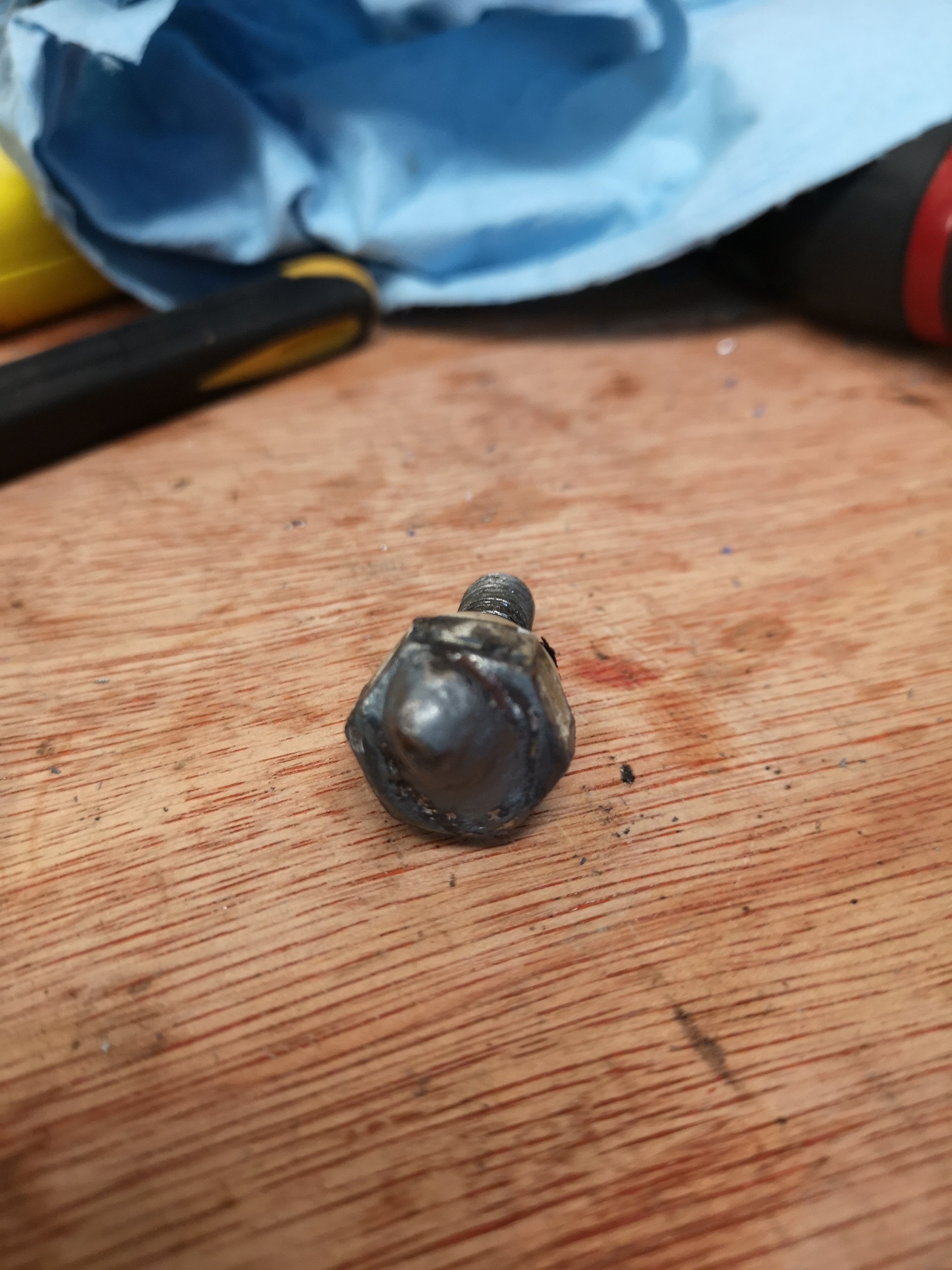

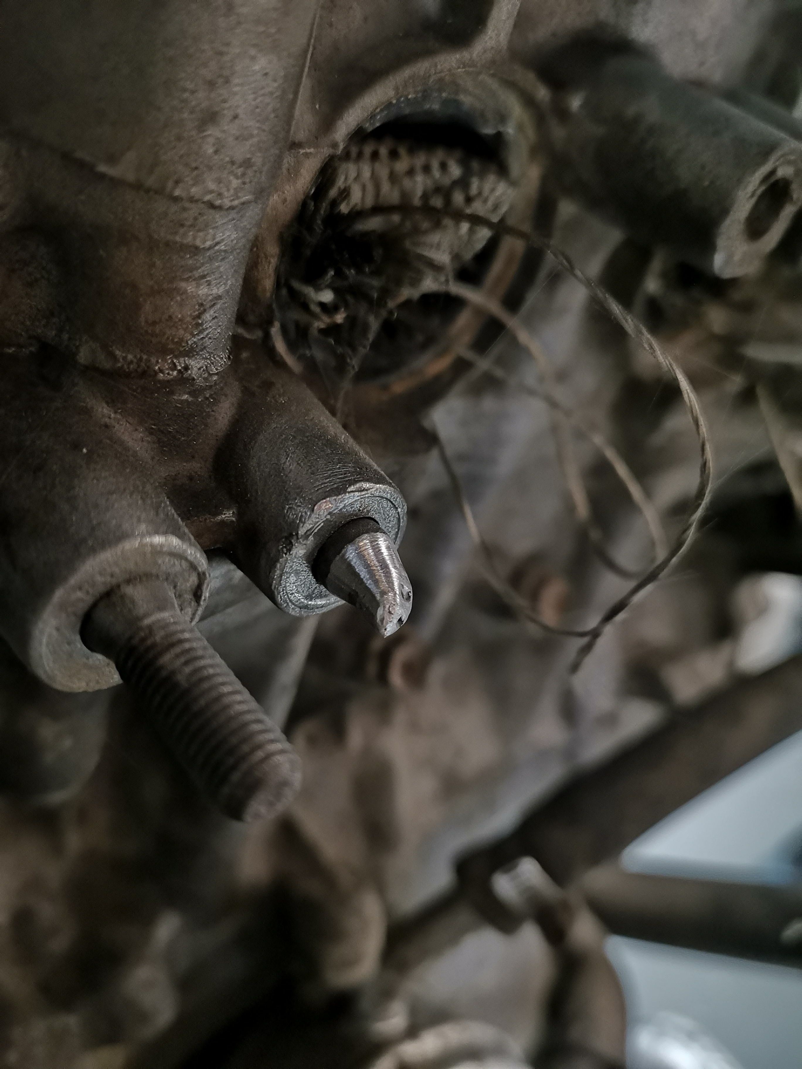

Welding a nut on has never failed for me, getting this exhaust stud out of my old CBR600 did cause a minor garage fire though 😂

Makes little difference really, a few mm protruding to hold the nut in place is ideal, then you can fill the nut with weld
and get plenty of heat into what's left of a bolt/stud/etc
