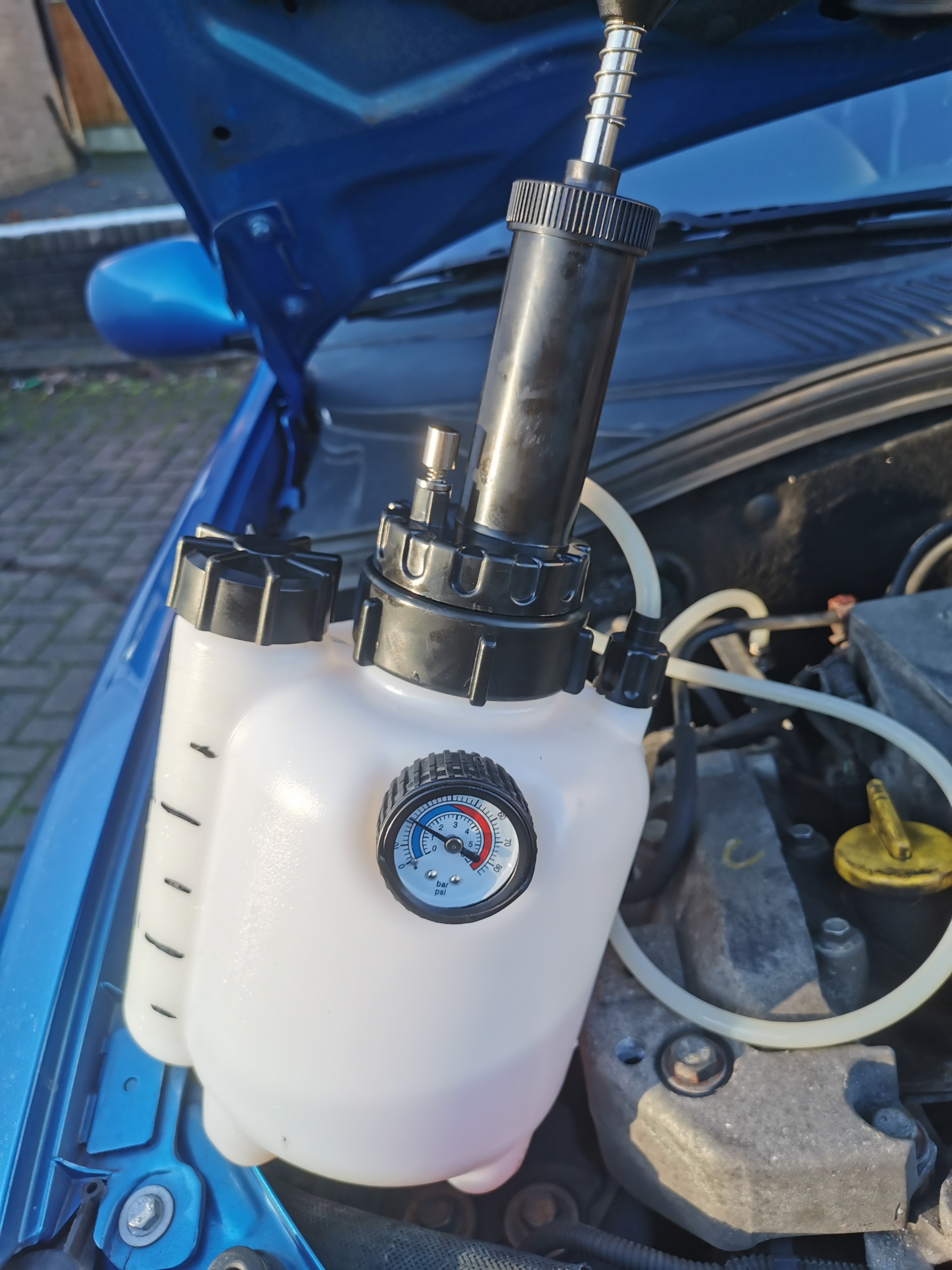

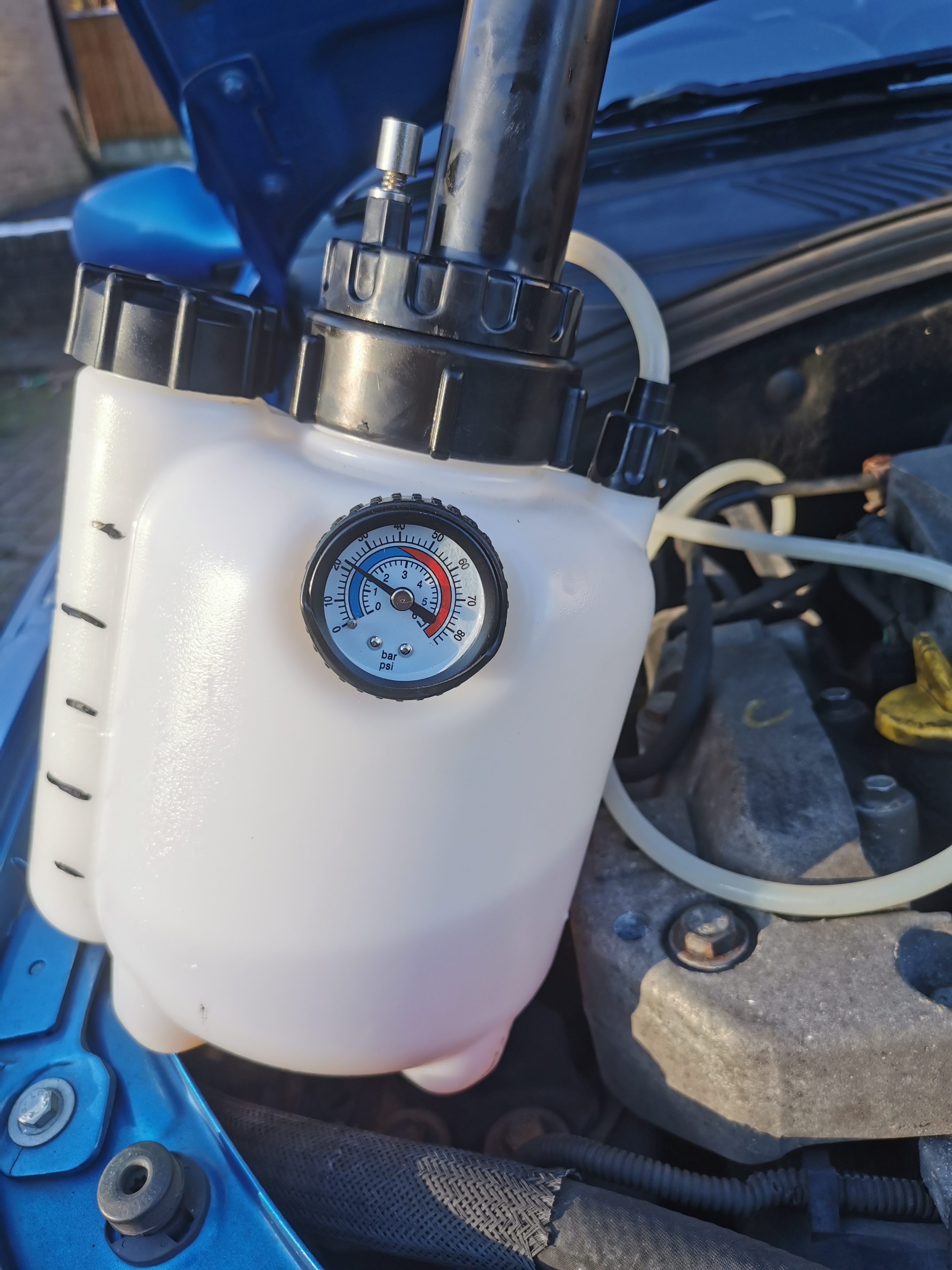

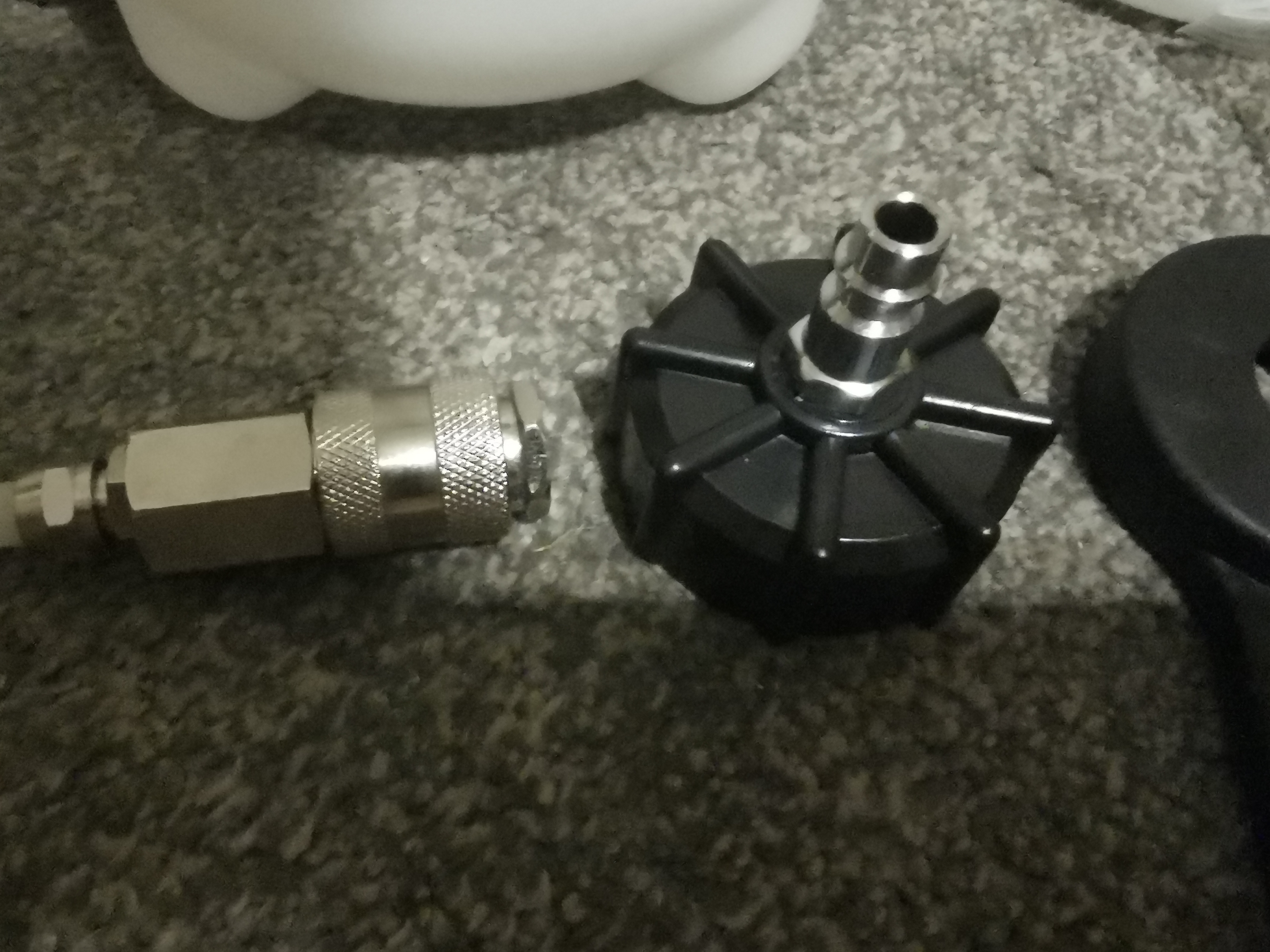

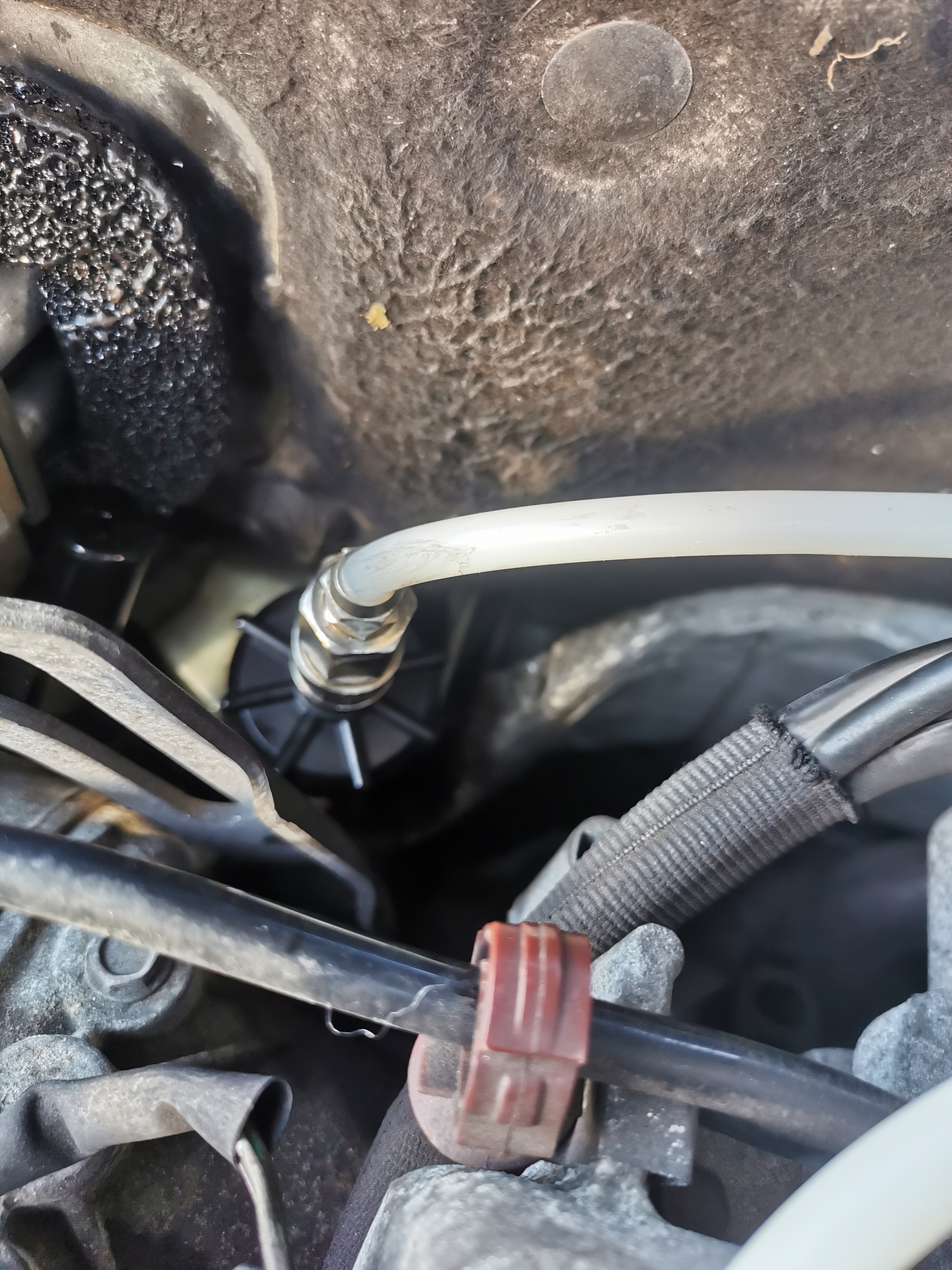

Just a bit of a heads up for anybody contemplating buying an Eezibleed pressure bleeder.
Don't waste your money.
I bought an Eezibleed a few weeks ago. It worked first time, but when I came to use it again a couple of weeks ago it pissed air out from a couple of places, so I took it back and got my money back.

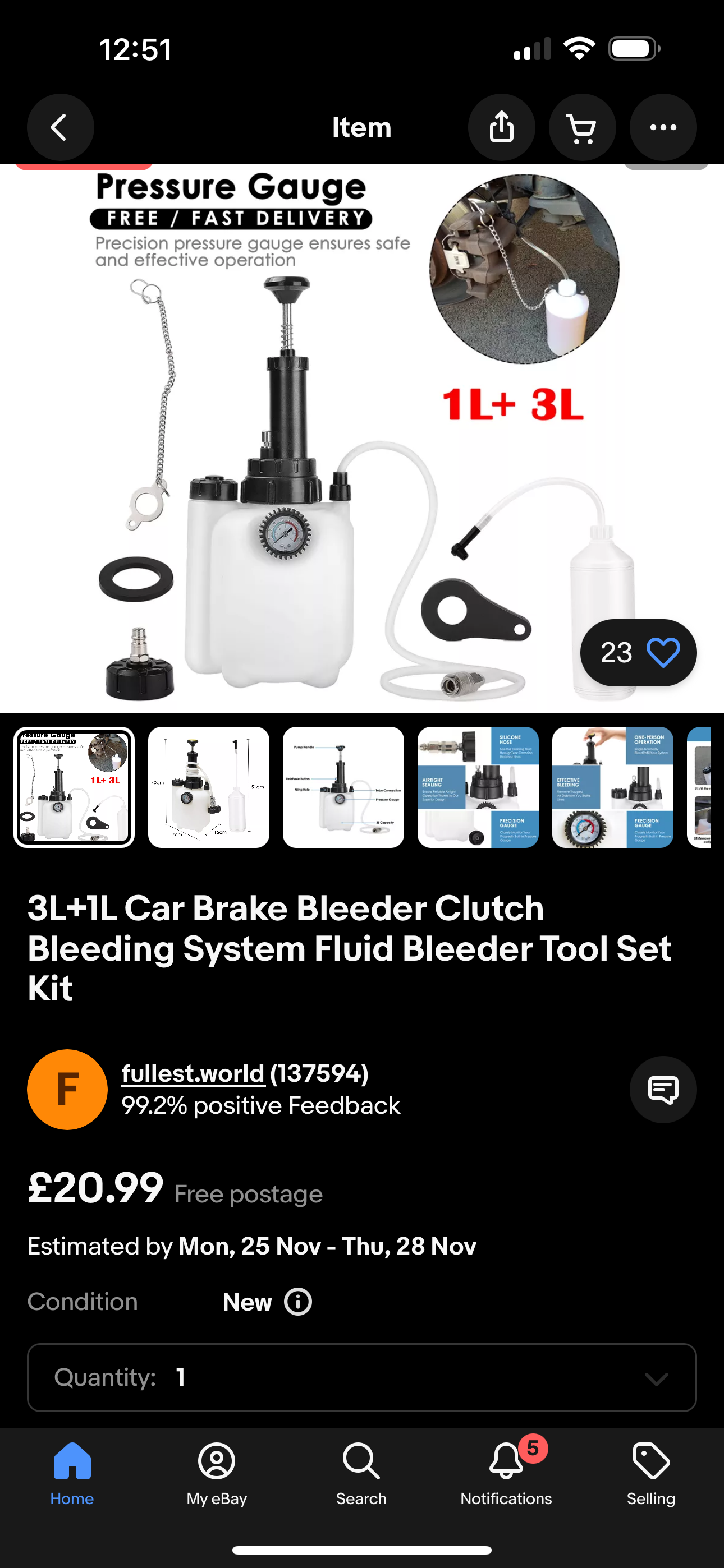

I'd seen these generic pressure bleeder on Ebay so thought I'd take a punt. For £22 it's the same price as an Eezibleed.

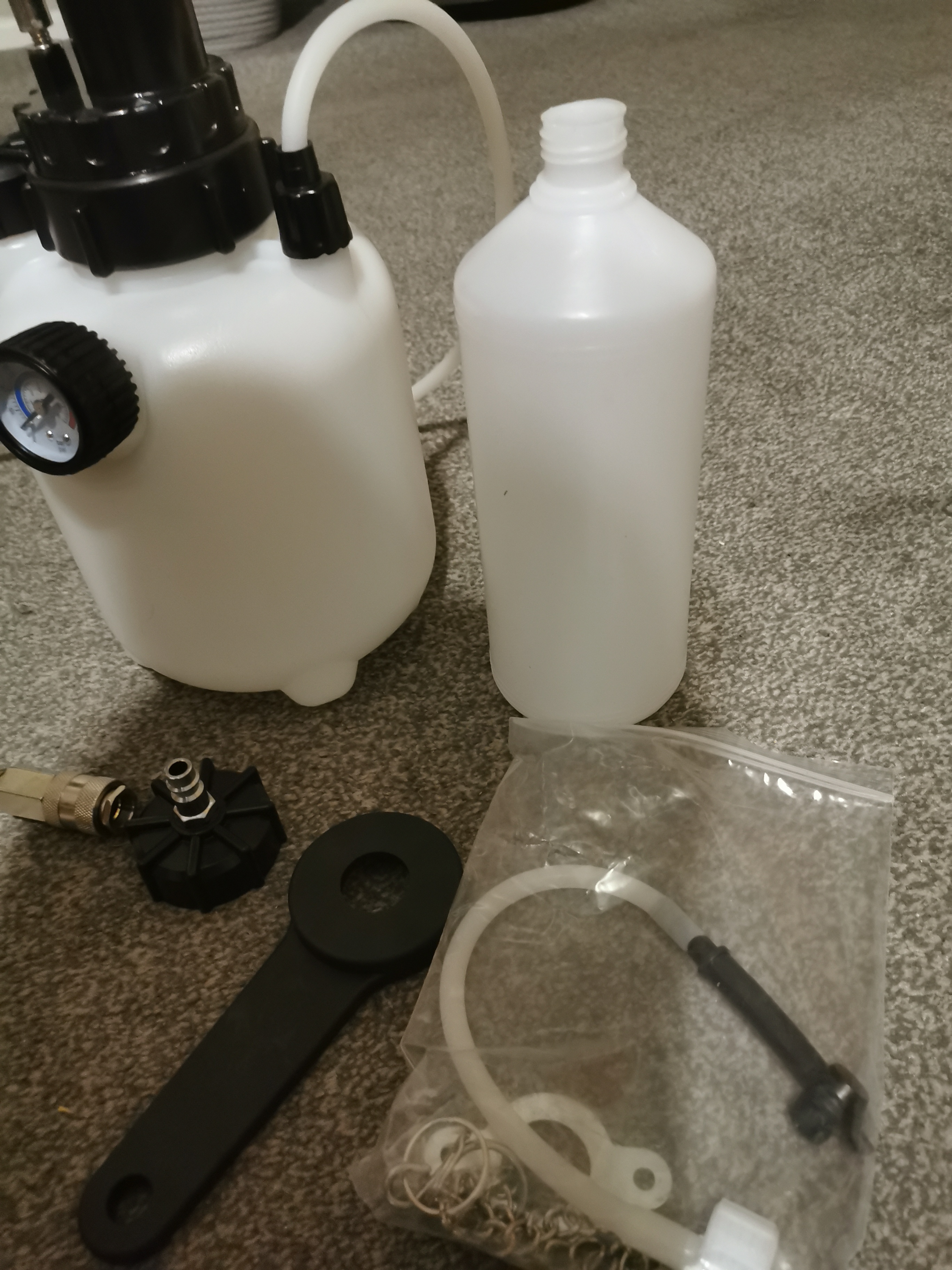

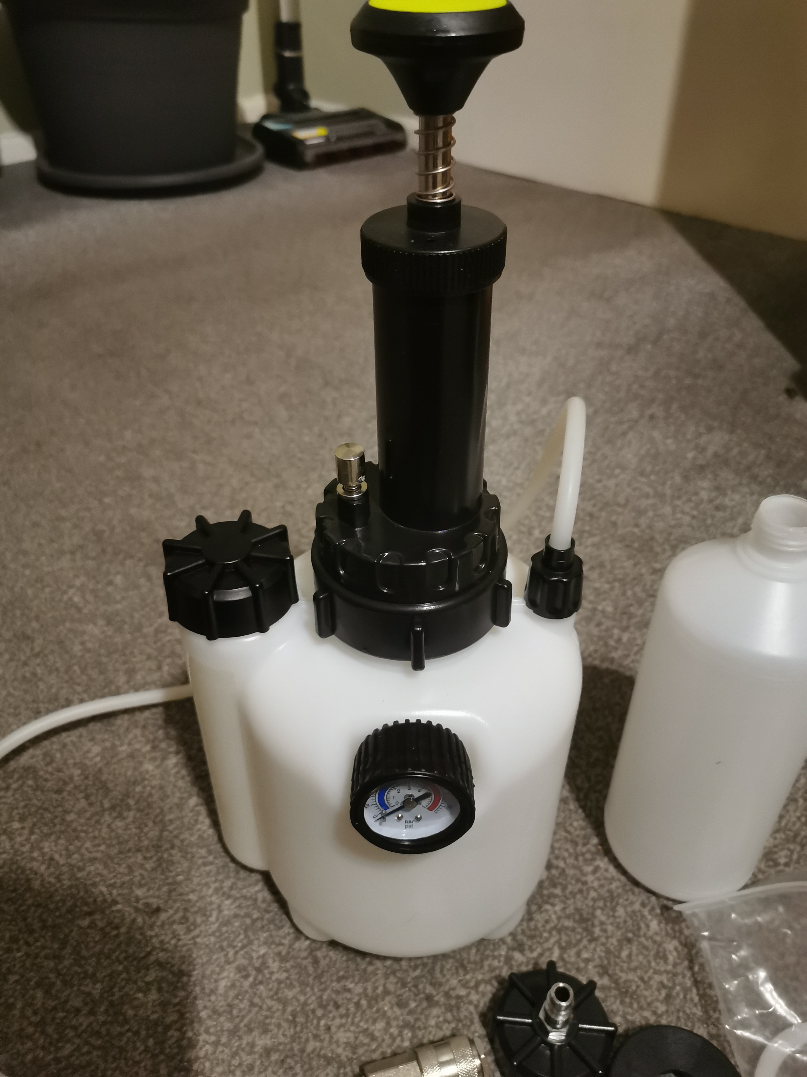

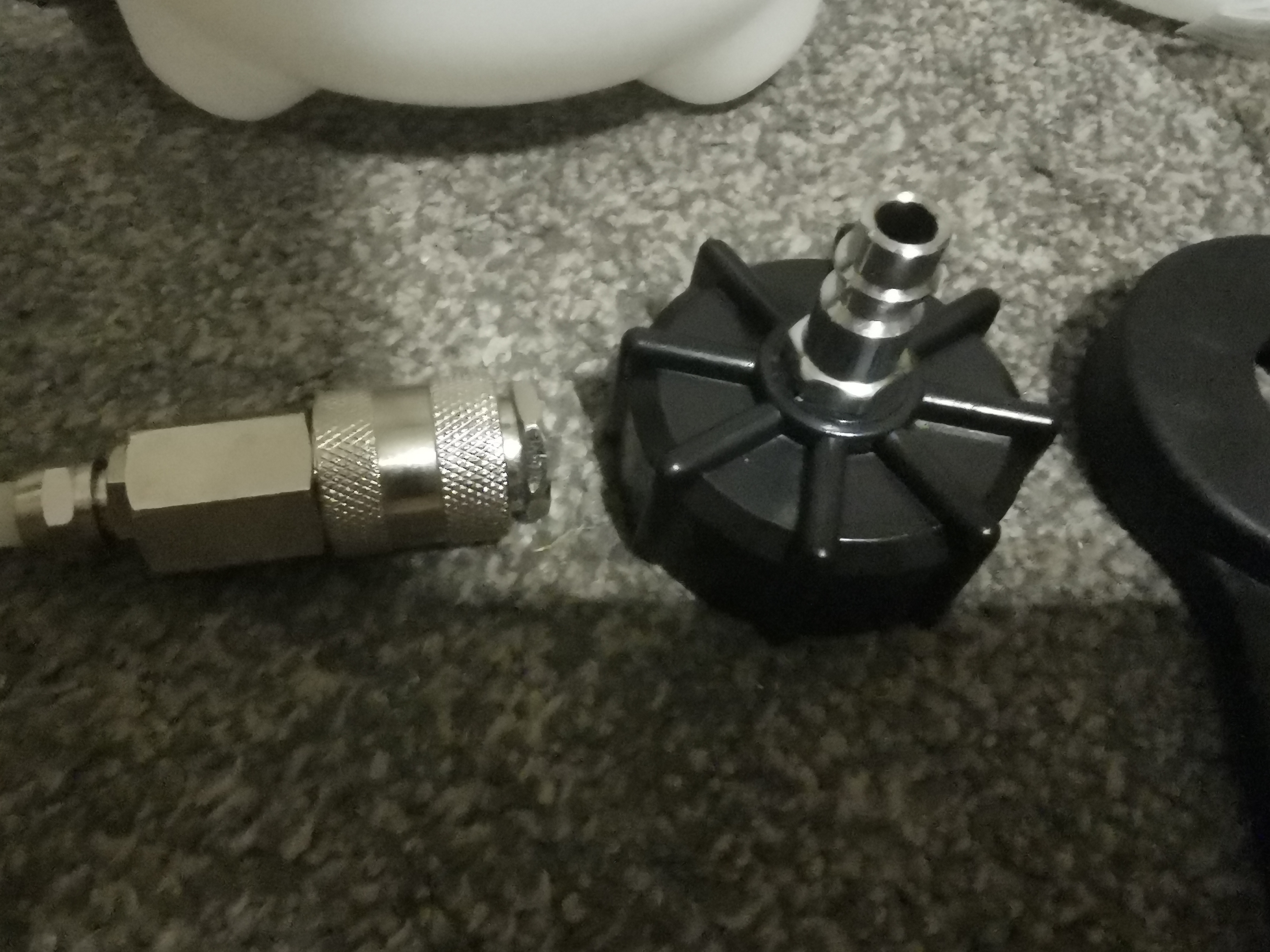

What a good bit of kit. You can tell instantly it's much better quality than the Eezibleed. It's put together with much more robust, quality components.
It holds 3 litres of brake fluid. It has a stainless push fit onto the cap, so you can disconnect it when it's still pressurised. It comes with a tube to put onto the bleed nipple, a bottle to bleed the brake fluid into and a spanner type tool to tighten the cap onto the brake fluid reservoir. I didn't need to use the spanner, I tightened it by hand. I also used my own tubing and bottle to bleed into.
I used it again yesterday. What an absolute breeze to use. I ran it at 20 psi and it was spot on. I added increments of 500ml myself with a marker pen. View attachment 1720354View attachment 1720355View attachment 1720356View attachment 1720356View attachment 1720357View attachment 1720358View attachment 1720359
It's had a good wash out with hot, soapy water so ready to go again whenever I need it.

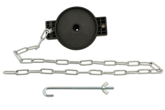

Mine only came with the one cap, did you buy the different caps separately, if so have you got a link?
