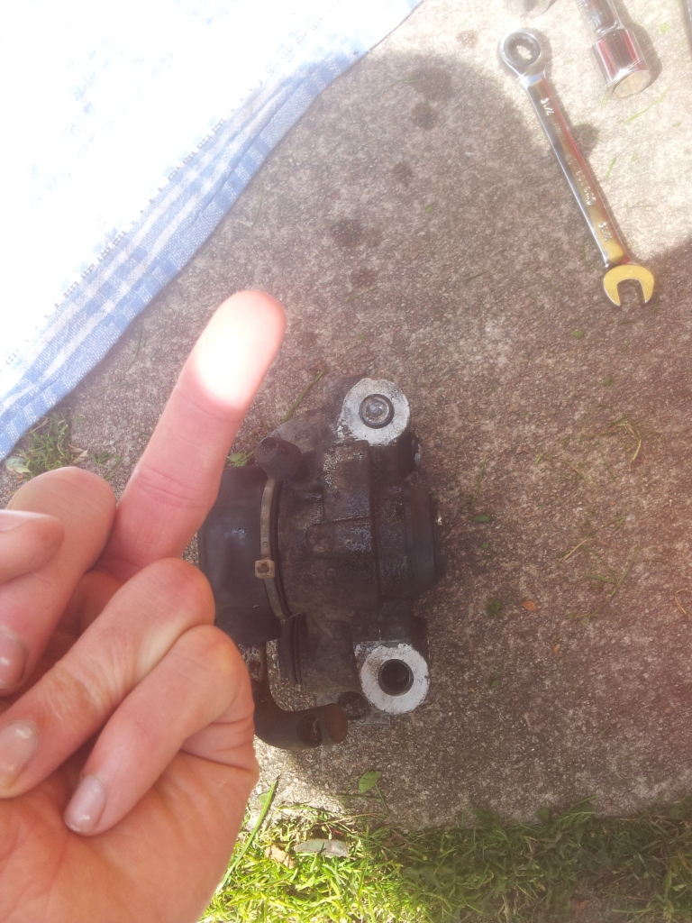

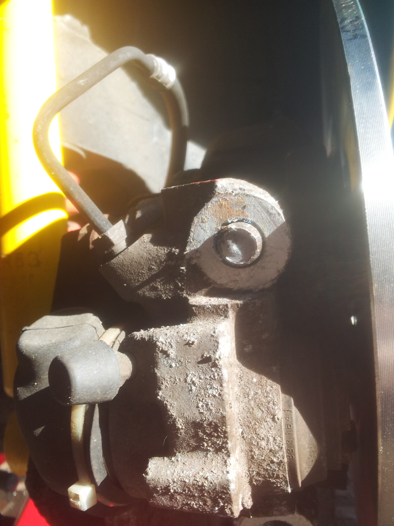

Fitted my new brakes today, one issue:
What the f**k can I do about that?? :(
drill a small hole in the centre of the bolt, (doesnt have to be extremely deep)
hit a allen key bit into the hole you made, then use mole grips to twist the allen key until the bolt is out...
you may have to re-thread the hole if it has cross threaded, use a tap and dye set for this :)
hope this helps fella :D
  182 Cup
Could also do the above but use a stud extractor (if you buy one ofc) where you tap the extractor into the hole, then try to undo as per normal. The Allen key method is worth a go at first to save cost :)
May try this though first

impact guns are so much safer for removing bolts, hanging off a bar puts a nasty constant stretching force on. Always try and use a jerking motion to crack off tight nuts and bolts. Being a steel bolt into aluminium really doesn't give you a good chance from the start. Bi-metallic corrosion is so hard to solve
Thank you for the tip. It was very tight with the ratchet so I attached my giant costco jack handle pole and used it as a breaker bar, always works a treat but it just snapped :( Lesson learnt.
  Liquid Yellow 182 FF
No luck so far trying to drill it out. Put the Allen key in and tried to turn but it keeps spinning inside the whole.

Doesnt have to be an allen key, have you got an old torx bit or old screwdriver bit you can knock into the hole ?
Or if you can add a bit of heat but be carefull not to boil the brake fluid though

Tried all of those methods mate and no luck, its proper tight in there so I'd have to use proper force to get it out, everything I try just spins in the hole I've made. Probably going to wait for my mate to bring the caliper round later.

Someone suggested sawing a line across it and using a flathead to turn it out but I think its to tight for that personally. Thank you, hoping to have it sorted this evening.
I would cut a slot in the head if it was sticking out enough, then heat it up a few times being careful of the brake line (not sure weather that would be safe though tbh) and on the last heat get a large flat object in the slot, try and smack it loose and then twist out.
I might get one of those stud extractor sets, look handy!
I'd just keep upping the drill size till the outer walls of the bolt were thin enough that you can push them inwards with a screwdriver.
Keep it perfectly straight to preserve the threads though.
Yeah was thinking that, alot of drilling though :(

IMO drill it out, starting with a 1 or 2mm drill and working your way up. Use some drilling/cutting oil as it speeds thing up a lot. You could try an extractor, but by the looks of it, its not gona move so the extractor will probably just slip or snap.

Right, I give up with this bloody thing now! Had the caliper completely off, drilled into it, turned the extractor into the hole (second to largest one) started to try and turn it and snap! The extractor has now snapped in the hole ffs!! Luckily, my mate has just phoned to say he has just found a 182 rear drivers side caliper and I can have it on Friday morning, so I'm just going to swap it over then, much easier and saves me wasting more time!
Got it all sorted now, swapped calipers over, jobs a gooden! Thanks for the help chaps.
