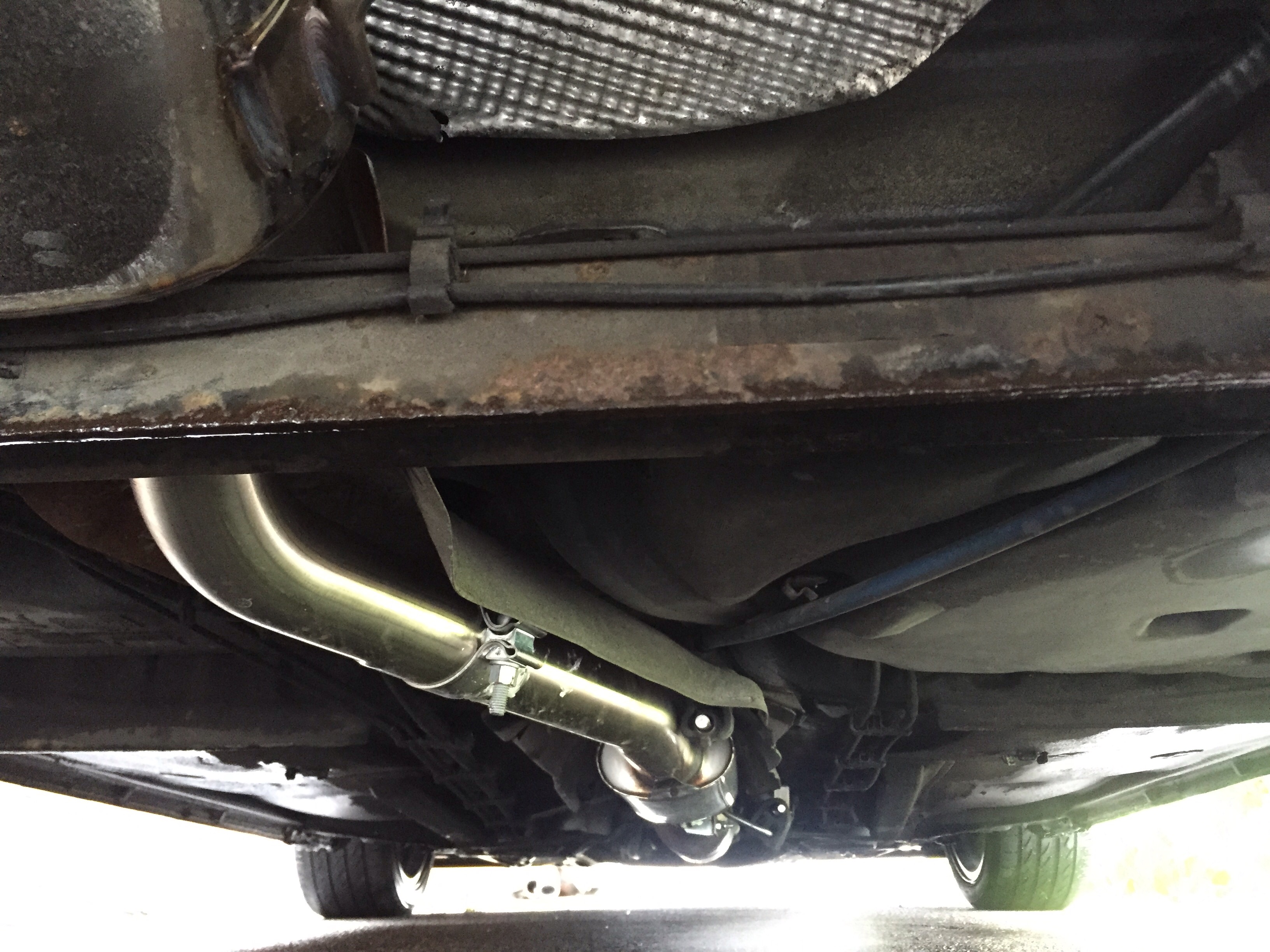

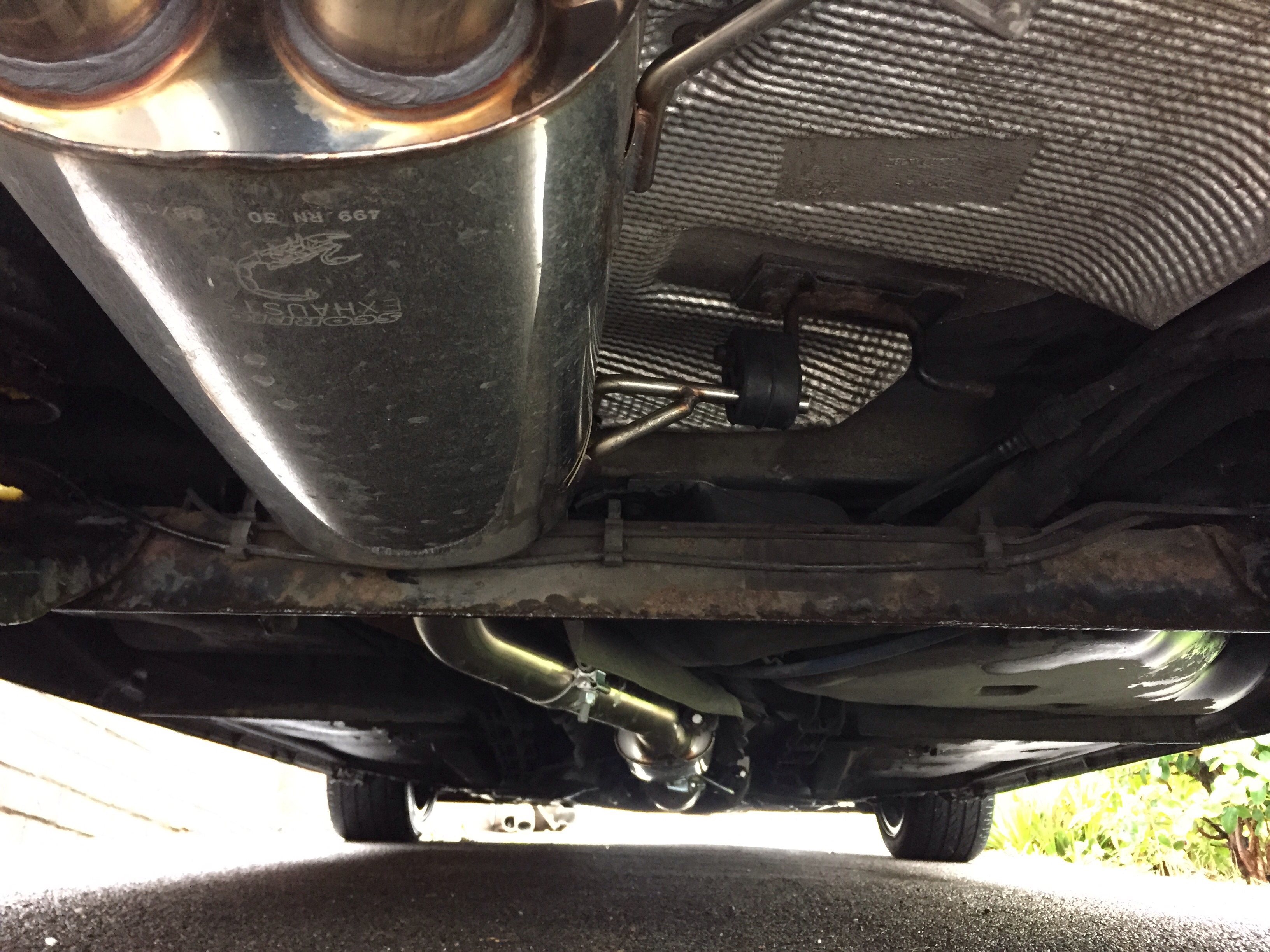

Scorpion exhausts aren't that loud tbh, you say an extra bracket was fitted to get it straight, can you get pics of it? I reckon the exhaust is now mounted directly to the underside of the car with no damping. Hence the drone.

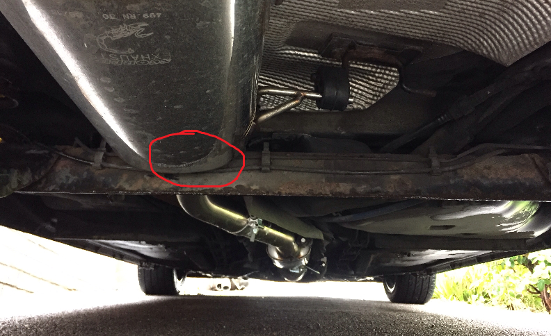

Get some underside photos of it up here and lets have a look, suspect it may be fouling the rear beam, if not then you might have to get a centre box for it or resonator, or sell up cut your losses and get a Rs192 or exchange it somehow..

I will get some photos up of the underside ASAP and hopefully someone might be able to see if anything is wrong.

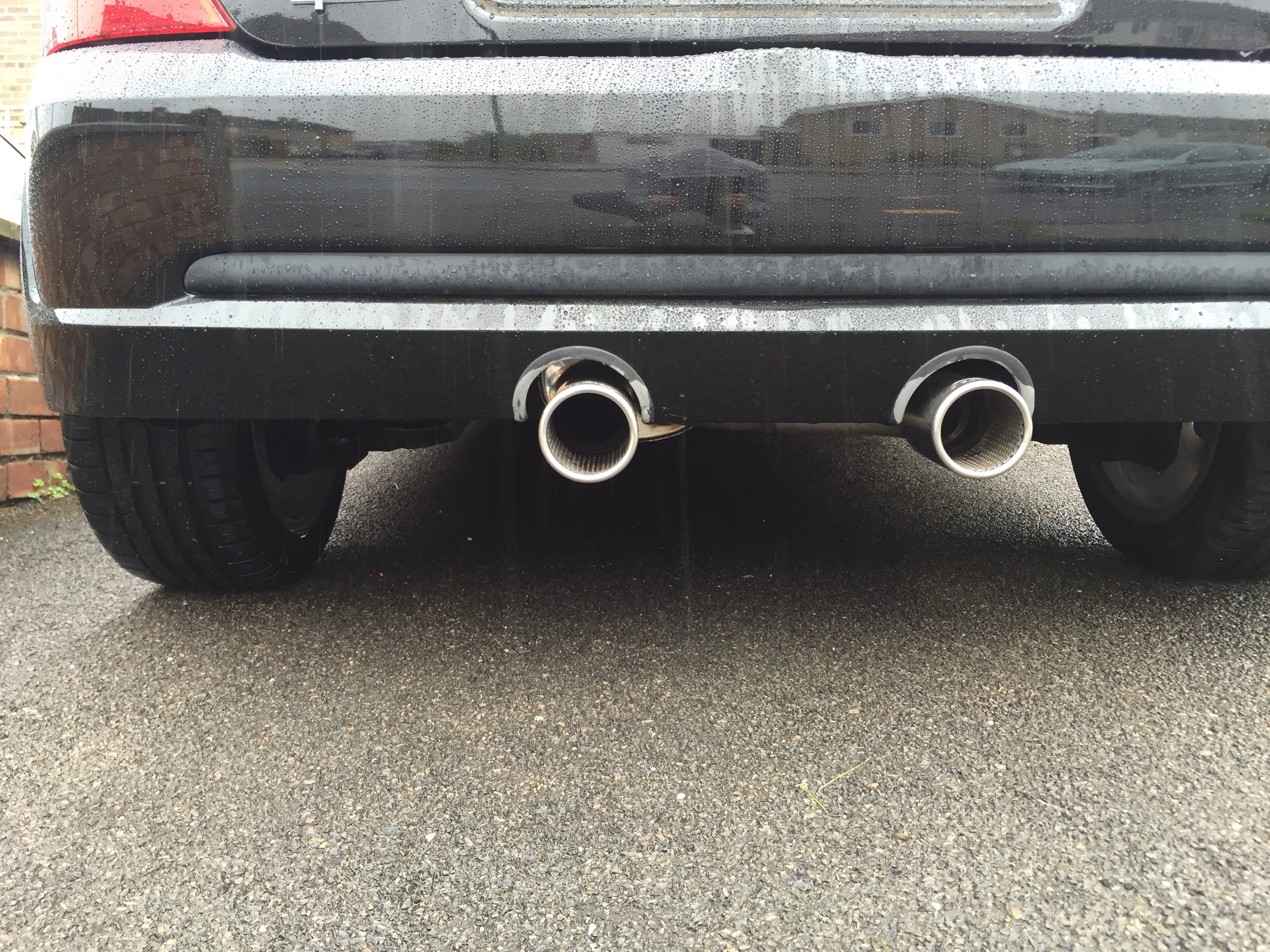

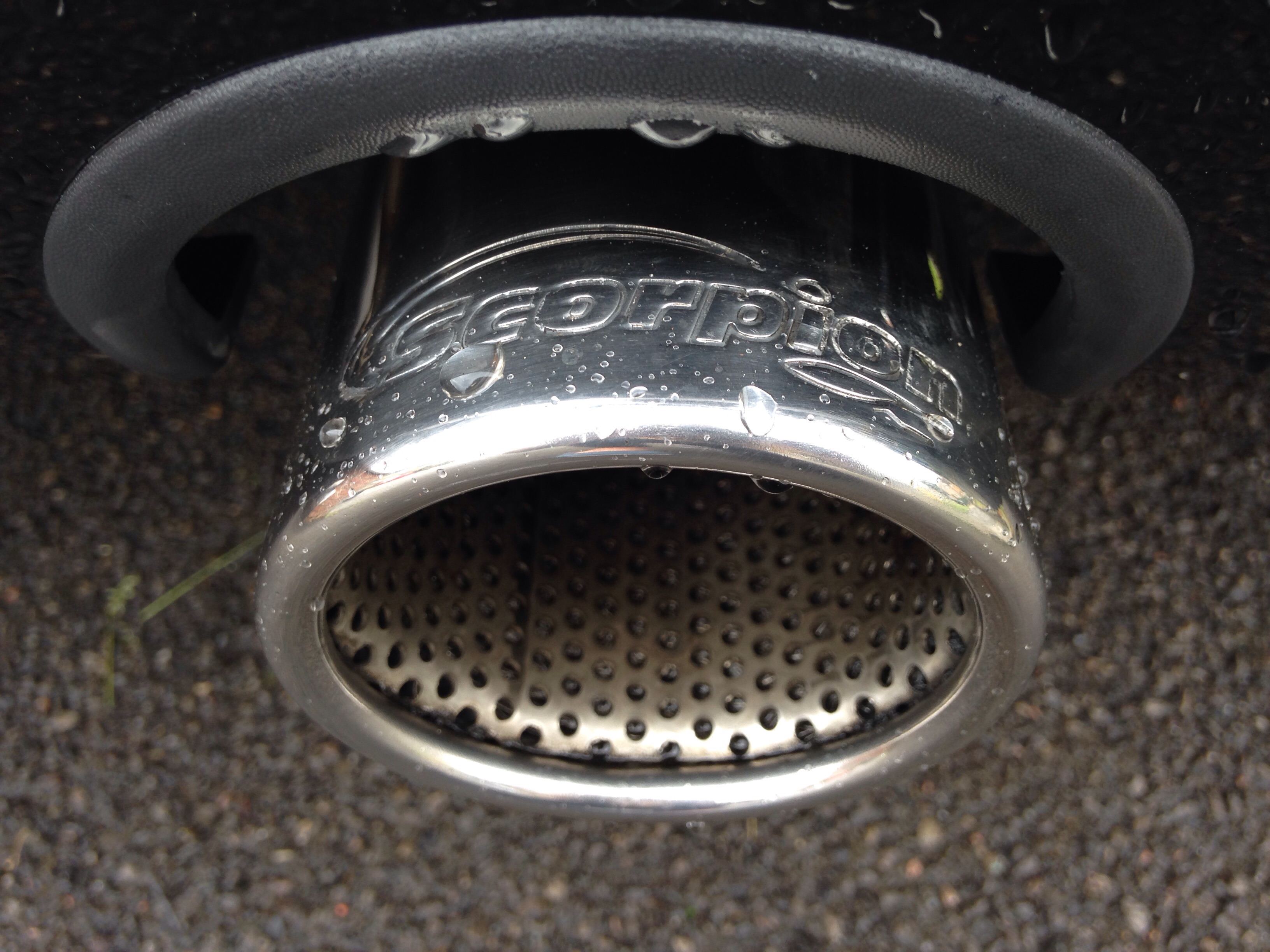

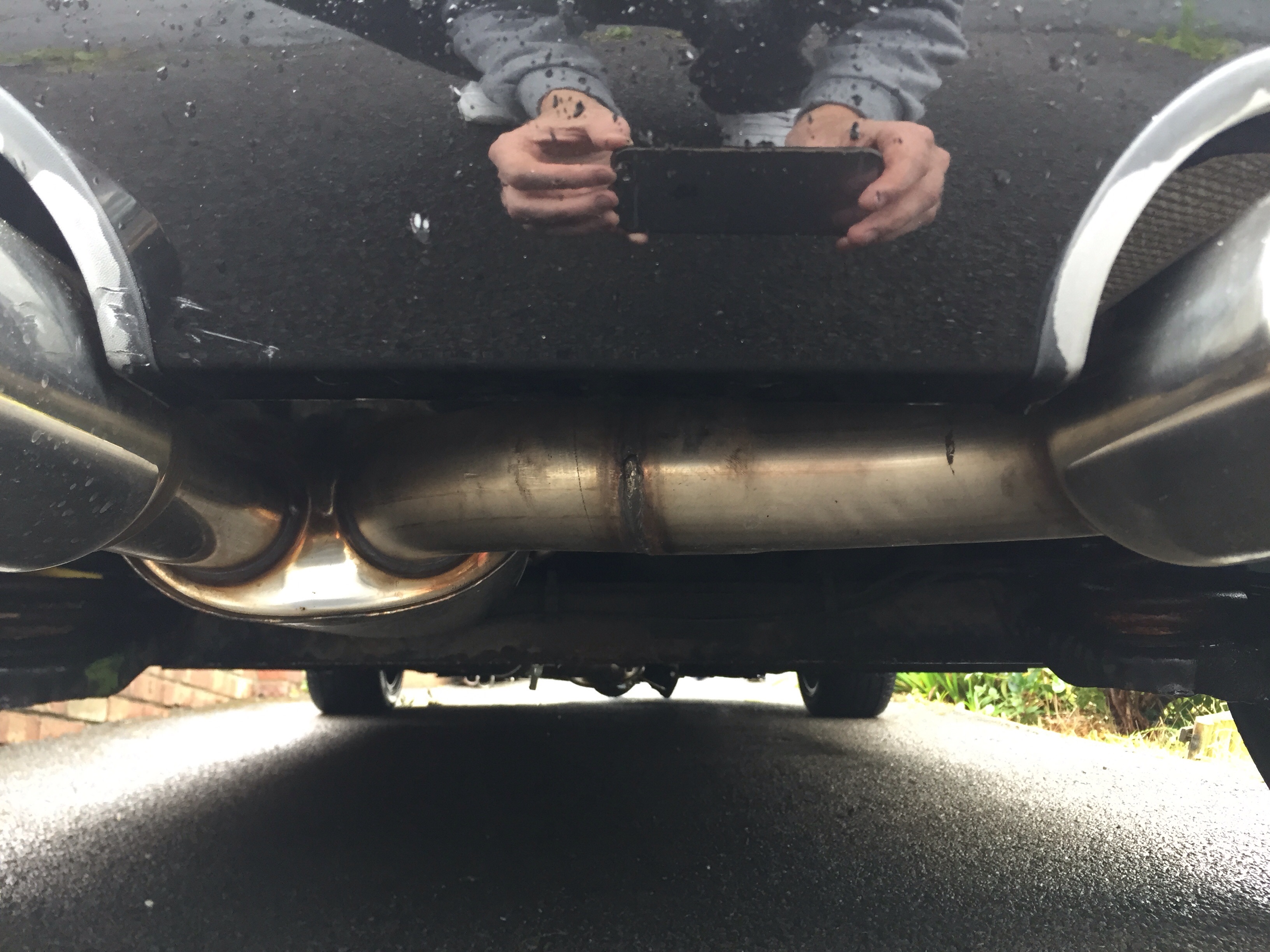

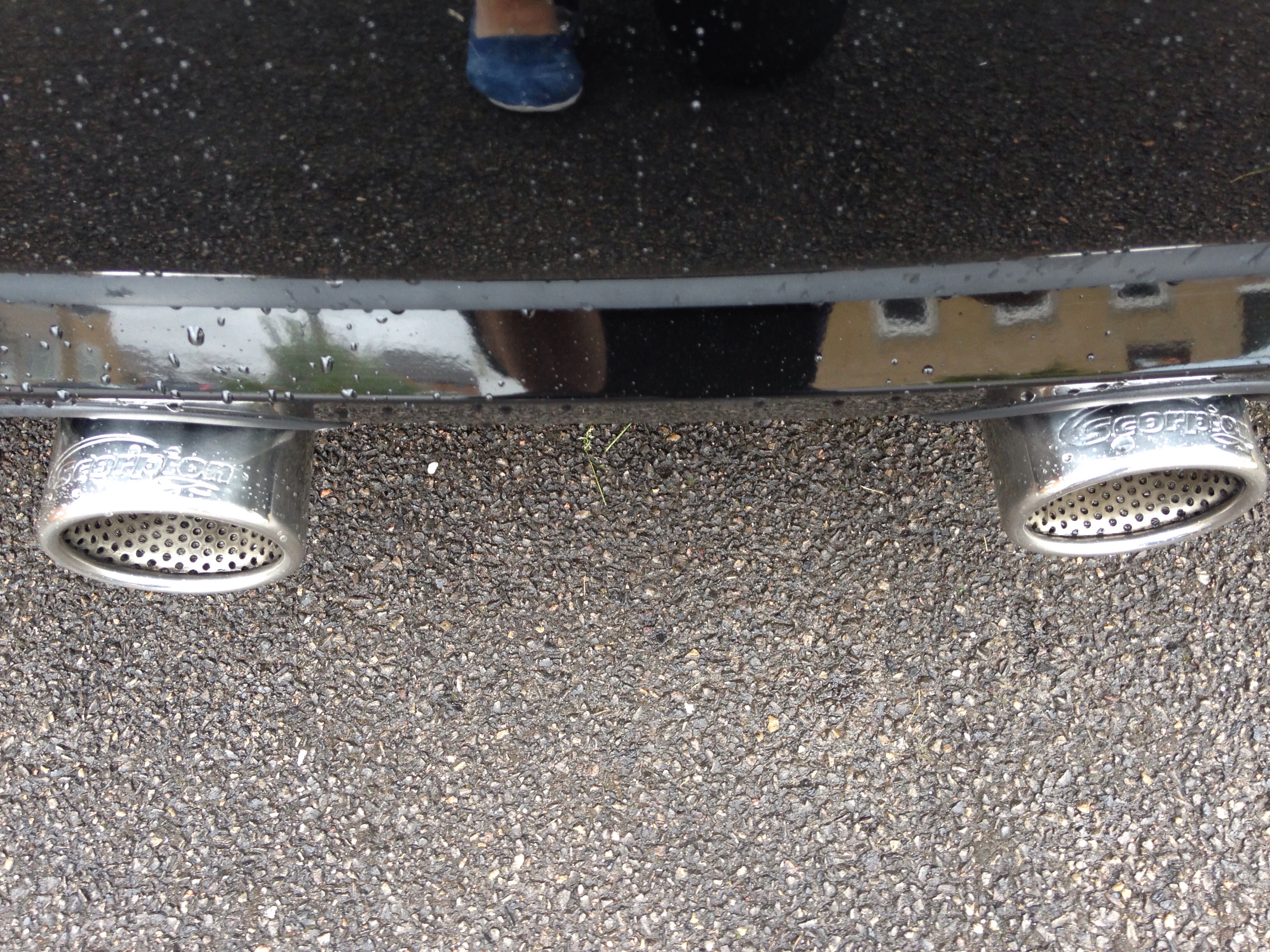

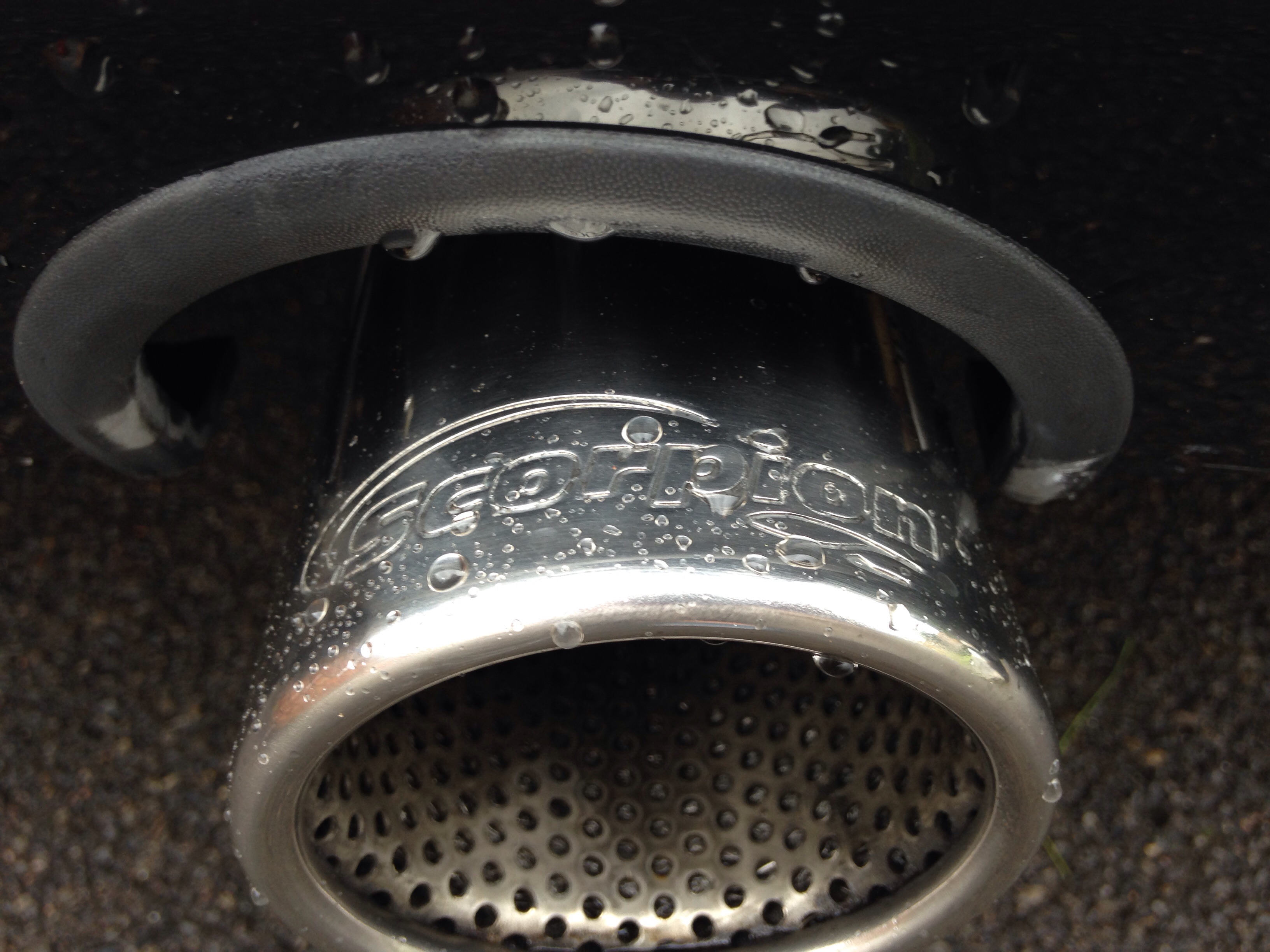

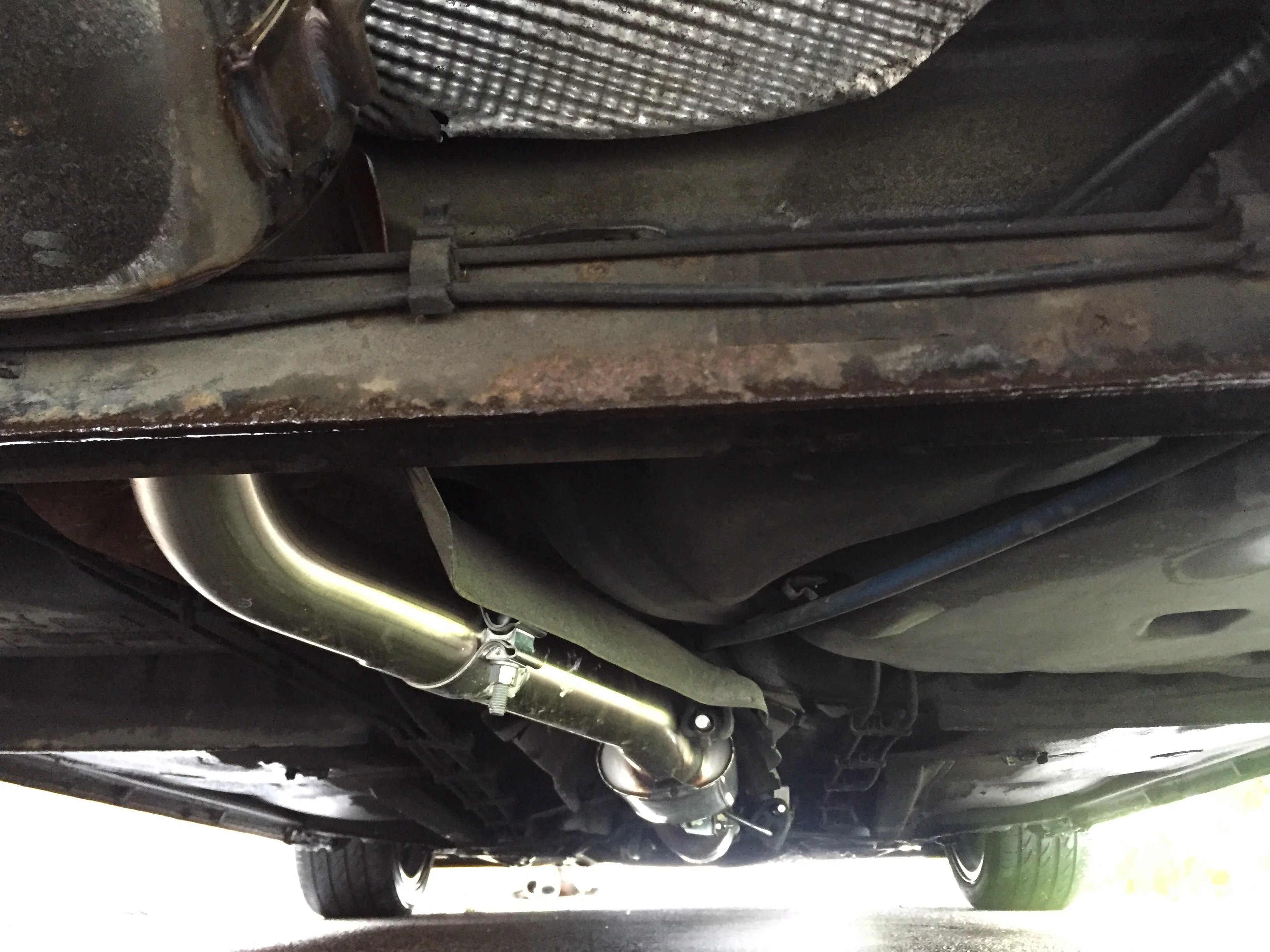

Just wanted to show some pics of how awful it's sitting. The left pipe sits out further than the right zoom in and u can see the left pipe u can see the tail of scorpion and space behind.. The left pipe u can't see the whole tail. Also both aren't sitting central in the holes but on the wonk diganogal to the left.
After inspection under the car my partner tells me there is no extra bracket at all. He called the bloke up who said 'no he hasn't put an extra bracket on. He said it needs an extra bracket if I want it sitting straight'.
He has checked over underneath and says there is nothing vibrating or knocking etc on any under the car. Nothing resting on anything etc.
Think I will have to get in contact with scorpion and speak to them as the noise inside the car is one thing but also having the exhaust sitting like that in not too happy about. :(
  clio 182 FF + chipped
a garage who we have taken our cars to many years now and never had a problem. Here's some more pics so u can see everything underneath has been fitted properly and is straight underneath...I wish Derek could of fit it would of saved me £110.

The only way i got my pipes to fit better that that was to cut the centre box a little shorter and modify the mounts.
Also I had to manipulate the bumper a little on the brackets to bring one side out further.

See if you can pop out again and get a side on shot of this so you can see if the shiney pipe is sitting on top of the rear axle
