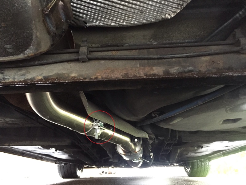

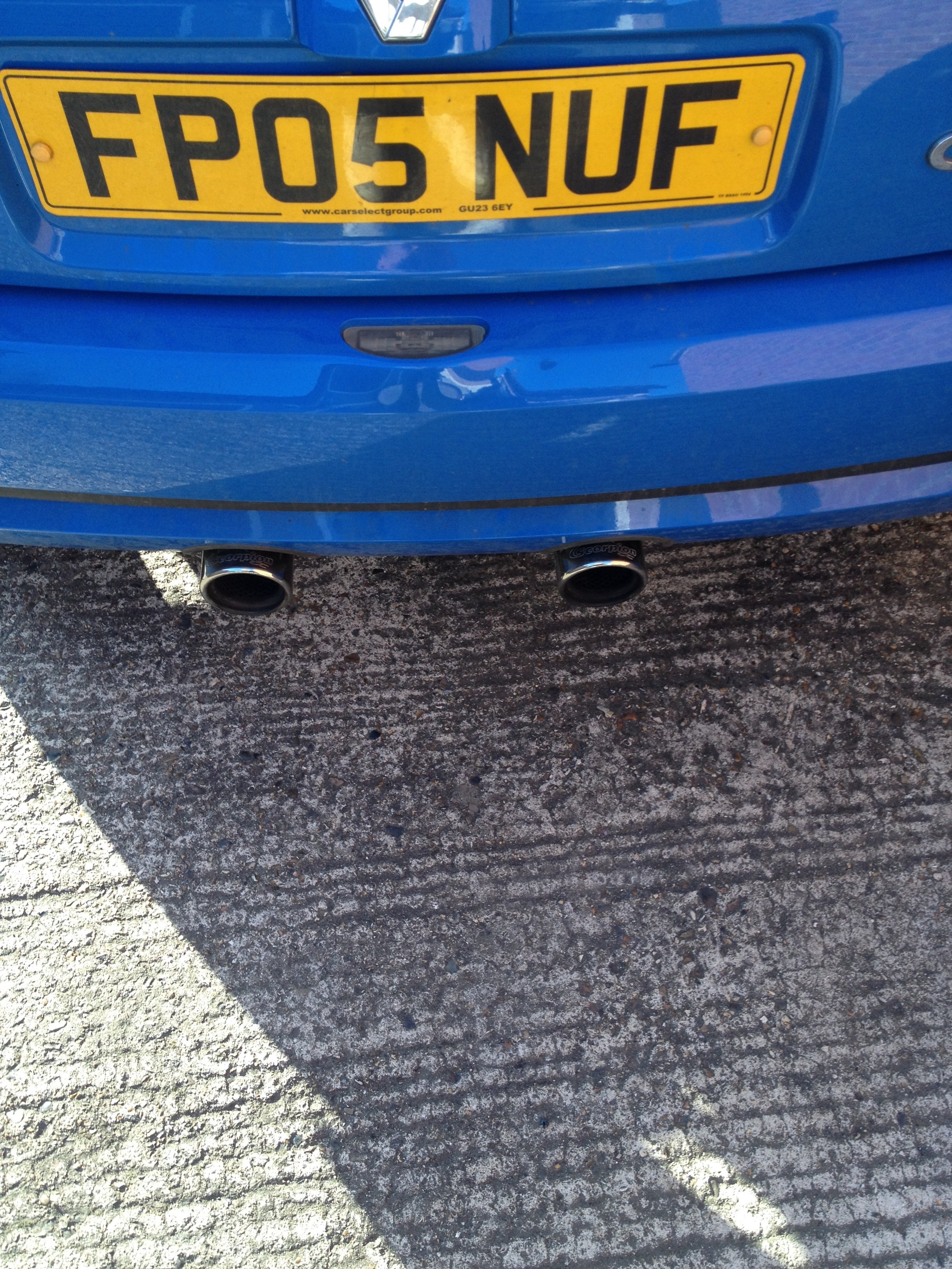

Yours sit a lot better than mine car.crash altho on zoom I can see your right pipe sits slightly over.

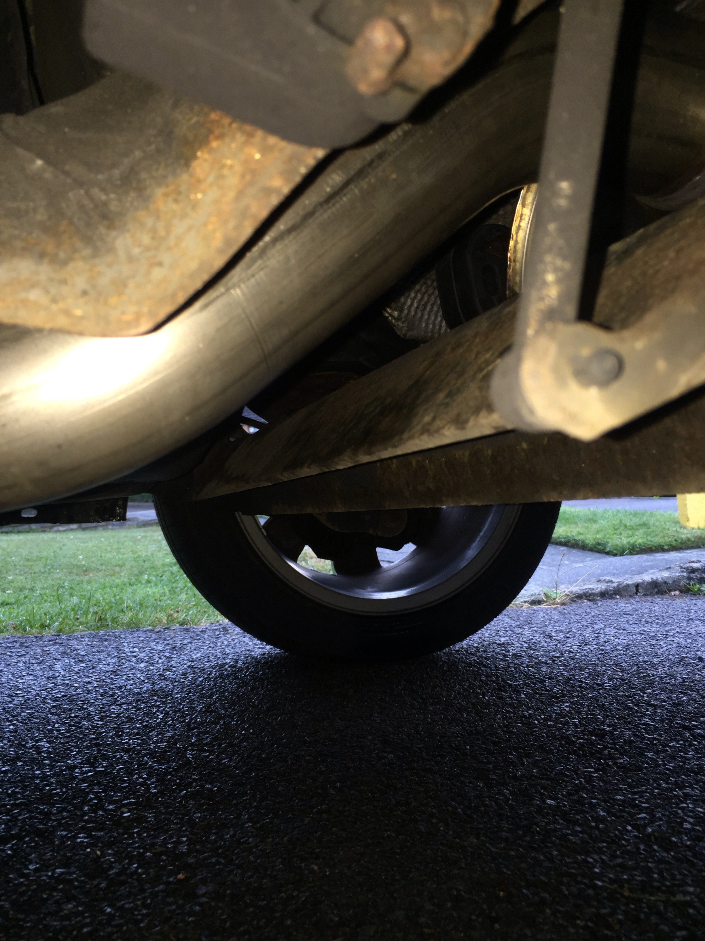

Here's the pics from side..

I'm looking on my phone but it looks like one of the mounts is rubbing on the heat shield?

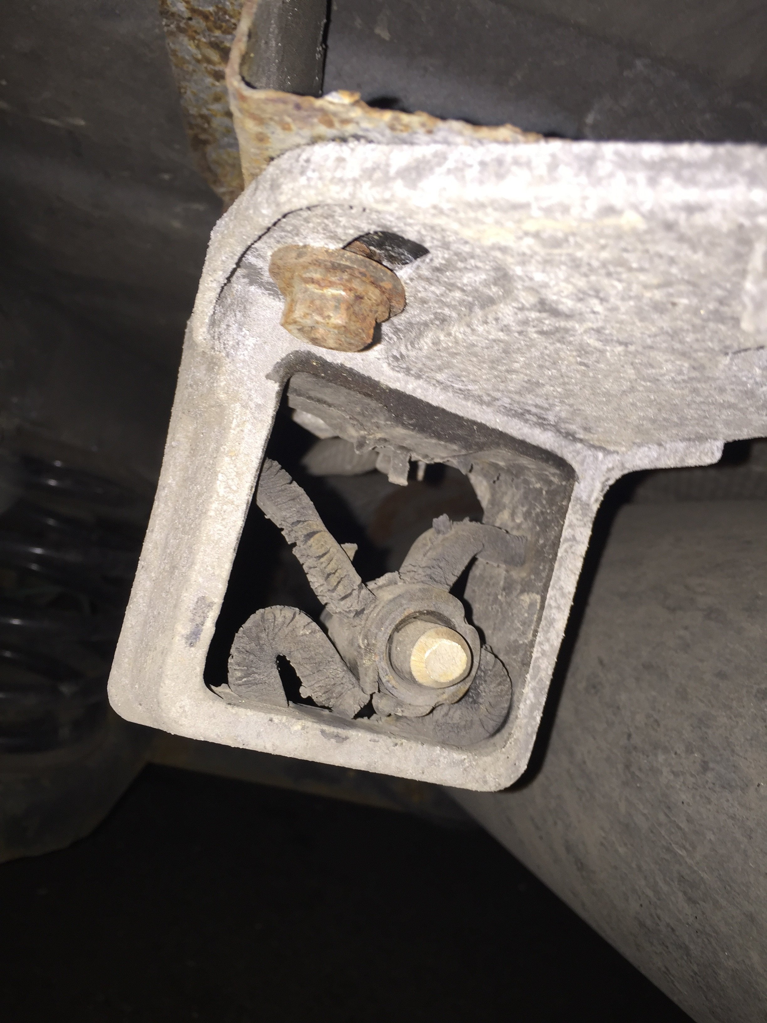

I have this exhaust when I brought my 182 mine was wonky. I know you have probably checked this but the two rear mounts have a kind of rubber web in them with holes for rear exhaust mounts. When the rubber webs are old they perish which causes the rear pipes to sag and twist. If they have fitted your new exhaust to old rubbers chances are changing these will pull it straight.
