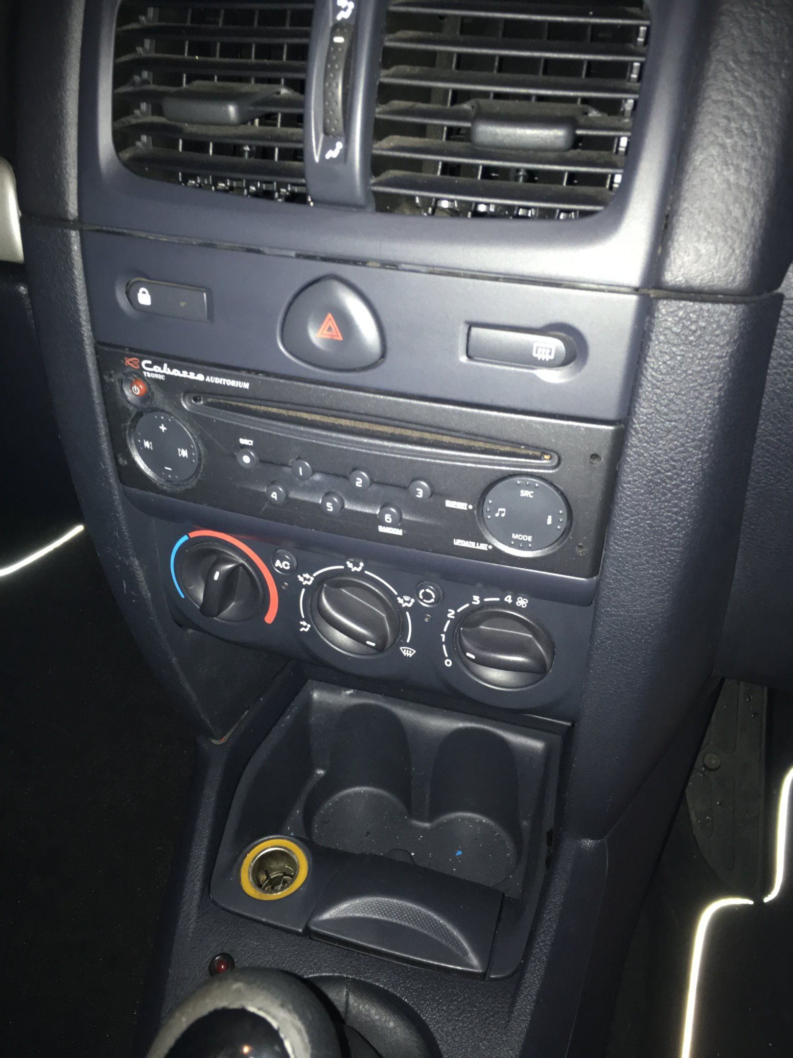

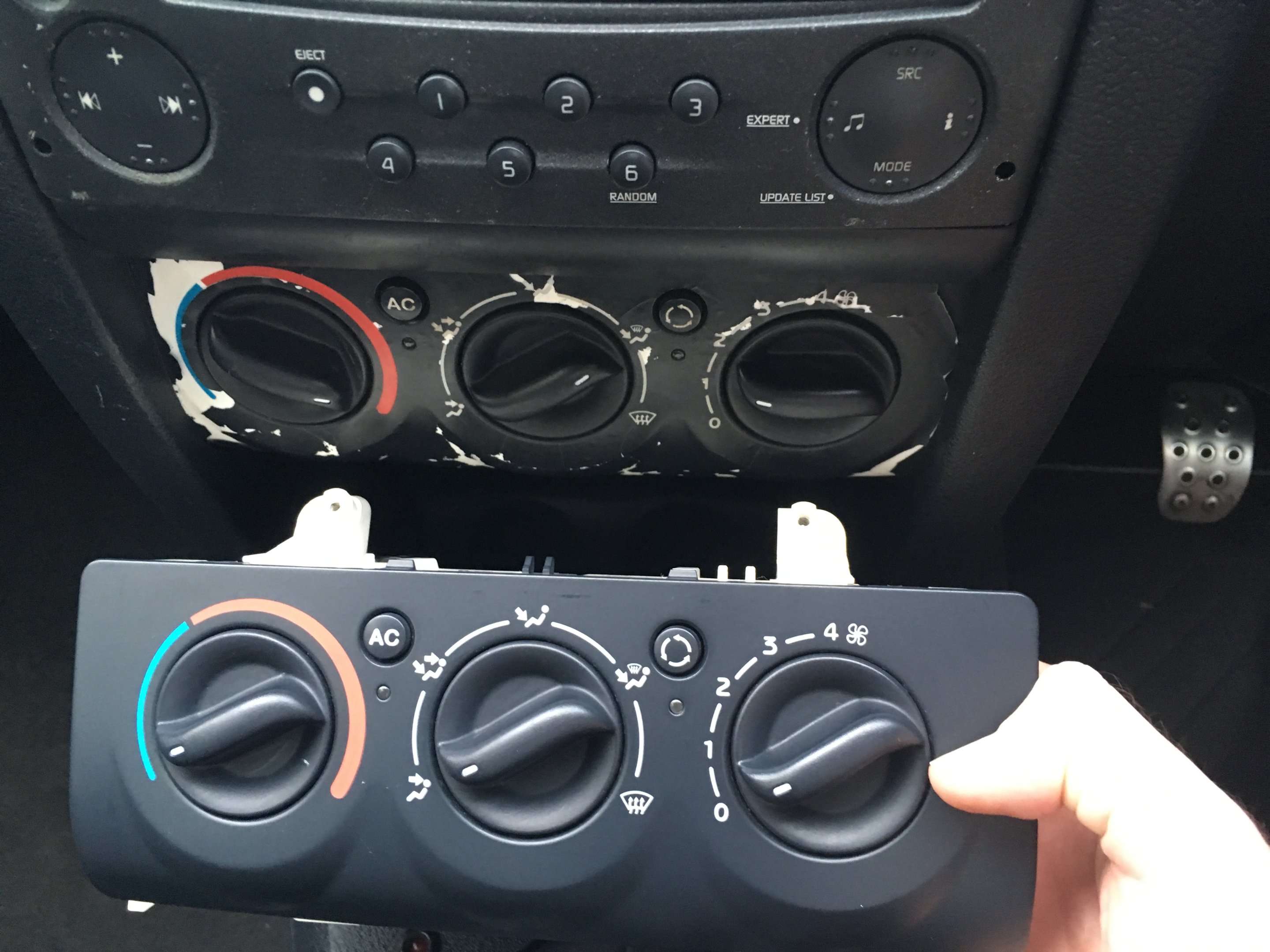

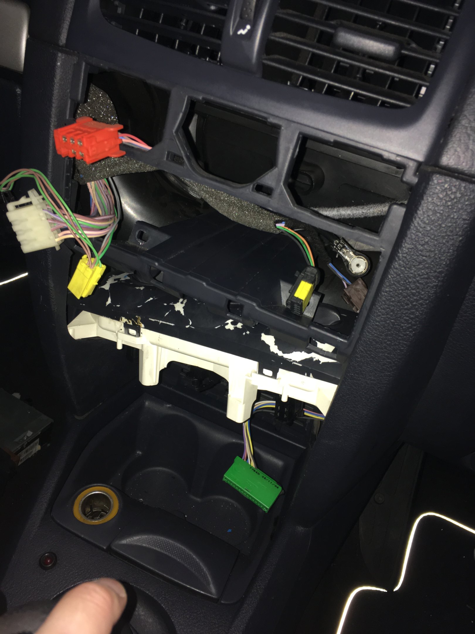

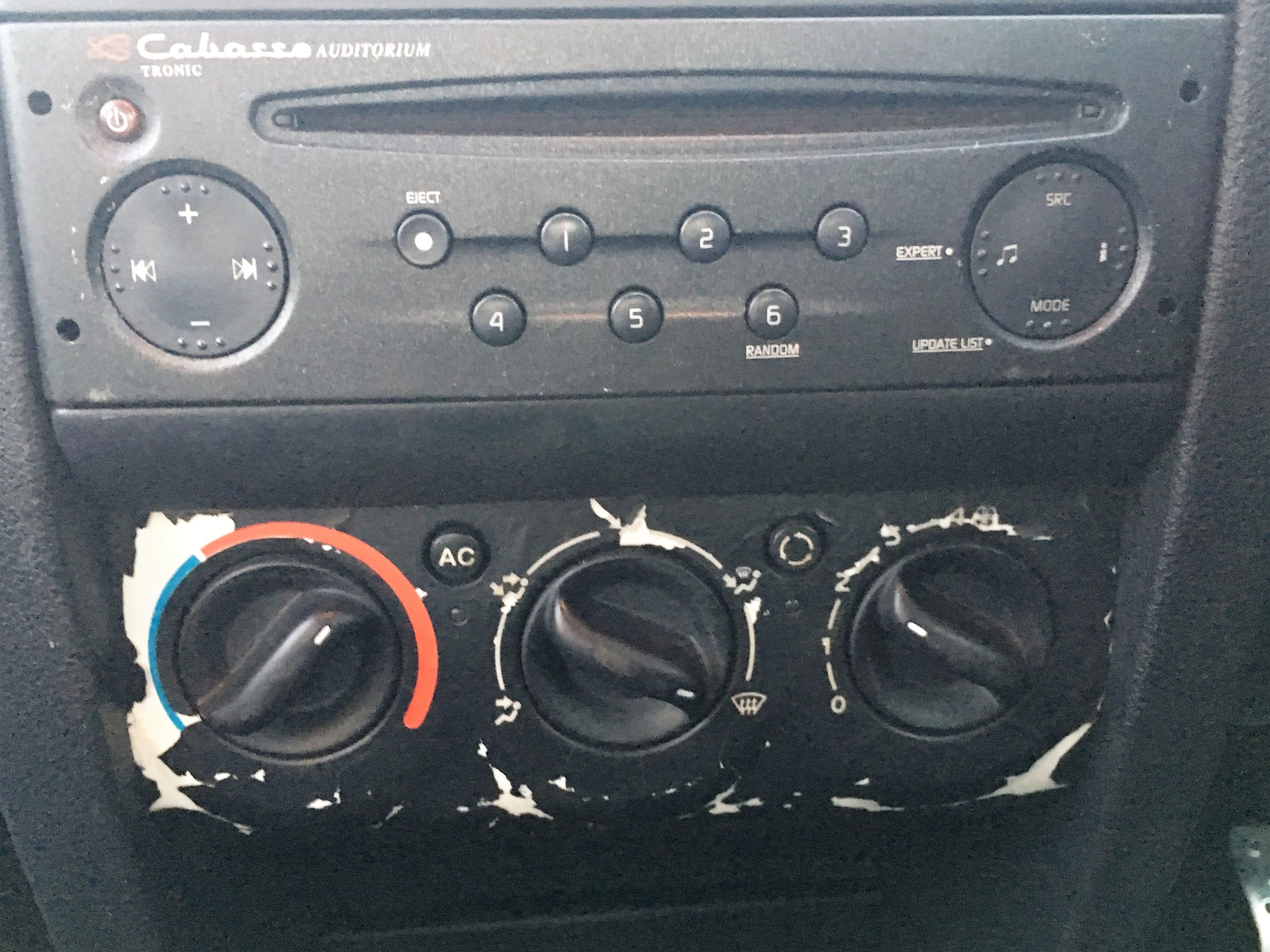

-The heating controls panel is flaking badly and it looks rubbish. What can I do about this, is it easily replaceable? The garage mentioned people spraying them in various colours but I want to keep the car OEM. (pictures attached)
-The stereo works intermittently. Sometimes I get sound from the radio, sometimes there is silence even though the display says a station is tuned. This was noticed at the garage and they gave me an aftermarket head unit. I'd prefer to keep it OEM as before, is it just a case of getting a replacement head unit?
-The washer jets are temperamental. Again, this was noticed at the garage and something was replaced whilst I was dealing with paperwork. It worked at first but then when I tried to use the front washer the fluid would come out at the rear only. Then occasionally even though the motor was apparently working there was no fluid at all. Apparently it is some sort of switch that can stick? That was what was replaced apparently but the fault still occurs. Again, help appreciated because I know this is probably an MOT failure item, and very annoying over winter.
-The glovebox is looser on the driver side of it and rattles when driving. Easy fix?

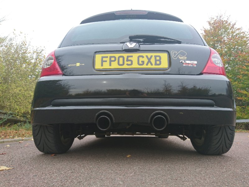

The last big thing is the exhaust. I could tell it needed replacing and the garage had confirmed it was on the original exhaust. It can still pass an MOT but looks like the passenger side exhaust pipe is hanging lower and I can see plenty of rust as well. Apparently replacing it is expensive and most get a Milltek instead, any thoughts?

Washers sounds like new pump required, easy fix. Stereo not sure but defo get it out to check the connections and wiring, could of been bodged. Glovebox the rivets can break or the plastic hinge begin to snap so may need replacing. Heater panel, no idea not up on the Cup ones. Exhaust there's loads of options depending on what your after, personally I run a janspeed on mine which is super quiet which suits me fine.

Will be keen to watch your progress, there is a guide on here about how to replace the heater panel, it’s a bit fiddling but entirely possible!

Does the CD player work OK?
Cheers Steve, all signed up. Worth it for the bottle opener alone!
I'll take a look, at the moment the washer is intermittent. I reckon it'll wash the front 70% of the time I try and use it. The driver side jets don't work well, one has completely stopped working and the other aims a bit high so bit of cleaning in order.
I haven't tried putting a CD in yet, just the radio. Just getting a tool to remove the stereo to check the connections. Looks like replacement OEM head units are cheap. I've ordered a new heating control panel in great condition, and also some genuine renaultsport floor mats as they were missing.

Check out the CD player, if it is OK, try fitting a direct earth to the casing to improve the radio performance.

No drone from mine but very little theatre either. I have had both styles of yozza exhaust on it in the past too however..... Now that's theatre!! But drone also!

Get a Janspeed or Ktec as it is now I had one on my first 182 in 2005 and that was great no drone, I have the Ktec ultra performance now in my track car and with no interior still do not get any drone.
this is what I have now with no centre silencer
http://www.k-tecracing.com/show_product.asp?id=2419&appid=2
this is what I had before
http://www.k-tecracing.com/show_product.asp?id=1264&appid=2

Cheers fella, I had a look at the ktec website earlier. The system with no centre silencer looks decent. As for the seats, I'm going to keep the cup seats for now but I completely agree that the leather/alcantara seats and door cards make it a nicer place to be. It's such a headfuck at the moment, very sporty and eye catching from the outside and then with the interior as it is very bland and flaky on the inside.

I have the Ktec 2.25 with no decat and unsilenced centre. No drone just rasp, great set up

Would recommend the Janspeed exhaust for a 182 - i had one fitted to mine and was just right imo,not too loud on idle or at low speeds,but sounded lovely when you opened her up.

+1 on the Janspeed. I like mine. If I was buying again I'd probably go unsilenced.

How much more noise are you going to get unsilenced, at all times or just under throttle?
Yeah unsilenced does sound good. Little burbles on slowing down :smile:
I do like slowing down burbles... :D

Just under throttle. Doesn’t drone atall really. I think it’s quite quiet in the car, ish.
But my better half always hears me coming home. I have heard the car drive off and I did have thought ‘that sounds ace’ as it went off lol.

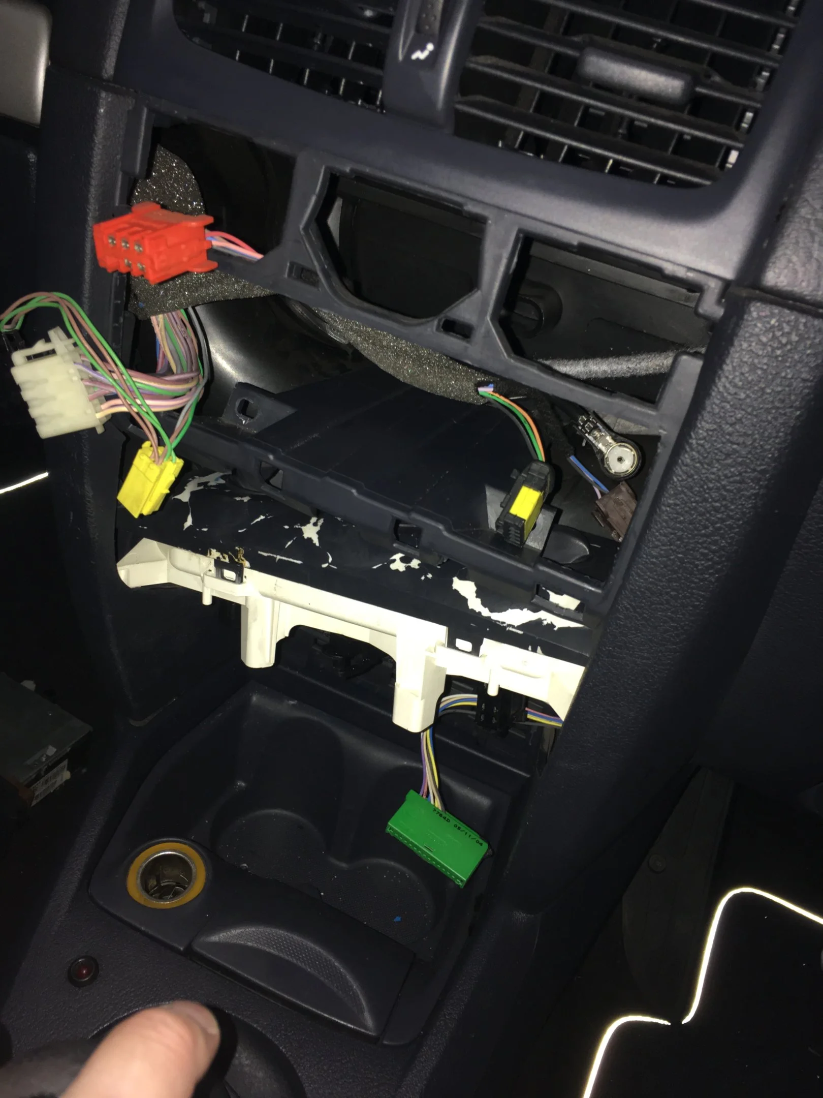

Well I haven’t managed to sort the stereo, I think I’m just going to buy a replacement head unit and see if it works, then sell it on if it doesn’t and give in and go to a stealer.

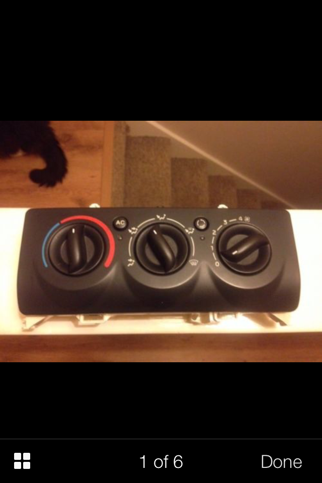

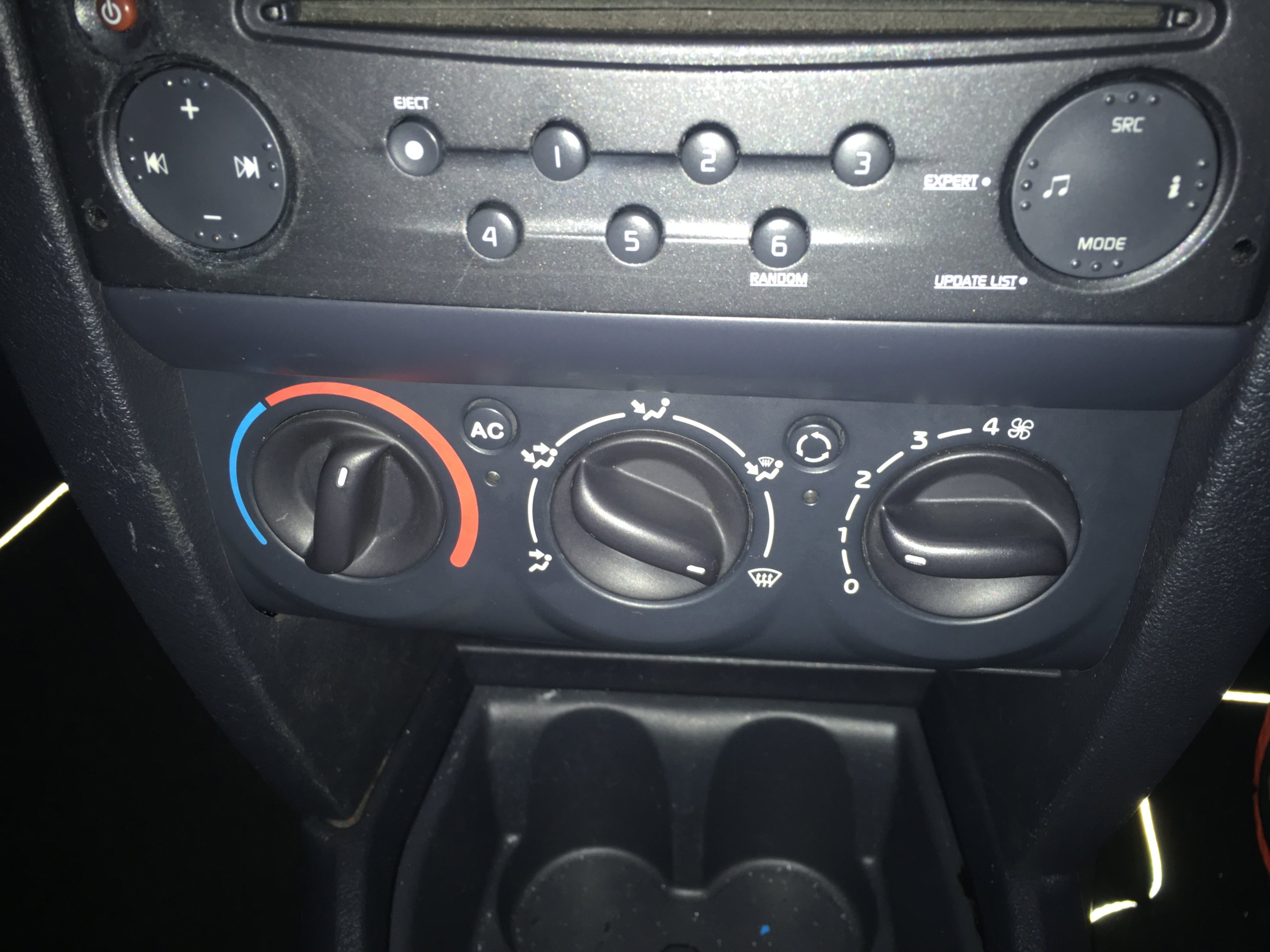

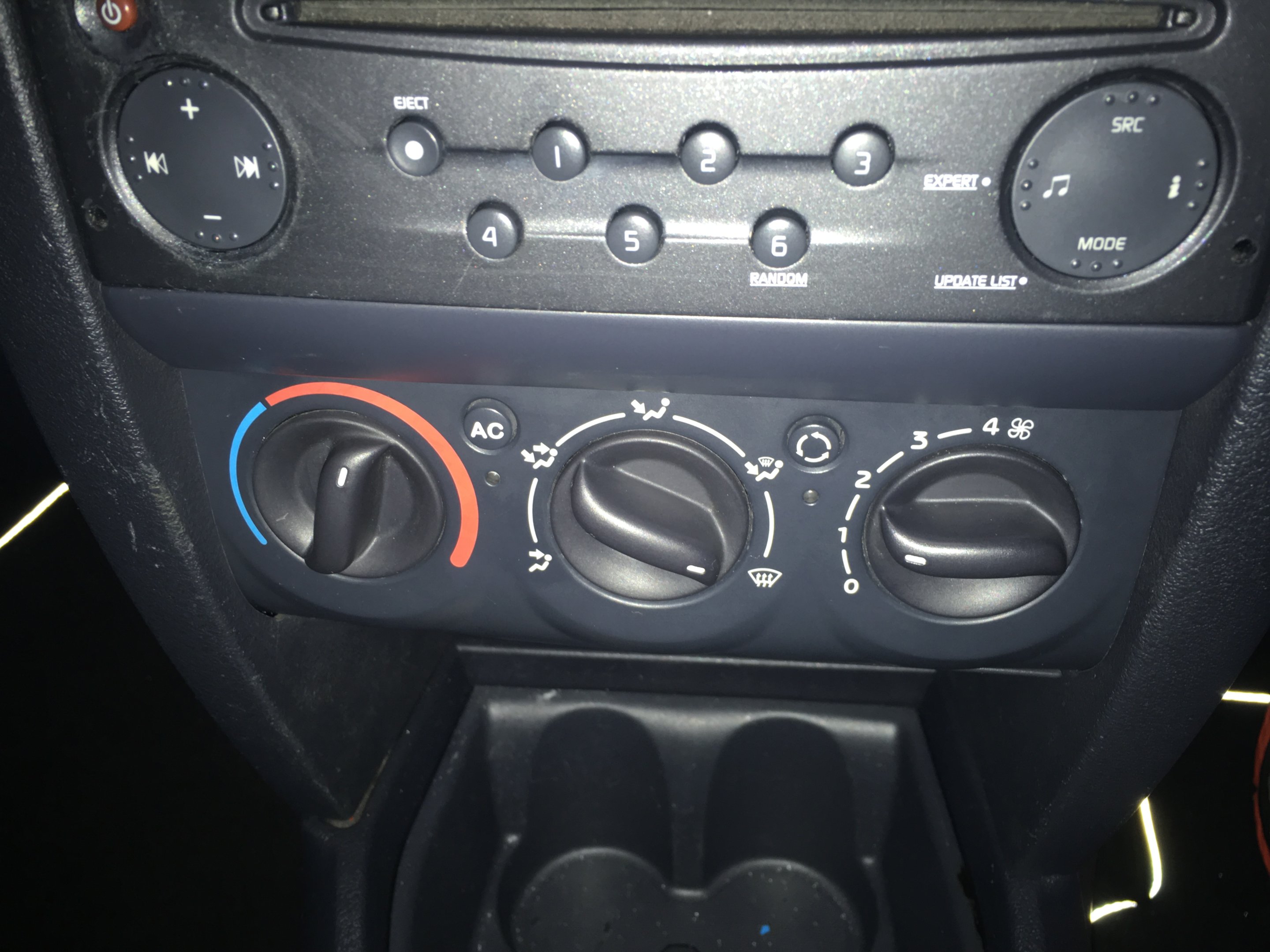

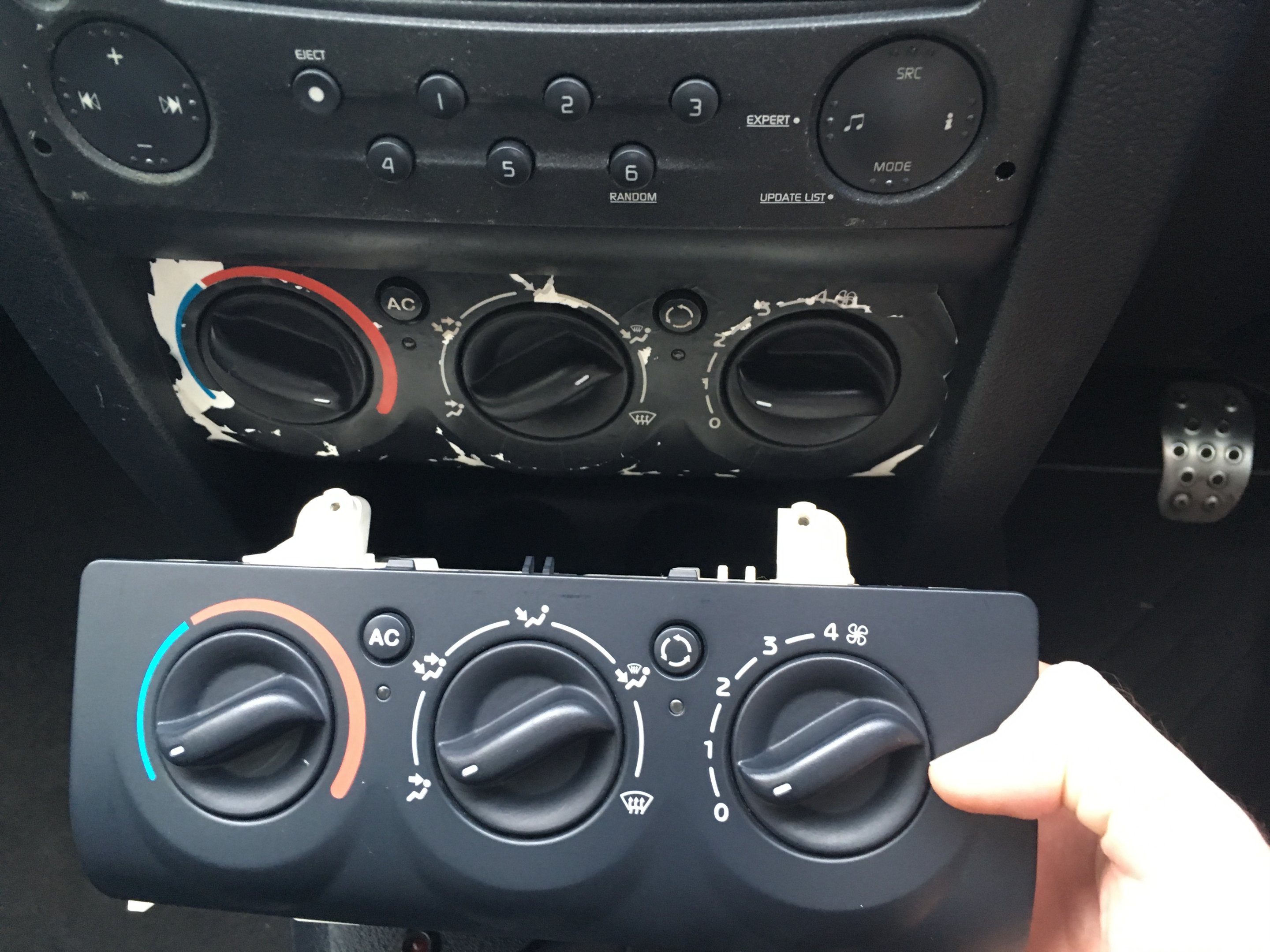

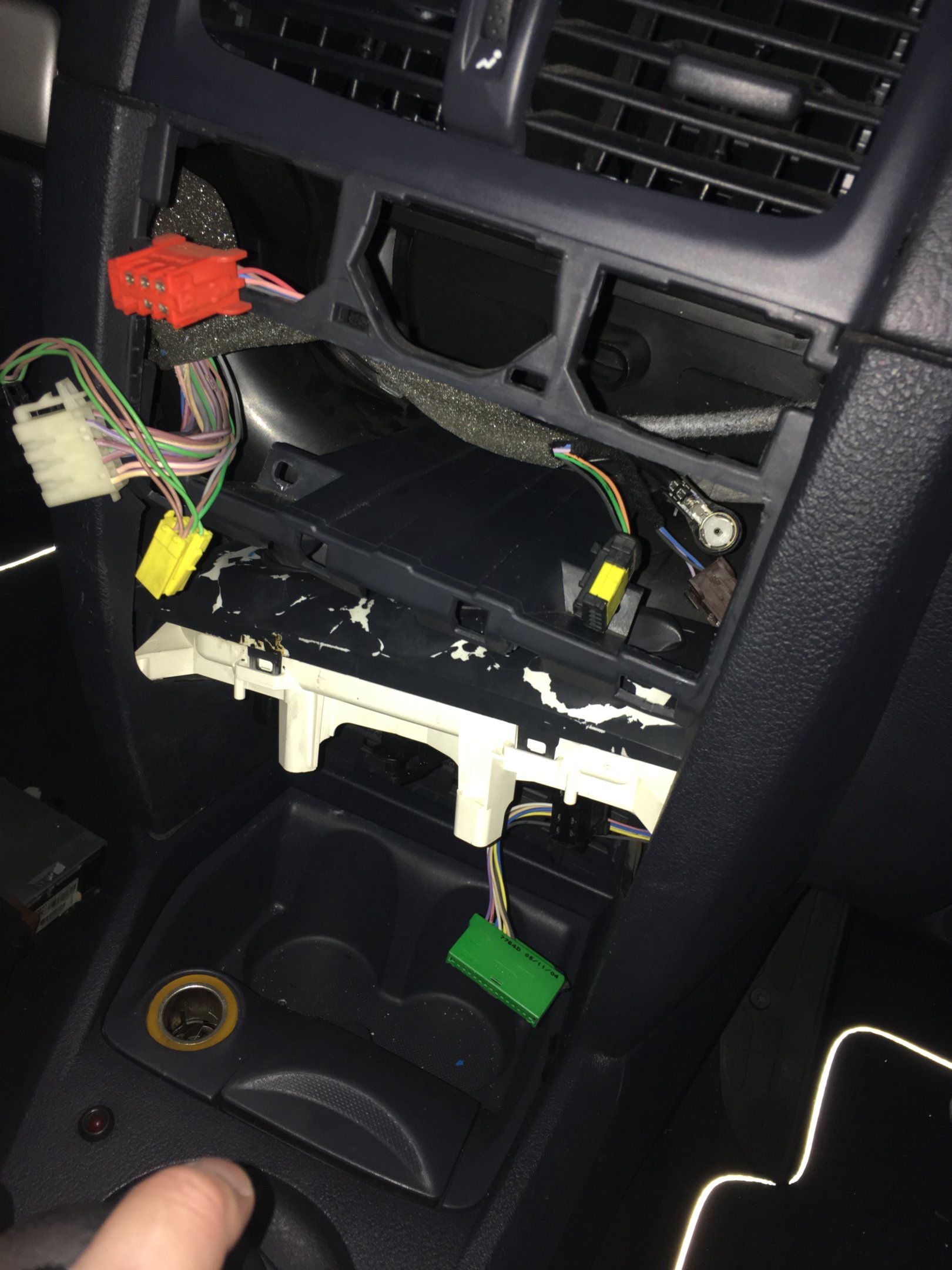

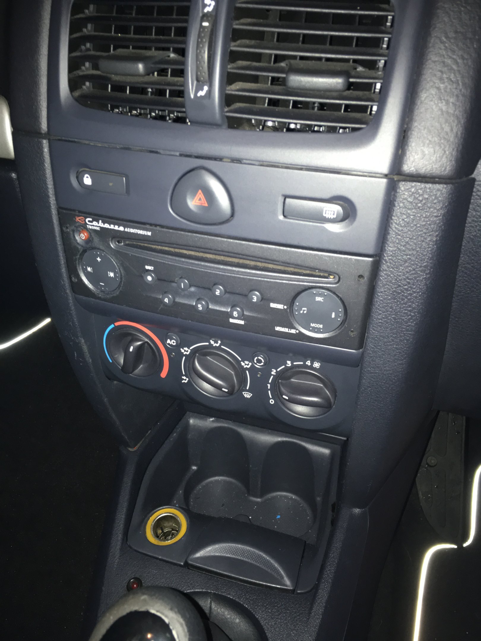

What I have done is fitted the heater control panel bought from mossyv6. Fiddly job but thanks to Woody_xX’s excellent guide I got there. I even managed to get photos of the circles fit into the back of the unit for his guide but i can’t reply to the thread itself?
Anyway here it is, it was dark outside once I’d finished (due to the apocalypse apparently) so not great photos:

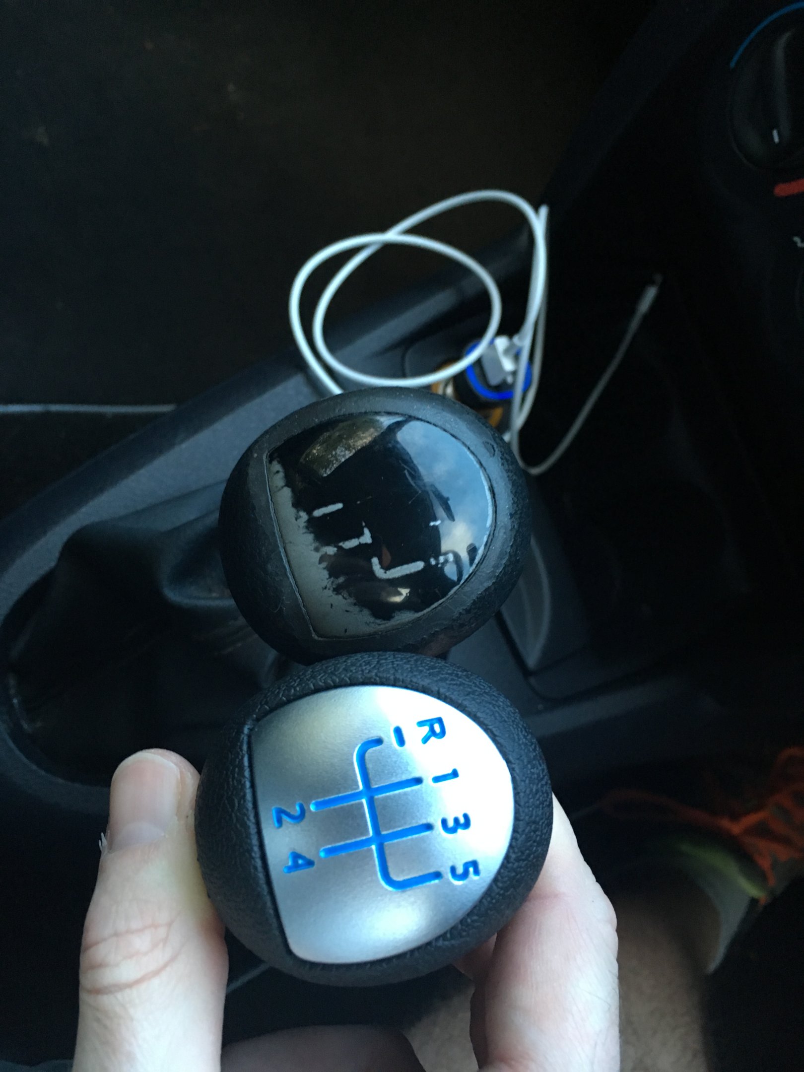

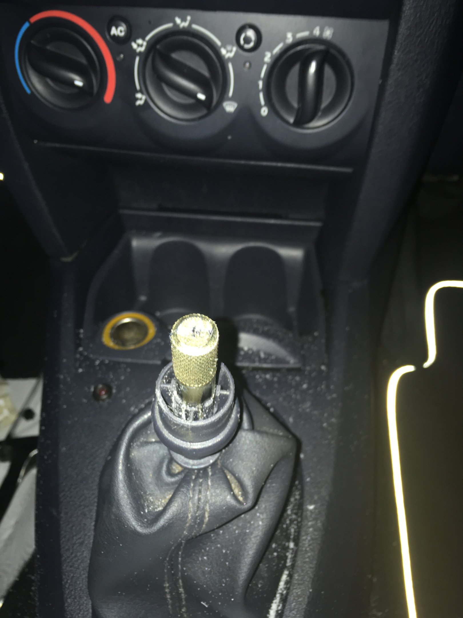

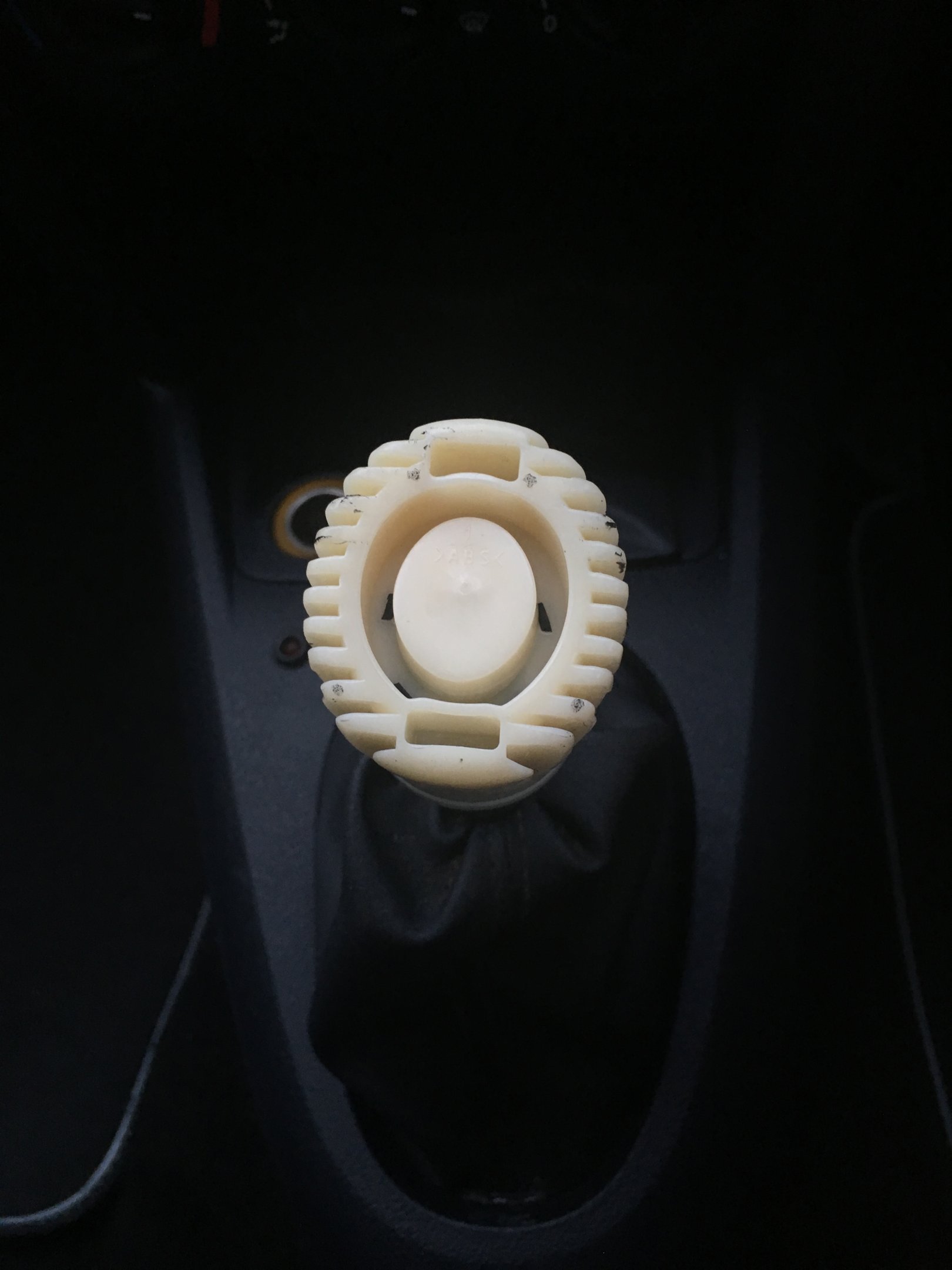

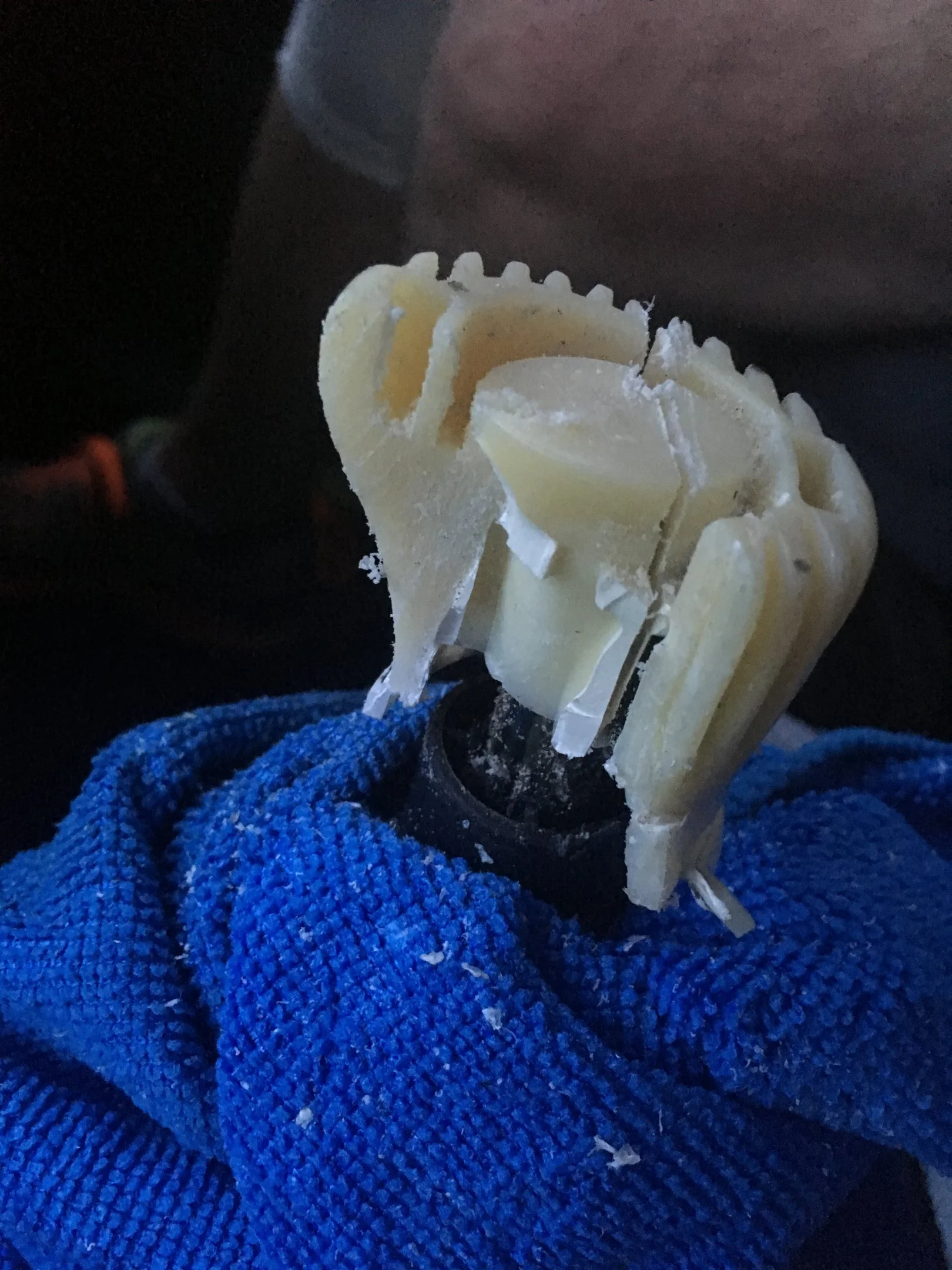

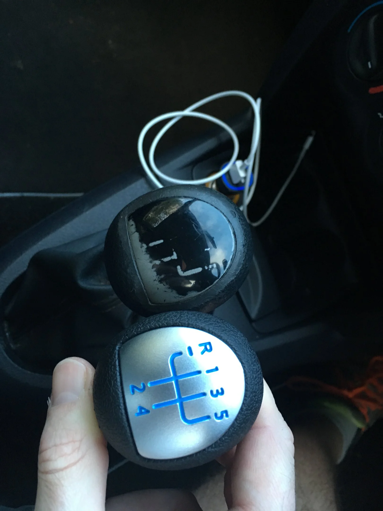

Next up, a new gear knob coming this week.. apparently I have to cut the old one off and then glue the new one? Not looking forward to that either!

Hacksaw a 'cross' into the top until you hit metal, then use a chisel and tap it off in sections, best way I found.
  RB 182 Cup,E46 M3 CS
Thanks fella, I did it a few days ago and wish I’d read this first! Had a bit of a problem with the new one though, I bought an aftermarket one off eBay for £16 or so. Looked fine but the plastic hole inside the new knob wasn’t big enough to fit around the gear stick? I tried as much as I could to push it on but with no luck. I’ve now glued it on with araldyte, it works fine but clearly isn’t fully on as it should be and it’s winding me up. Any thoughts? The chap I bought it off said take it off again, file/sand the plastic and try again but getting it off now might be an issue..should I just go with a genuine one from Renault.. can I get one from the forum?
So much better and glad you got it fitted okay as I know they can be swines to fit.
Thanks mate, it wasn't too bad in the end considering my complete lack of talent in anything mechanical, electrical or really anything at all!
