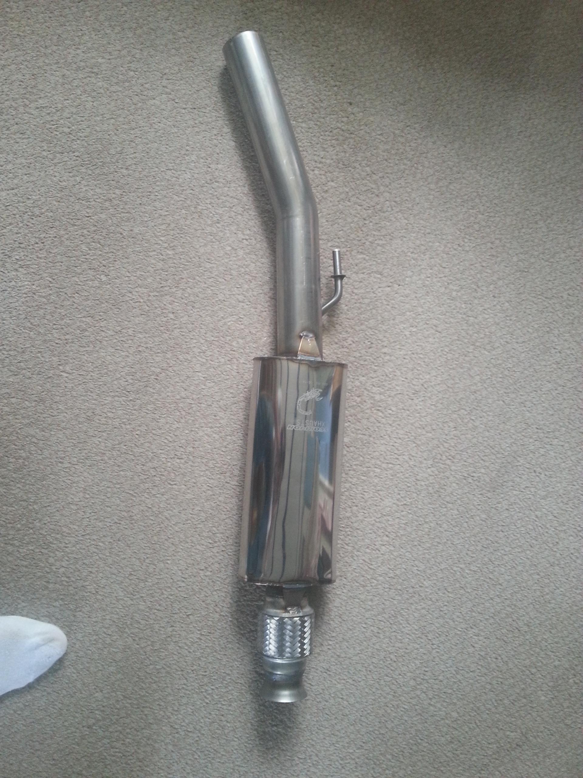

Top down...

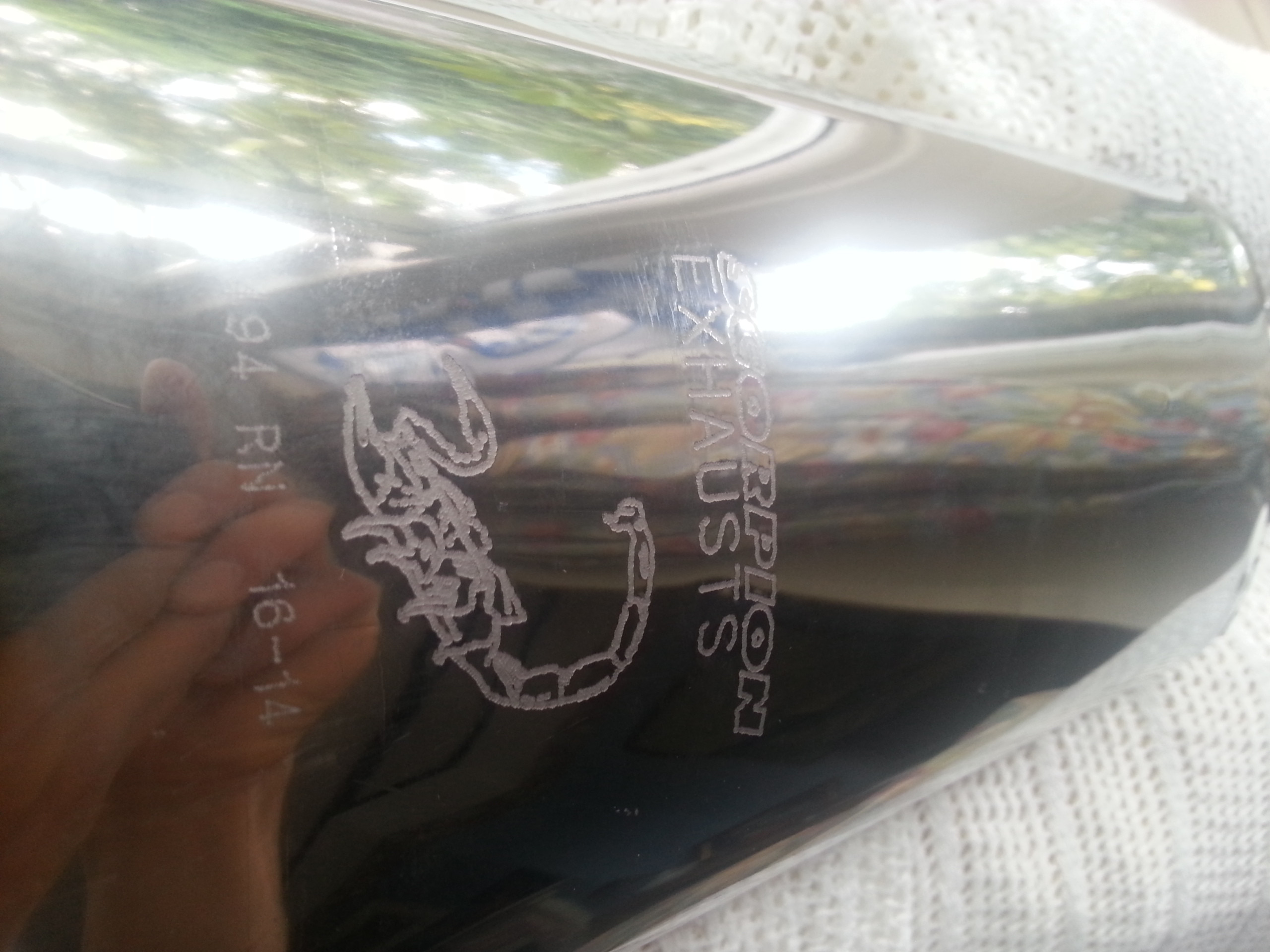

Close up of engraving
494-RN 16-14 (14 meaning 2014 design hopefully)

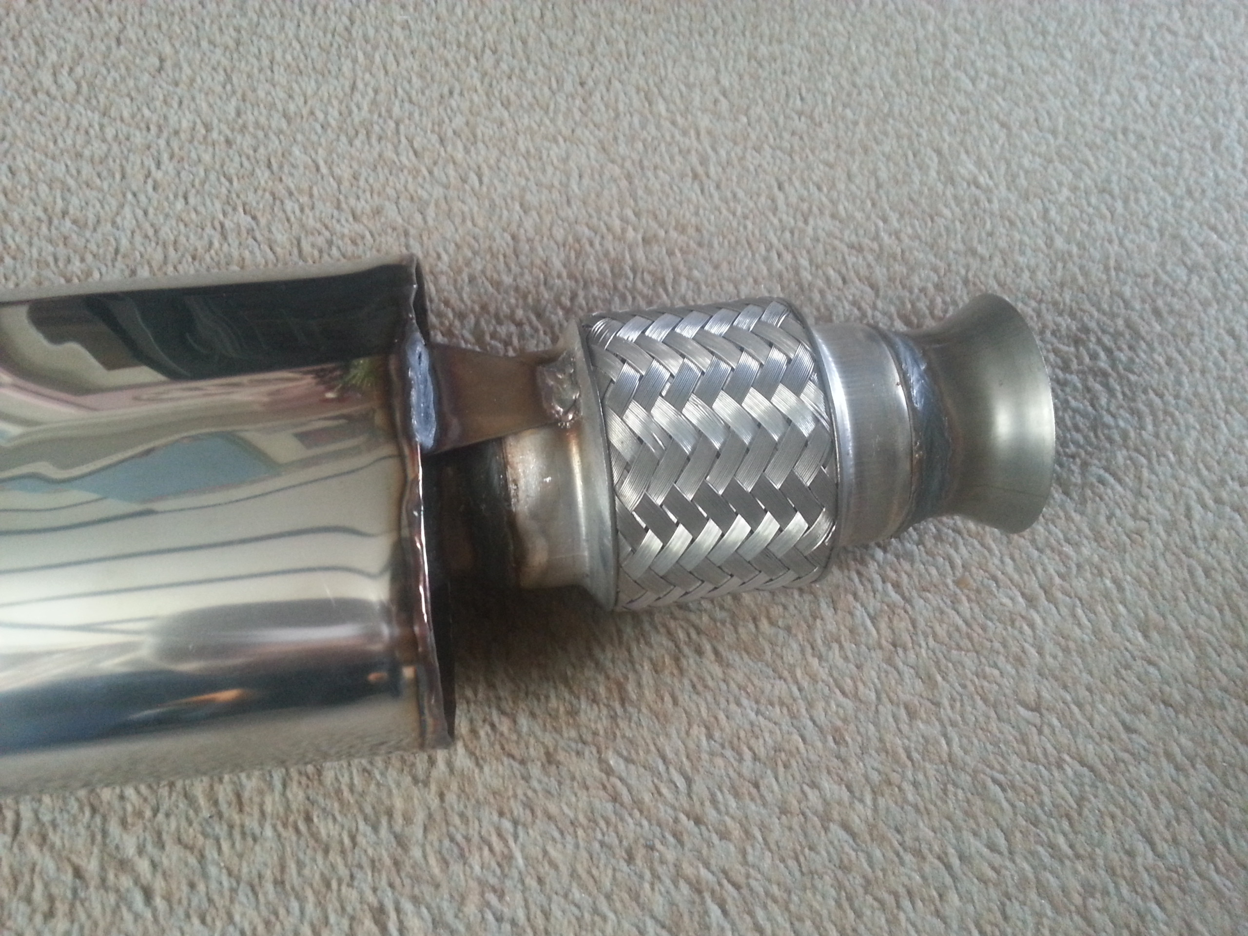

Close up of flexible olive joint

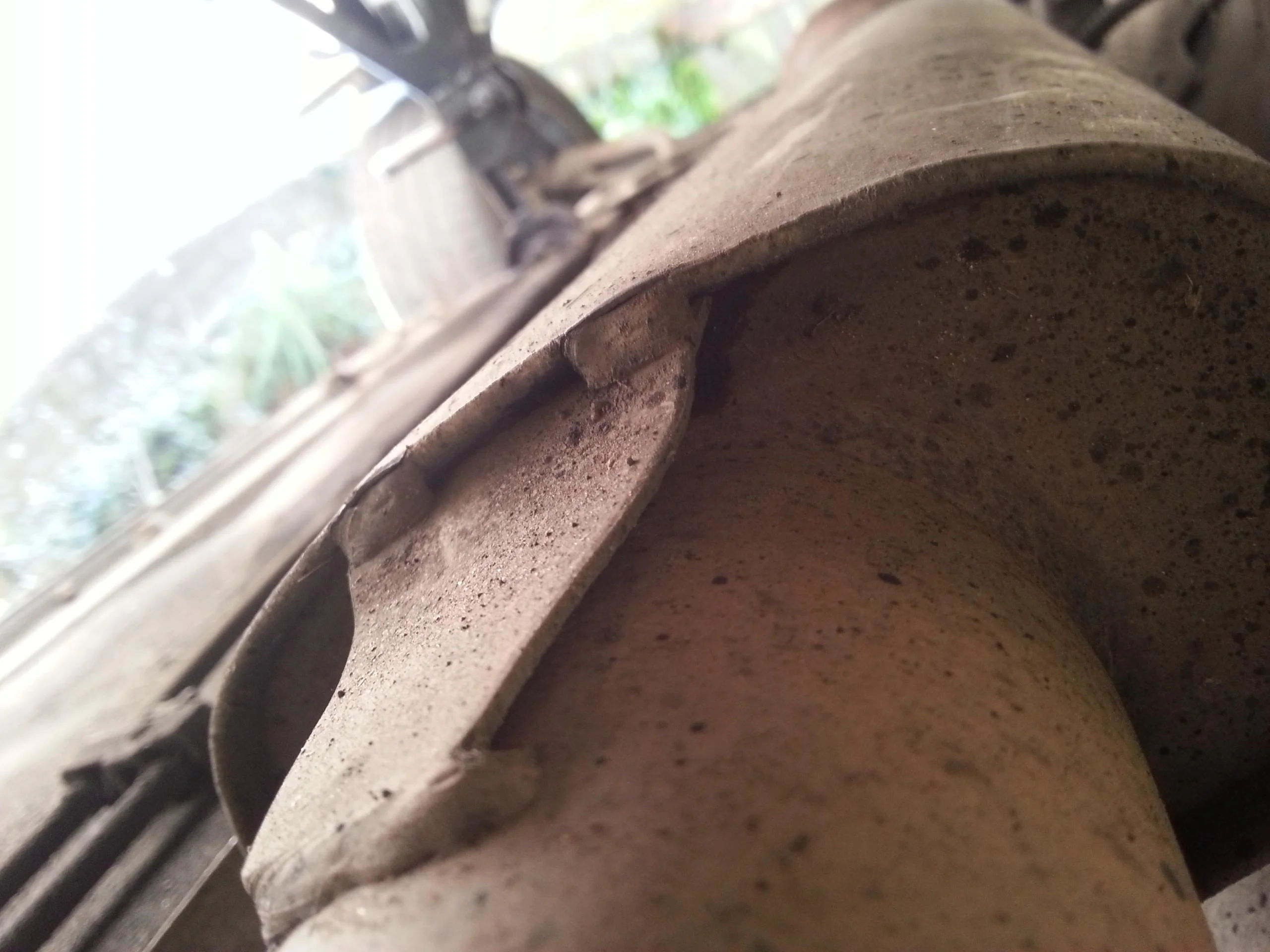

The interesting bit is the flexible joint as above, will this help solve all this olive joint woes people complain about? Mine cracked at the other end, where the small triangular bracket joins the pipe to box, for strength I assume, but also peeled the weld apart when it went! (see below)
So back on track, has anyone else received this new revised design? I have a heavy duty olive joint clamp with two individual bolts, going to put high temp silicone on the clamp, inside the 'V' , which should hopefully seal well. I suppose with some flexibility there, if the clamp can be cranked right up with the silicone, the flex will be directly transferred to the sleeve mesh section in theory!
Also have some mikalor 2.5" clamps for the rear of the system, which is also blowing like a biatch, probably due in part to my poor joining skills and using no sealent when putting together first time round, new mesh clamp for the cat to manifold courtesy of Northwests, new centre hanger and also new rear hangers.
My car sounds like chavs wet dream at the moment, so bassy and hollow and puffy because of the leaks from each joint! Wish me luck putting it all back together!

I got that new centre section on Wednesday too, same as the one in your pics. Not fitted it yet as I'm waiting for new clamps and gaskets so everything is new again. I bought my RS 192 in 2011 and it failed this winter in two places, two cracks in the actual steel sheet at the forward end of the centre silencer, both starting at the weld with the pipe. I think the olive joint will be a good solution to the fault that mine developed, mine was not down to failed hangers as they were new when I fitted it.
