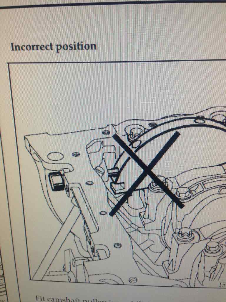

Yea the guy knows the engines well,
Problem was the crank locking pin was located in the balance hole, not the locking pin hole.
And it turns out a couple of HT leads have broken down. Replaced them all. And it seems to be ok at the moment.
Lol @ in the balancing hole. The locking pin won't go all the way in unless it's in the right hole iirc.
