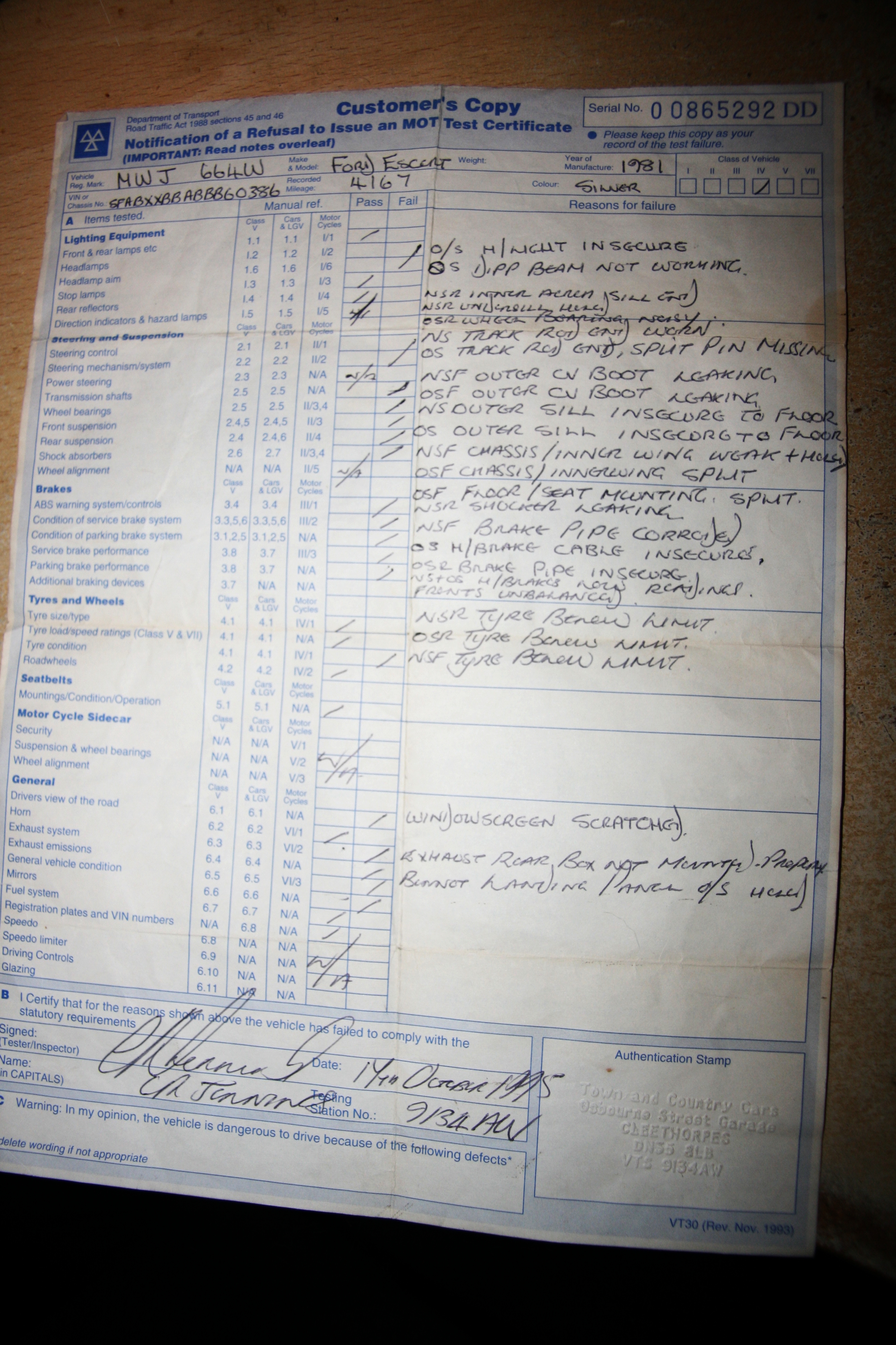

I have an old one somewhere. Smashes any you lot have lol. It was awful lol.
I'll scan it if I find it.

god sake thats not bad for a car my age have you still got it
Oddly, I scrapped it lol After murding it of course :D. That was 18 Years ago! It was 14 years old then, look at the miles...

I seen that lol that's why i wondered if you had kept it and fixed it up
Long time to keep an MOT slip

Yip - until another fails so bad, I'll keep it for a giggle. I found out after I had bought it at auction, it was a barn find lol. Mrs Farmer had barely used it and in 1990 it was laid up. They "Dodgy" MOT'd it and flogged on 6 months later.
​Cost me £50.
