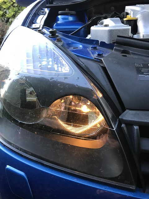

- Headlights changed for new due to clouding so they look mint

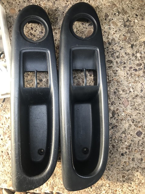

- Change all the horrible rubber door grabs, hazard switch and any other bits for non-sport items

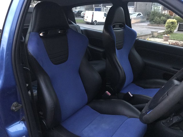

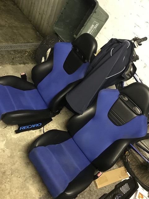

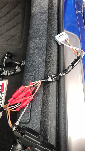

Before I even purchased the car I came across a set of Trendlines on the Recaro frames with pretensioners, covers and frames for a great price, so off i went up to near Sheffield to collect them, and stuck them in the garage awaiting a car. Thanks to @mossyv6
Once the car was purchased, I set about the nuts under the car to get the seats changed. Outer nuts were fine, but the ones exposed to the elements under the car and awkwardly near the exhaust were a PITA to get out (what a silly design)!!

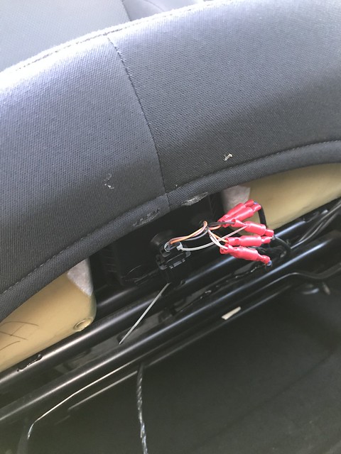

Upon unbolting the standard seats, i noticed that the wiring had been "accessed" before, with connectors on the pretensioners and actual car loom cut off and reconnected using crimps. The airbag and service light were also on when i purchased the car.
Given I didn't really want to cut the wiring on the recaros off I went to the scrapyard to get 2 new pretensioners and the connectors from a scrapper. Whilst there I stripped the car of the door grab handles, centre console, and hazard switch, and some fresh seat nuts for underneath.
With the standard seats out, I swapped the pre-tensioners over on them, so that when they ever go back in the car, they have a proper connector on them, rather than crimps, and I know they are done properly.
I then set about adding the connector back to the car loom, and tidied away with insualtion tape, so the proper connectors can now be used. Hooray! The airbag and service light have disappeared!!
Seats went straight in and look great with the mondial blue

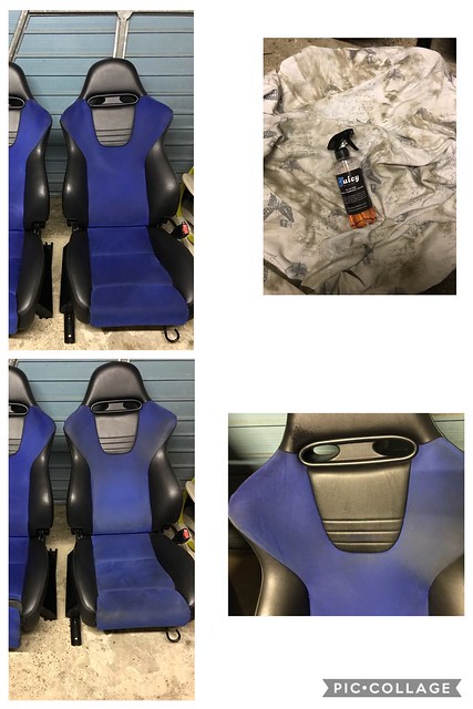

Because 2 sets of Blue recaro trendlines are never enough, I had previously committed to purchasing a set from someone else, so rather than go back on my word, i ended up buying them, making a good set from the 4 seats I had and then sold the other set, to the first genuine person who turned up! I had to give them a thorough clean, but was worth the effort. Really rate the juicy details fabric cleaner.

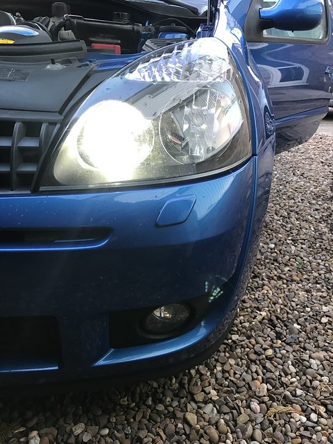

Thanks mate,i changed my headlights to xenon.They are much better & just look cooler

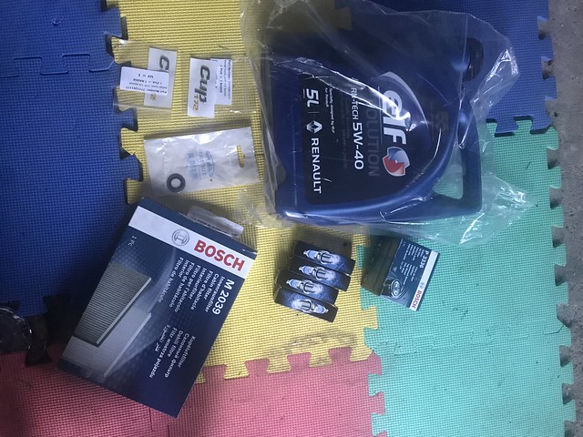

Some service parts ready to go on:
Elf oil 5w 40
Oil filter
Spark plugs
Pollen filter
Sump plug washer
No air filter as running its panel filter, and ordered a fuel filter but they look to be an item not normally replaced so will leave that well alone lol.
Also ordered 1 cup badge for the doors and 2 turned up. Happy days?? so they will be replaced aswell

I dont think cups have a pollen filter mate,are those Bosch Super 4 plugs?
Haha you may well be right! Blindly ordered during the newborn night feeds ? and yes they are the super 4. Just want to give it a quick going over.
Never mind ay,can sell it on.I would suggest using NGK plugs next time mate as most use them as some have probs with other plugs,you maybe ok tho (y)
Looking good tho mate & keeping it well maintained.
Good to know. Cheers. I normally use the NGK iridium platinum on turbo cars as they seem best. Will stick them in and see what happens lol if not will flip over to them. Interested to see whats in there at the moment.
