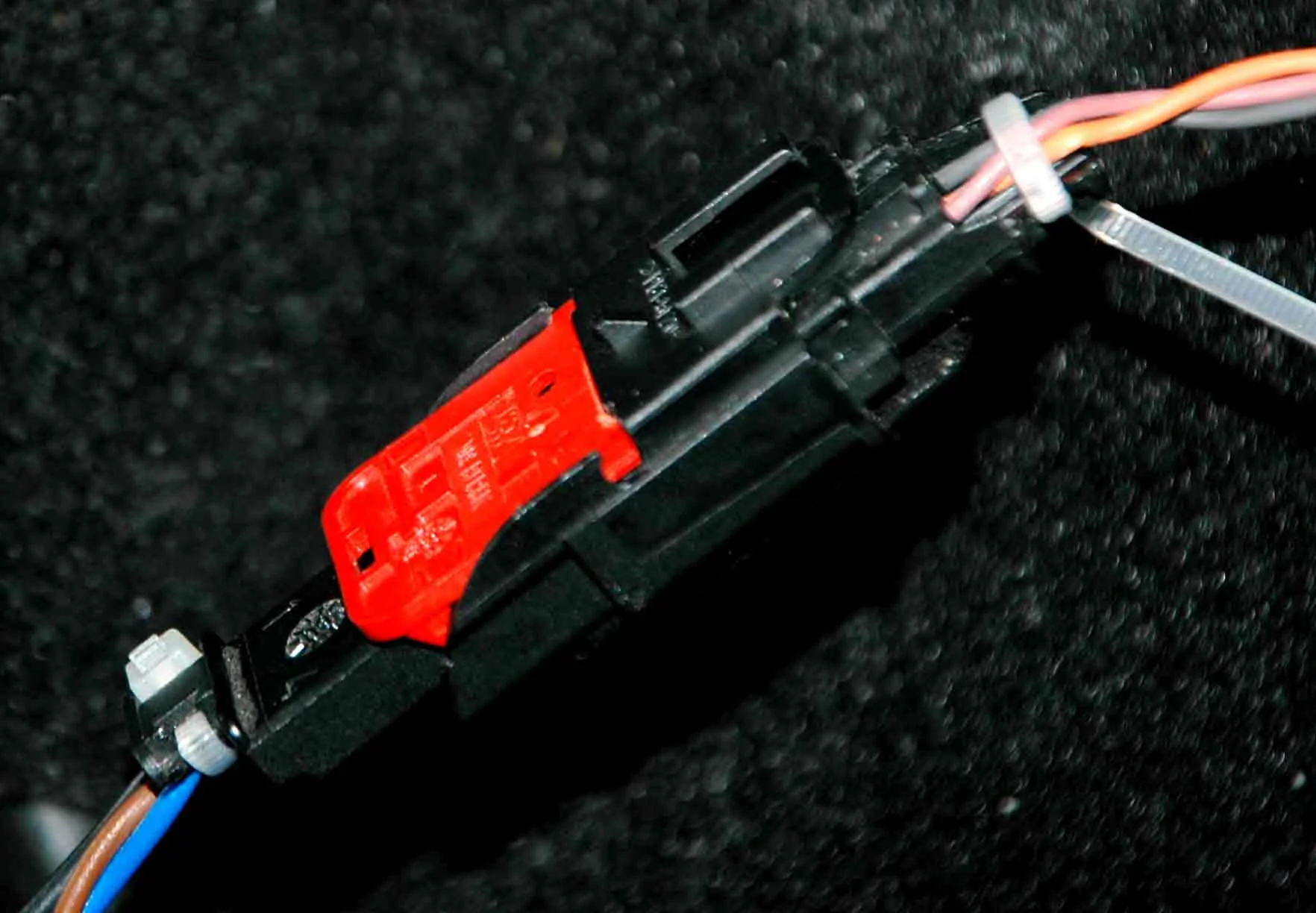

Just had a look at getting the seat out. There are 2 plugs, one grey one with yellow tab. This one opened quite easily. The other, with a large red tab will not budge. Anyone any ideas as to how this comes apart? I have lifted the red tab but it is still stuck. Without this one undone the seat cant be removed.

The plugs come apart by pushing the two halves together then releasing the clip by moving it against the spring pressure.
Disconnect the battery as a safety precaution, as they are part of the SRS system.
I've removed the fuse. I cant feel any movement by pushing the connector together. They are stuck fast. There is slight lateral movement which seems to suggest a catch but I cant see any. Releasing the red tab seems to do nothing.

If it is a small tab with a slit in the middle, just lift the tab and pull hard on the plug.
The plug has a rubber seal and they are tight.
The tab is as wide as the plug, about a third of its length. It seems to exert pressure on the four contacts below it. Presumably to prevent rattling of the contacts which may trigger the seatbelt tensioner. The plug has three wires going to it and matches the Haynes diagram for SRS. I'll see if I can get a photo of it.
Heres a photo of the plug
Ah, right.
Push a small screwdriver under the red clip and it should just pop off. The push the black clip at the other end and pull.
