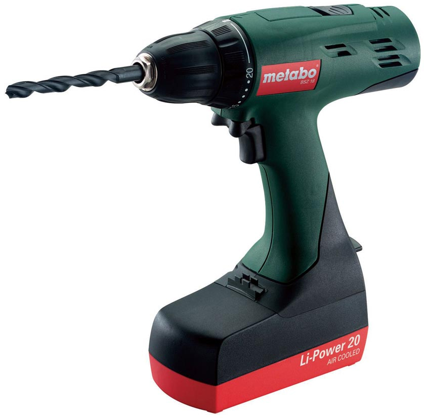

My solution is quicker.
Straight through the carpet/floor. Mind the fuel lines and you're laughing.
