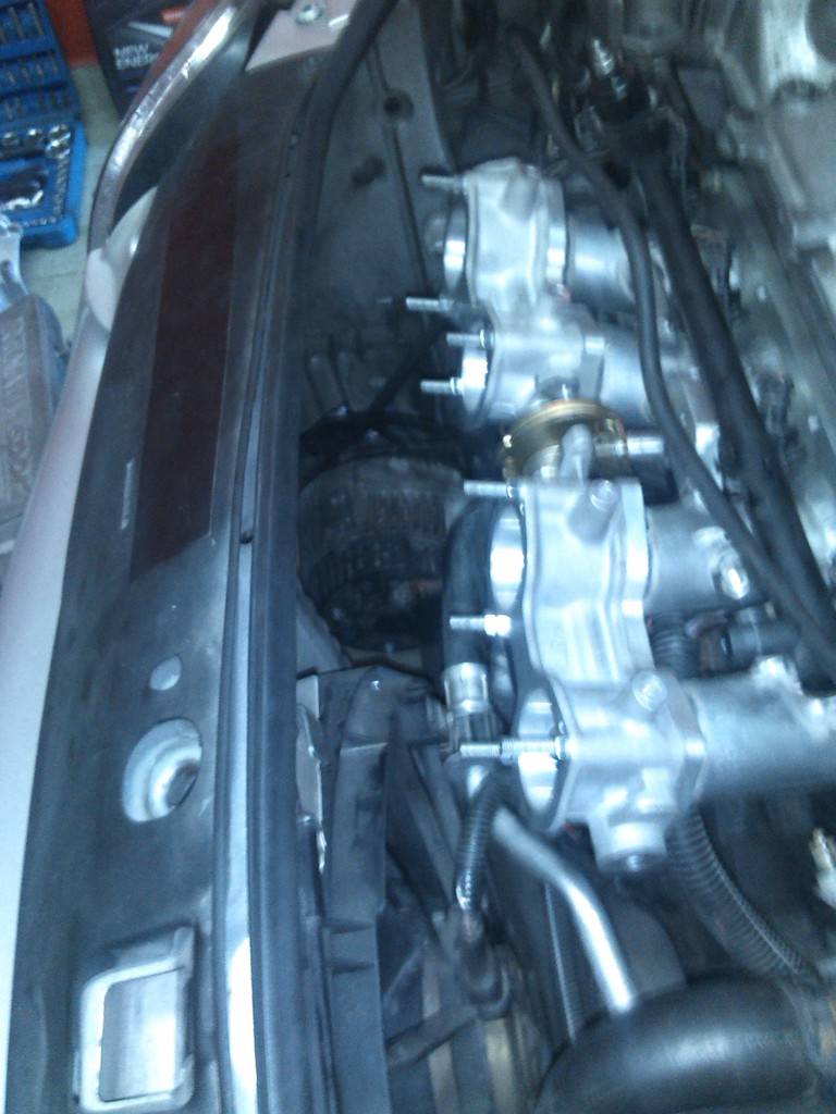

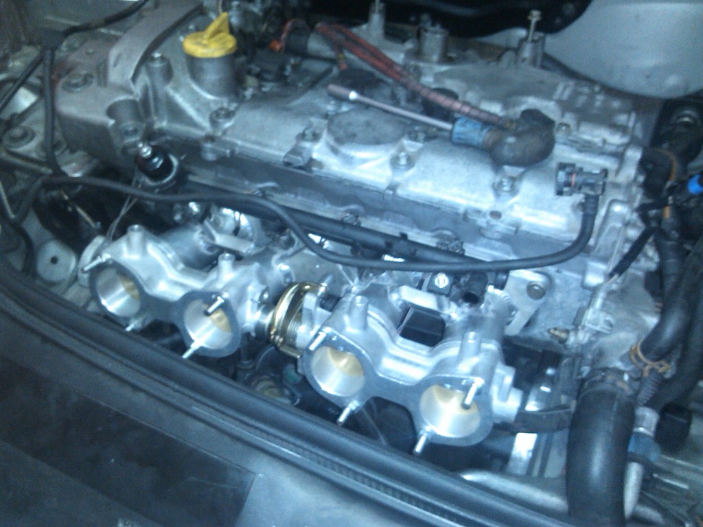

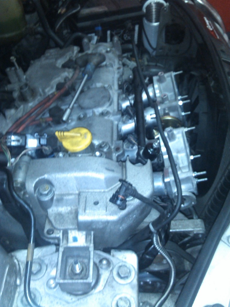

im converting my ph1 172 into itb's and now that im doing that i have just a few question, maybe you can help me !!
here are the pictures like it is at the moment:

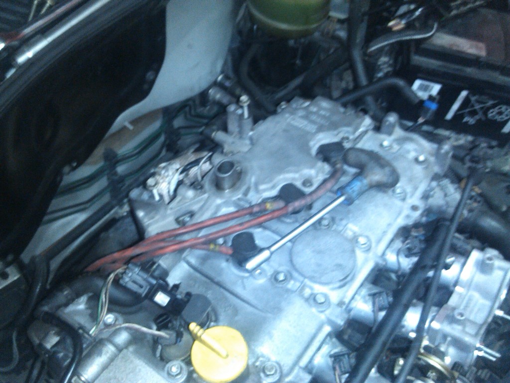

what to do to the hole in the head, that was connected to the intake manifold?!

You only need to be worry about the small hole (1mm). You can plug it to close it off.

When you remove the inlet there is a small 1mm (ish) size hole next to the large oval boss. Look hard and you should see it.
