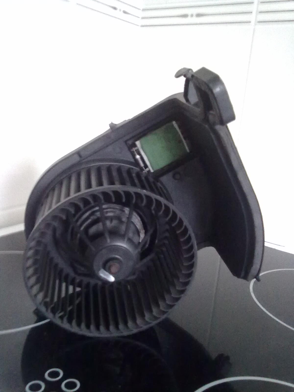

Hi, I visited my local scrappy on the weekend and managed to find an interior fan on a car so took it out only to find that it has a different wire arrangement. After some internet investigation I believe it's because mine has A/C, anyone know for sure please? also does anyone know what part of the unit usually fails? and could I possible swap it between the units?
  Mk1 172 Exclusive
I now have a working interior fan :) Basically the motor in mine had died but the resistors etc were all working so I took the resistor pack out of mine and put it into the one I got from the scrappy and hey presto it worked.. unfortunately the screws etc did not fit due to being a different design but I sealed the unit in place with sealant.. I know its not a very neat job but until I can find another one for a £5 at my local scrappy it will do :)
