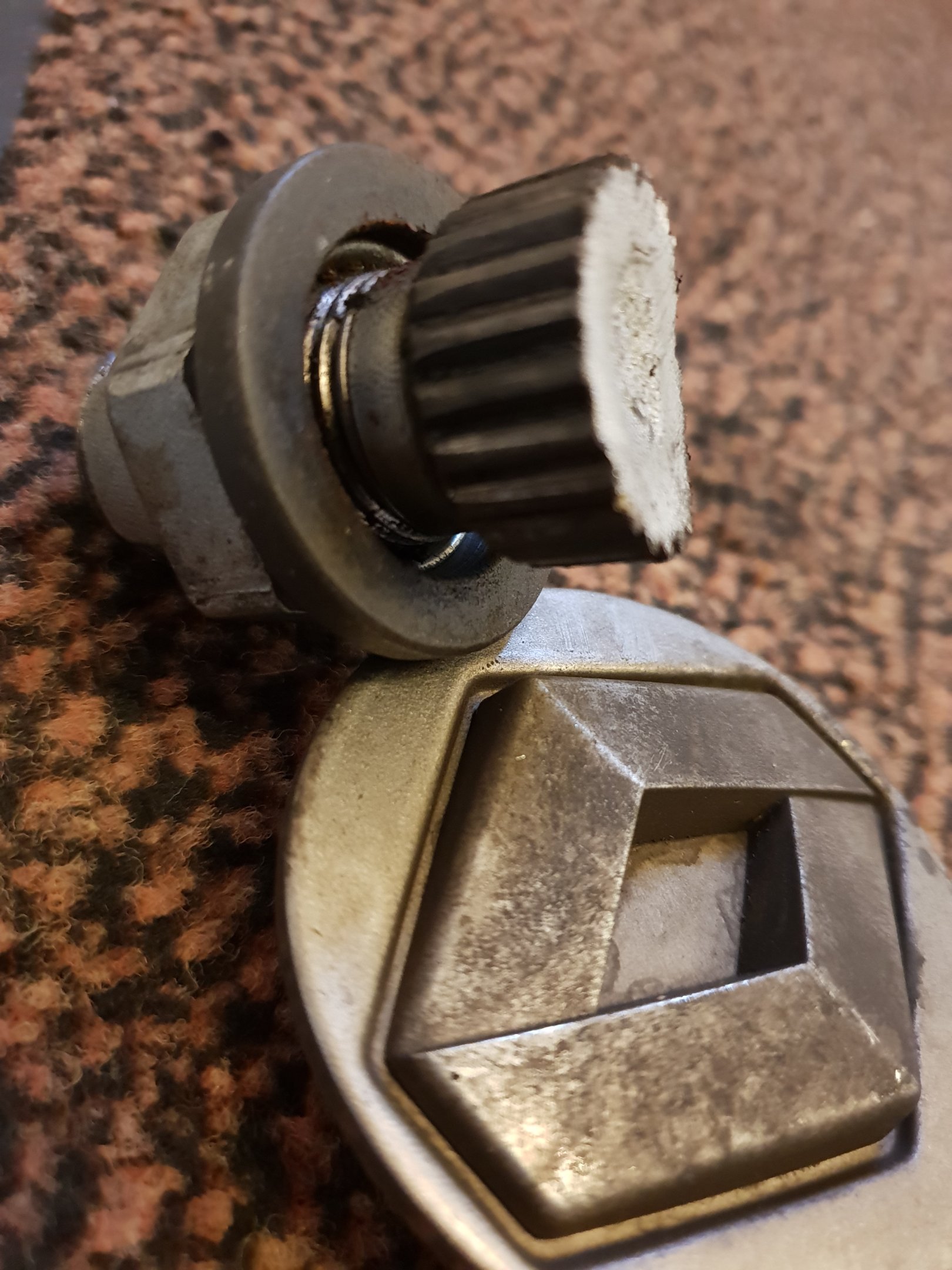

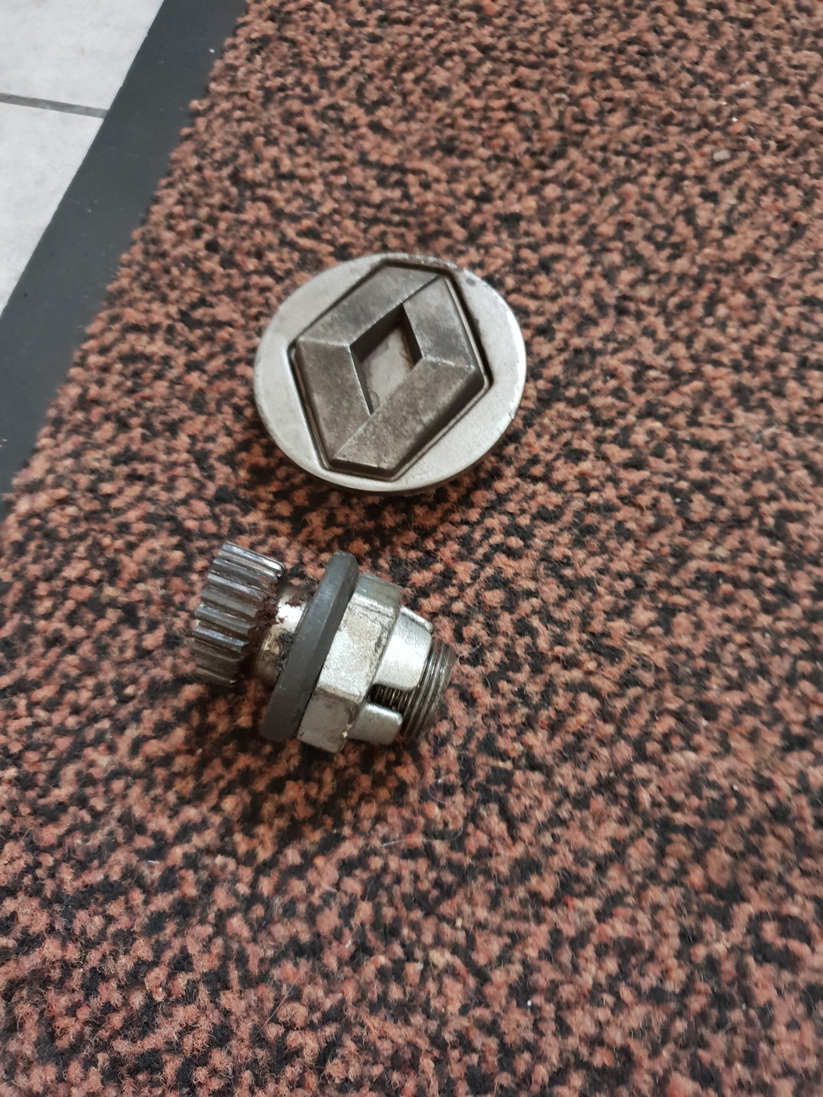

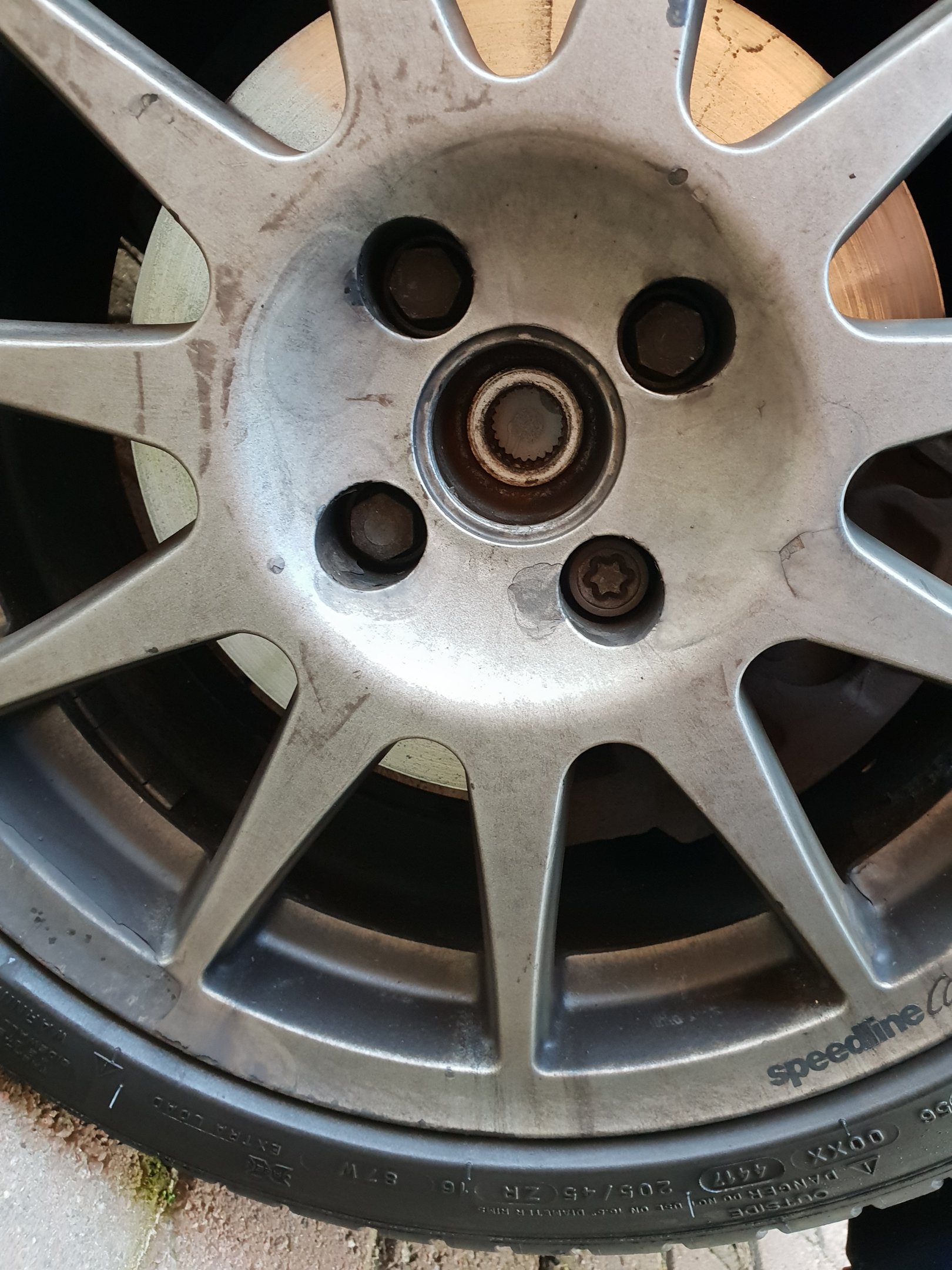

As per the pics, looks like they took off the centre cap off and tried to take off the central hub nut, which luckily sheered off. No other damage weirdly.
Does anyone know the part number for the nut I need? Cheers.

I don't think there's been an attempt. Any of the bolts loose?
That seems more like a driveshaft failure than anything. Weird place for it to break though
Think you guys are right, just had a proper look around and there's nothing else untoward, my car is dirty as anything so there would have at least been fingers marks around the wheels. None of the wheel nuts are loose or look to have been tampered with.
The randomness of it breaking off there though is crazy!
They'd have to be super retarded to undo that one so most likely the driveshaft has snapped. Not great to fix though!
I’ve had one go exactly like that before from when a wheel bearing was proper fucked for a long time
If you've driven it like that the chances are the bearing will be goosed now too

So the centre cap was just on the floor sat next to the nut? Need more info
Yeah.
Went to get in the car and the centre cap and nut were sat right next to the wheel, hence why I thought someone had tried to steal them. It's been driving fine before that.
Hub nut doesn't look that old compared to a new Renault one I got recently
Discs look recent
Wheel looks like its hit some cones on track or something
Did they take the car on track at all and leave you to pick up the pieces?
Either way whatever has happened you need to stick a new driveshaft in it and get that bearing pulled together as soon as possible really. If it wasn't fucked before it might be in future with the weight of the car sat on it
Others will disagree but it'll start to separate and weigh heavy on the bearing races
