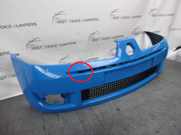

A good thing to check - usual crash damage on the front would mean the black inserts on the bumpers at the top are usually taken off/sprayed over - so check those are still there :)
Here's a quick example:
