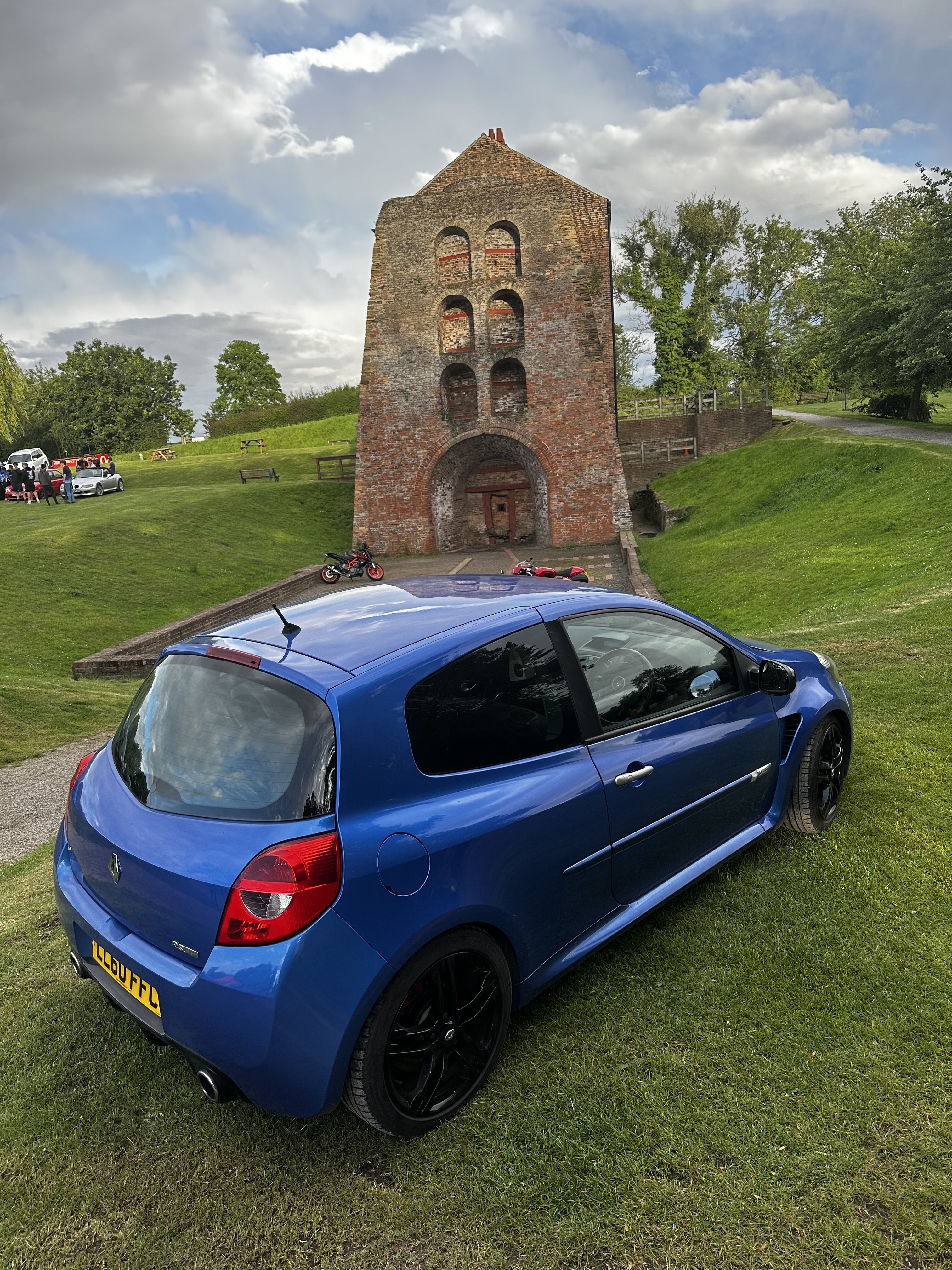

Hey people
bought a beaut 200 last year, it’d had the clutch done and is a low miler (now on 60k on a 60 plate).
probably time it was serviced. I just rechecked and looks like I have no book and receipts are light, so what do you esteemed folks reckon I should get done?
im thinking full service, oil, filters, plugs… but what about belts and stuff?
