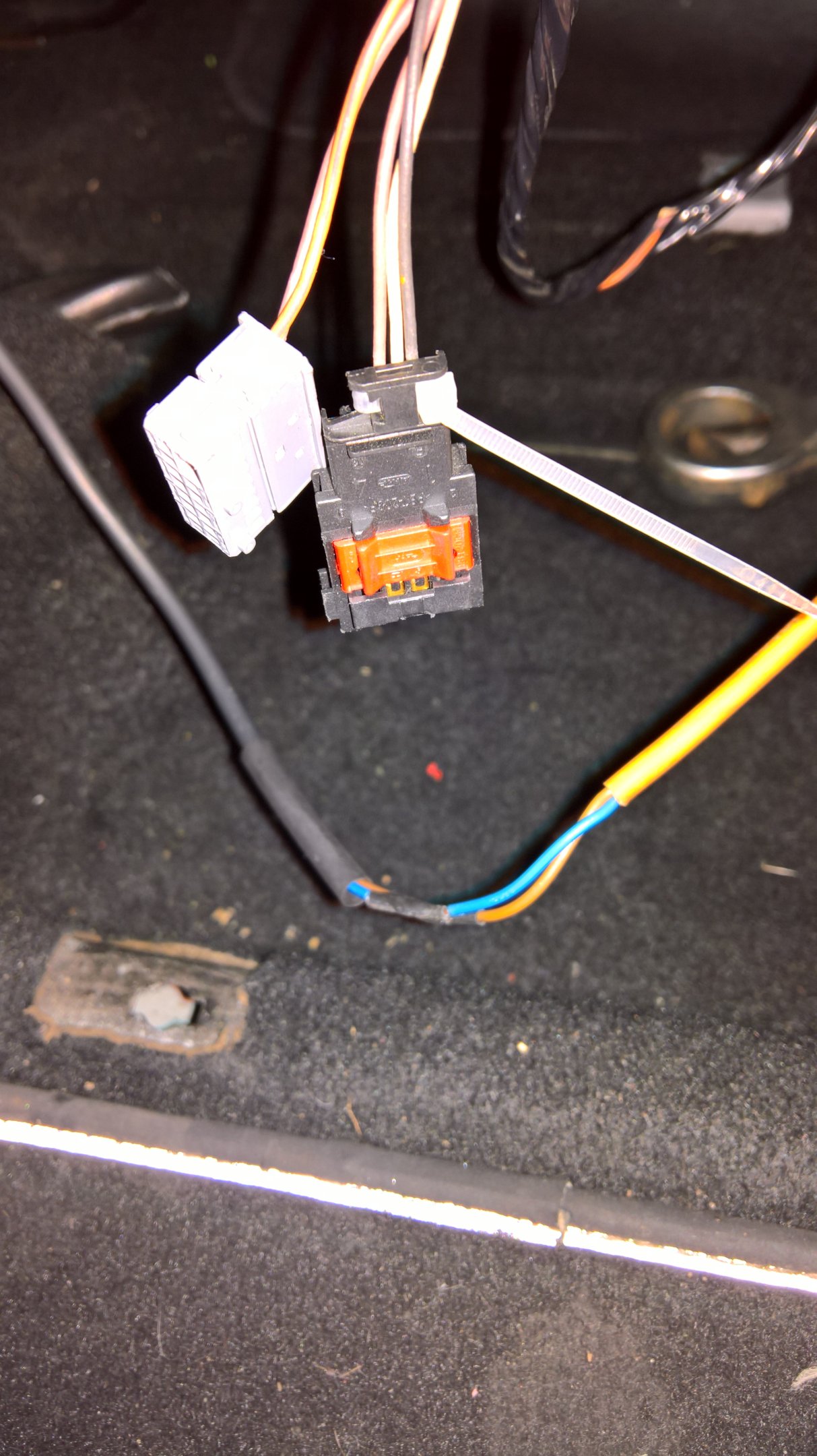

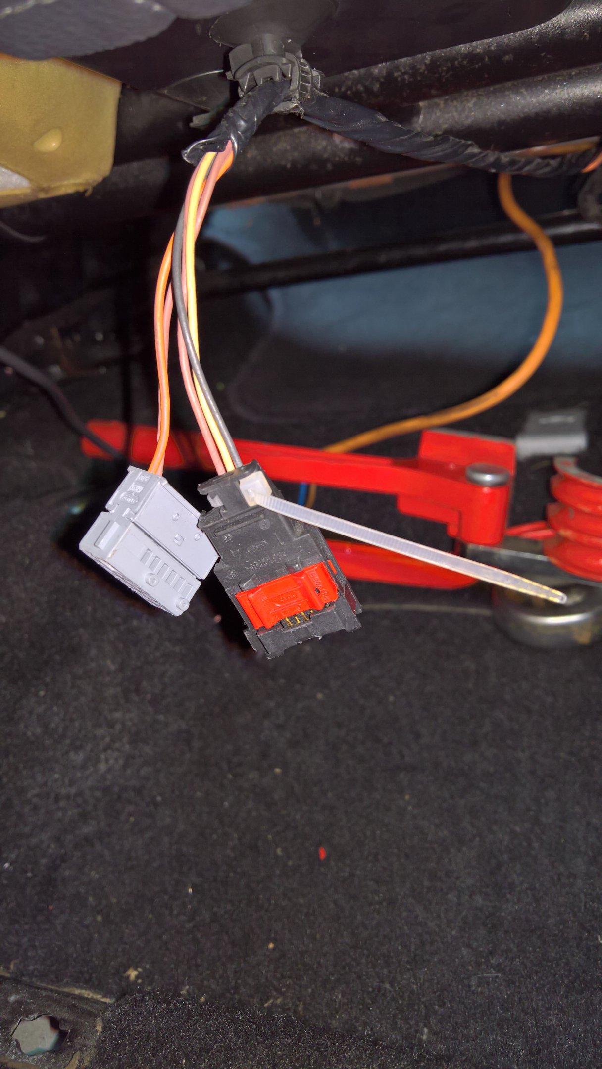

I have been searching on here for about an hour now but cant see exactly what I'm looking for.
The connectors under my passenger seat have been chopped off and connected incorrectly to each other so I am trying to find out what colours connect to what as I would like to try fixing this without the use of resistors first
Can anyone help me out or check what colours match up, would be much appreciated as it failed its mot on the airbag light
I’m not sure which wires you need but you will need the resisters as they create a false reading to the air bag module to extinguish the light. Or.. take to a garage with clip where they can again access to air bag module and bypass the seat circuit. Rentec did mine
