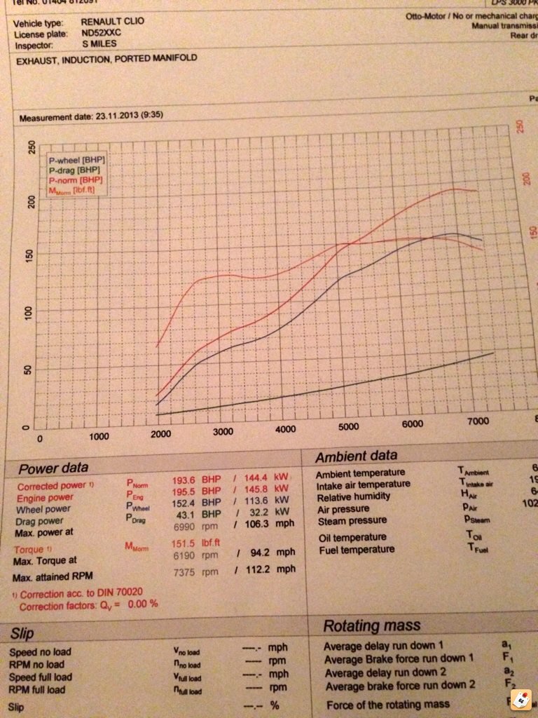

The 193 was mine I don't think mine has cams or been mapped I'm abit confused with it really. This is the dyno reading I got.
I've not seen a standard cam'd 172 hold 150lb-ft on a stock inlet over 6500!
