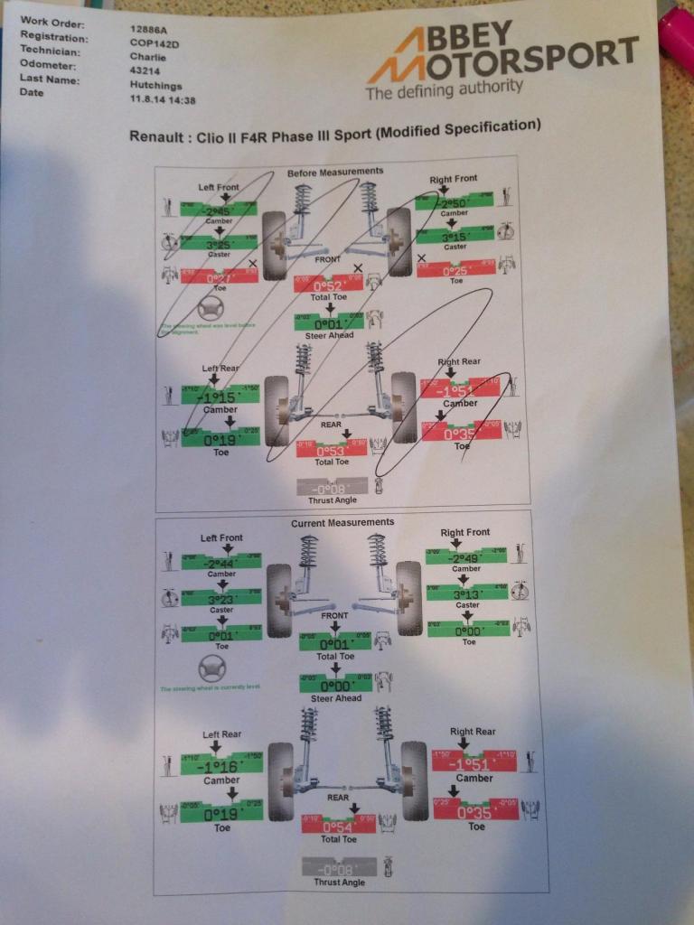

Right so I got a proper GEO setup done on the car on Monday.
It's given me some values to work with and hopefully work out what spacers and shims to buy.

3) I've currently got -2.5 camber at the front. Can't go anymore currently as the tyre is extremely close to contact with the thread winder on the coilovers. So if I want -3 degrees I'm going to have to get the spacer sorted first but don't know what to go for.
I was thinking something like 10-15mm each side on the front. That might allow me to reach -3 camber too.

I'd go an extra degree on the OSR and 30 minutes on the NSR; correct the toe too you might need two shims used together one for the toe and one for the camber.
You'll be ok with 10mm hub spacers on the back along with the shims and then as Mark said 10mm will be fine on the front too.

What would that give me in numbers compared to what I have now please :o I don't know how to read degrees/minutes properly lol.

2.3 degrees each side, or thereabouts.

So I'll aim for about -2 to -2.5 degrees camber on the rears. Will it be a problem if my fronts can't actually go any more than this, and I have the same camber front and rear?
No mate it will be fine. You'll find that you can add more camber with the roll centre hubs fitted as they push the hub out by 5mm at the bottom.

You need to know what the rear geo is before you can say really mate. I'd say you'll not be far off tbh, but it all depends on how straight you're rear beam is.
I'd leave the rear toe as toe in by 1-1.5mm if I were you. If you run it parallel or toe out you'll end up with quite a loose rear end.
Ok so I'll Geo it before hand and see what figures I get - is rear tow standard toe in 1 - 1.5mm then ?

I didn't know the rear was toe in as standard. Isn't mine toe out? From the results above? It's a positive number just like the tiny bit on the front.
Really can't get my head around how parallel would make the rear loose... Isn't mine pretty parallel now?

Can you iMessage me a pic of your geo sheet? Can't see it clear enough on here. If the numbers positive it's usually toe in. Negative means toe out. If you've got 54minutes of toe in on the rear, you've got a lot of toe in as well! You ideally want toe out up front to.
Massive thanks to Mark. Who has taken time to explain it all to me properly. I now feel that I have a much better understanding of it all and have some settings which I'm going to aim for.
