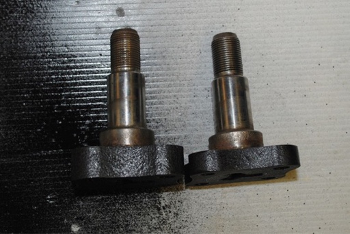

Just out of interest have you checked you’ve got the same stub axles on both sides?
172cup axles were about 5mm thinner than standard. I found this on my car a couple of years ago.
Never looked at those...[emoji848]
5mm is a lot so would be worth checking stub axles as already mentioned. Does it drive ok? How did you find out it was 5mm out?

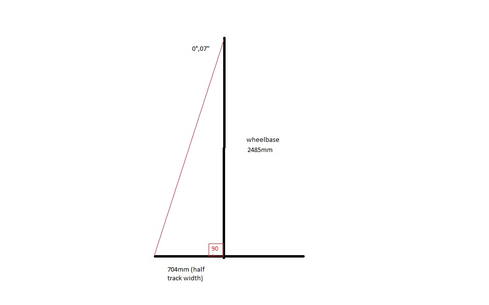

yeah I know, found out from an alignment see this topic.
offset is 0°.07min, plugged some numbers (wheelbase, centerline angle, offset angle) into a Pythagoras website and it came up as 5mm
it also has a problem with camber.
it now drives ok, slight pull under braking and seems to prefer left hand corners.
