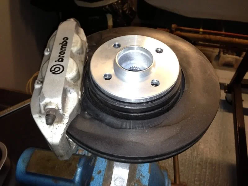

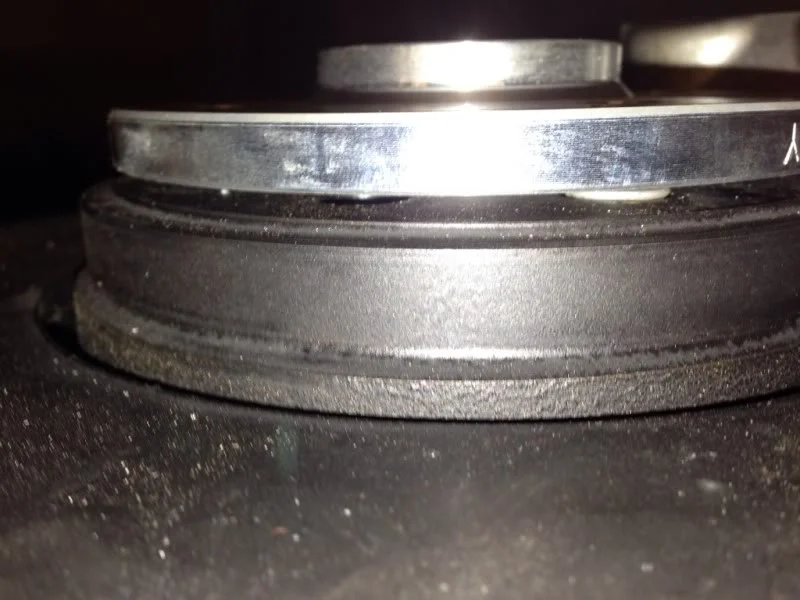

Not very well, the listed 20mm kit is 10mm per side and they have a spigot so don't even work.
I have doubled them up with some washers for just now to clear my brembos untill I get others, you need the listed 40mm if you are wanting 20mm per side. Iirc 16mm is the smallest spigot spacer you can use on a Clio.
Otherwise they are really good quality for the price.
You can grind the spigot on the hub down so they will sit on better, and its still enough to locate them properly, the clio spigots are particuarly deep.
Yeah thought about it tbh but the chamfer on the inside if the spacer would only have circa 1mm onto the spigot with 2x10mm stacked on top of each other with the lower spigot cut off.
Not I deal if your away to chuck it round a track, I'll do it right and get some 20mm per side.
edit: I read that as grind the spigot down on the spacer. Viable option but would need every set of rear disks doing. Might look into it after I receive the new wheels, unsure of the offset as the seller couldn't tell me so I took a punt.
Agreed, I meant to allow use of one set, I wasnt recomending stacking them on top of each other, that just mutliplies any inaccuracy in their fitment.
