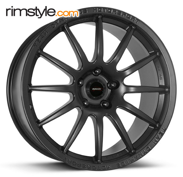

I am between Speedlines 2118 and the Team Dynamics pro 1.2 in anthracite. Logic and maths/physics saying to go with the TD’s as they are cheaper by £100 and most importantly lighter by 3 kilos. Less Weight to rotate and less unsprung weight for the suspension.

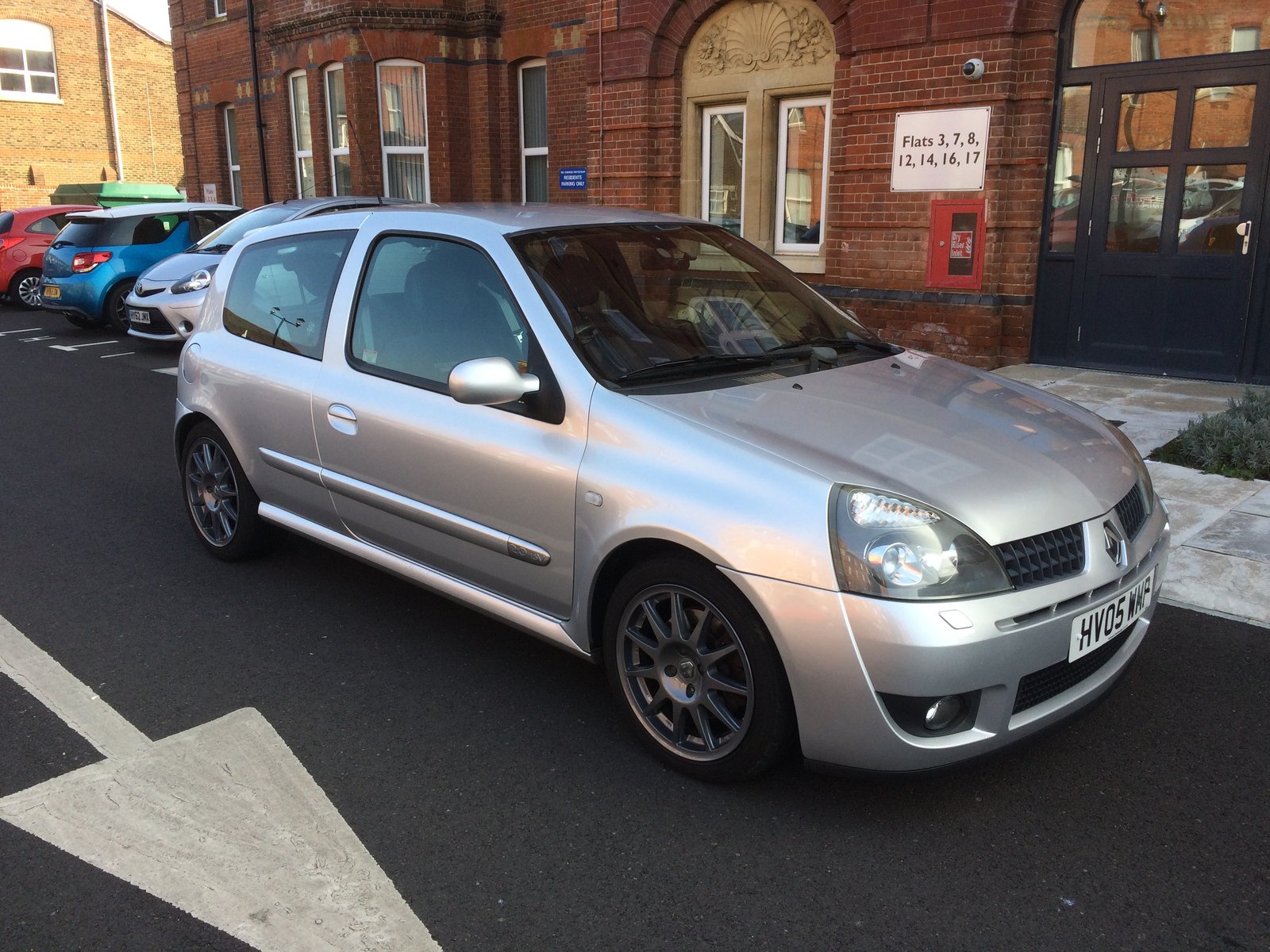

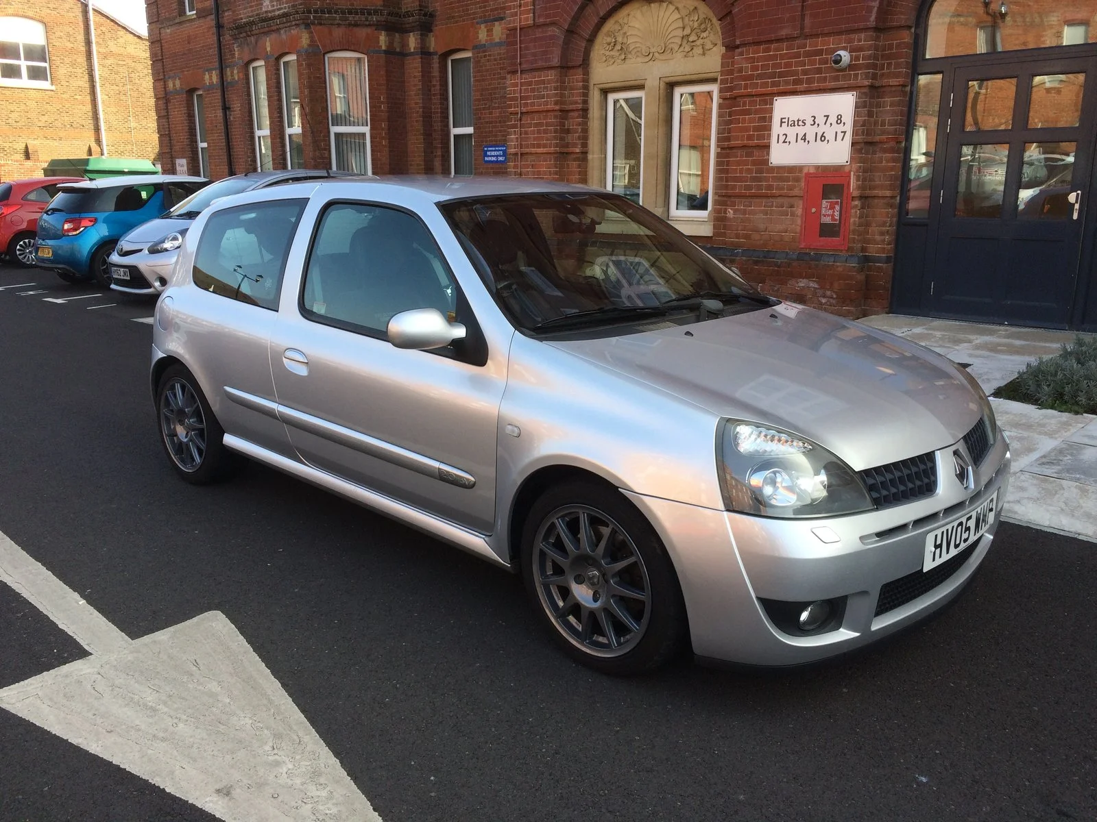

At the moment my car looks like the picture bellow.

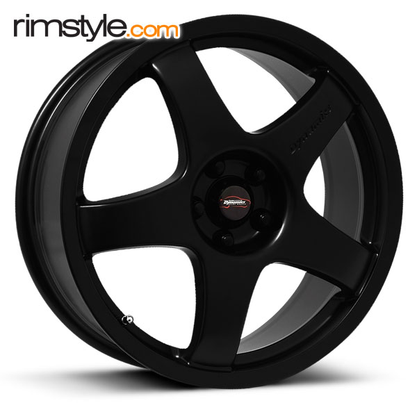

Think I paid about £45 a tyre for PS3 in 195/50/15 from My Tyres or Tyreleader last year though. Currently on my 2118's and have done a few track days on them. I'm currently debating on some more track wheels. Either another set of 2118 because they are strong (even if they are a little heavy but i'm not a race drive so probably wouldnt notice much difference) OR Sell my 2118's and buy 2 sets of Pro Race 1.2 or 3's in 15" (they were I think £391 a set in Gloss black or Satin/Matt other colours were more expensive) Picture was just for refrence I think I looked at a few places.... I was swayed towards the chunky 5 spoke for ease of cleaning, ventilation (which is probable negligable) and clearance if I want to run bigger calipers in future.

I have a set of both pro race and 2118....the 2118's with road tyres (ps3's) and the pro race with track tyres (r888r's). Surprised how much heavier the 2118's are, I'd be inclined to go for another set of pro race just because of the price difference but I liked both wheels haha!
2118's are in et43, pro race in et35.
